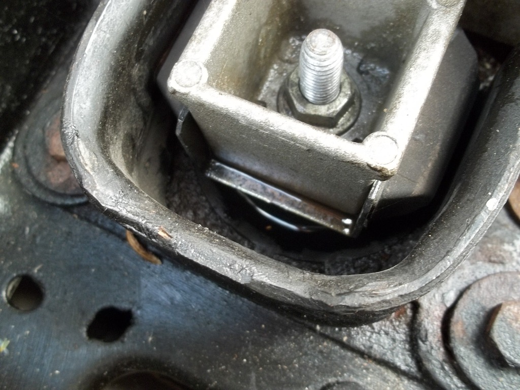

I noticed this first, some engine oil in the offside rubber engine mount recess.
Wasn't too worried about that, was expecting a small leak at some point due to the rather complicated cam cover arrangement. No big deal.

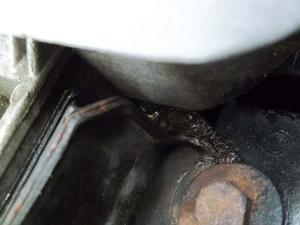

Then noticed some white scum in some of the oil just under the same engine mount spanning bracket.

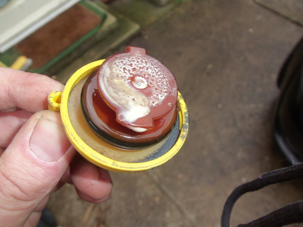

Next checked the oil filler cap. Covered in white scum. Cleaned it off and ran engine again and scum returned straight away.
Do we think this is def a HG failure? Could it be something else?

Has it been doing a lot of short journeys? Is the breather choked? It could just be condensation building and not evapourating up due to not getting up to temp (if short journeys) coupled with the cold weather setting in.
Corsa C's are murder for it. I was convinced my wifes one was away on her old car but it wasnt.
Drain a but oil out the sump see if its mixed there if not id bet its just condensation

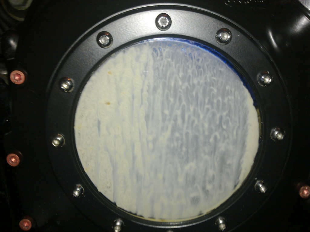

being able to breathe doesn't make much difference when an engine is warming up, the pic i posted is from a perfectly healthy engine with no breathing problems.

Hey guys just got back from garage. They block tested and no sign of exhaust gas in teh coolant so I am in the clear! Yipee!
I need to keep the same short journey routine so from now on my routine will include:
- a long drive at least twice a month
- extra regular oil changes(i am guessing water in oil is bad one way or another)
