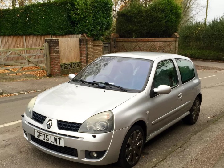

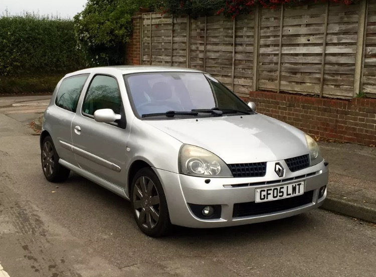

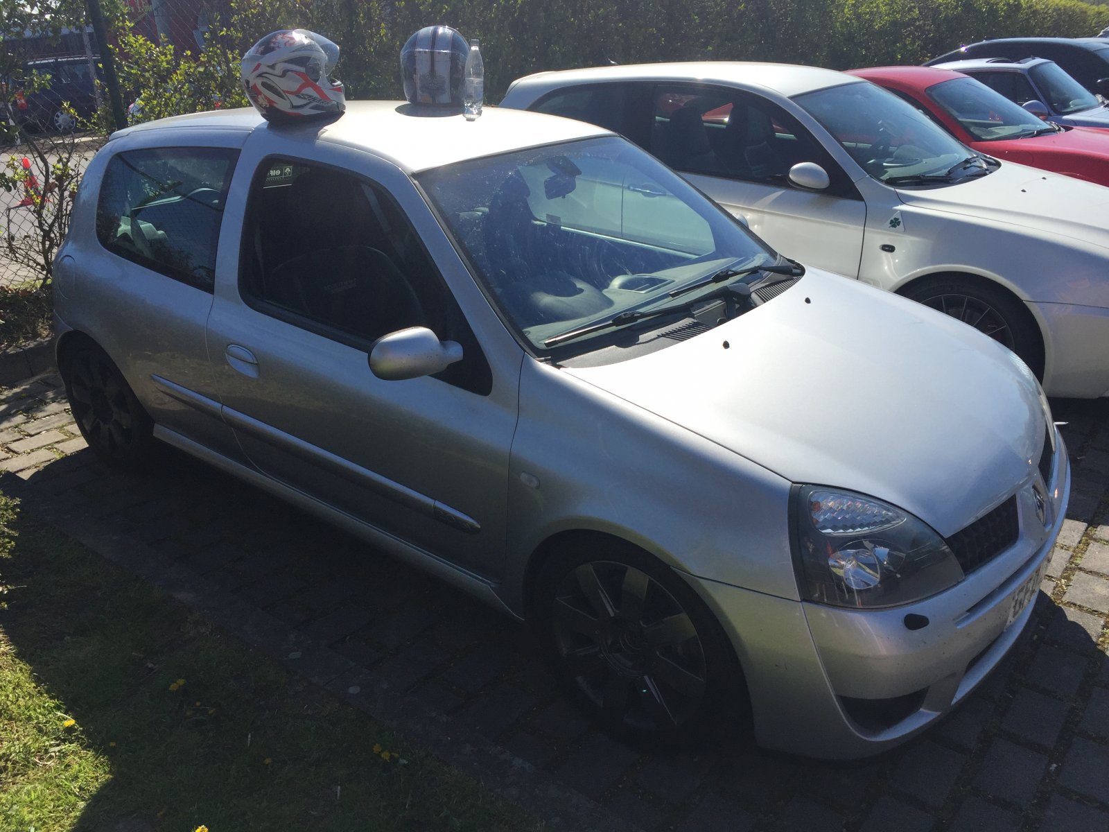

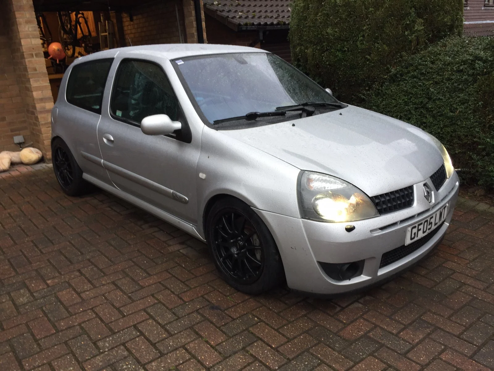

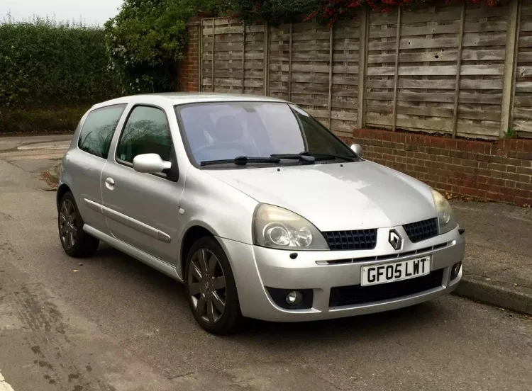

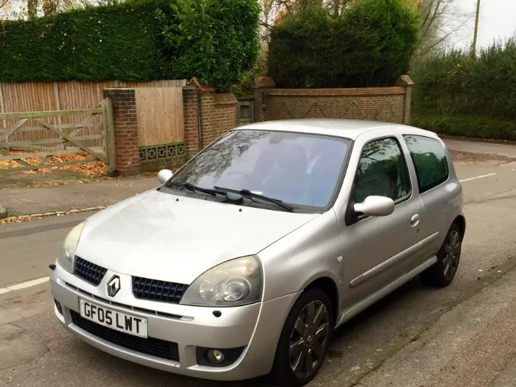

I brought this standard 96K Clio 182 December 2015 and have been on quite a journey with it since. The idea was to have a track car that can be used as much as possible and not be sat in the garage for months on end when something goes wrong (I’ve learnt this the hard way having spent a fortune on an M3 thats engine failed which then turned into an ornament in the garage for years!). Then if time allows to race it in something similar to track day trophy in a few years’ time.
So I brought this 182 off eBay. It seamed ok and all the other cars seemed to be 100s of miles away.
At the time it was standard but I decided on changing/uprating before I used it properly on track. I don’t use it as a road car so on road comfort isn’t an issue.

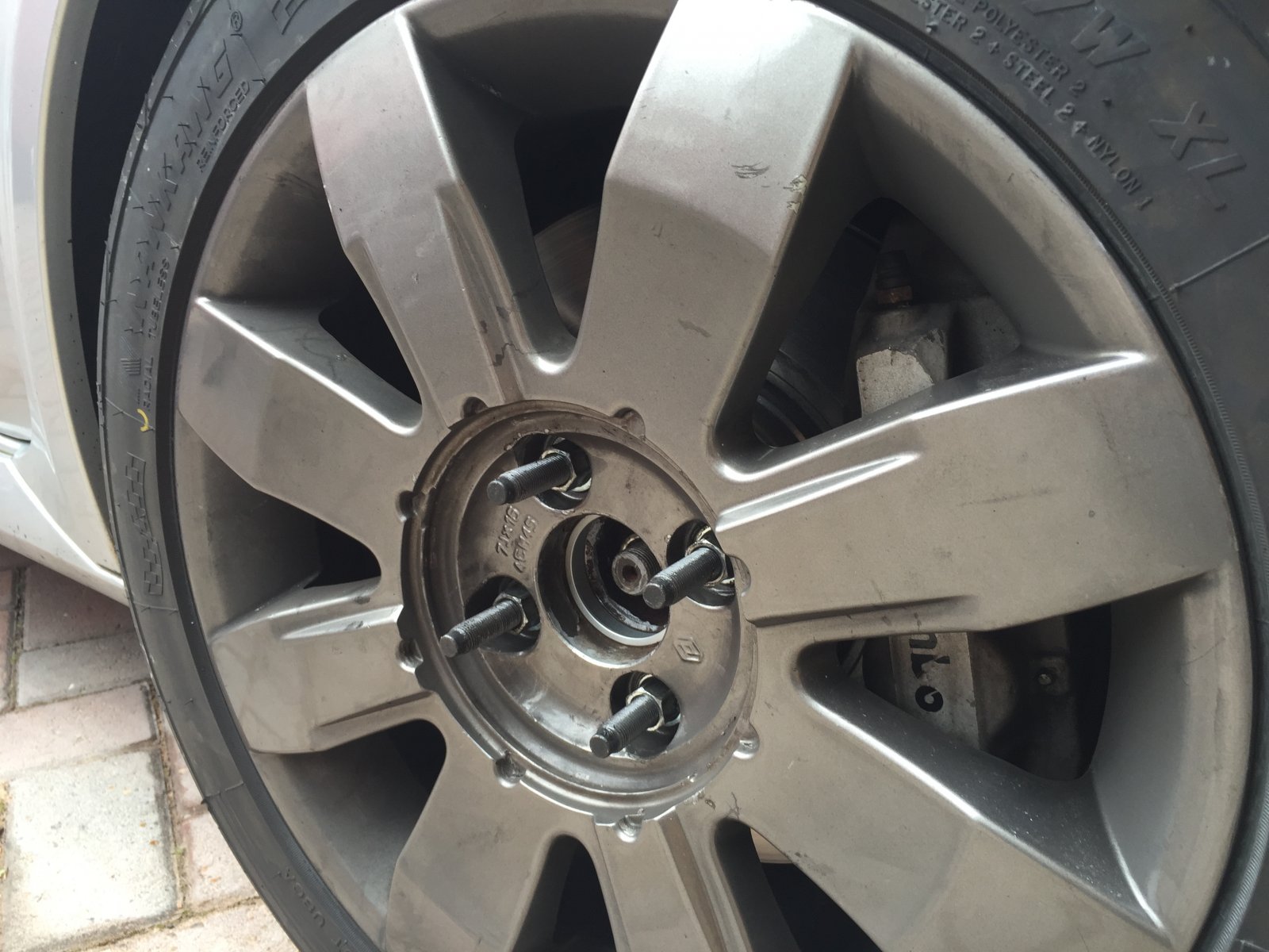

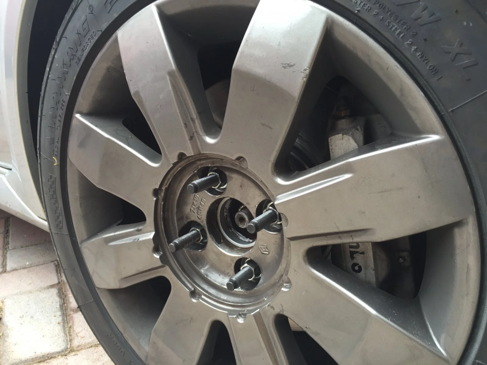

Stud conversion and 25mm spacers (couldn’t get the brembos to fit under the standard wheels)
Nankang RS2R tyres

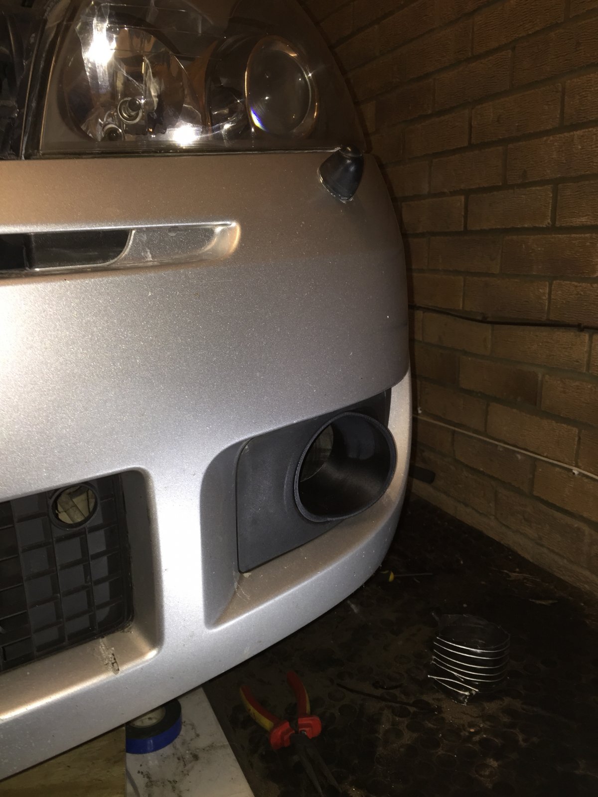

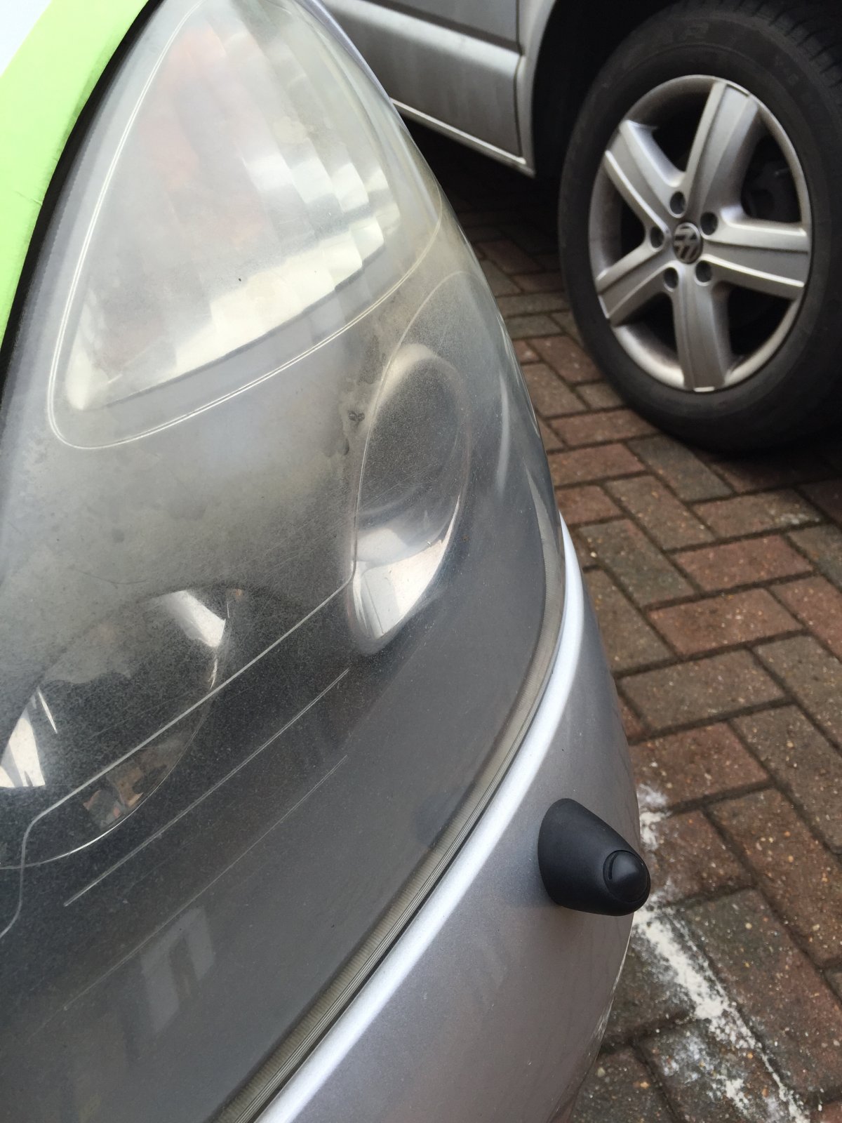

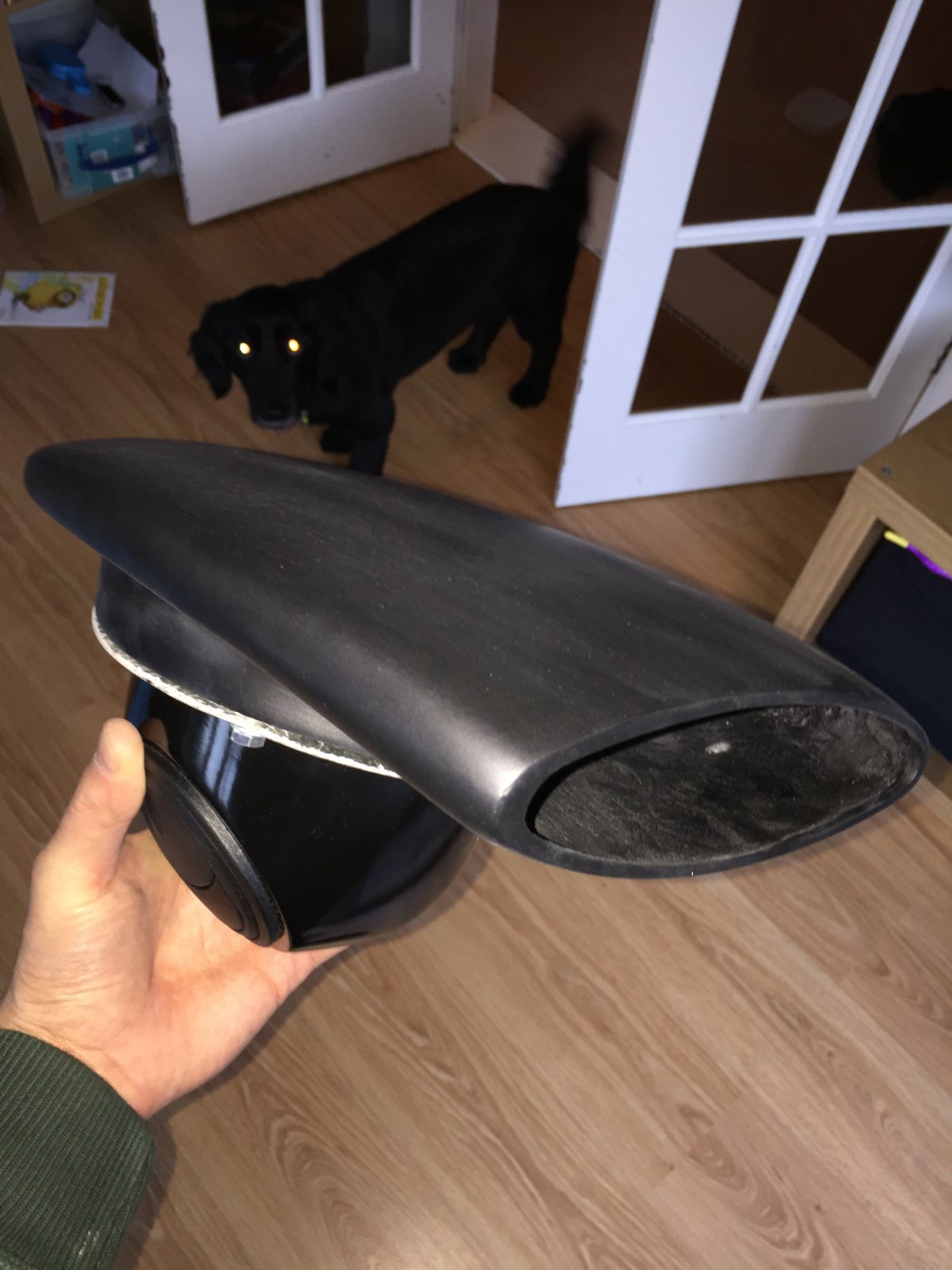

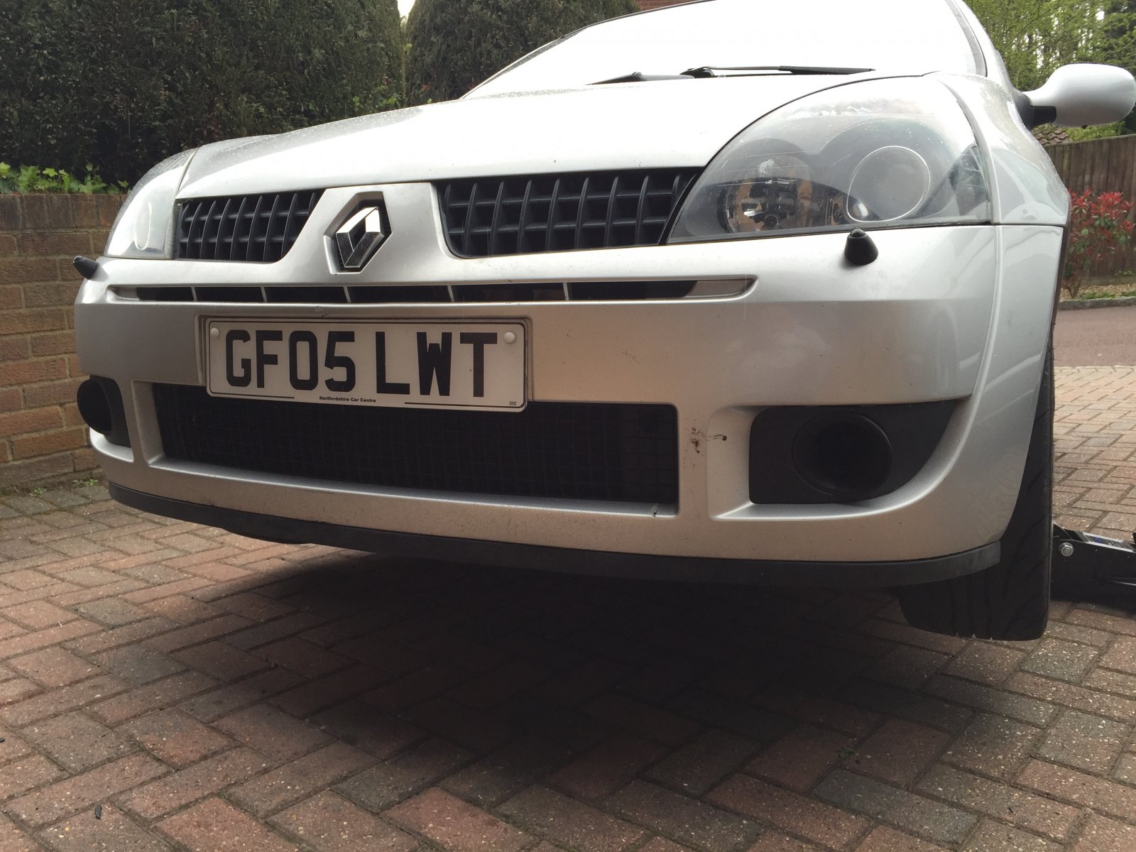

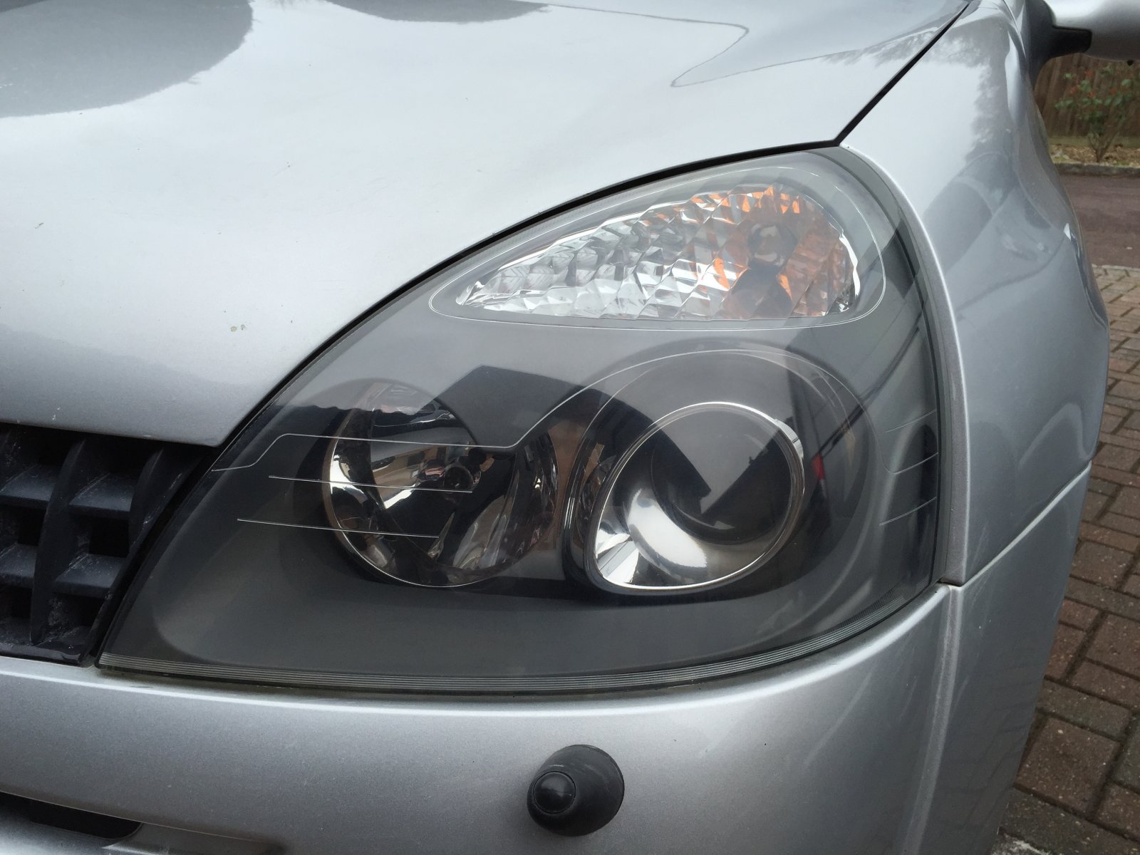

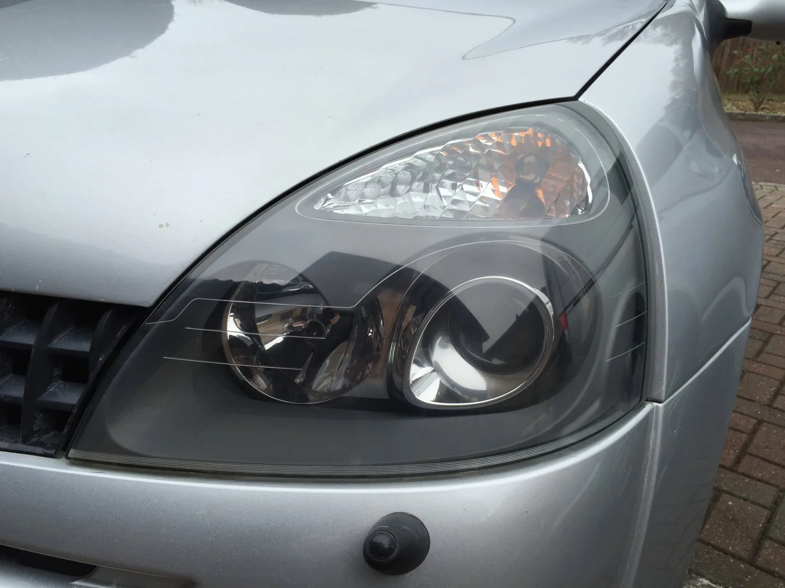

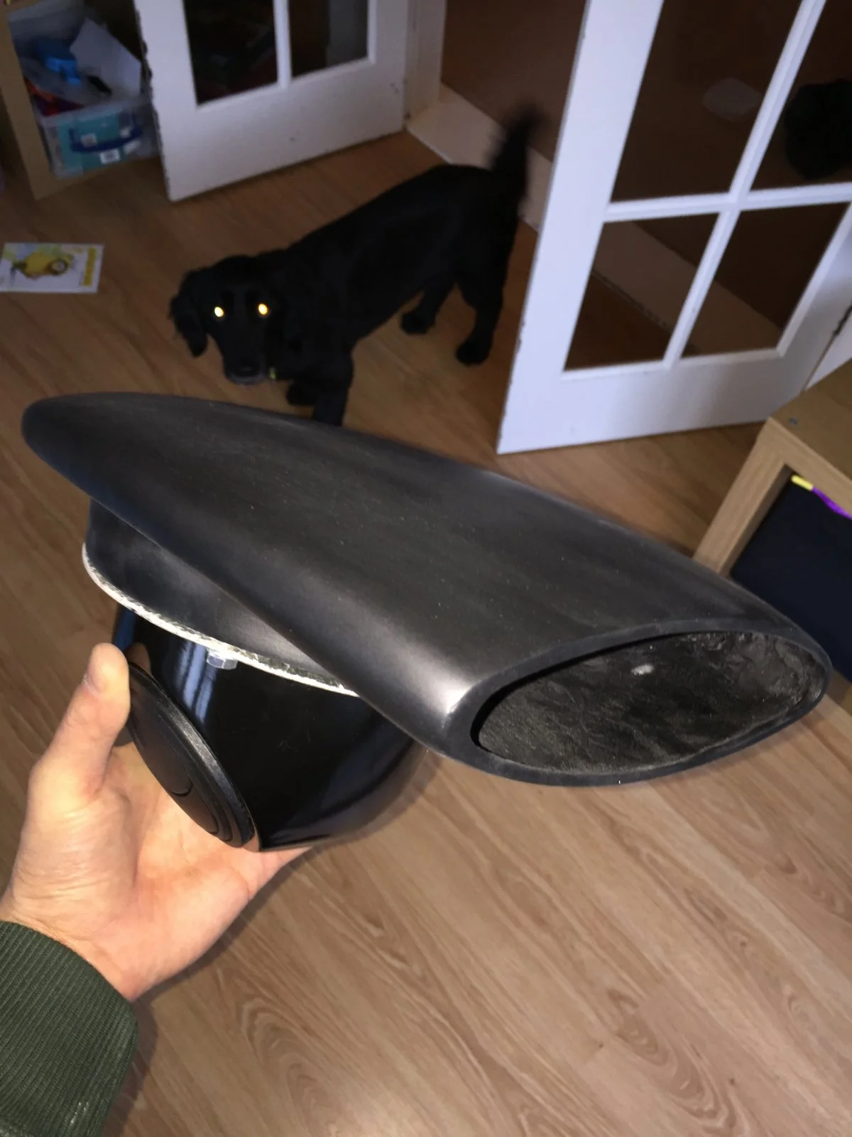

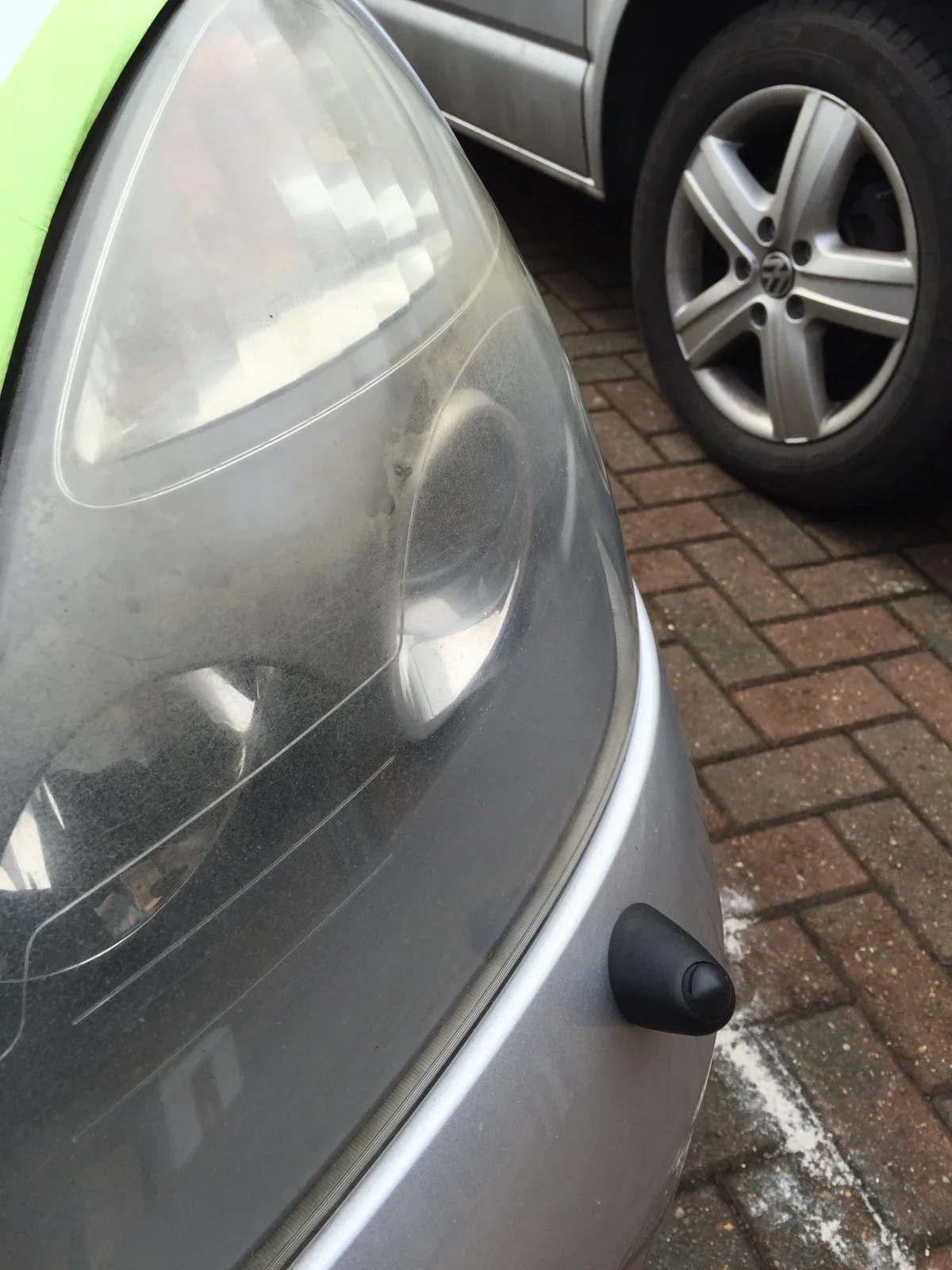

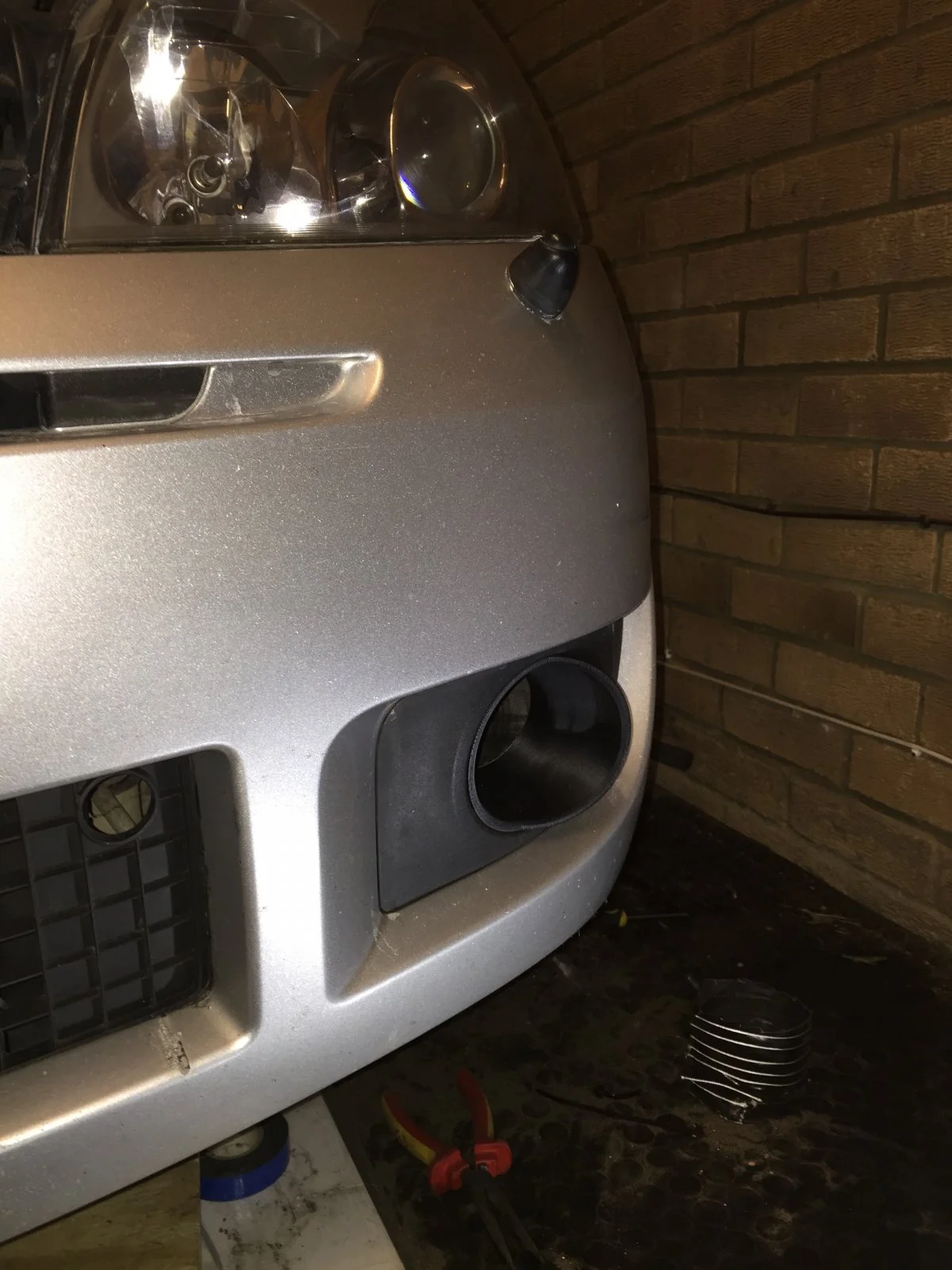

I also tidied up the headlights and installed some brake ducts

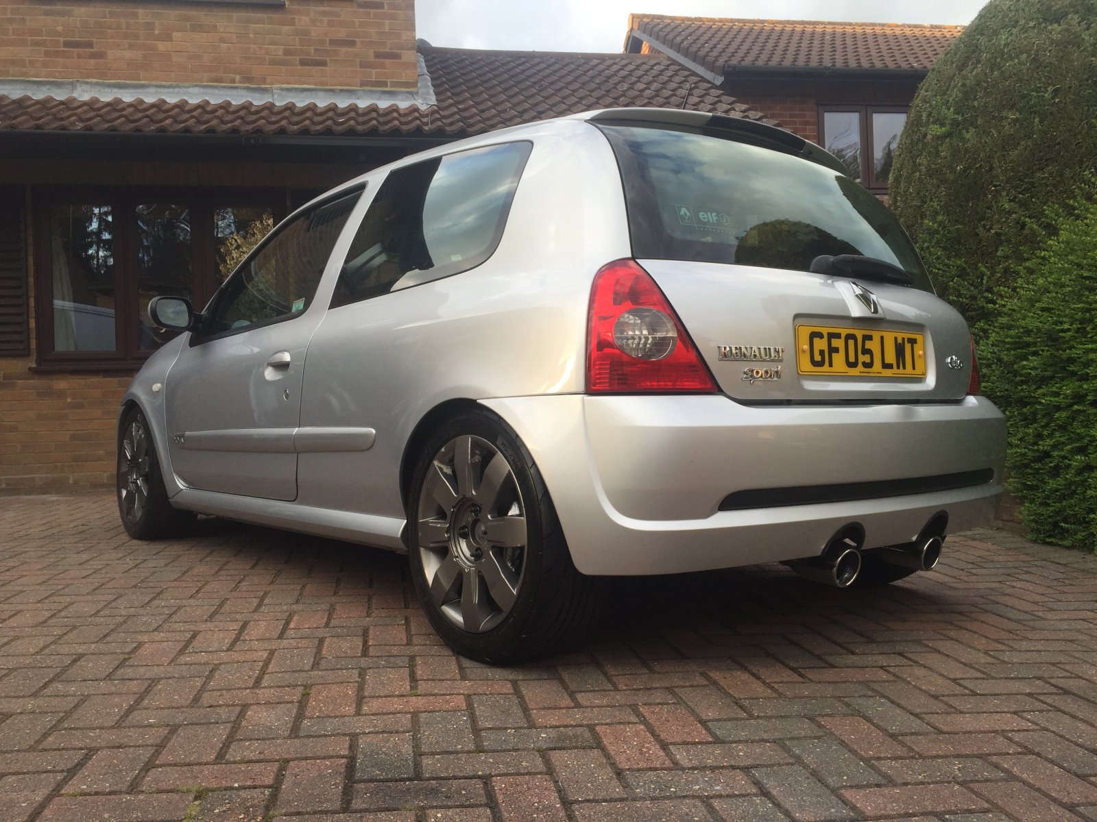

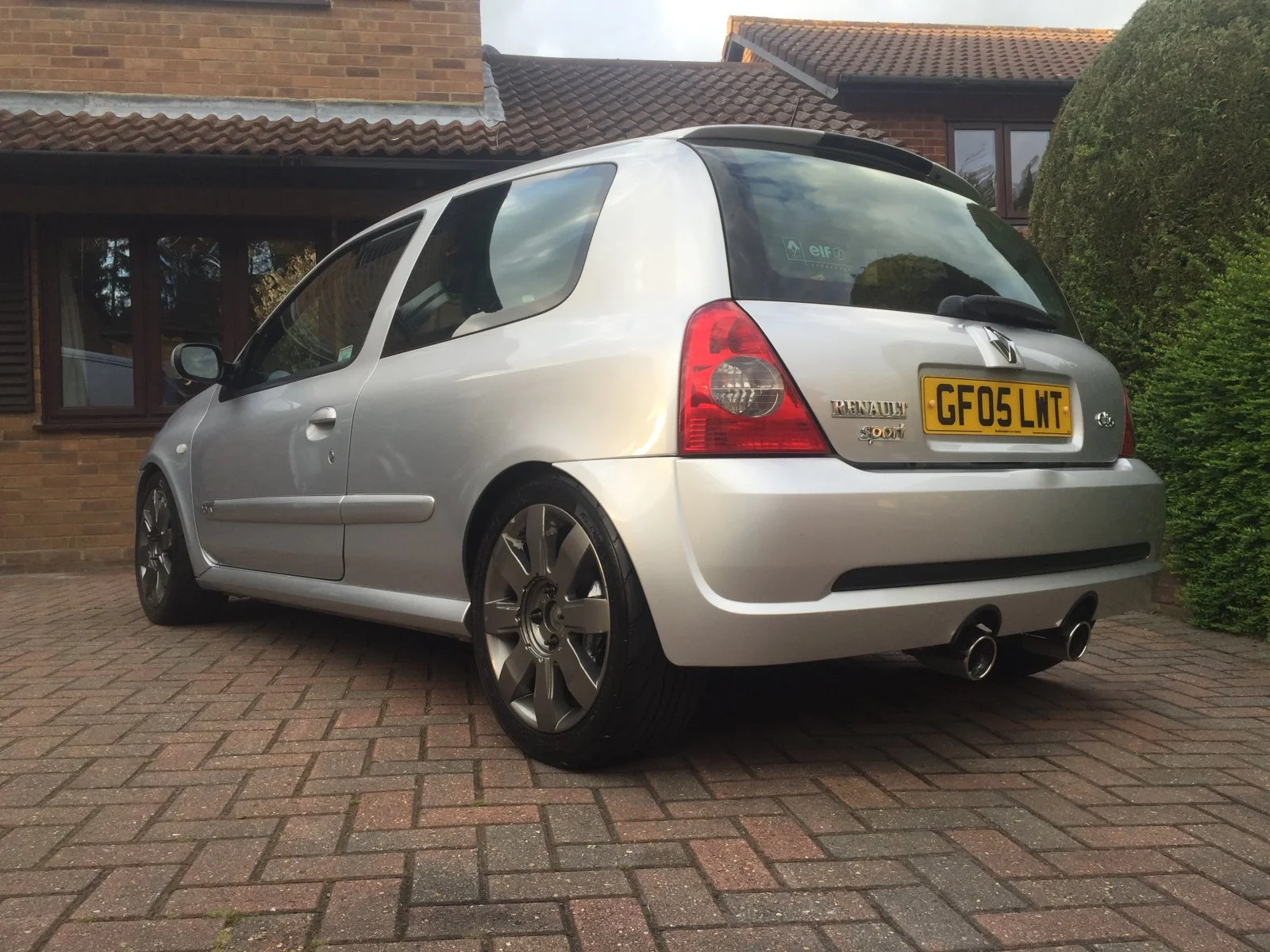

Once cleaned it looked like this

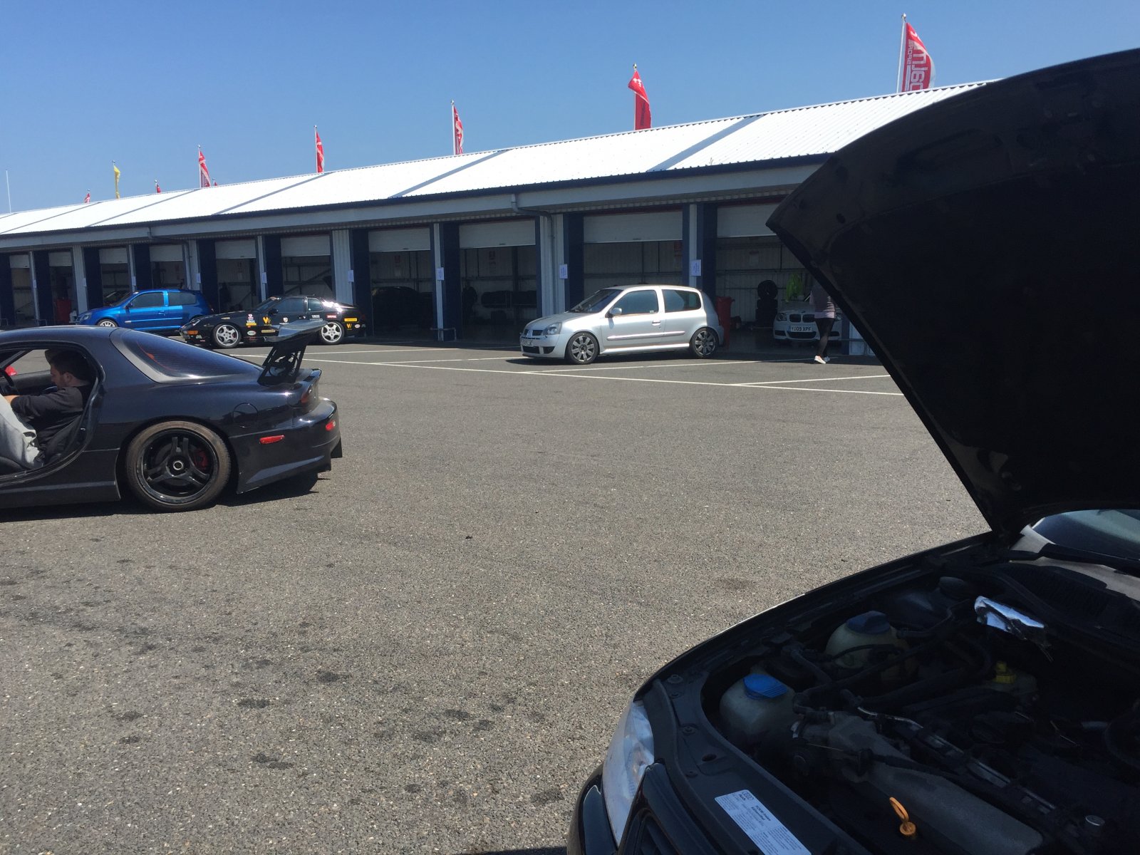

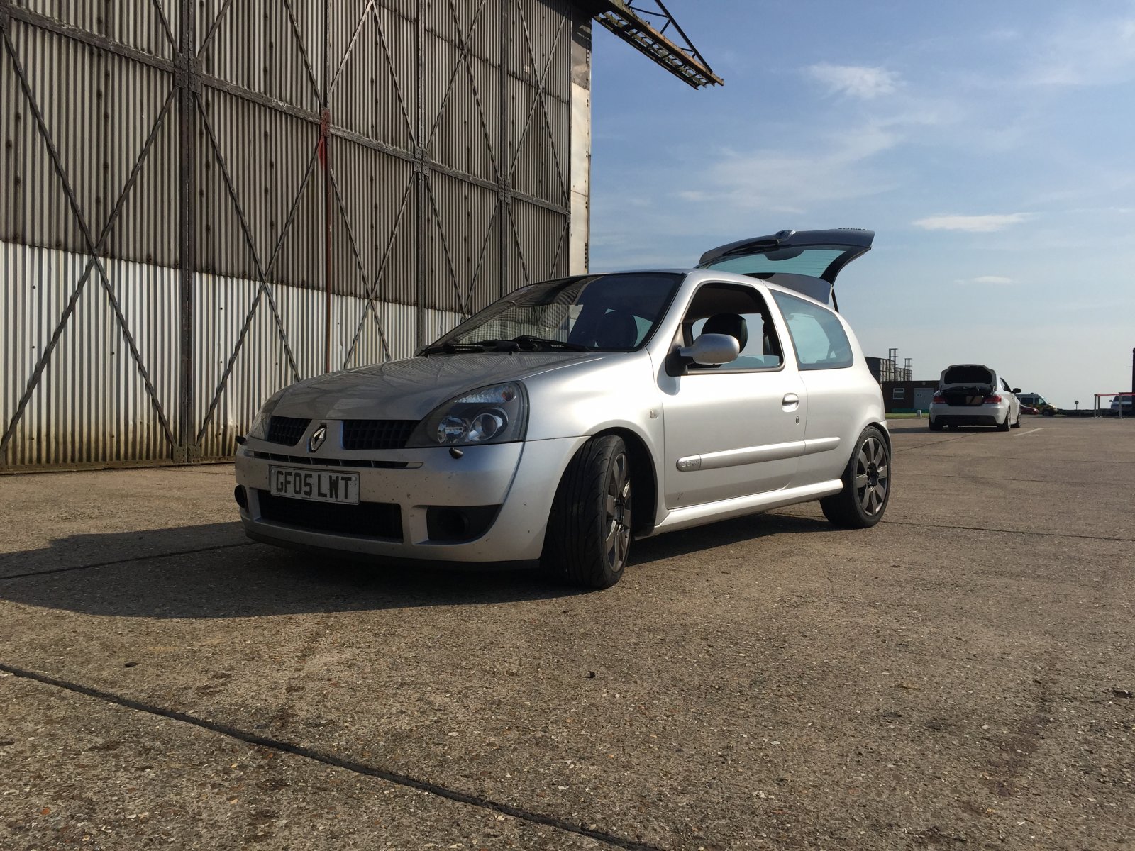

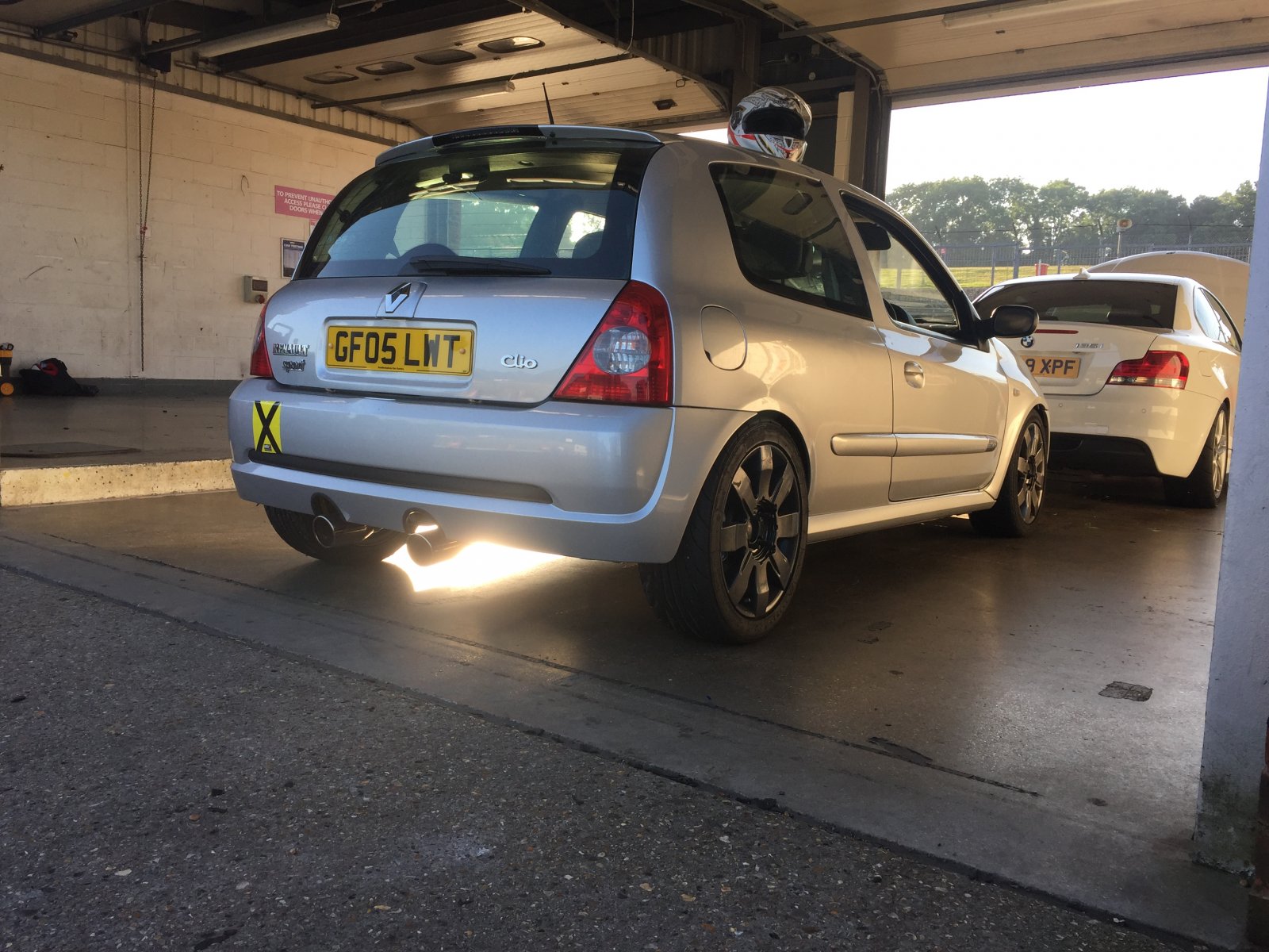

With this all installed/changed I attended my first track day (with this car) at Bedford 21st March. Picking the car up two days before I wasn’t feeling confident. In hindsight I should have put the day off. When I picked the car up the car drove terribly. I knew it would be bad on the road due to the hard spring rate but when came out of corners the car would sometimes pull in different directions. Also I had had the cambelt, dephaser etc. replaced and the engine didn’t feel the same…….. As I hadn’t really used the car I had no comparison so undeterred we set off to Bedford. After the induction and sighting laps my confidence with the car was low but felt a few cautious laps were need to work out what was going on. So on the first ‘fast’ lap and after a few corners to allow the car to warm up I put my foot down coming out of the hairpin at the end of the two back straights and……………………………………….. bang! The engine died . To abbreviate what happen next the car got recovered off of the track and then home.

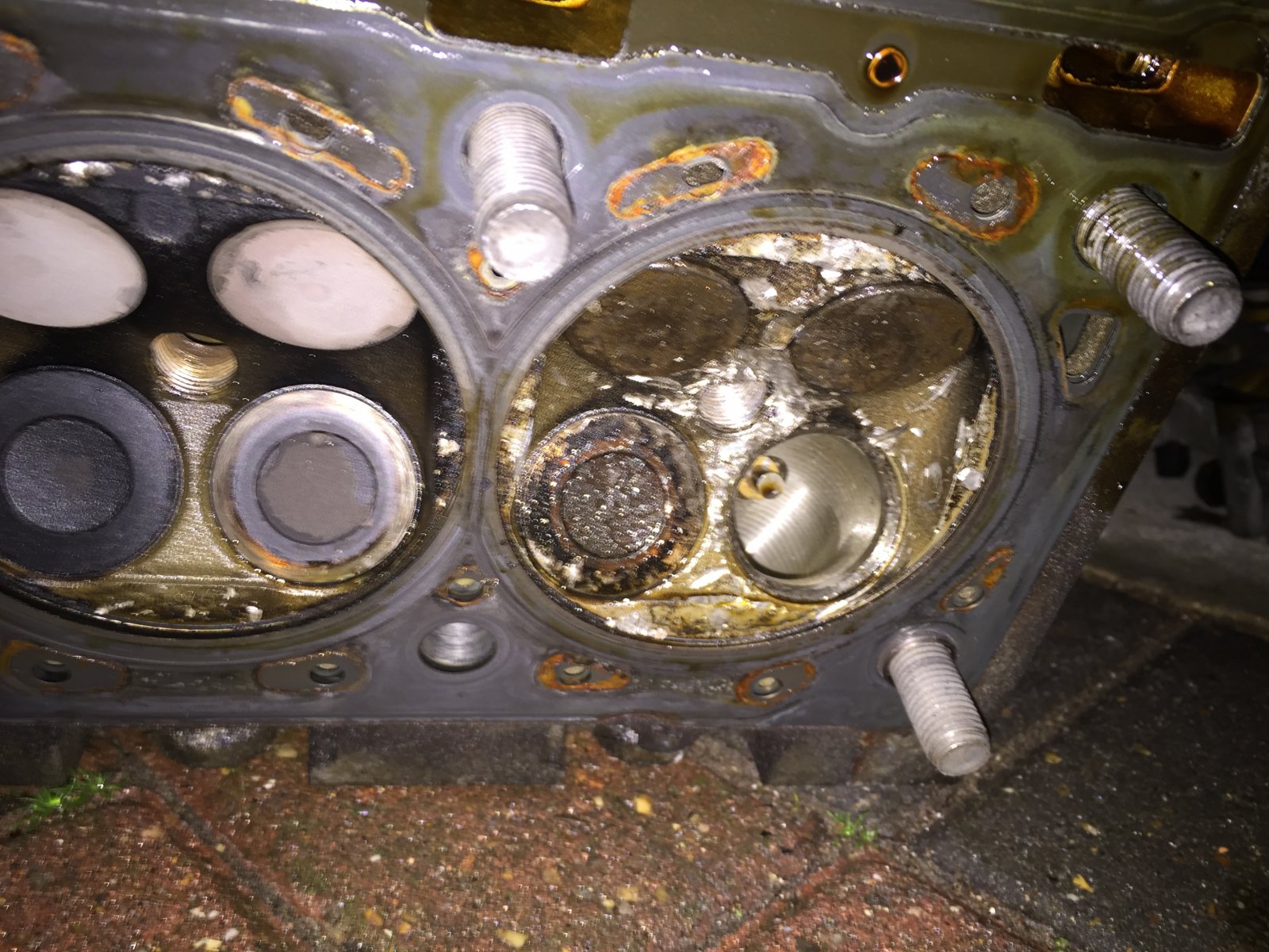

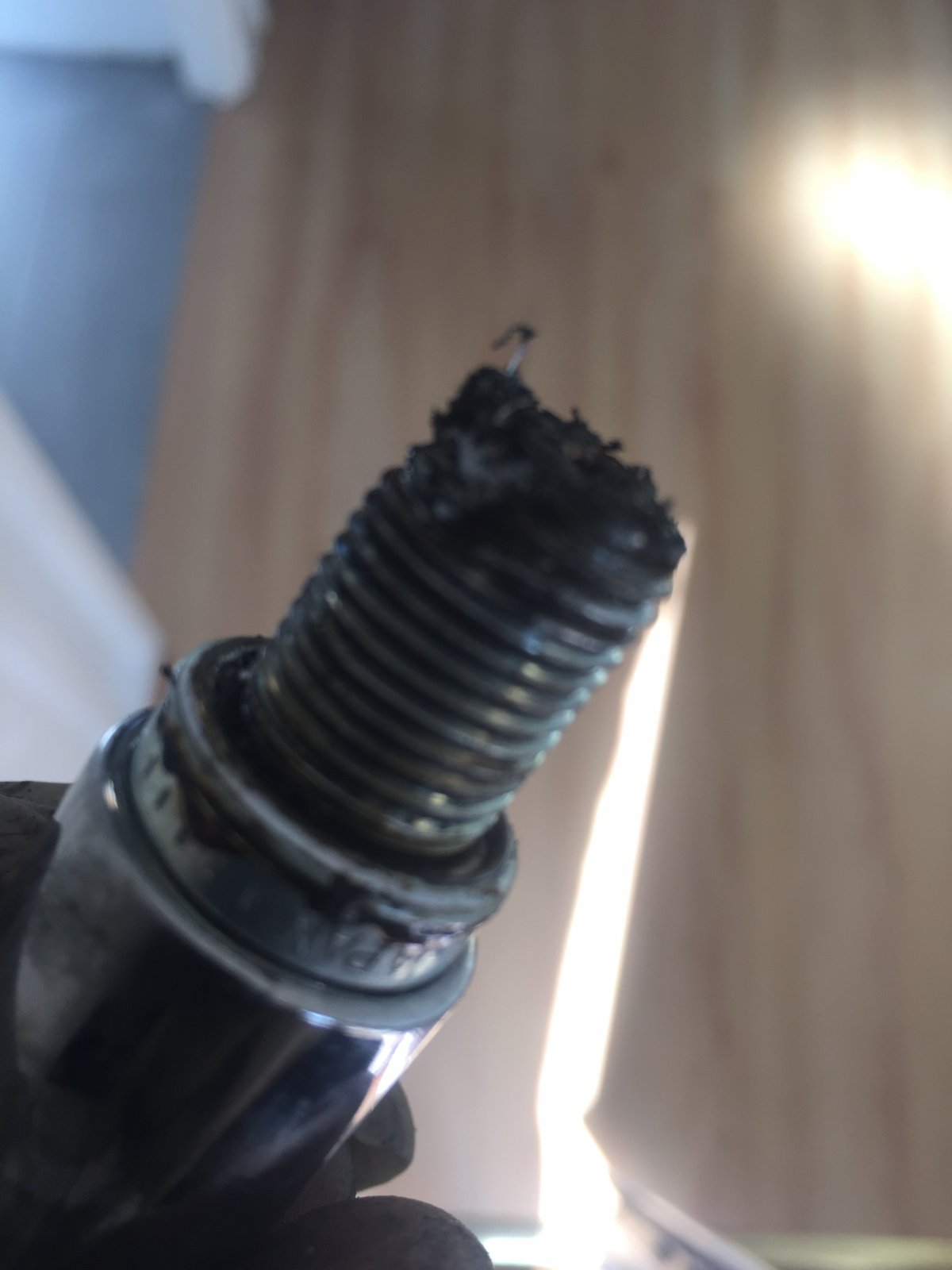

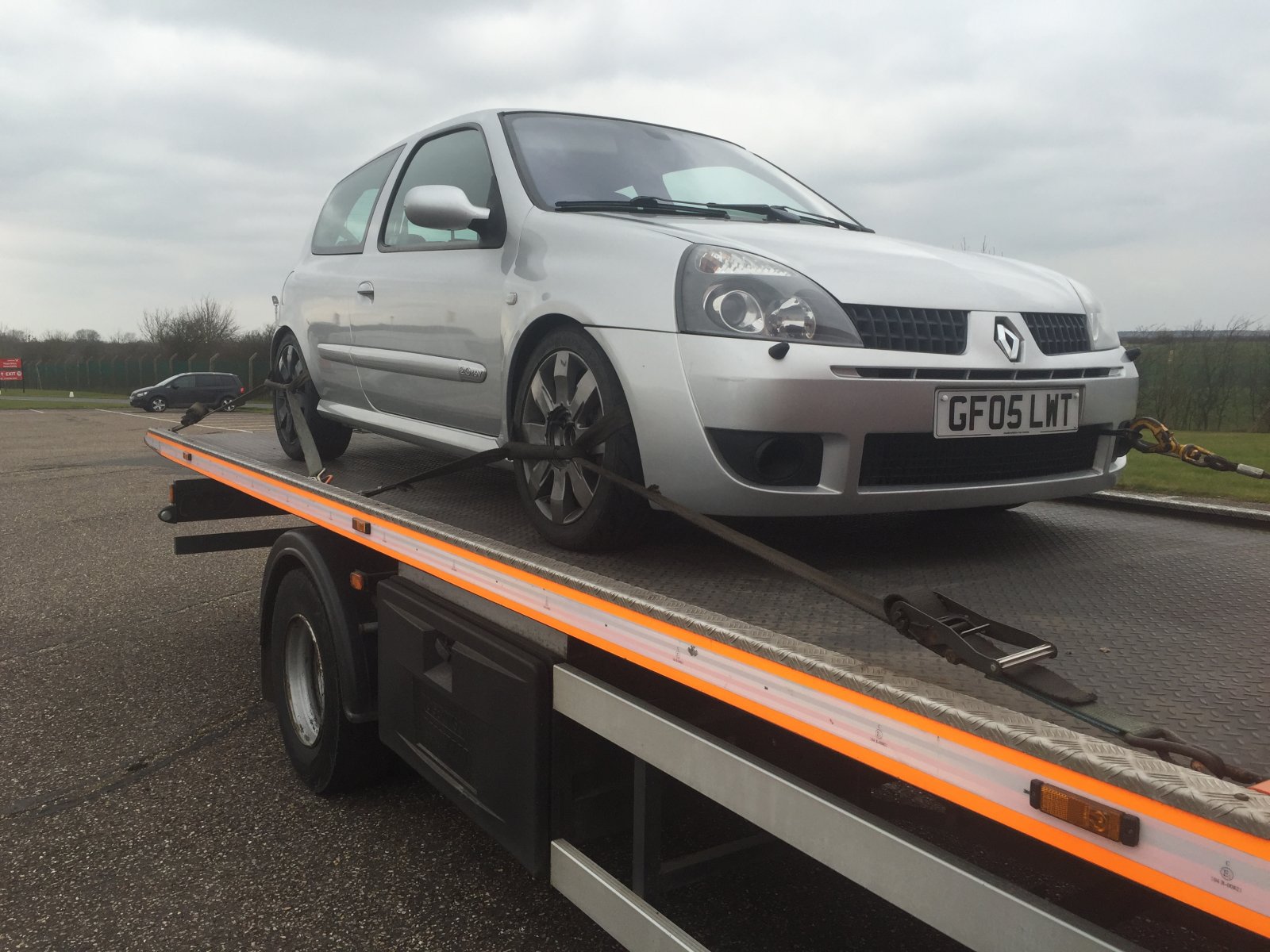

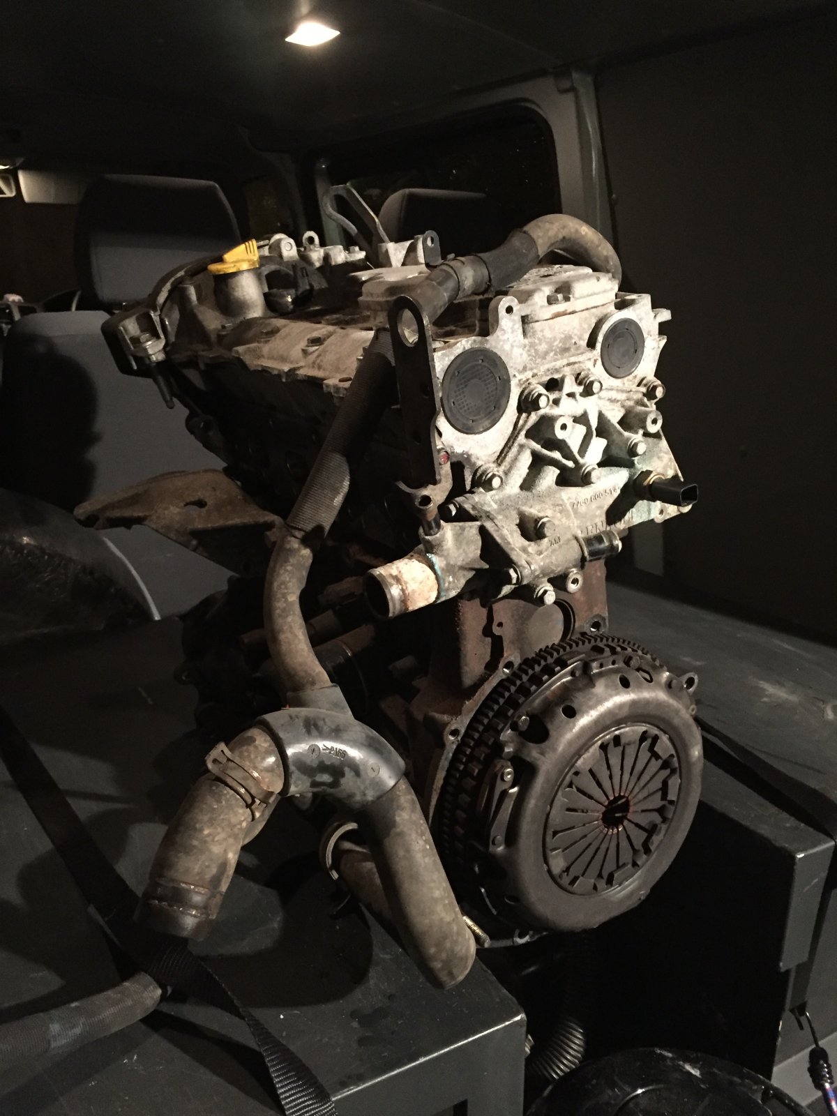

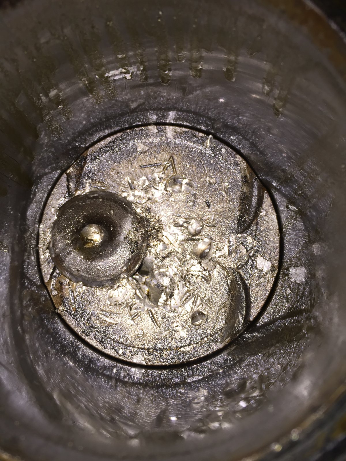

A few days later it was taken to the mechanics where it gets looked after we found that the engine had dropped a valve.
Nightmare as I already had a Ring trip booked 4 weeks later. I’ve had time to brood over what happened and I’m pretty confident the valve time was wrong when I had the cambelt changed.
So I needed a new engine fast! I found one for £350 from a crashed Clio at a breakers with similar mileage that had had the cambelt, dephaser etc. changed within 12 months (all the receipts to prove). So I went to pick it up. This was installed and due to timings etc. I picked the car up 2 days before we set off on a 400-mile journey to the Ring. To say I was apprehensive was an understatement.

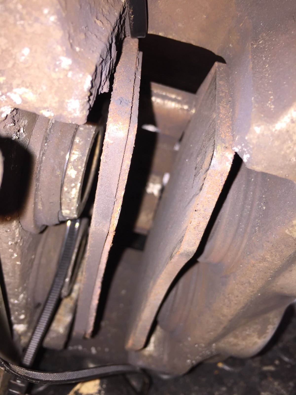

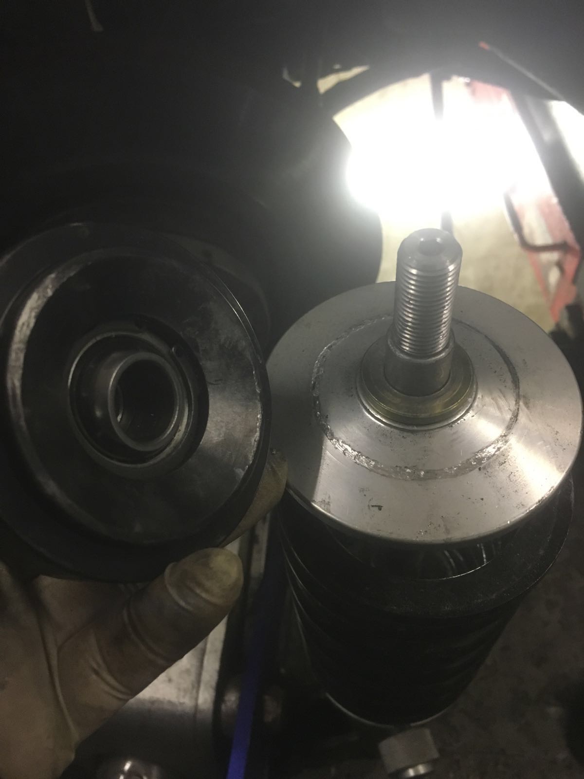

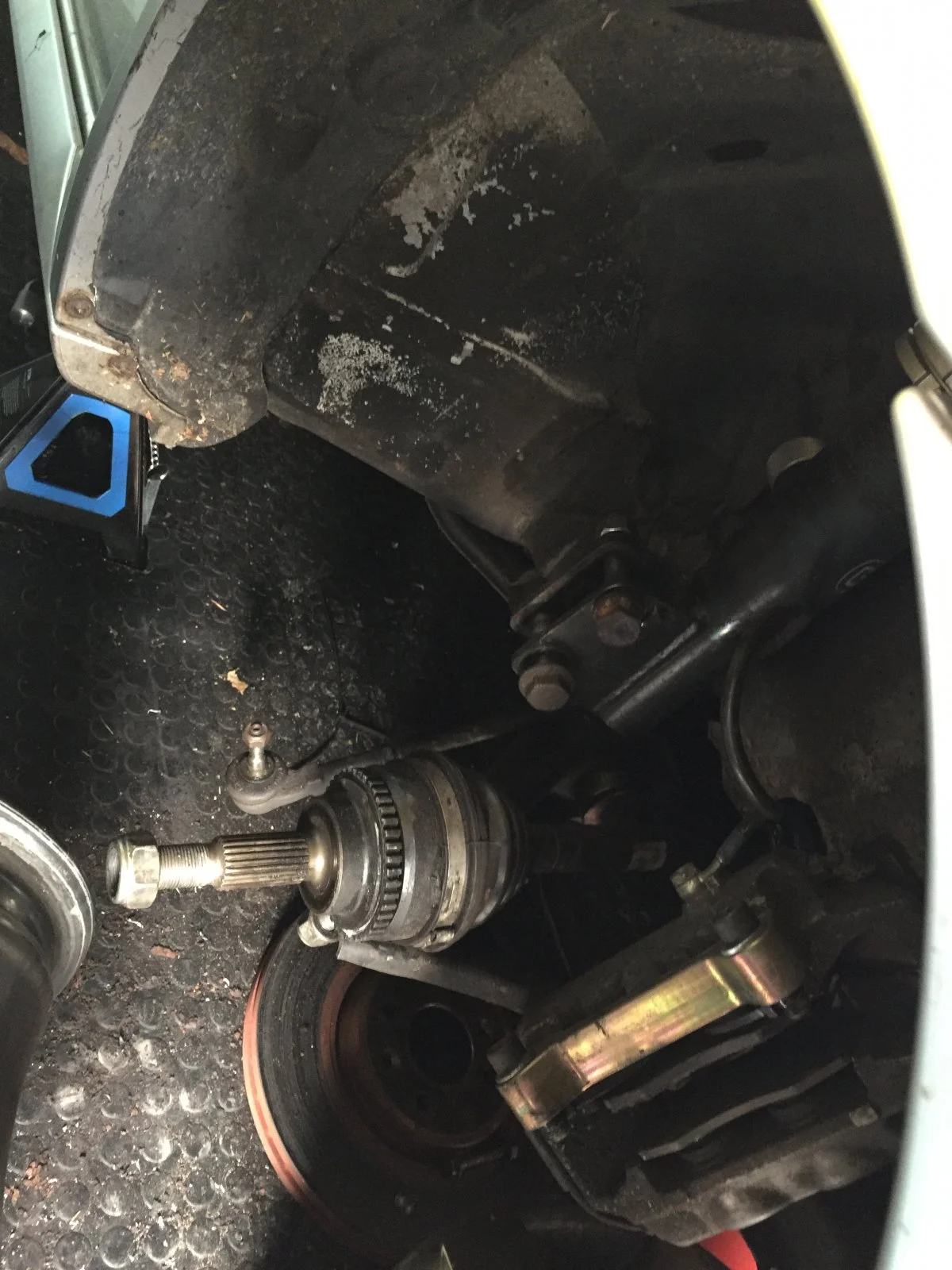

On returning home I knew there was something fundamentally wrong with the steering. To cut another long story short the issue with the steering was the top mount and top of the coil over had become one so the strut was moving as it should on the bearing. Strange as the coilovers and solid top mounts both came from Gaz. I took this opportunity to upgrade again so got rid of the Gaz top mounts and had the PMS top mount and strut brace. At the same time the I had the camber adjusting poly flex lower arm bushes installed.

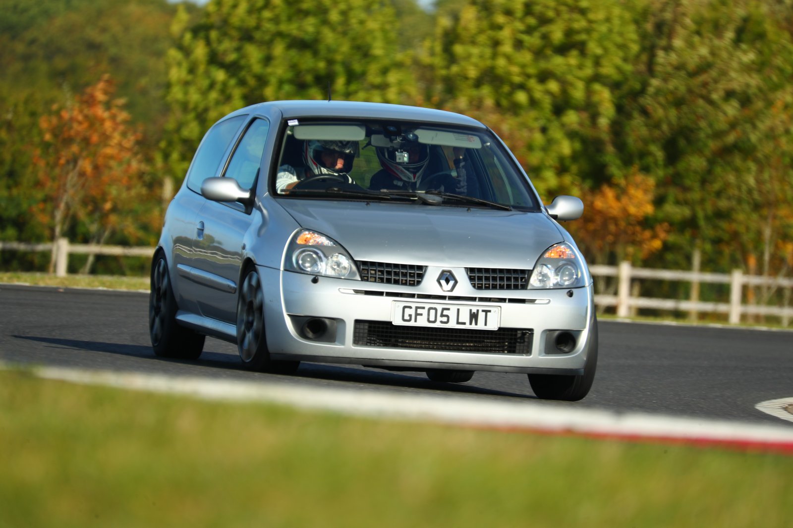

A few weeks later and we went back to Bedford for another track day. OMG what a difference! From that day onwards I’ve been so happy with the Clio and have already become very attached to it! The weather was brilliant. The car was faultless. The handling is in a different league to what I had become us to.
This session was so much fun-

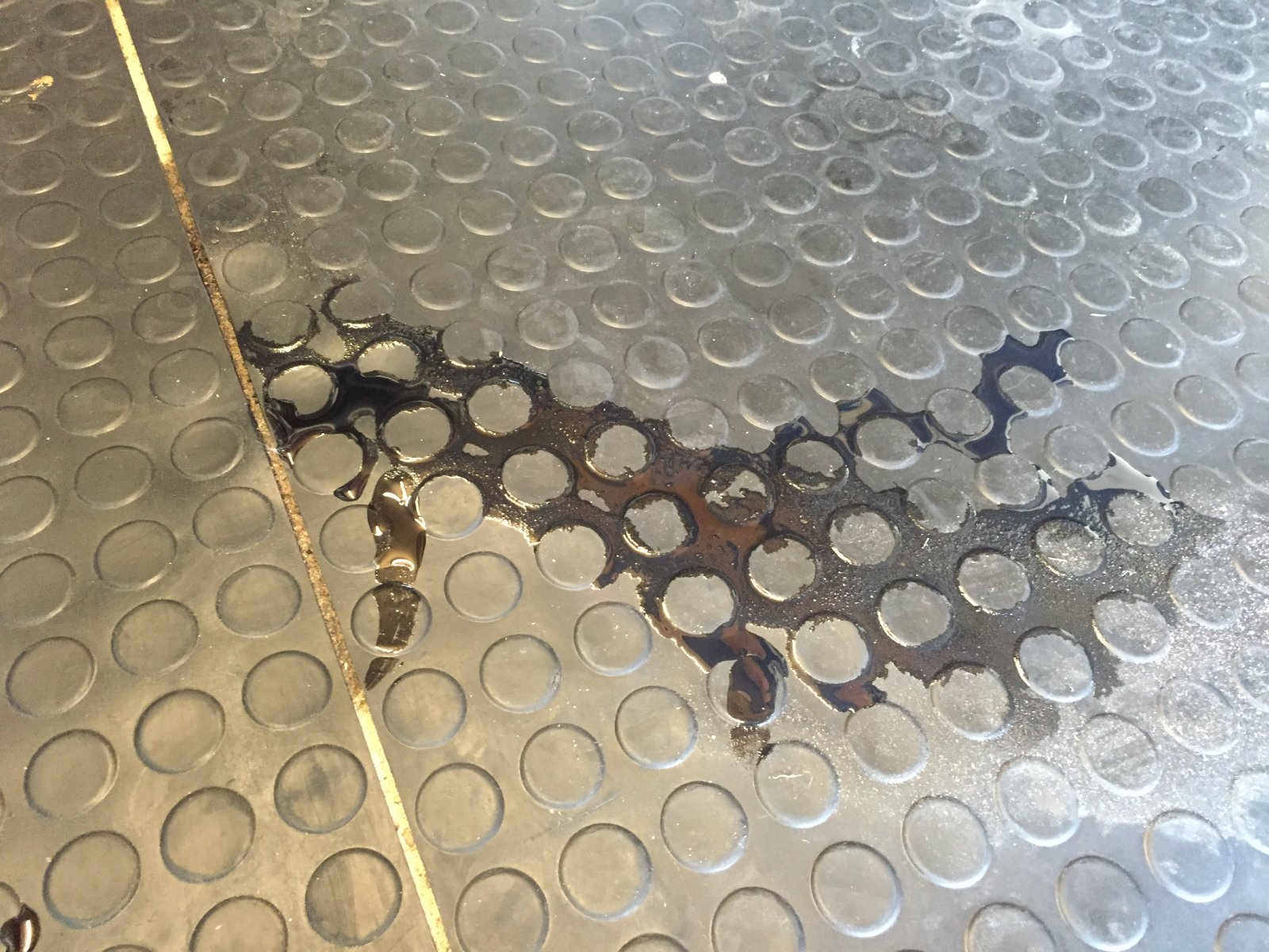

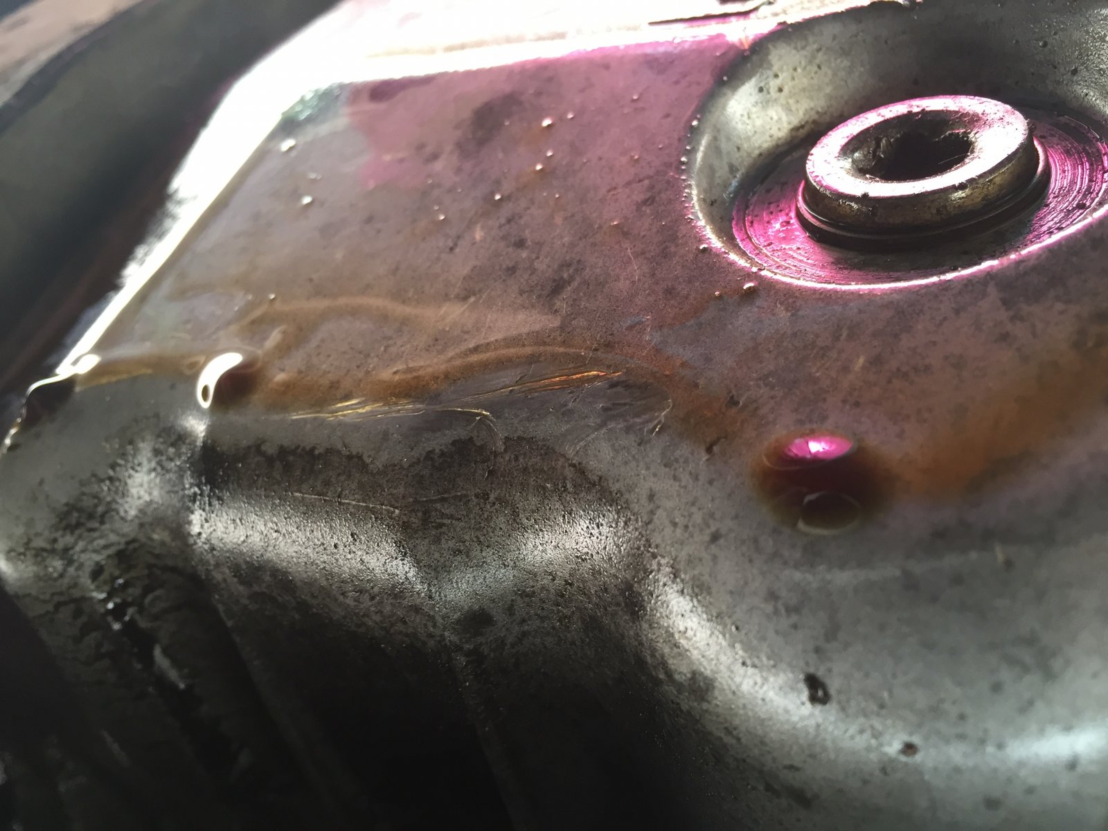

The MOT was due and I had started to notice an increasing amount of oil was being dropped in the garage at home. The car failed the MOT on a lower suspension ball joint so whilst I had this changed I had the oil leak fixed. Turns out it was the sump leaking from an old repair?! Luckily I had kept the old engine so had the other sump to swap over.

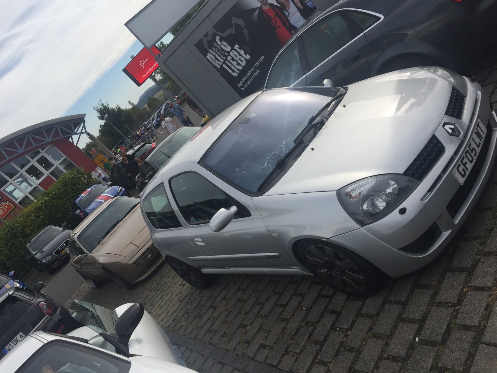

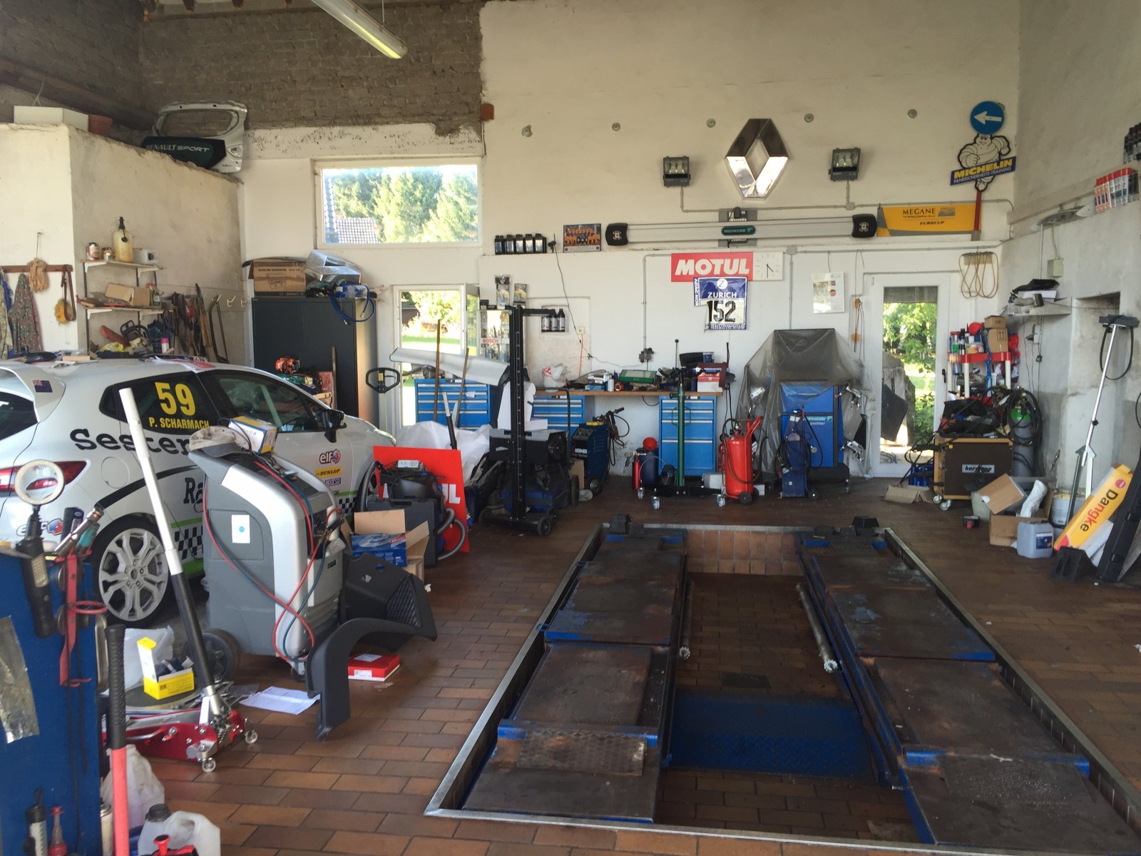

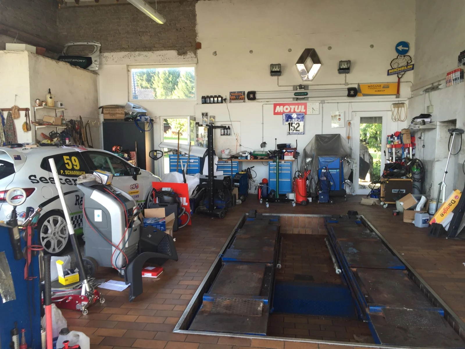

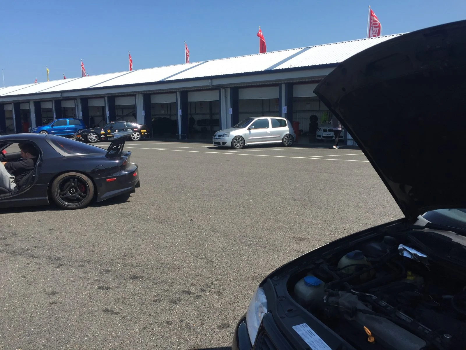

Filled with confidence we set off in early September set off for our second trip to the ring. The journey was uneventful until we got close to the destination when I noticed the rear of the car was grinding. I knew the rear wheel bearings were on their way out but to fail in Germany! After a heavy night on the beer we manage to arrange for the bearings to be replaced at this place.
We stay at the Ringhaus and this guy races a Clio with them. It was like Clio heaven and I recommend them to anyone who gets in trouble over there. The track opened at 17.00 and the Clio was back in time to knock out a couple of laps before crashes forced an early finish to track time. Remember last time I went the steering was all over the place. Already confidence was double what it was before! So with that in mind I was up on time and on the track at 08.00 the following morning! The following two days were great with the car. My time was some 30 seconds faster than last time and the car was faultless (another 12+ laps were achieved).
Fastest lap was this one -
We did have an off due to oil on the track.
I think we were lucky compared to the others
The car made it home and ready to go for the next outing.

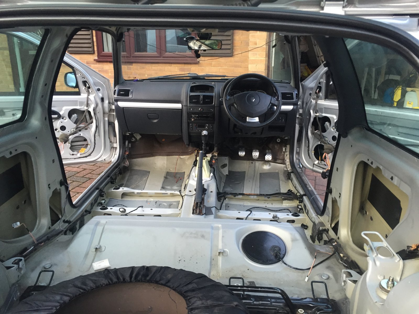

So the weight loss has begun! Finally have had time to start this as work has become a bit crazy recently but I'm determined to have the car ready for early next year ready to use it as much as possible. So all the interior is out (and for sale!). I want to strip all the sound deadening and then paint in a gunmetal grey colour. I have also paid a deposited to Mark Fish for a full safety devices roll cage (option 4) but I'm waiting for the newer cage that will go through the dash so haven't got a confirmed fitment date as of yet.

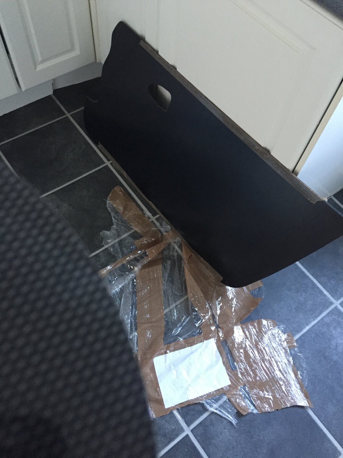

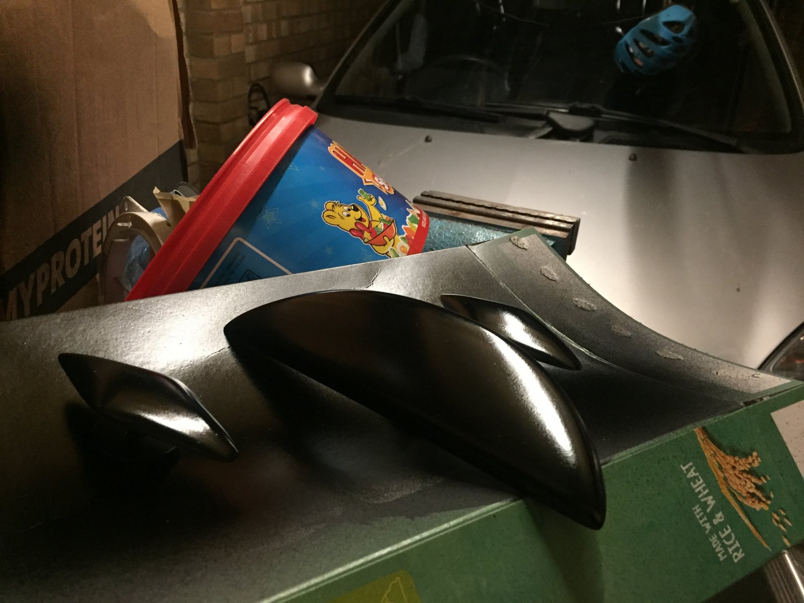

The door cards have arrived. I went for a full set of carbon effect ABS
I also have the rear wiper delete blank and headlamp washer blanks that I have painted satin black
Worrying the car looks terrible at the moment but I hope it wont be long until bits start going in and it should start looking better...........I hope:monkey:

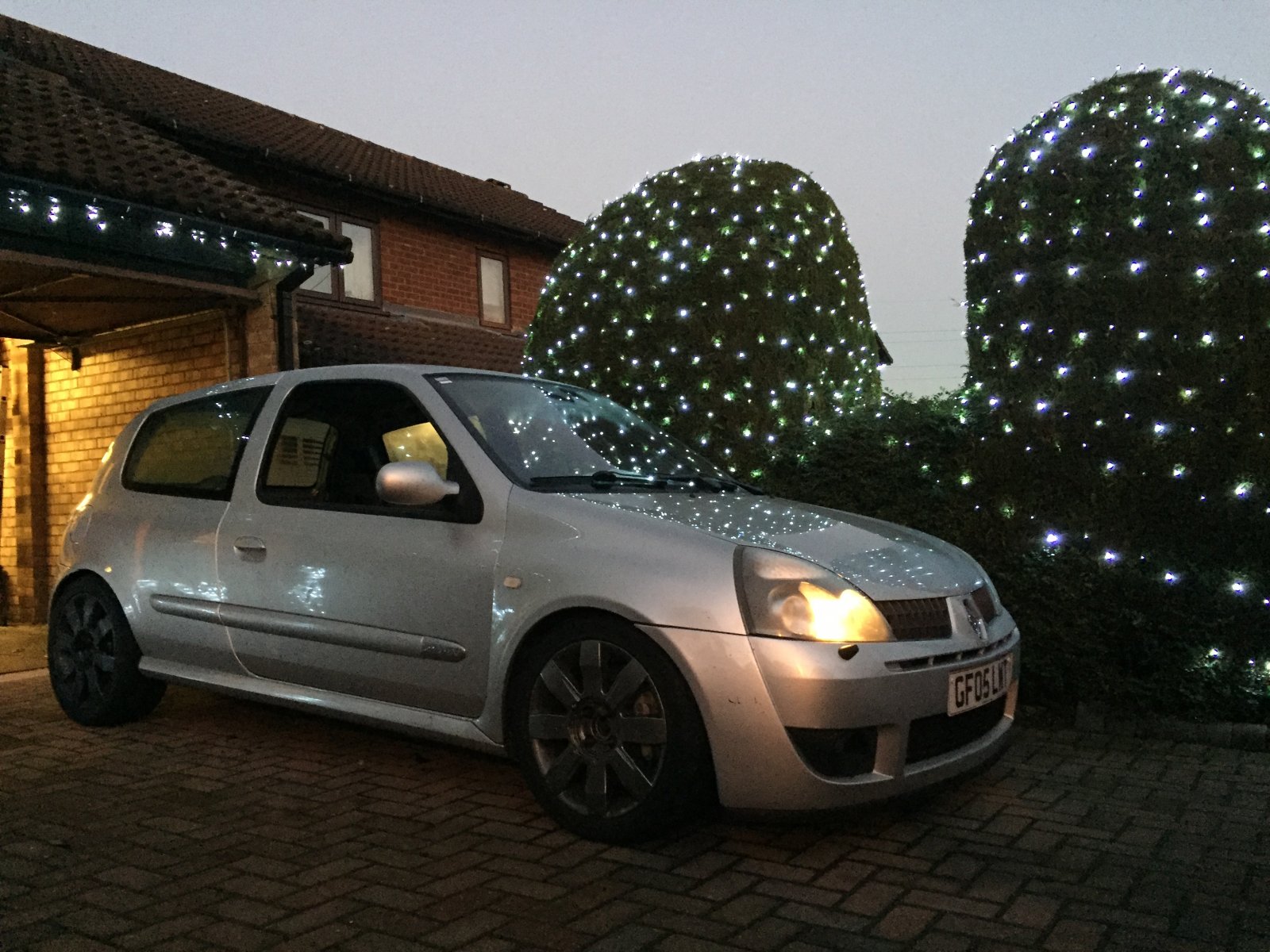

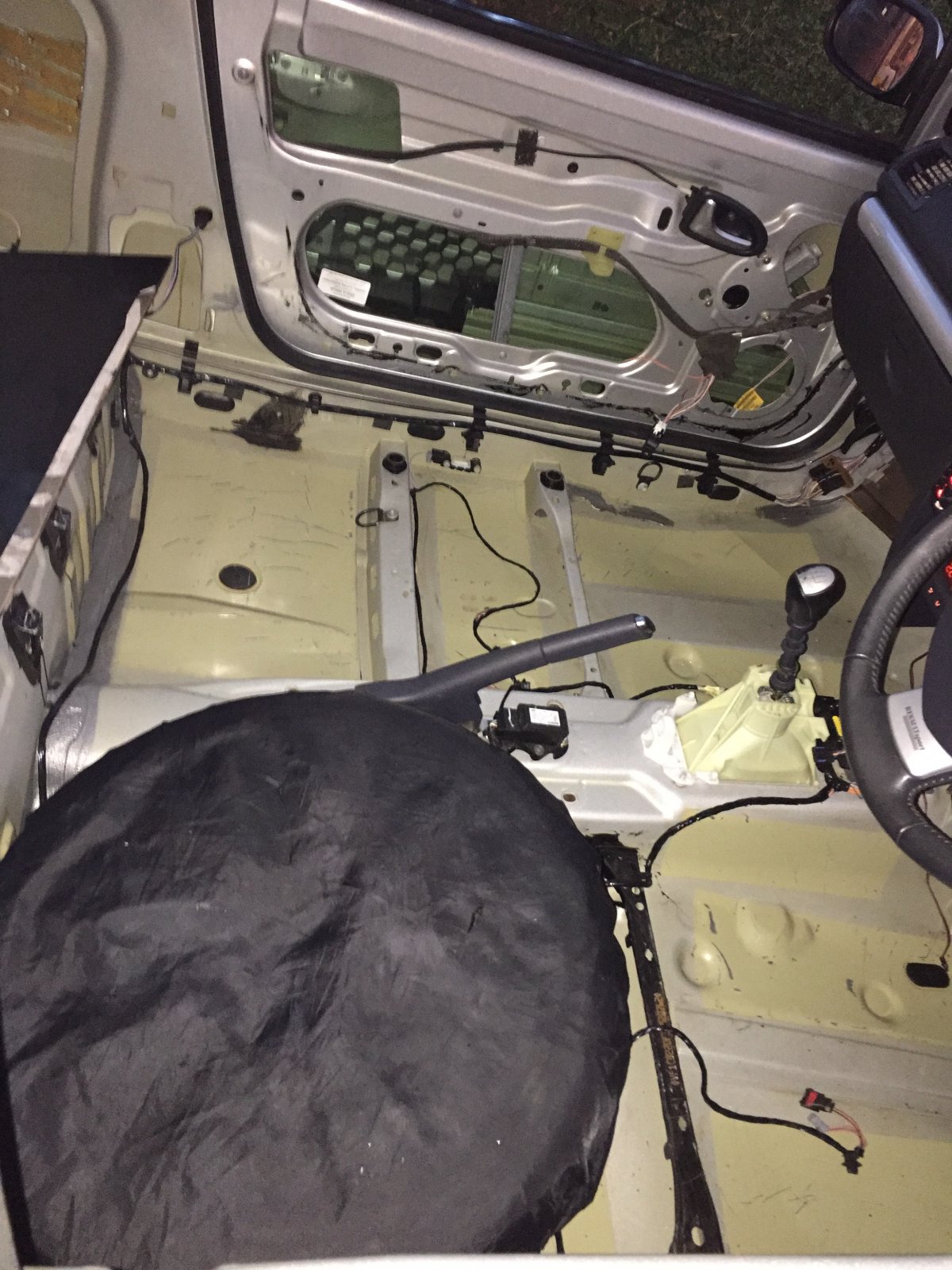

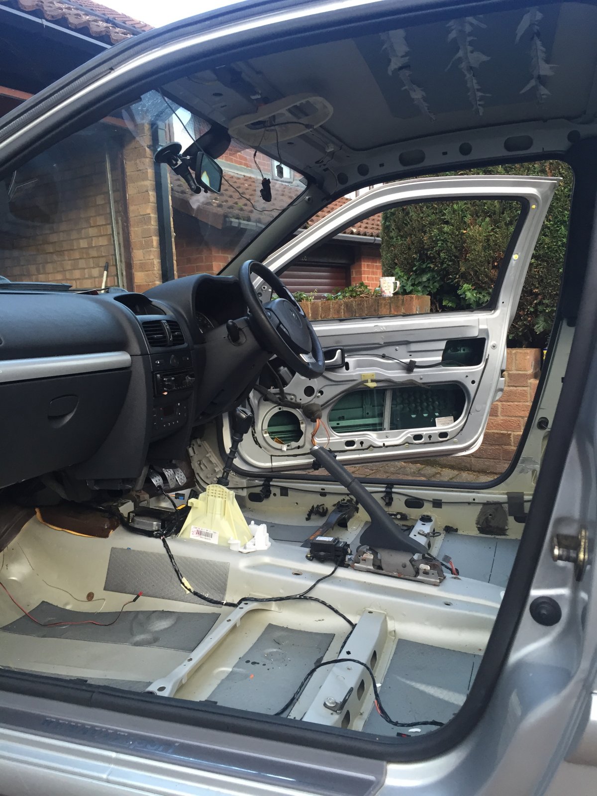

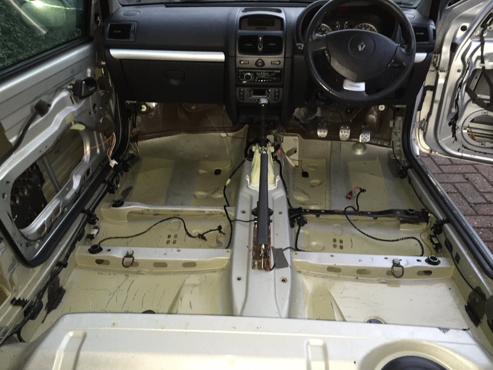

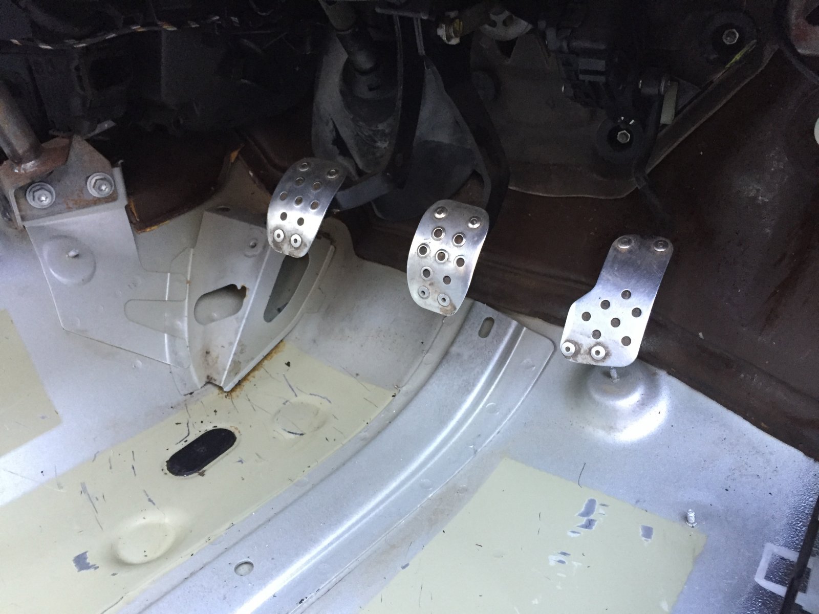

Result, all of the sound deadening is now out! Possibly one of the most dullest things I have ever done but its finished now! Pretty impressed with the weight of the two carrier bags that was removed. When I get time I will get it painted before it goes for the cage to be fitted at the end of March. I'm ordering the seats, harnesses and steering wheel tomorrow so hope it starts to resemble a car again before long :smile:
As it hadn't been out of the garage for over a month I took a Christmas photo.....
Hyperhatch
  182
What did you use to get the tar of so well??
I used a heat gun and a scrapper to get the big bits off. Then some Tar and Glue remover to get the sticky glue that was left. After doing the first section I worked out if I splashed a bit around on the next area and waited 10-15 minutes it came off some much easier! I also used the vacuum to get all the loose bobbles away from the area as you can spend a lot of time moving the glue bobbles from one place to another. Its not fun:smirk:

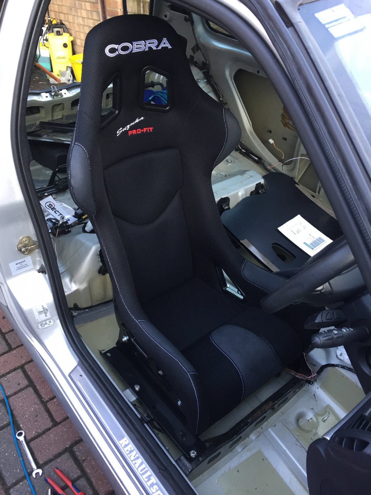

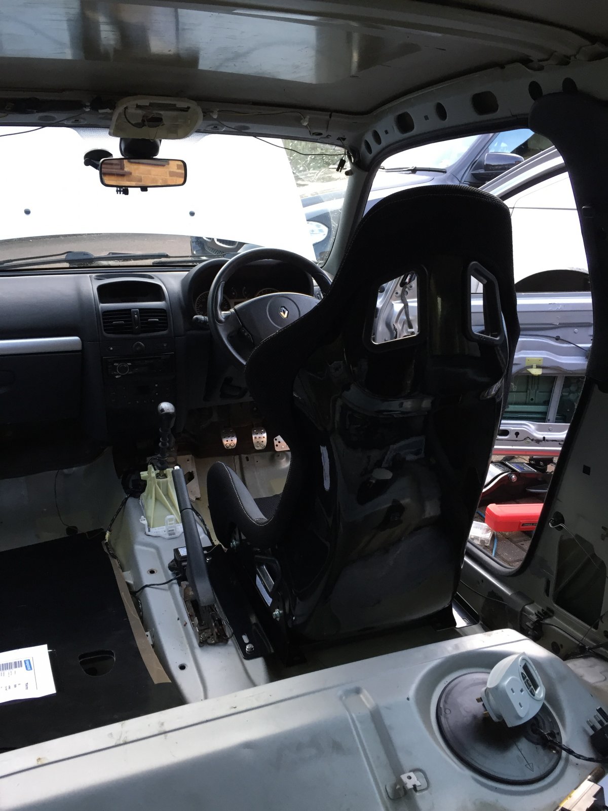

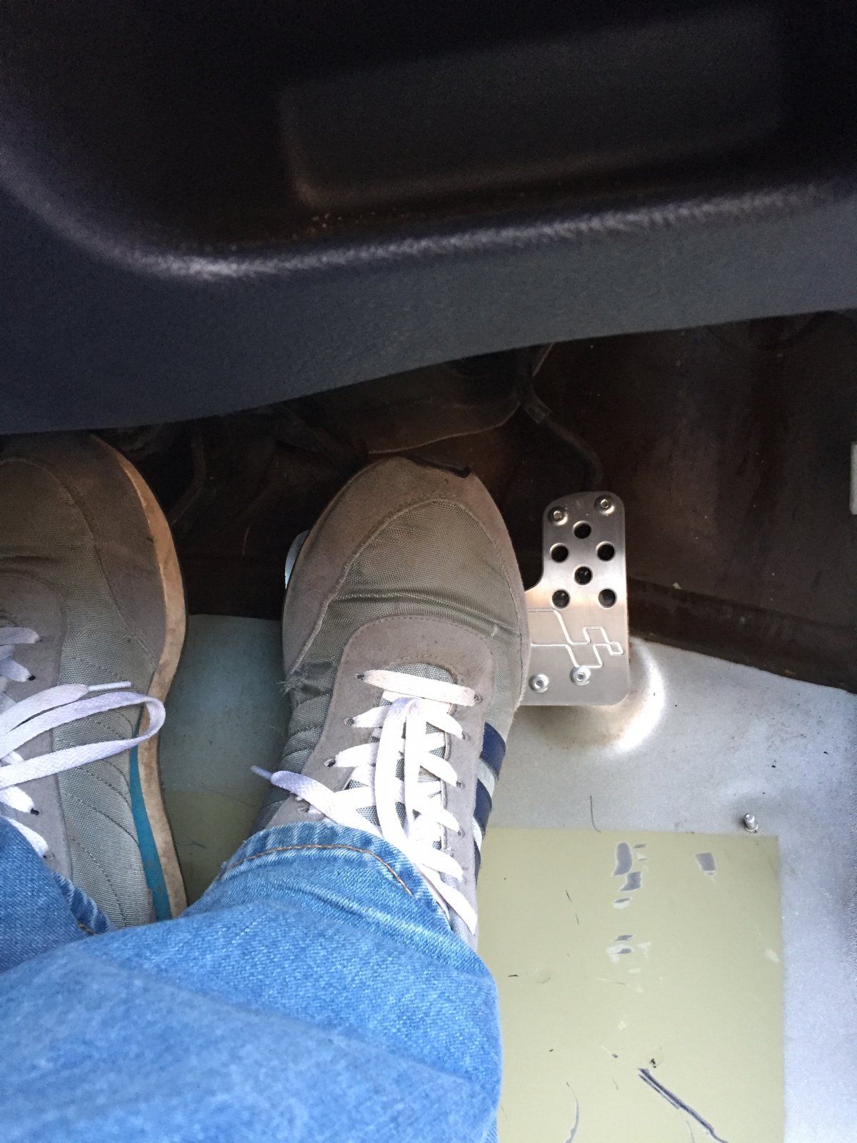

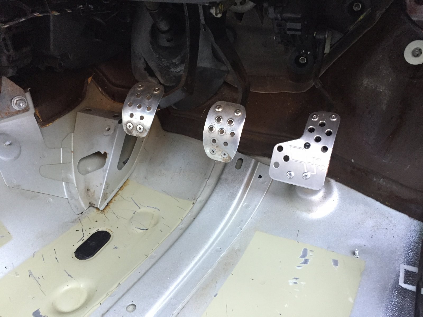

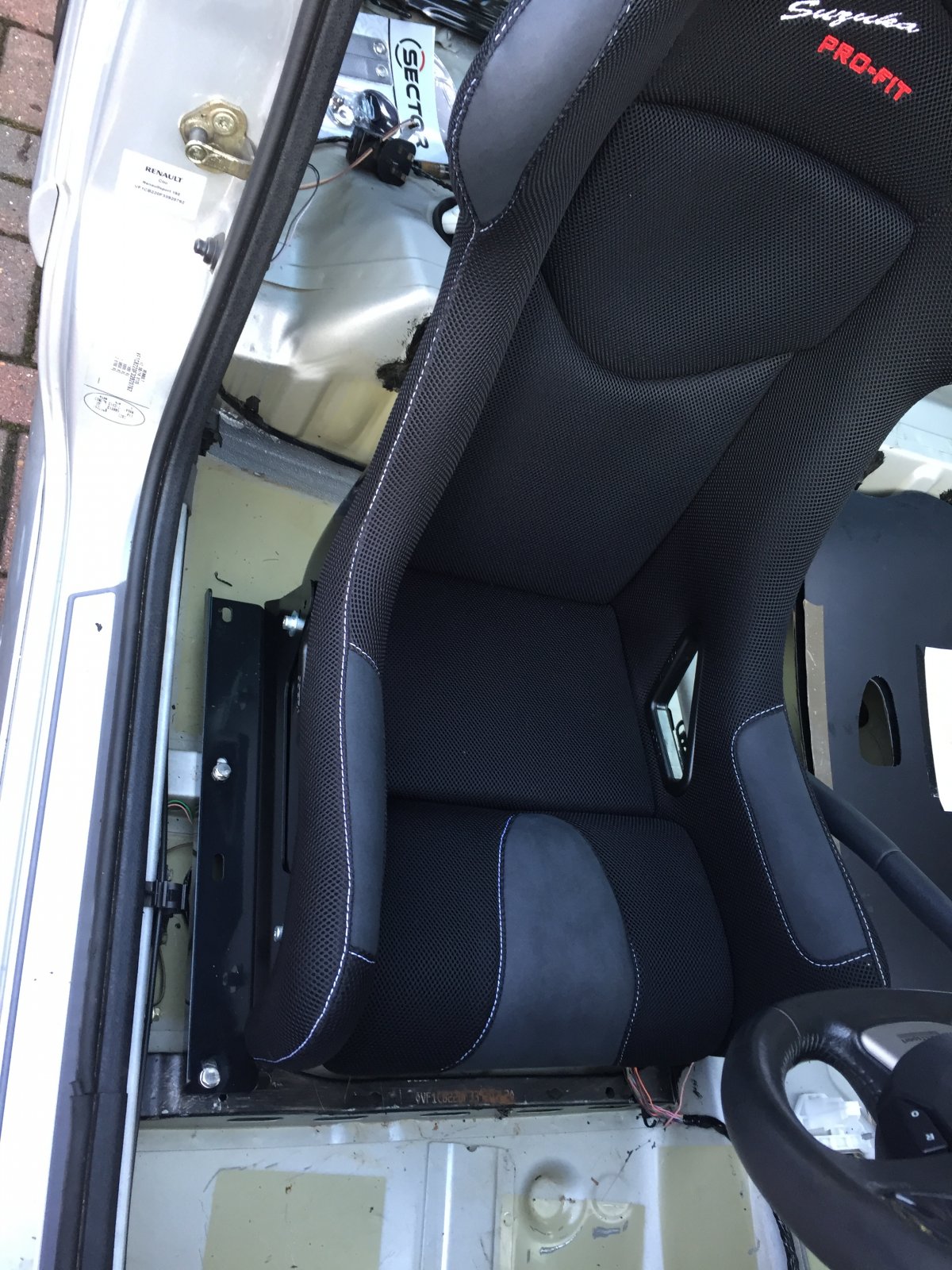

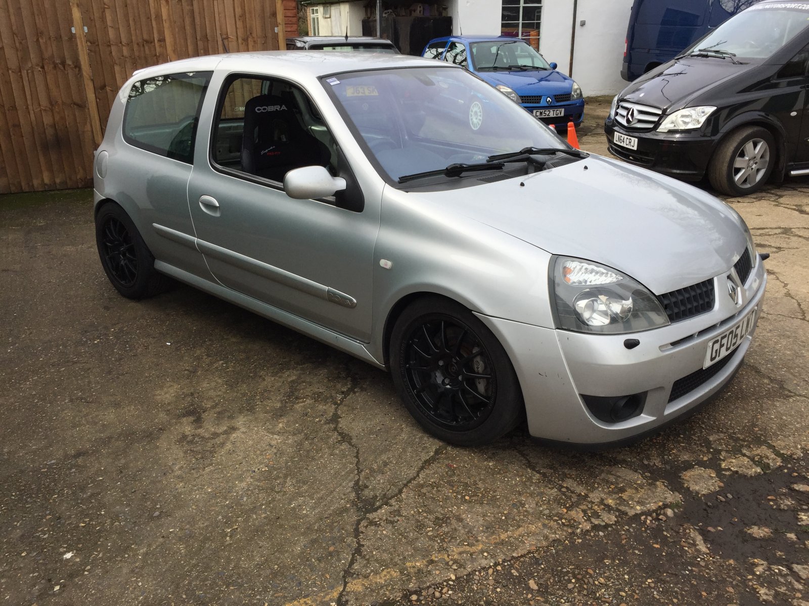

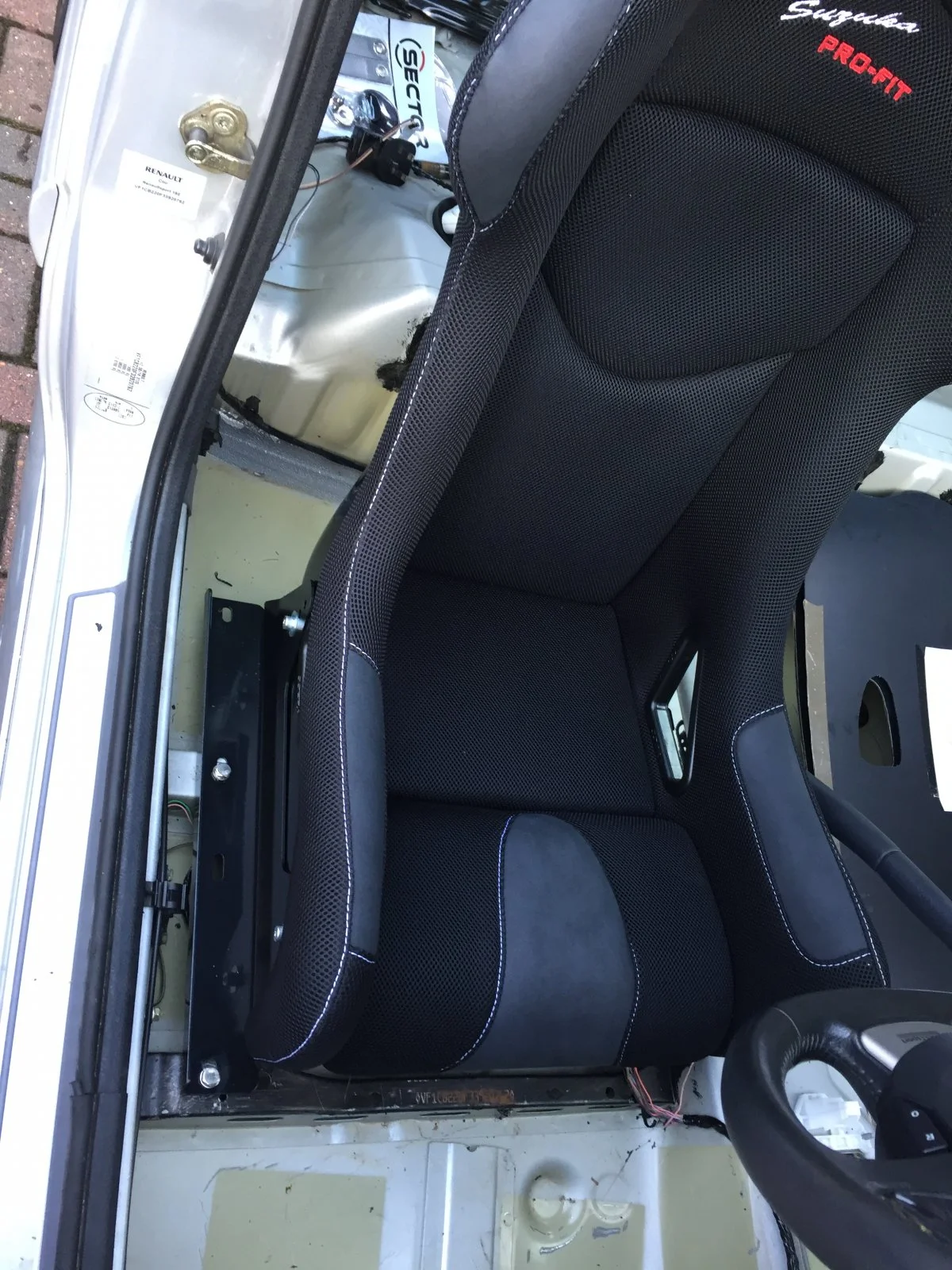

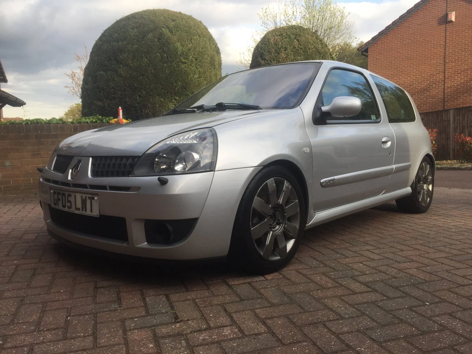

At last bits are starting to go back in the car, but only temporary so I can drive the car to Mark Fish to have the roll cage fitted at the end of the month. I was going to paint the inside first but I think I will do that after now as I have lots of body panels coming so might get someone else to do it. First mod is so simple but should make a massive difference! The car now has a heal and toe accelerator peddle.
Best of all the car has a seat again which makes moving the car about so much easier :blush: I went for a Cobra Suzuka drivers seat and of course it had to be mounted to the Jon Foz super low mounting plate.

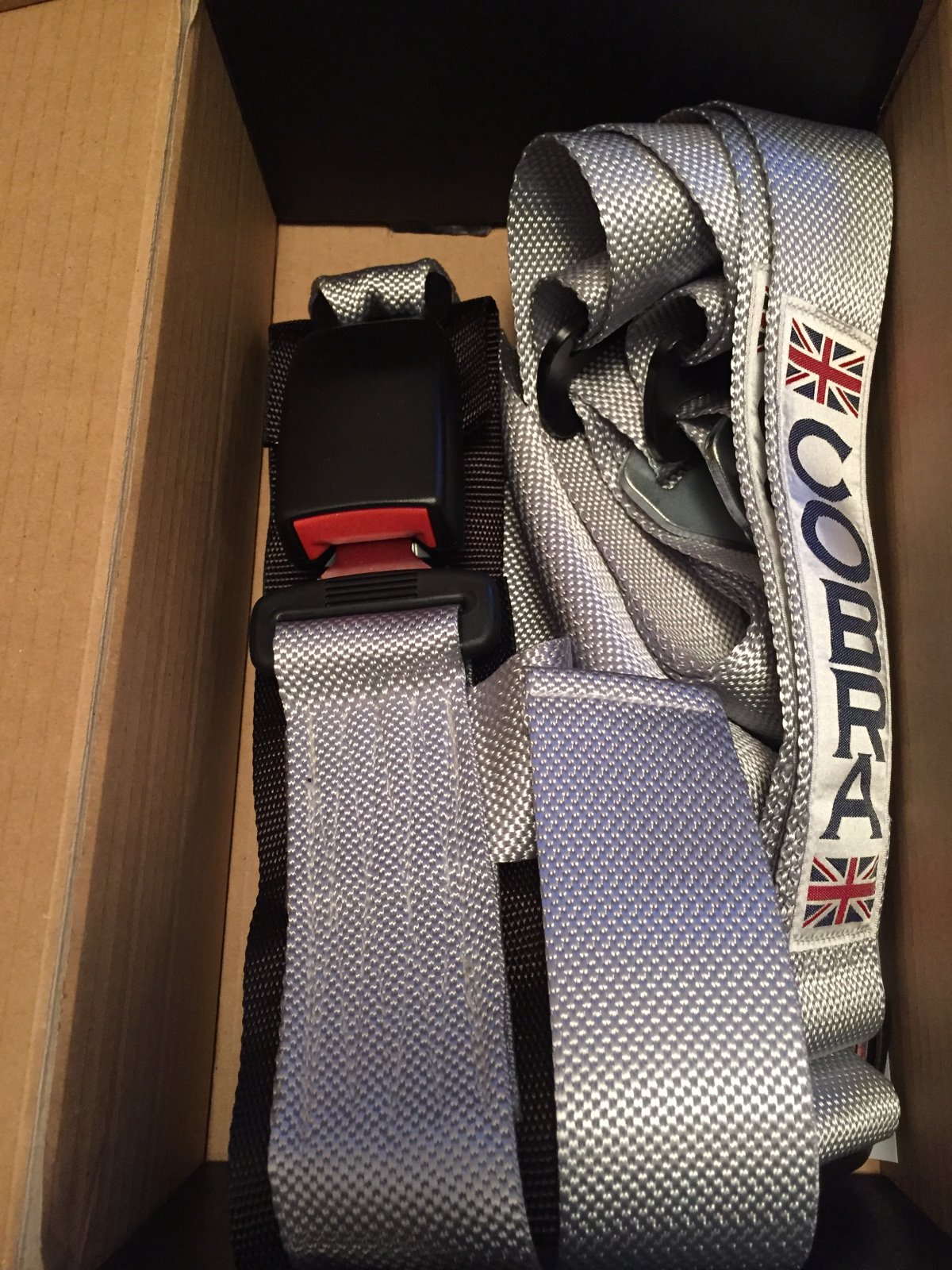

Definite improvement over the standard seat:sweatsmile:. I'm still waiting on the four point Cobra harnesses with standard road buckle (I want to still be able to keep the car road legal) to be delivered.
I will fit this when all the painting etc is finished......
I also have on order a full polycarbonate window set and fibreglass bonnet, boot, cup spoiler and roof scoop. So much for trying to keep the Clio looking standard :fearscream:
Next up the hubs are off to Northloop for some attention :smile:

I now have black power flex bushes but it hangs low as it's a bit dented and squashed in places. It came off of a rolled Clio! Only cost £100 so I can put up with it at the mement but might swap it out if the right one comes along at the right price.

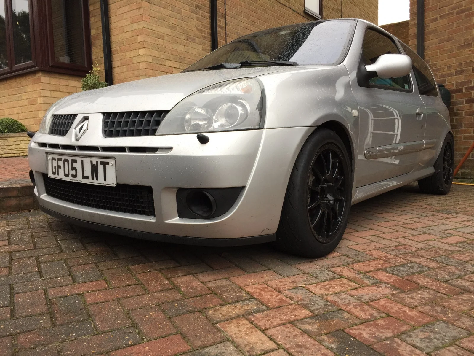

Hyperhatch
  182

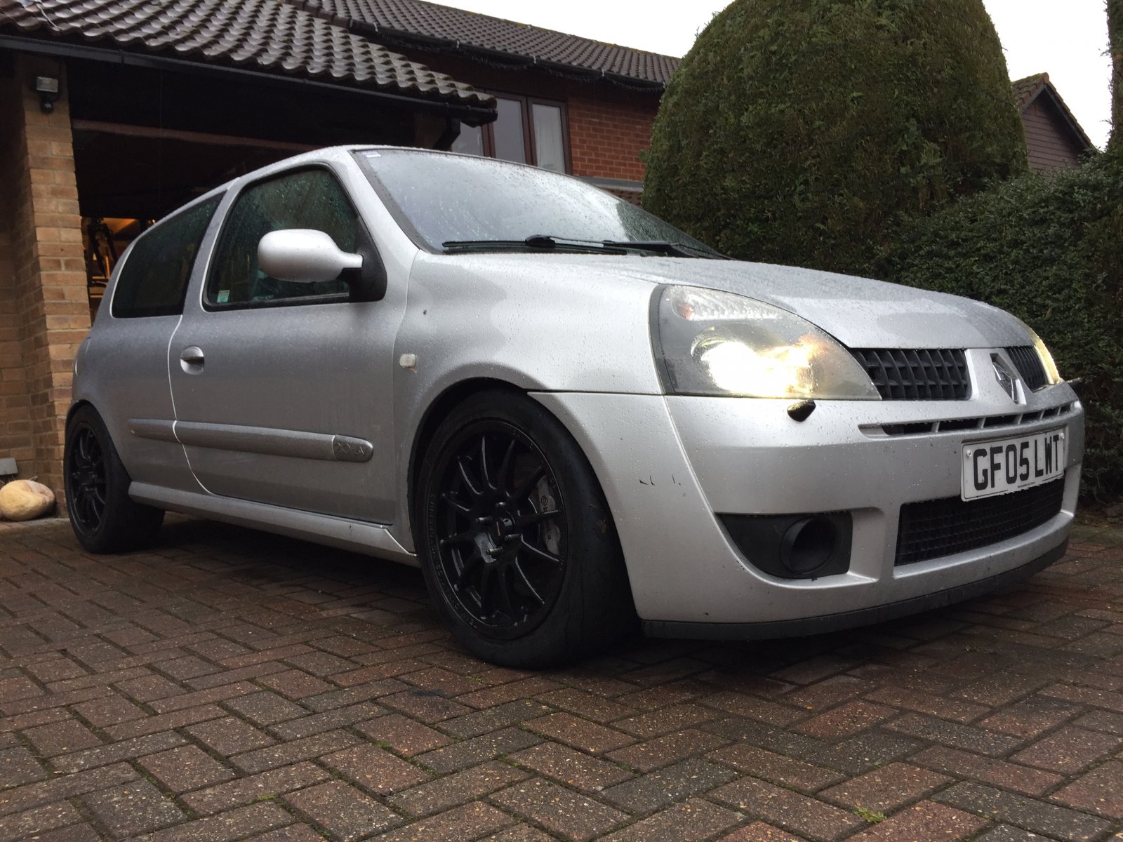

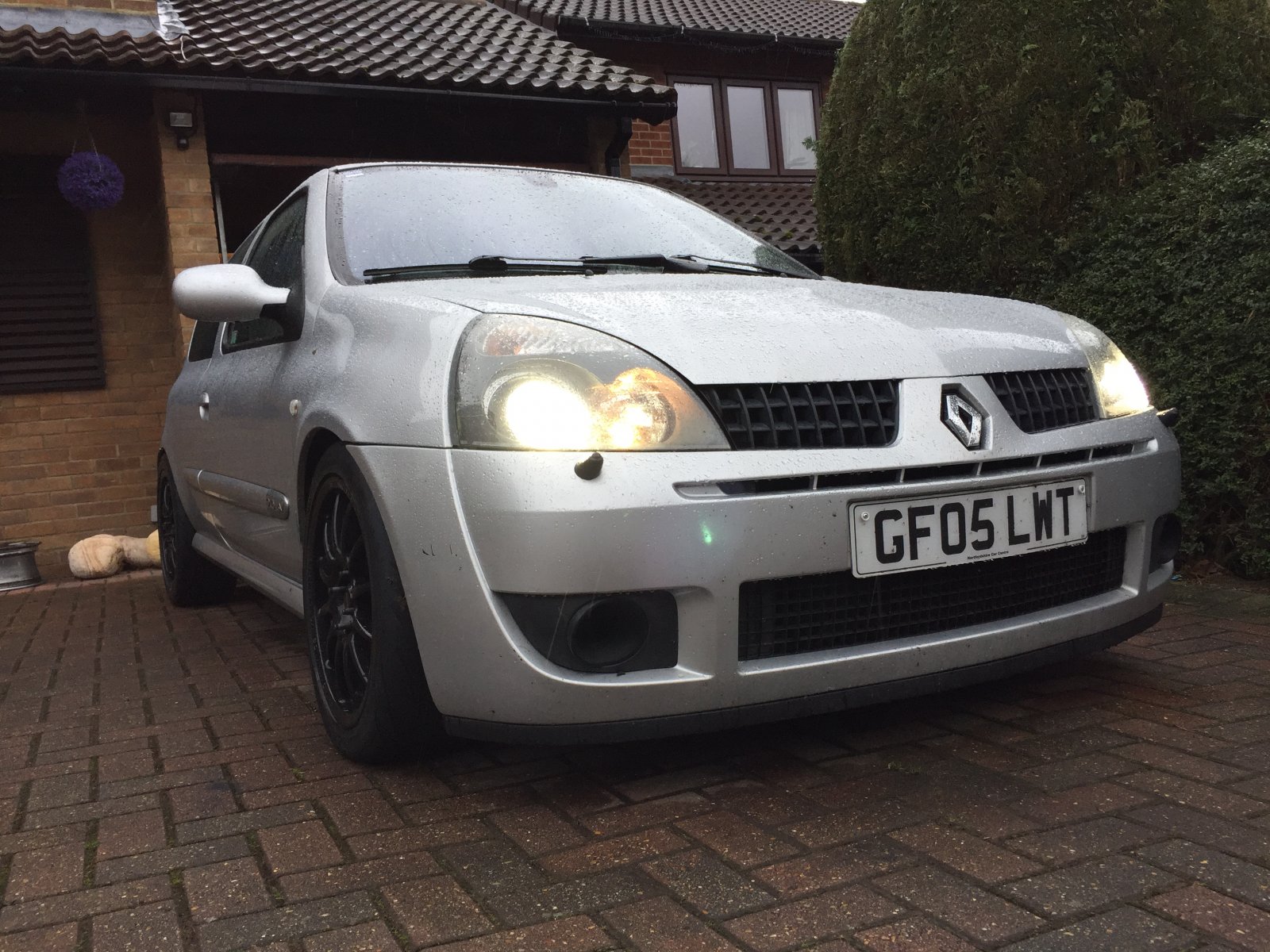

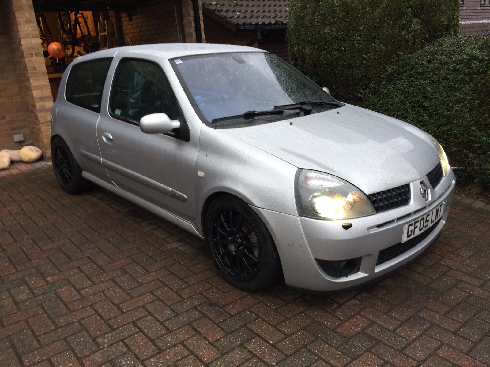

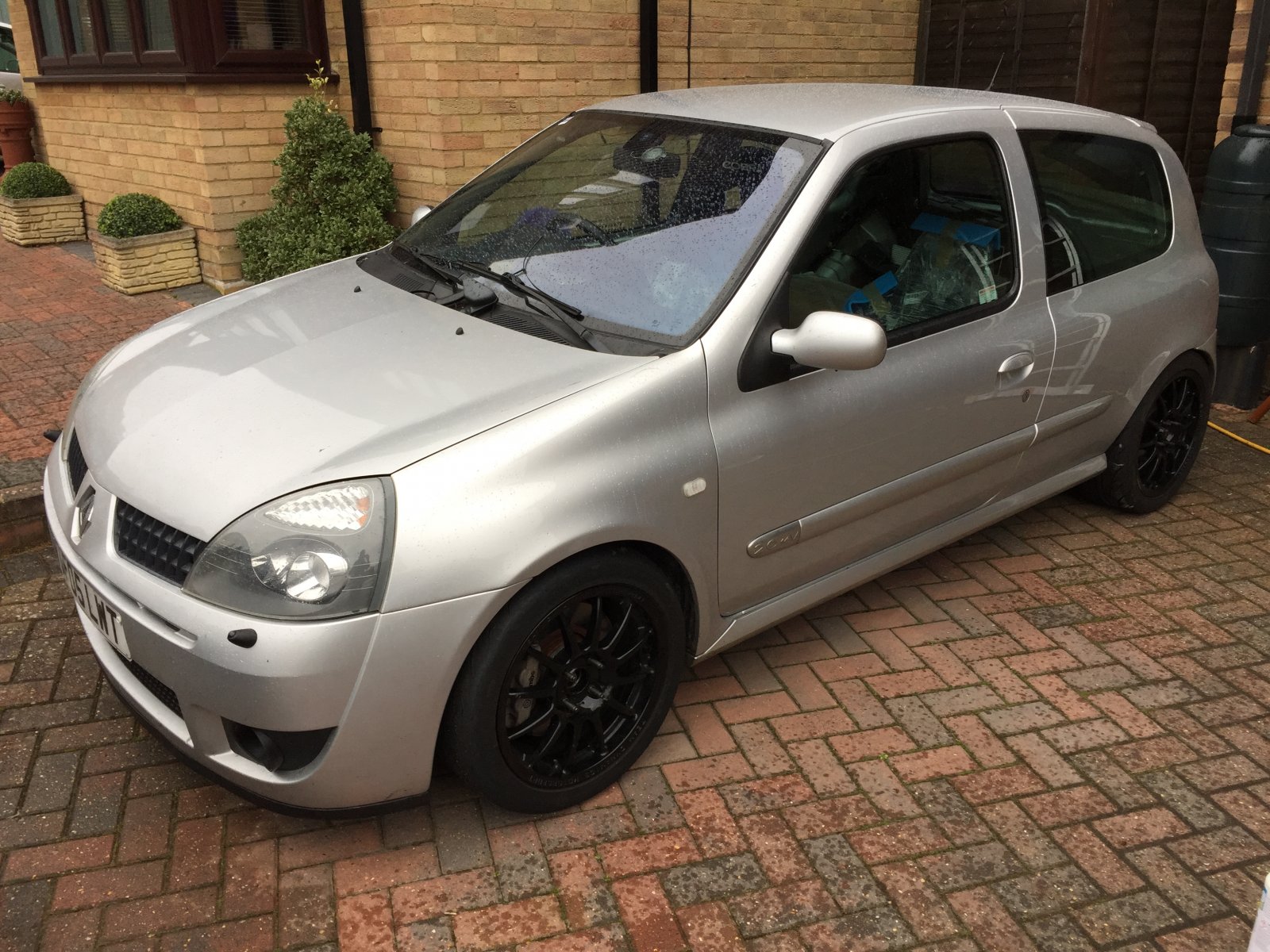

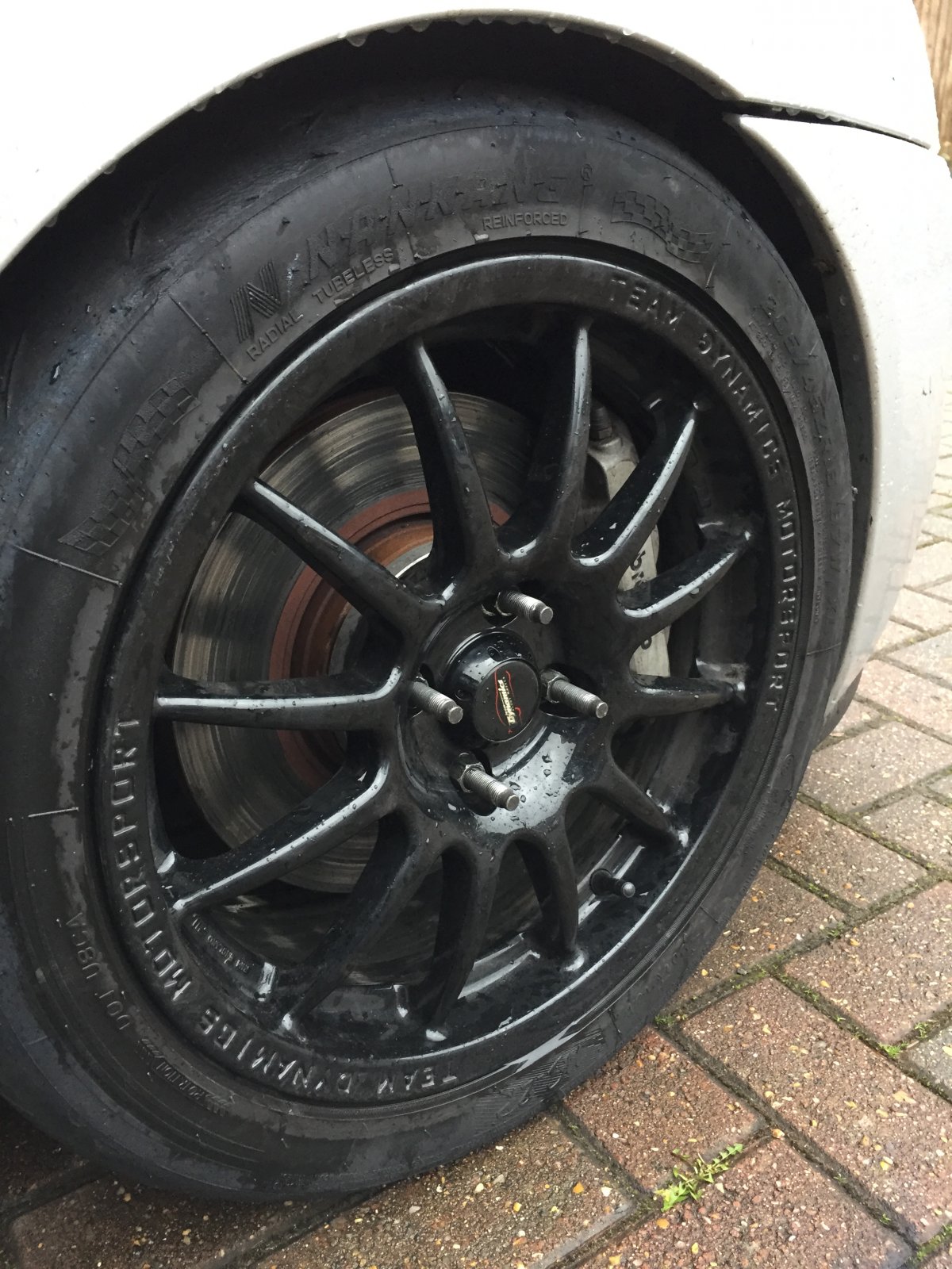

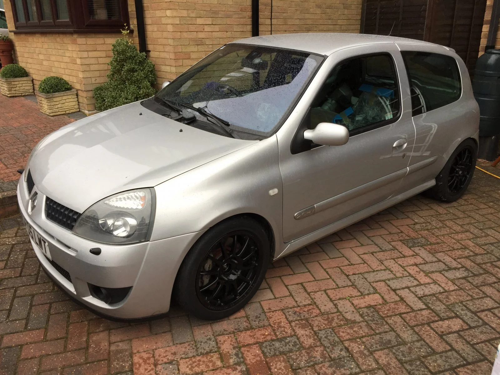

Well this week was a little unexpected for the Clio! I've been trying to keep the Clio looking relatively standard but events this year have lead me to buy fibreglass panel, plastic windows, aero catches and a roof scoop! With all the emphasise on weight loss the wheels couldn't last long (I'm actually a fan of them!), late night eBay watching came up with some 16'' (I have to run 16'' due to the brakes) Team Dynamics 1.2 Prorace, best of all they were less than 5 miles from my house. A deal was done, I collected them the following day and have just had the tyres swapped over.
Note - the cars filthy, the wheels are filthy and it's raining!
I cant get over how light they are, I think with the tyres on these are lighter than the standard alloy with no tyre?!
Note - I'm not a fan of black wheels and I'm not a fan of multi-spoke wheels but function over from wins hands down :smile:

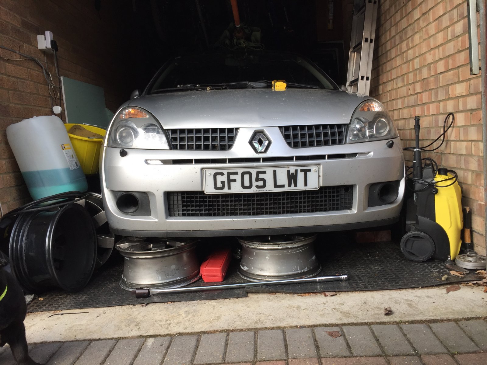

Bit of an update -
Parts have been arriving thick and fast. The poly window set and fibreglass bonnet, spoiler, boot and roof vent are here.

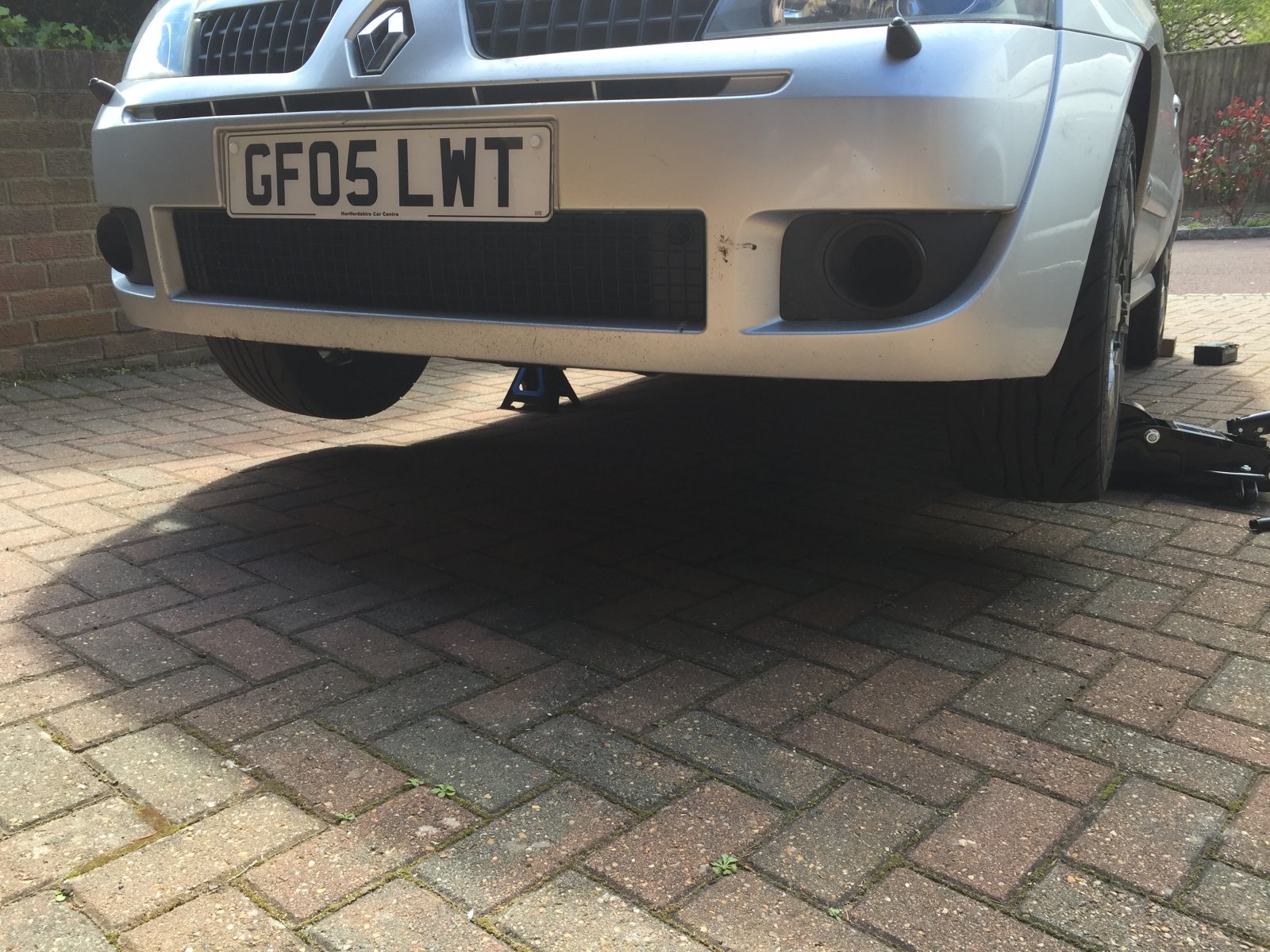

I removed the hubs to be sent away for the roll centre/bumpsteer conversion. Turns out I might need some new brake pads! Also some dust covers. I also want to try and convert back to the original 280mm disc so I can run 15 inch wheel with slicks on them.
Whilst the front was apart we worked out I can ditch the horrible 25mm spacers are run 5mm spacers which is great news.

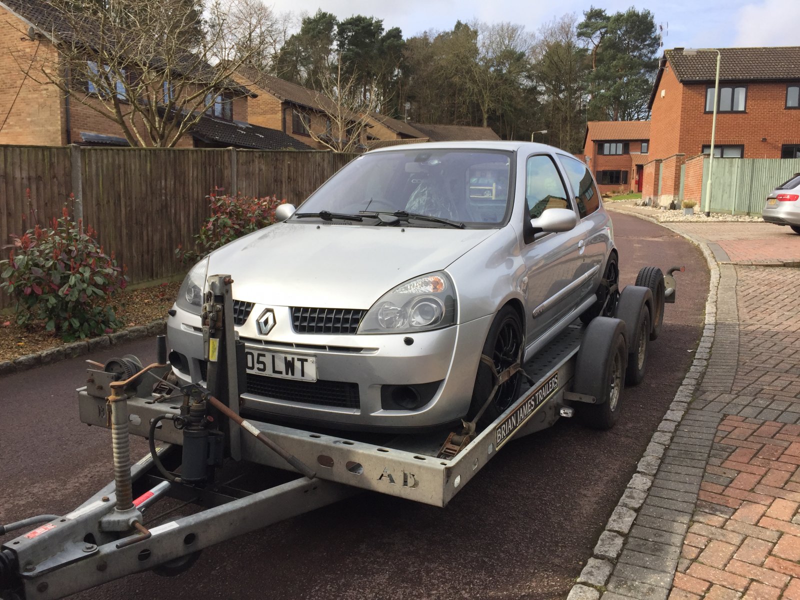

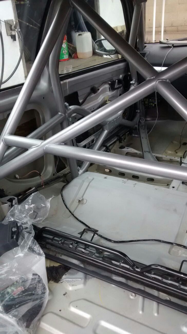

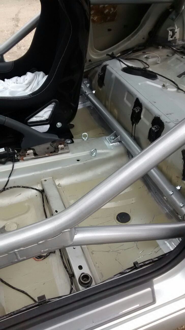

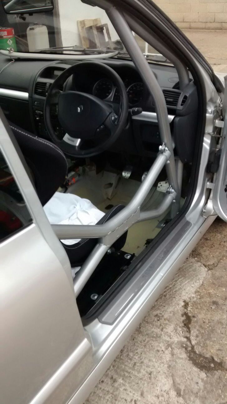

Then unfortunately the timing gods worked against me! I got the call to say the roll cage is ready for me but my car was floating in the garage with no front hubs so I had to buy some second hand hubs so I could move the car about.
Which brings us up to today, first time it has moved off the drive this year! We took the car on the trailer to Mark Fish to have the cage fitted. I went with anthracite colour cage which should look nice.
I can wait to get the car back. Once the cage is in we can crack on with the re build. The cars been un drivable for 5 months now and I'm itching to get it back on track with all the new bits. Just need some spare time to get things moving forward!

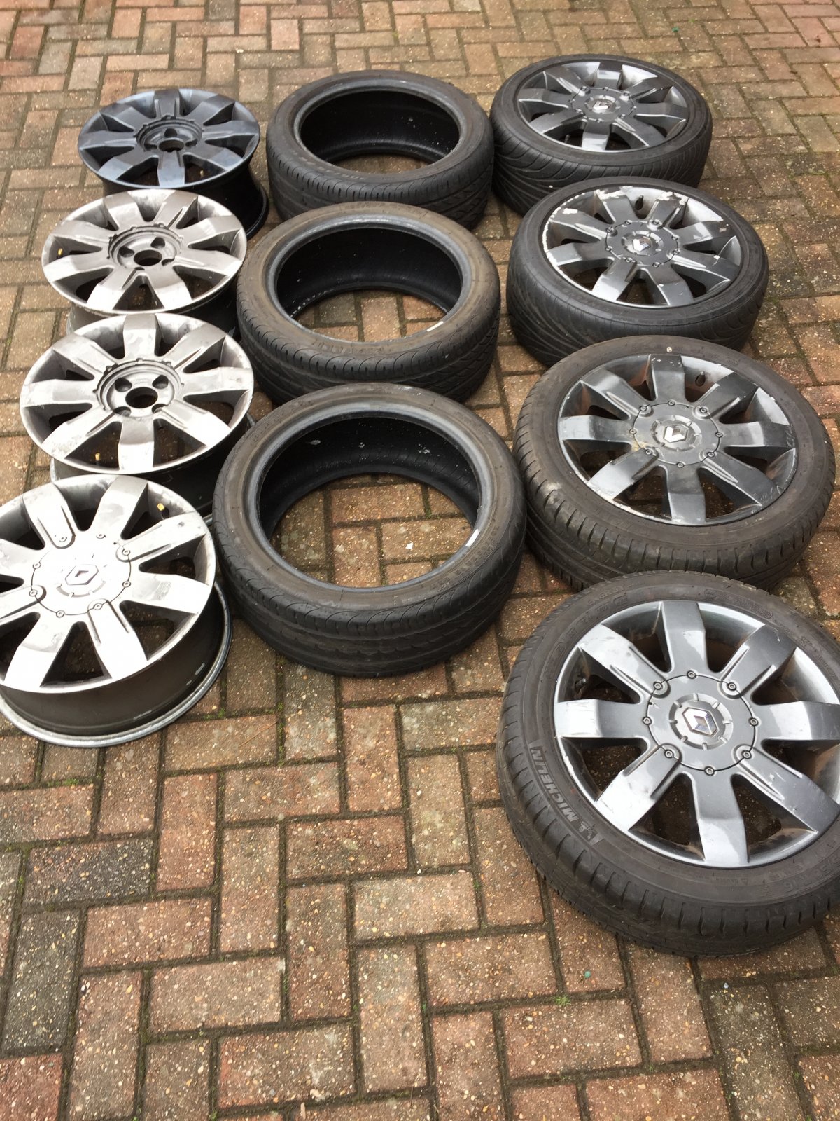

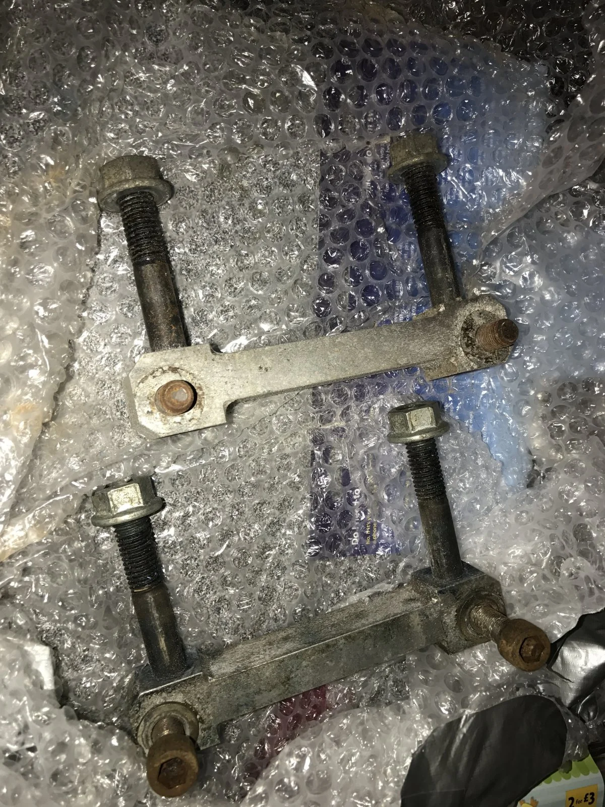

Busy week! Sold all of these.....
To help fund some new 15' alloys for slicks because I finally managed to get hold of a set of these........

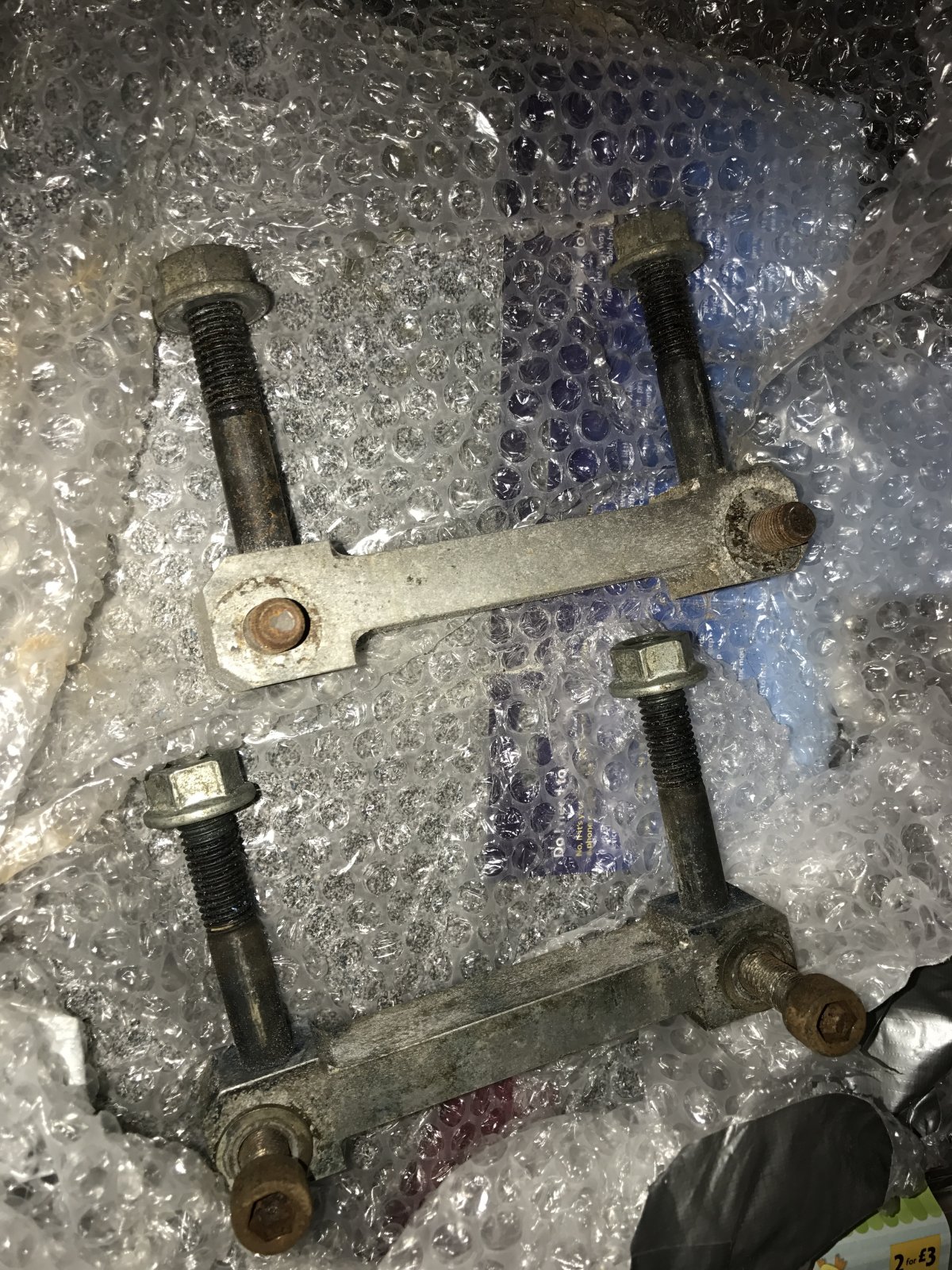

Brackets to allow me to run the standard 280mm discs which allows the 15' wheel. Happy days
