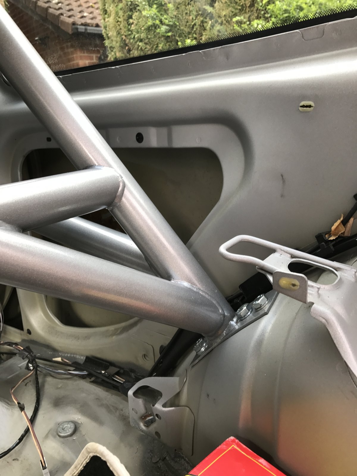

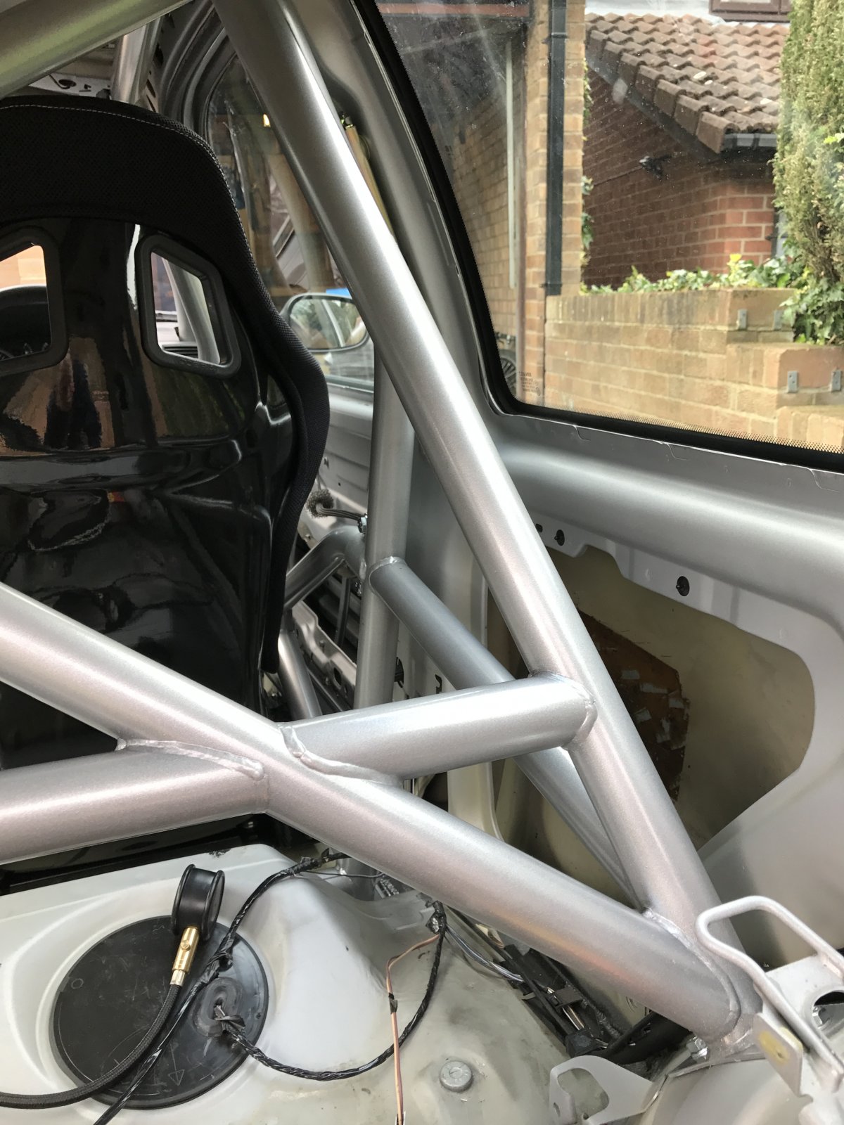

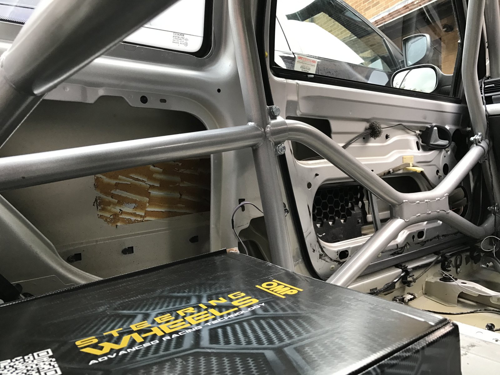

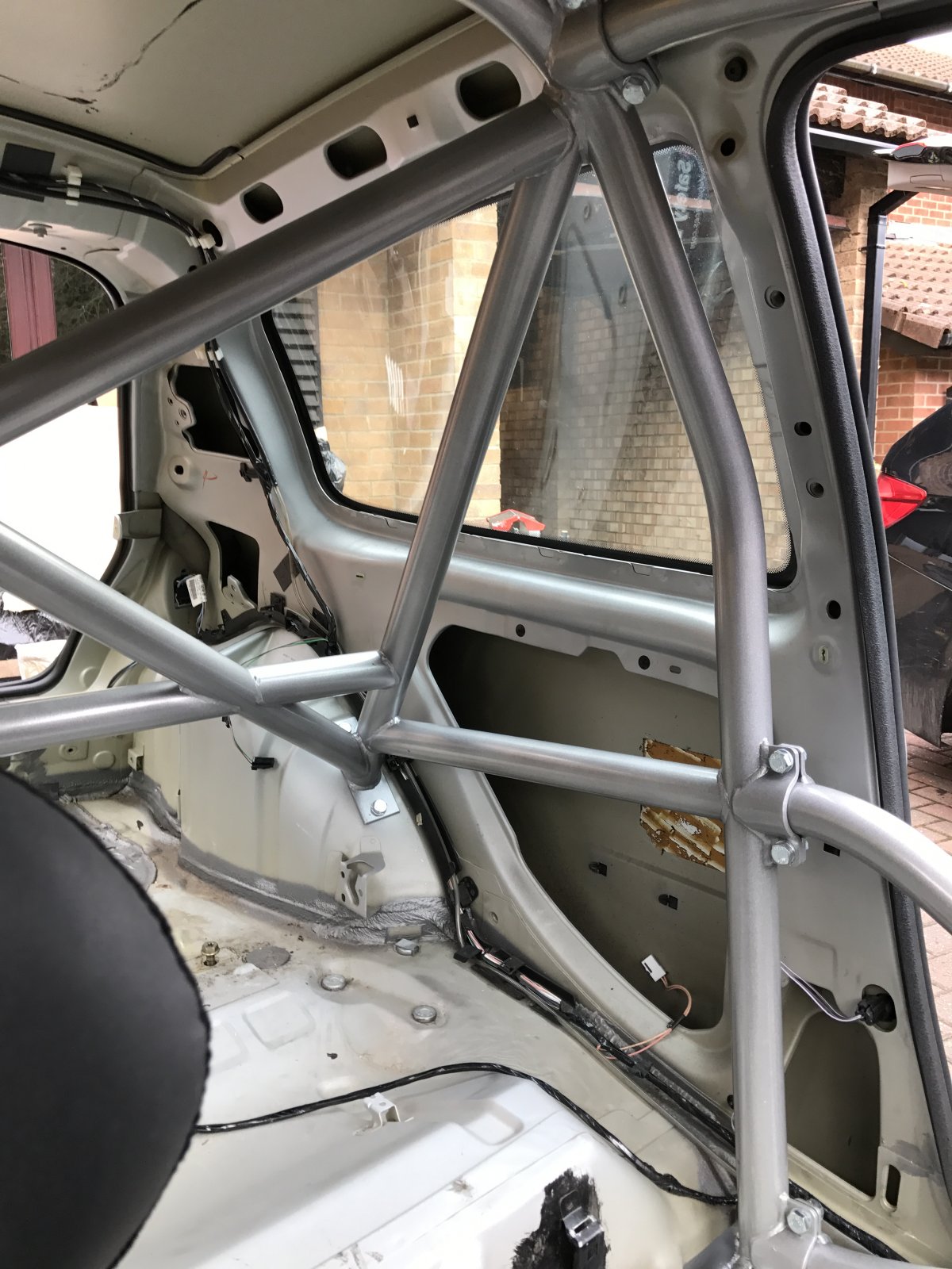

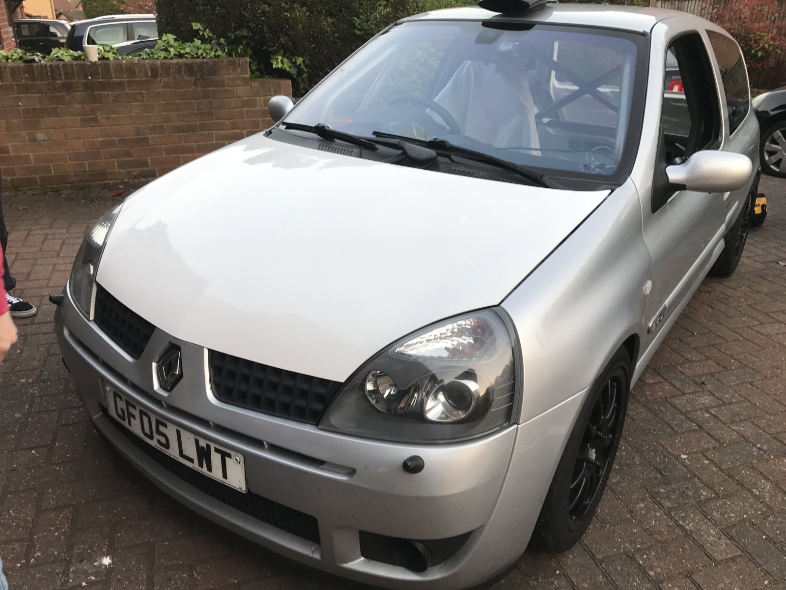

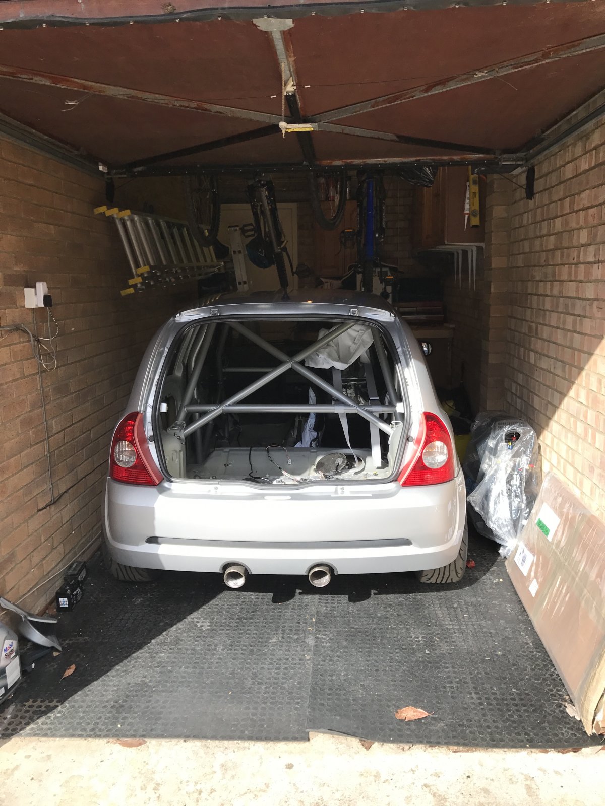

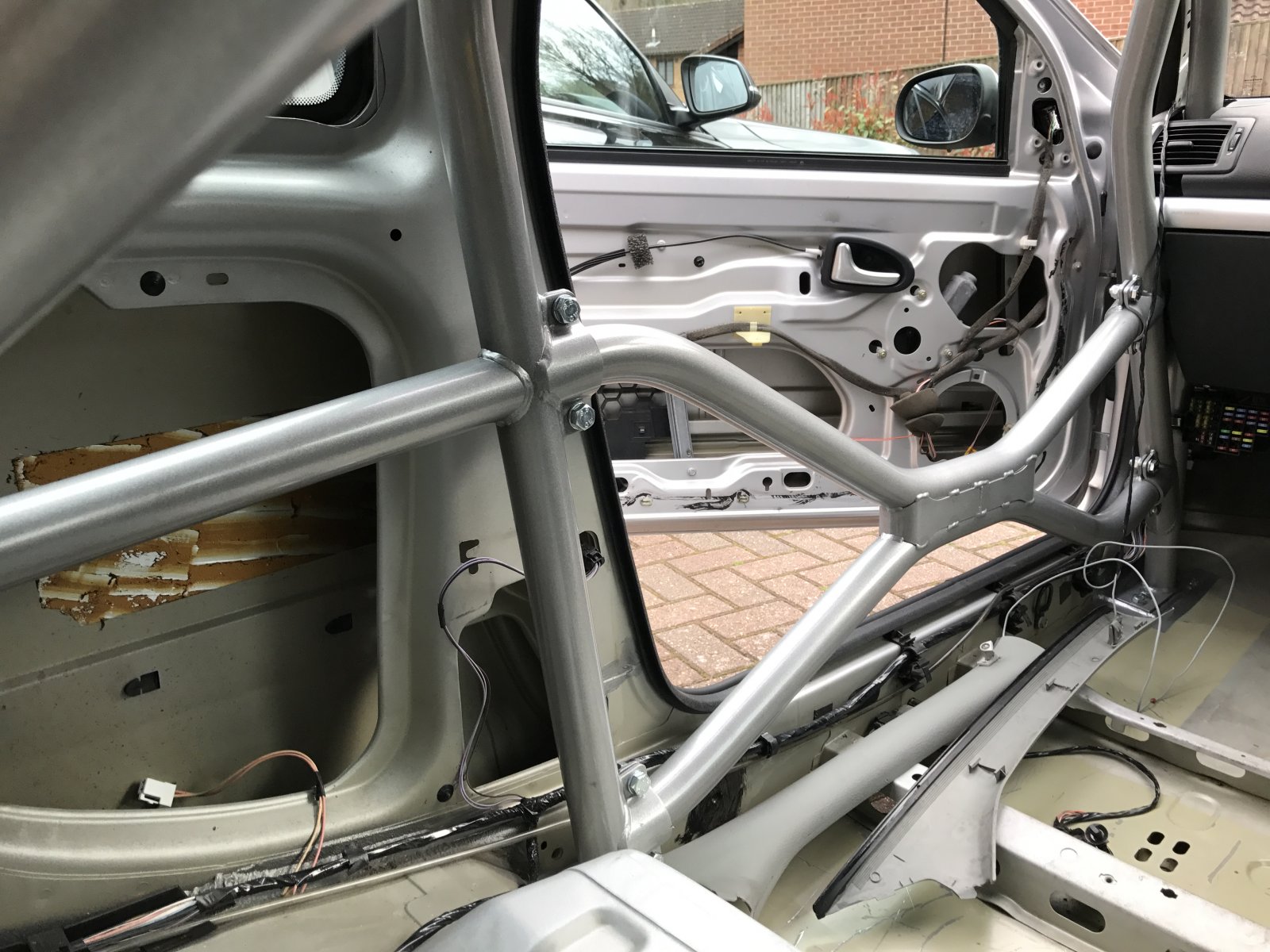

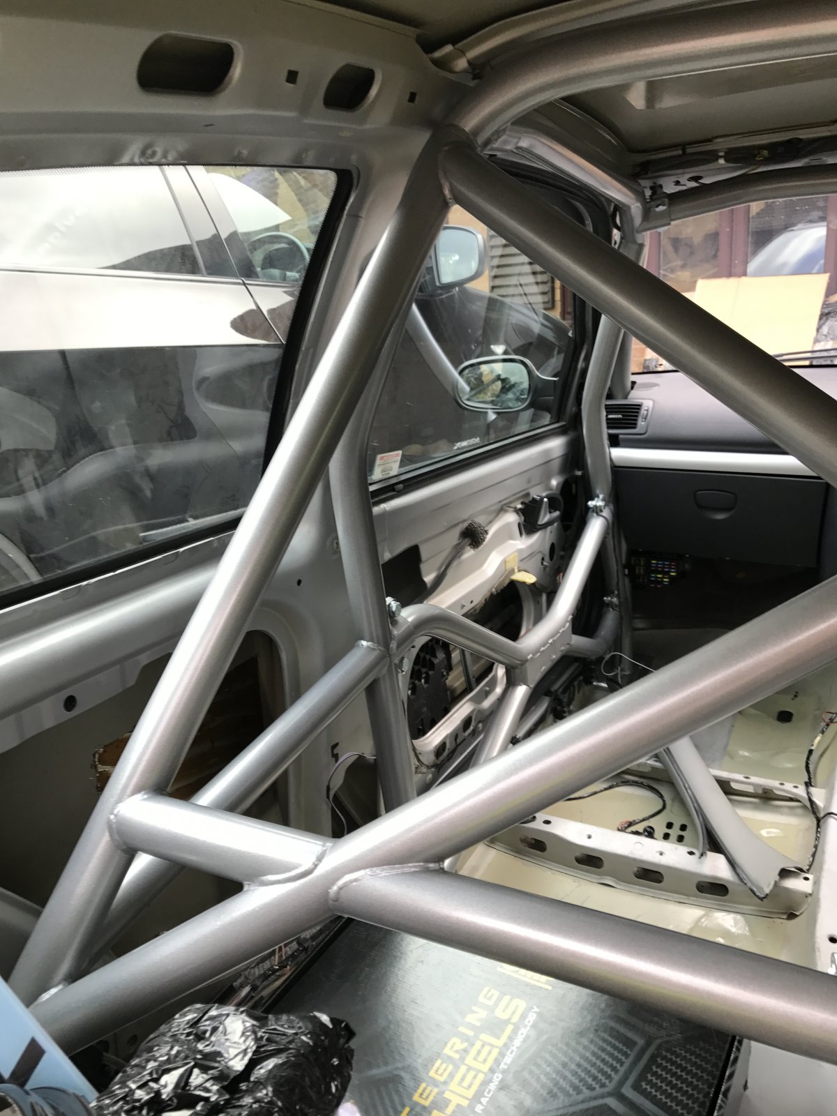

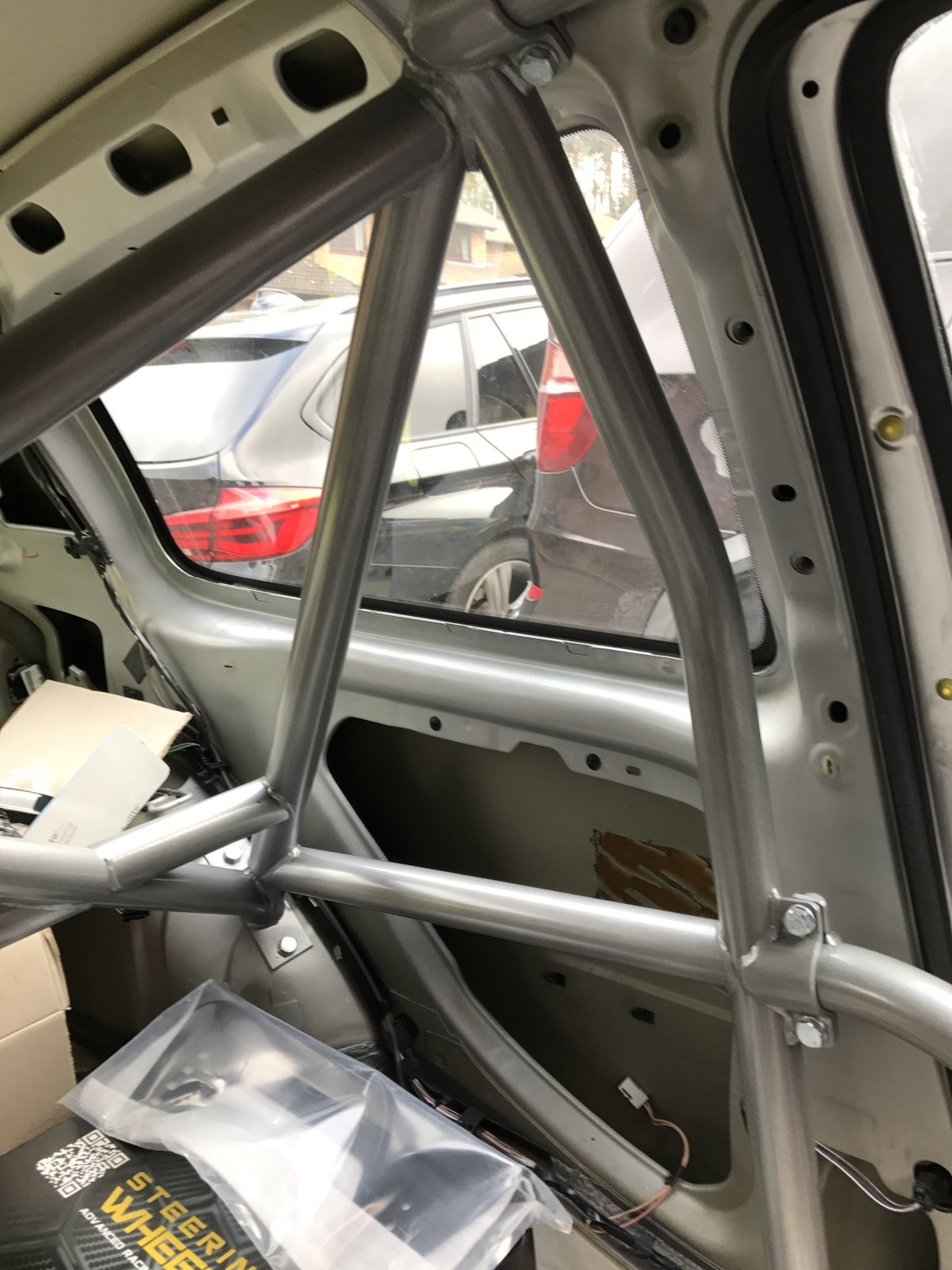

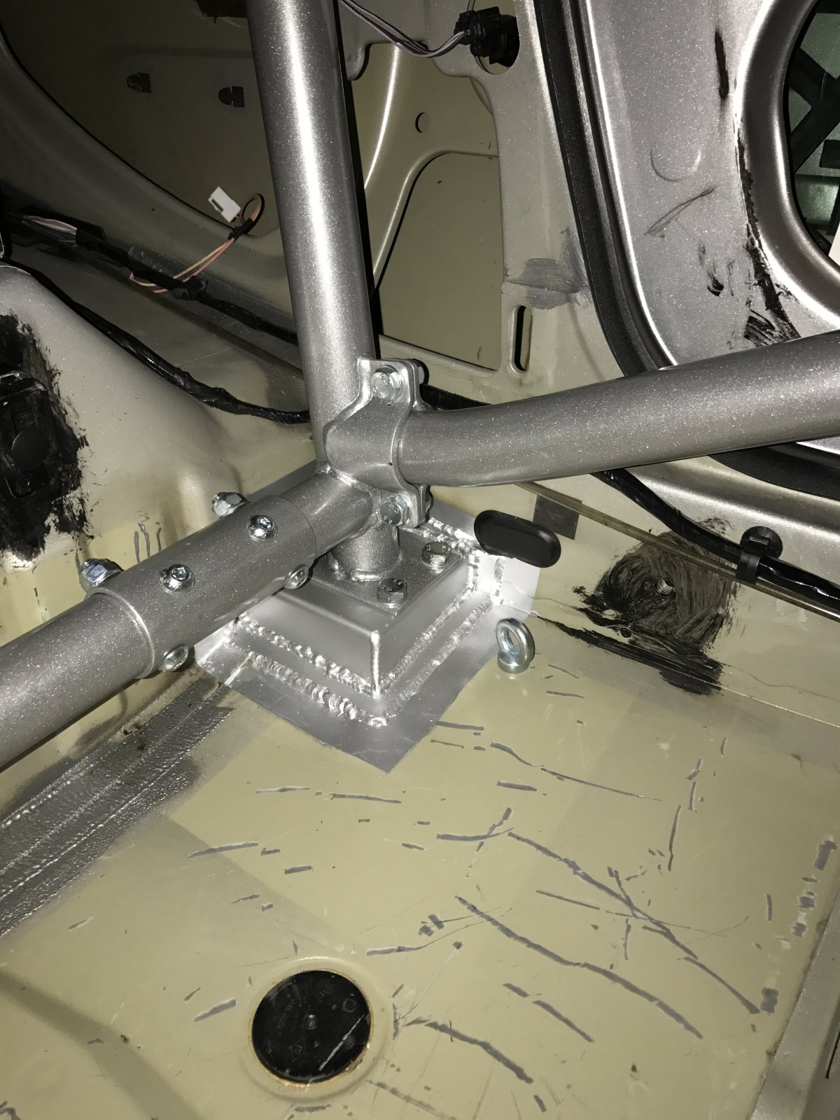

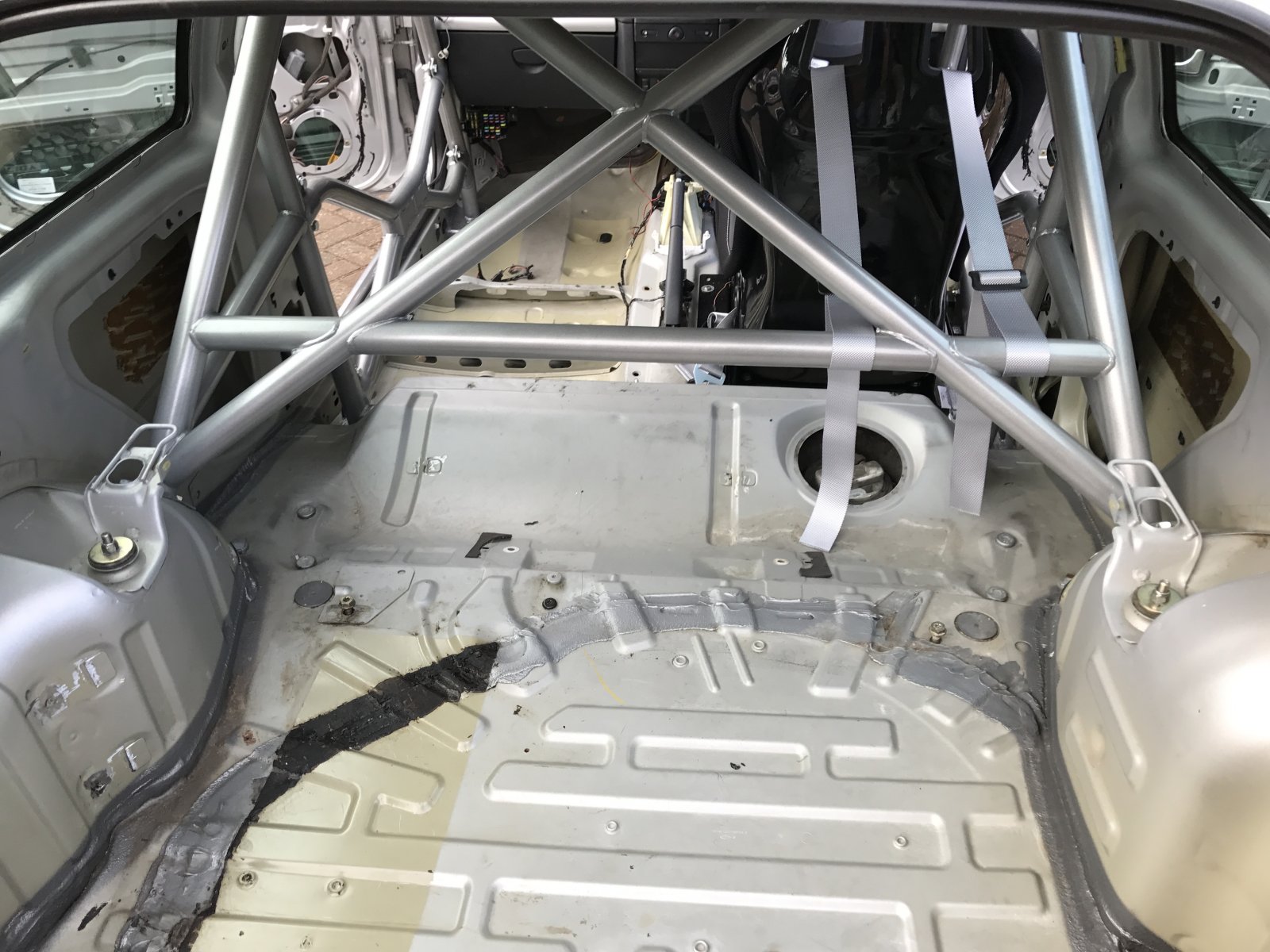

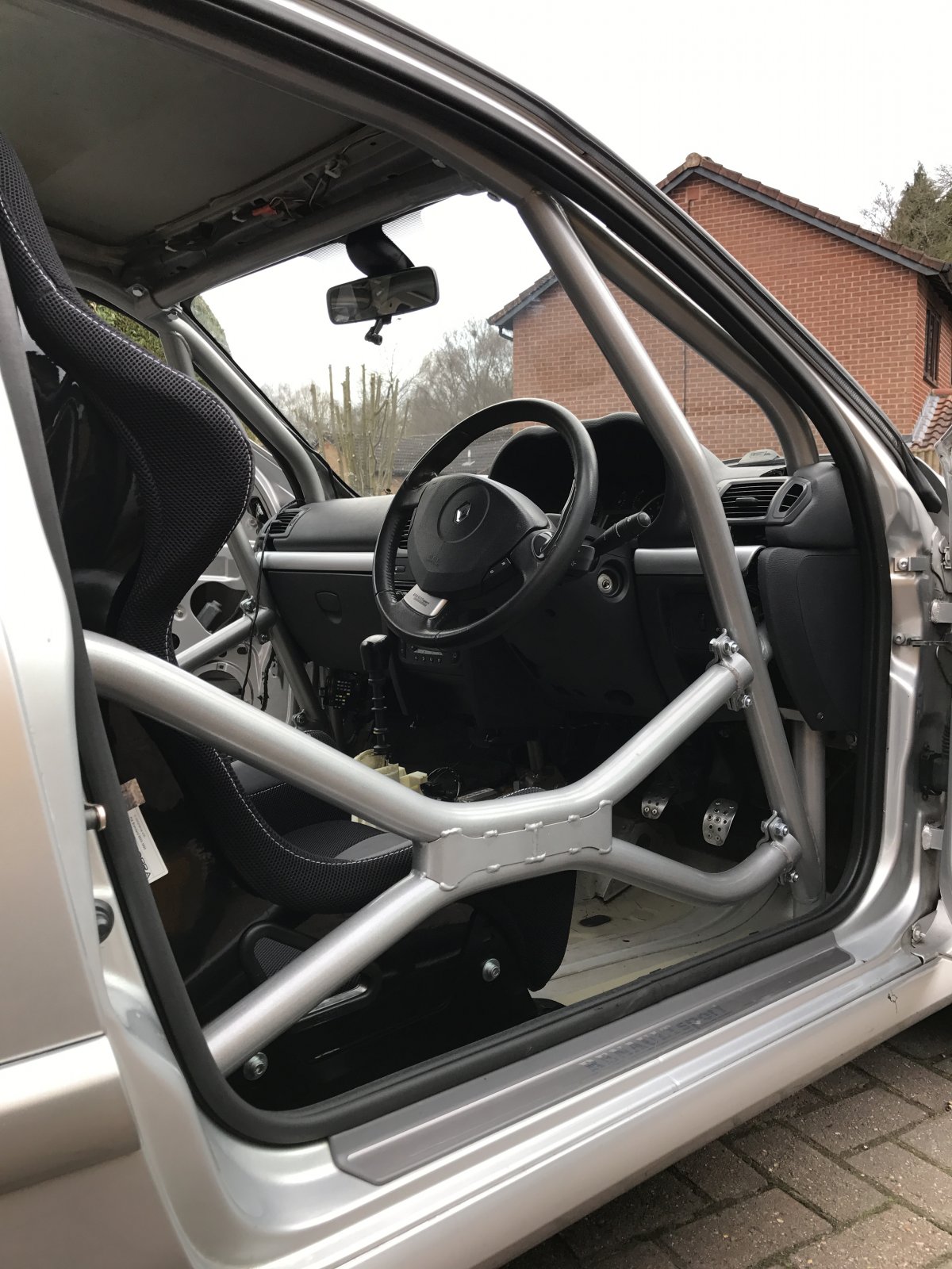

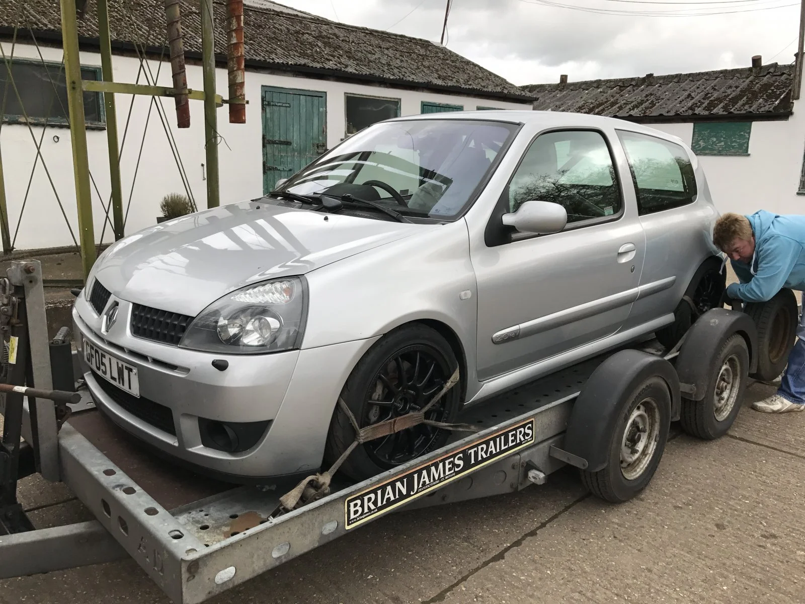

The Clio's back! I'm very happy with the cage. Mark fish was a pleasure to deal with. This is the first of the new Safety Devices cage. Now starts the hard work!

Cage looks brilliant mate it's starting to come together mate , what was and where was the garage called you used when you went the ring going in July so always worth knowing if I have any issues
The cage looks great.

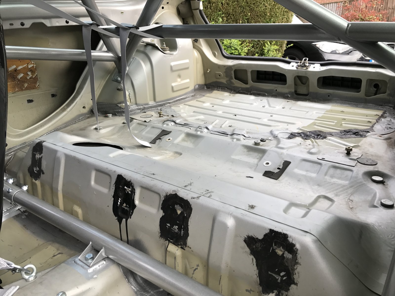

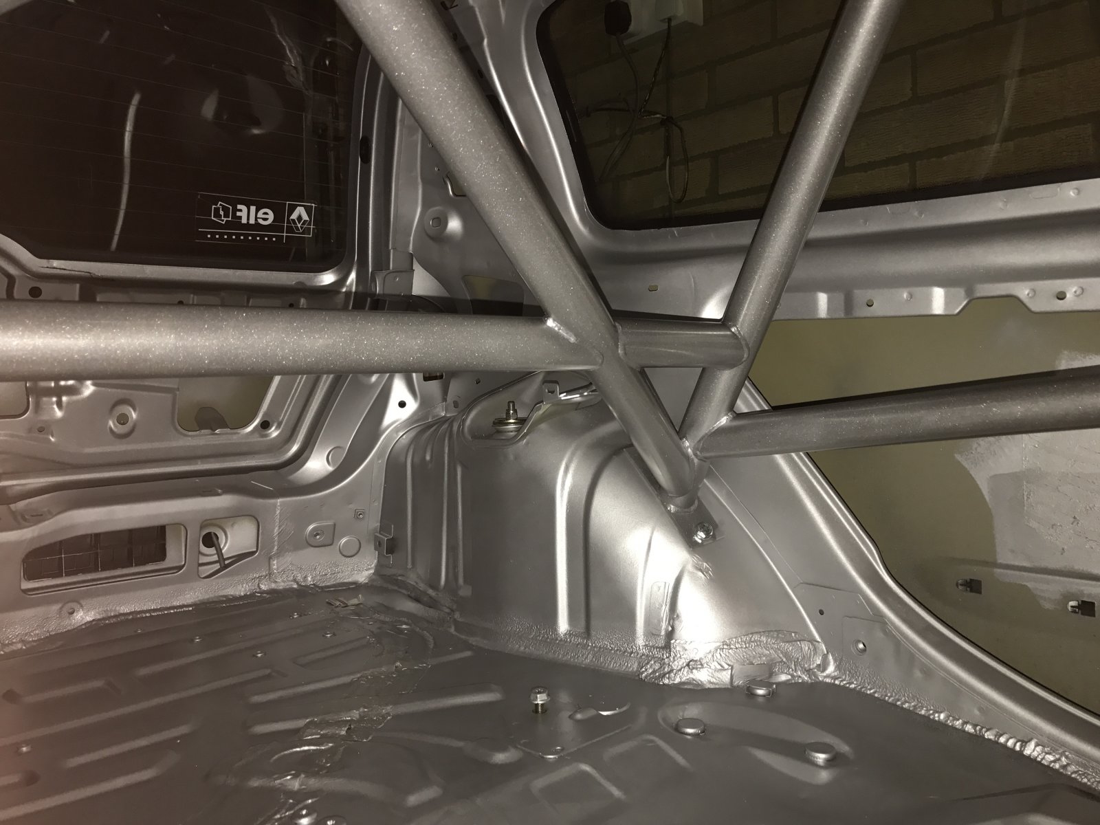

Some more pics of the rear section would be great.

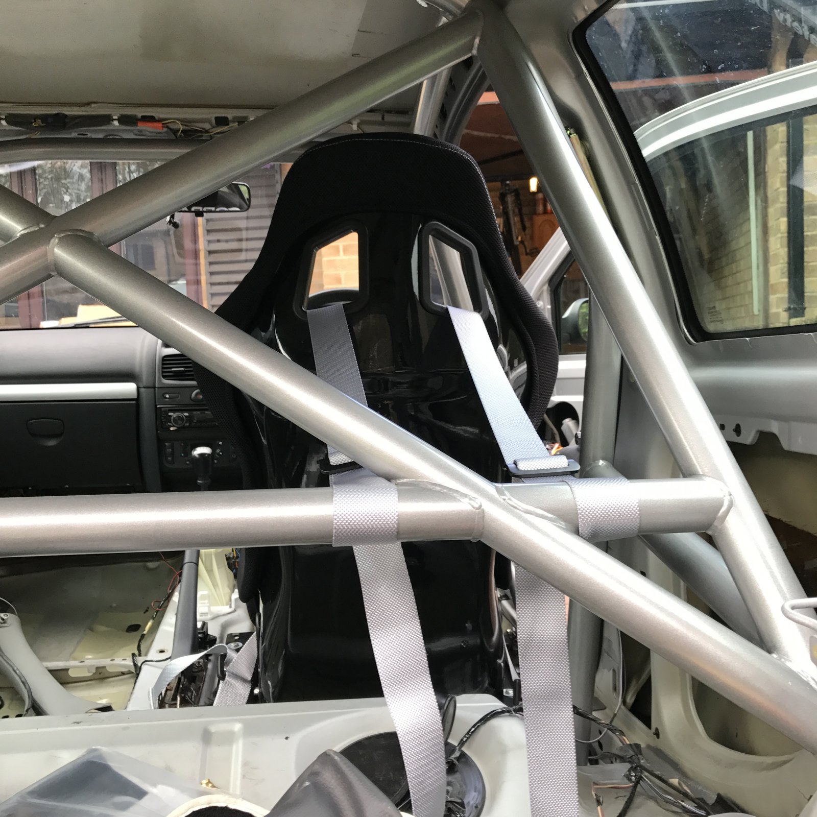

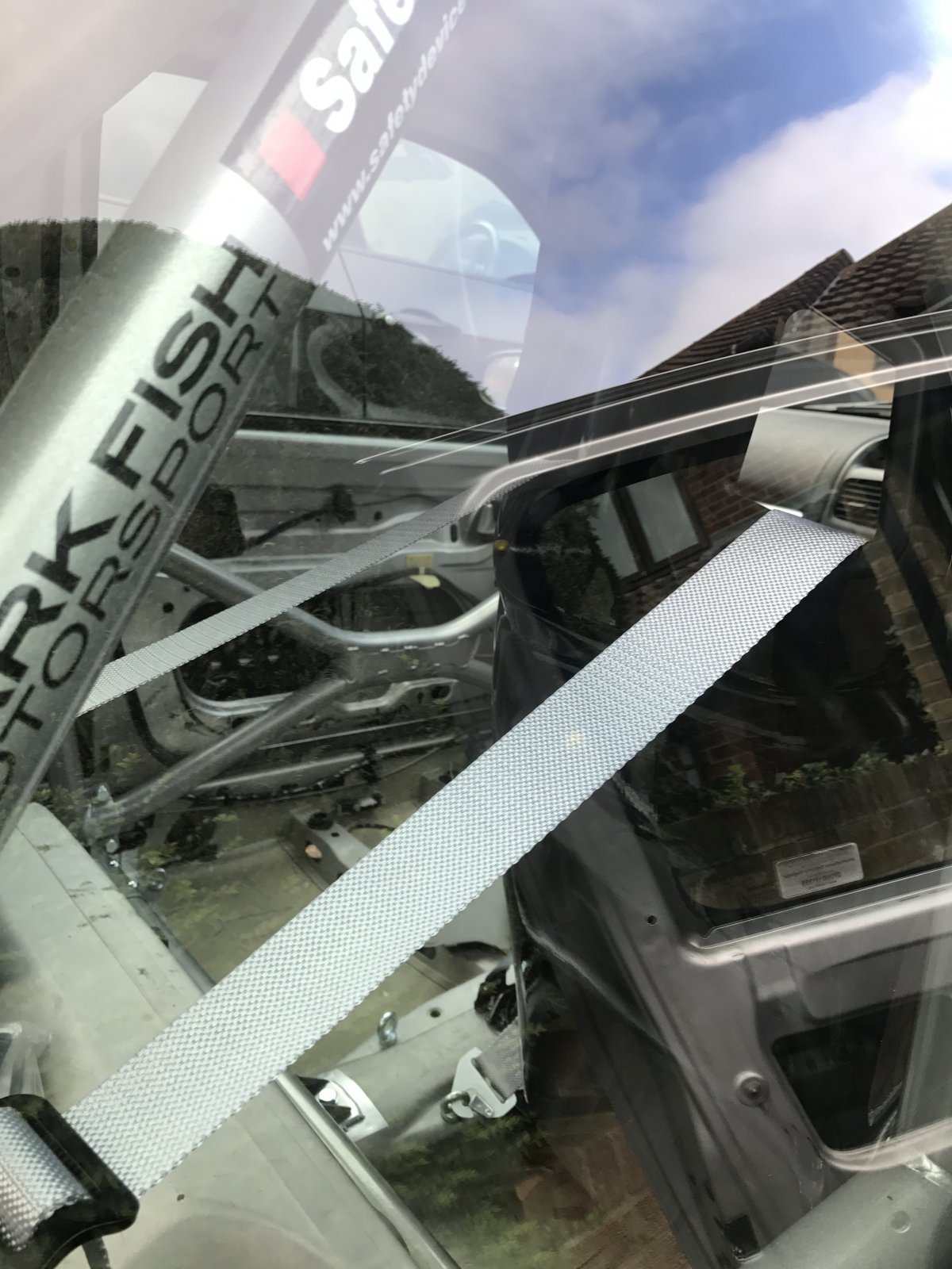

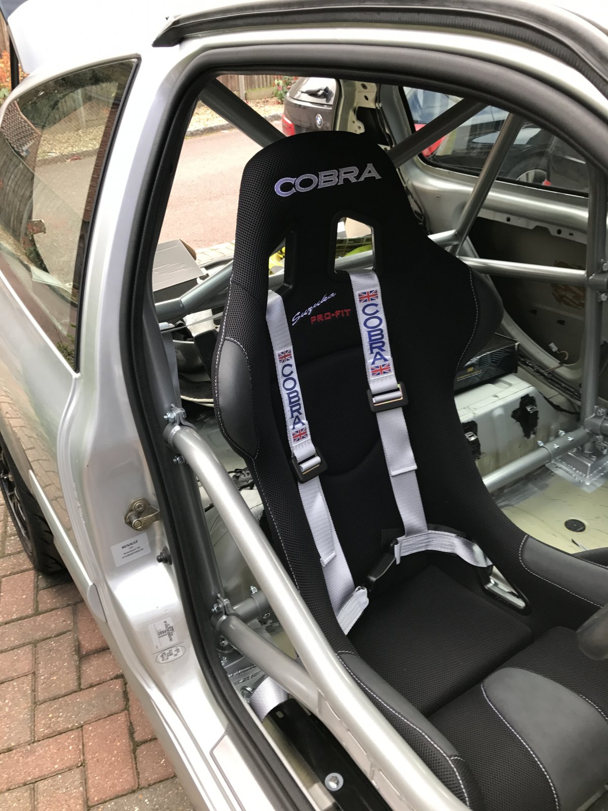

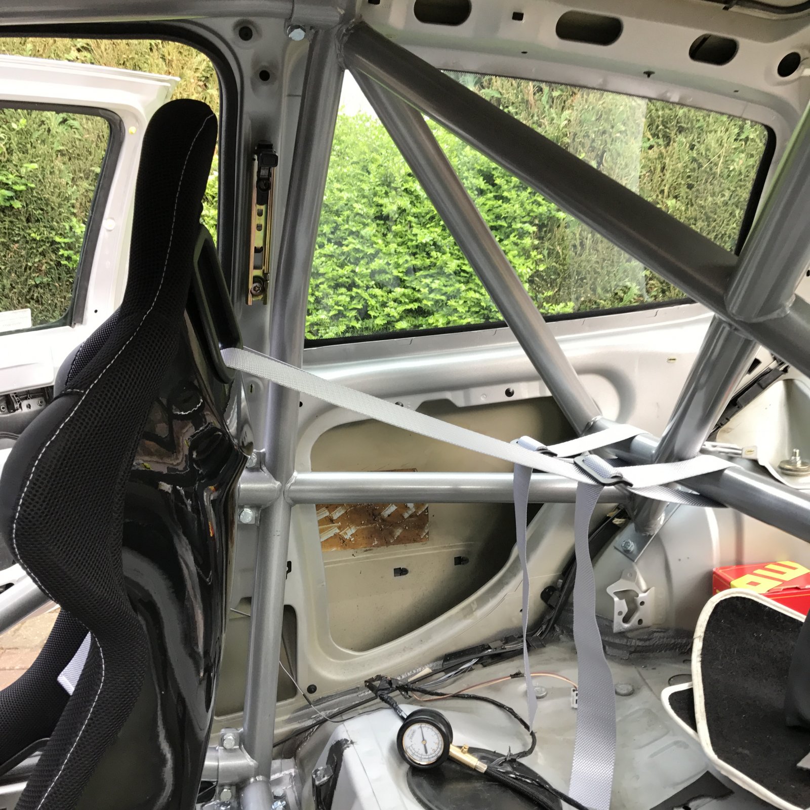

I put the harness in temporarily. Very happy with the colour combo of the cage/harnesses. I need to get painting inside but I'm away next weekend so it may be a few weeks away. Roll on the longer summer nights!

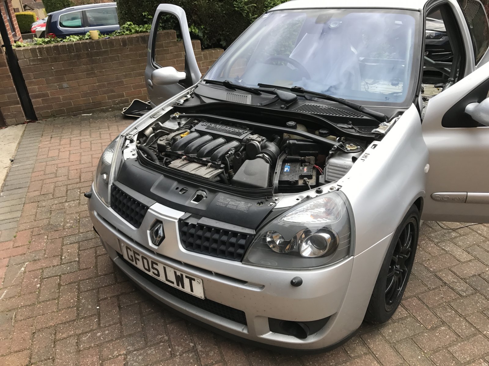

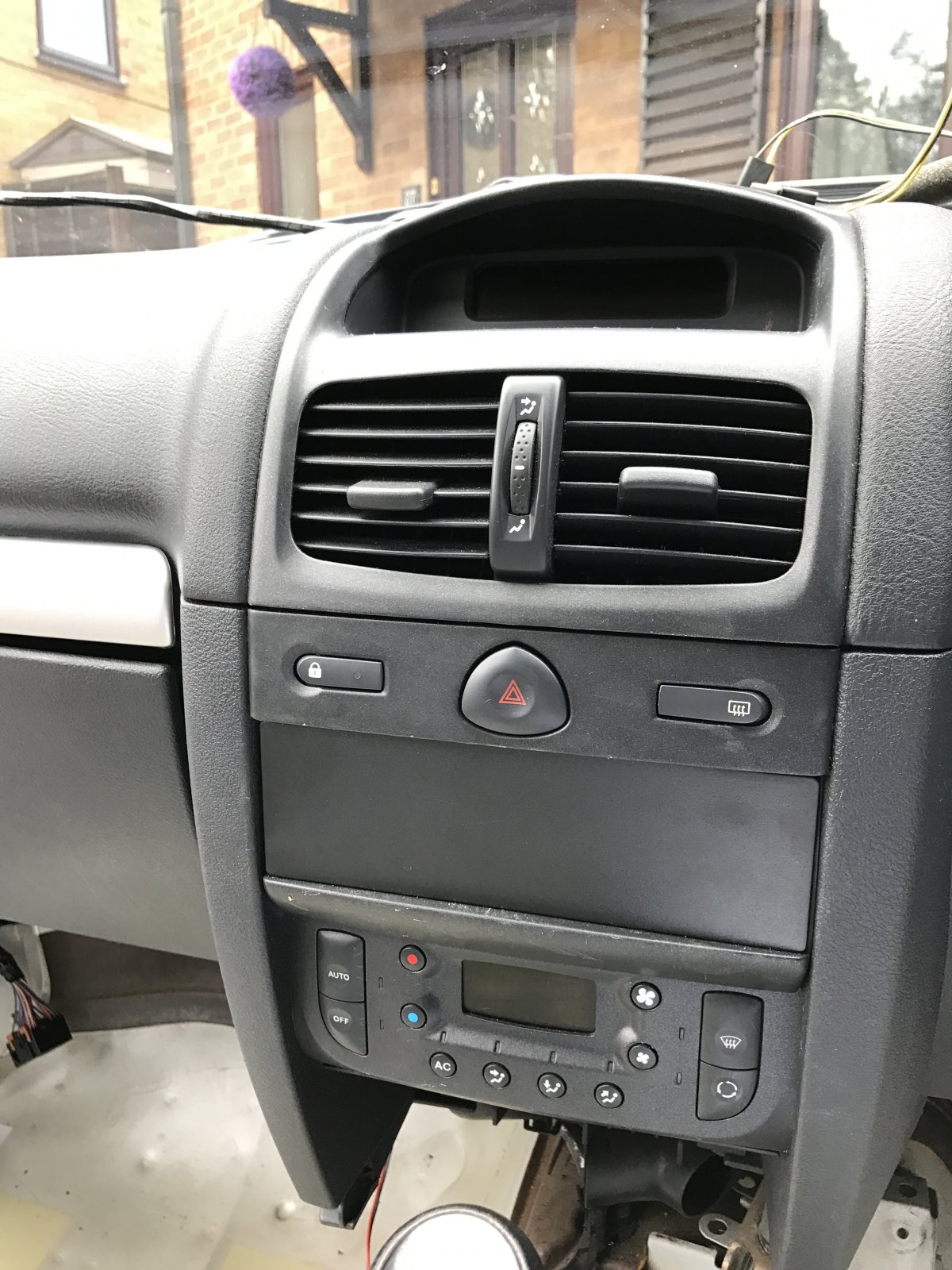

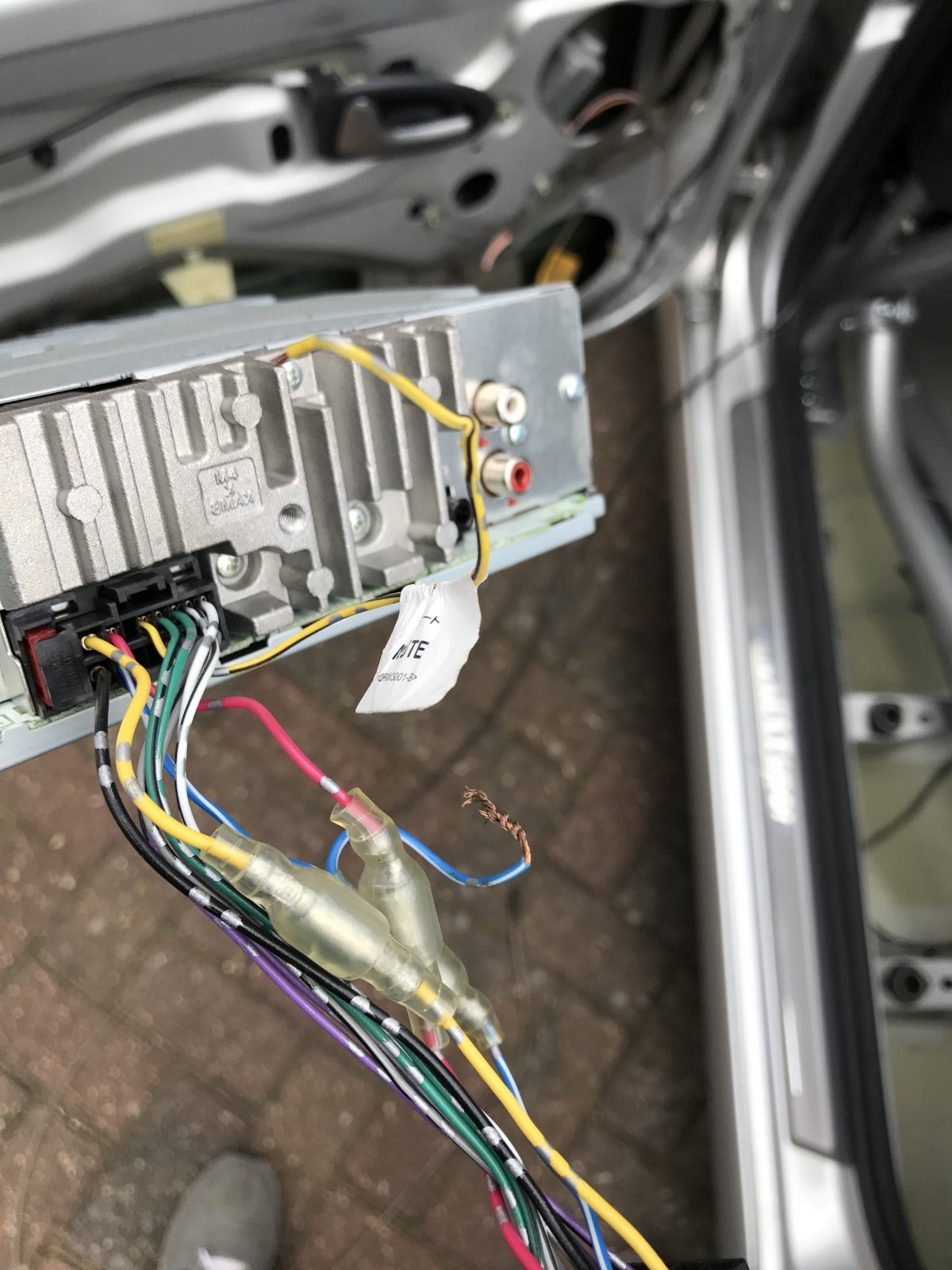

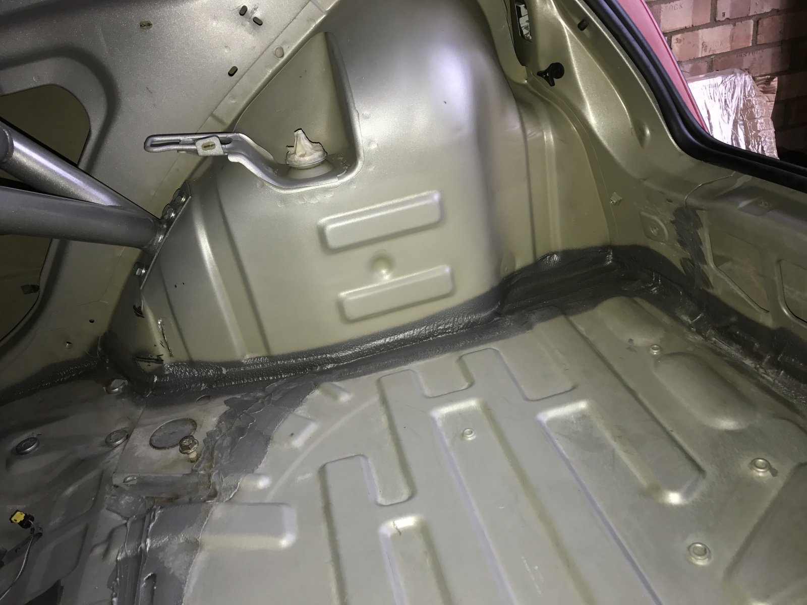

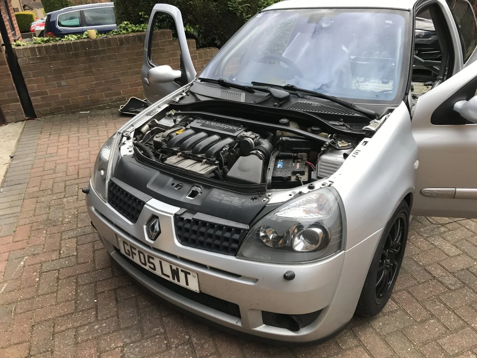

Little update, new job and a stag do have slow the pace up abit. I'm aiming to get the inside finished before I make a start on the outside. The hubs aren't back so there's no rush at the moment. I've removed the bonnet and boot for easier access for to the car. I also removed the stereo to find sime suspect wiring! Also fitted the blanking plate.

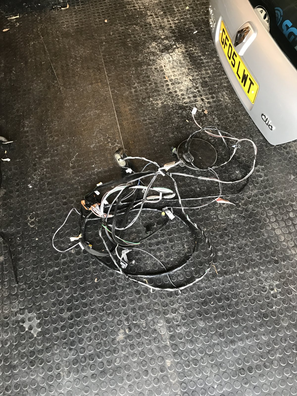

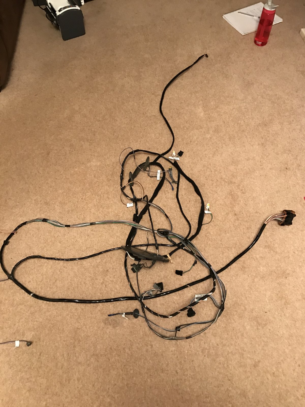

I pulled out the internal wiring harness to make painting easier. Also I will re route this and remove what is not needed. I also removed all the upper wires for internal lights etc as I don't need them.

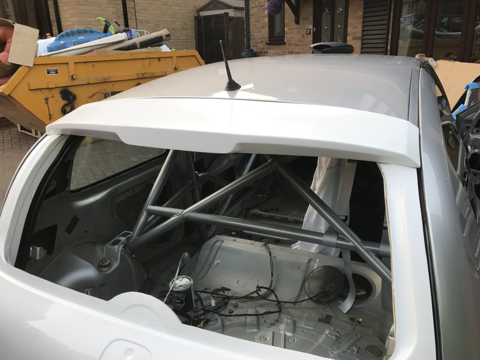

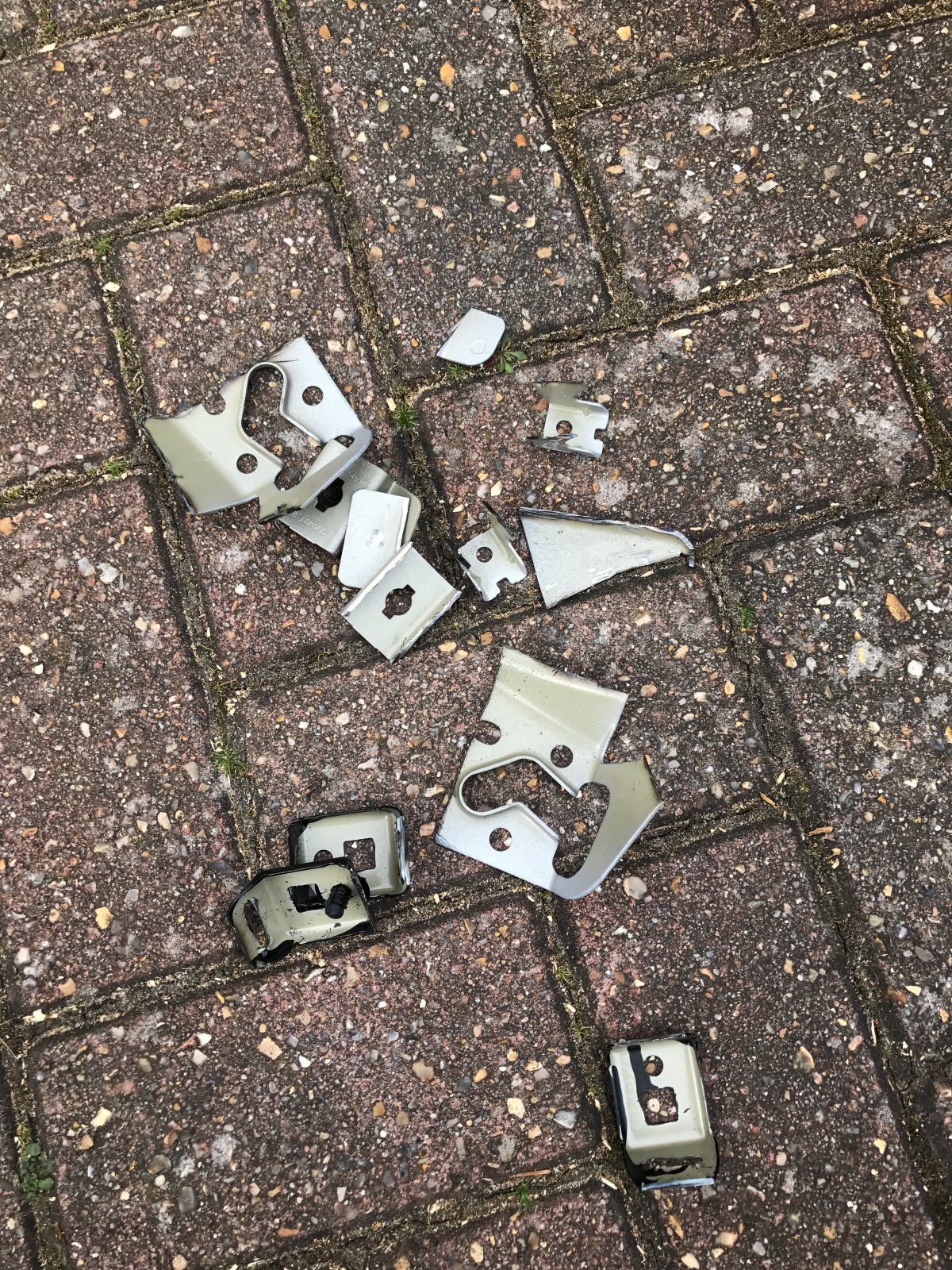

Out came the grinder to remove some excess metal work. I have left in the mounts on top of the rear stuts as they look handy to use as mounting points to strap down track day wheels if I need to.
The car is almost at internal paint stage now which will be a big step.

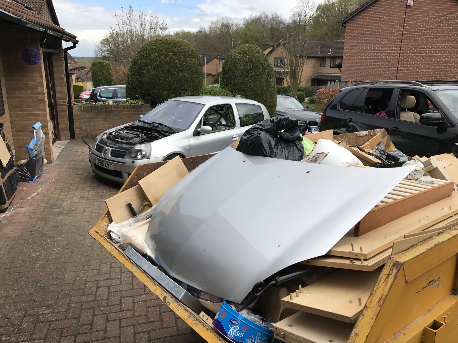

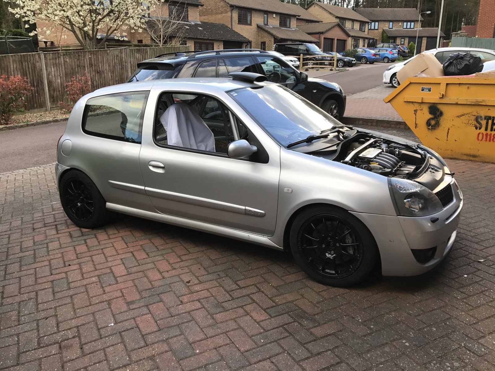

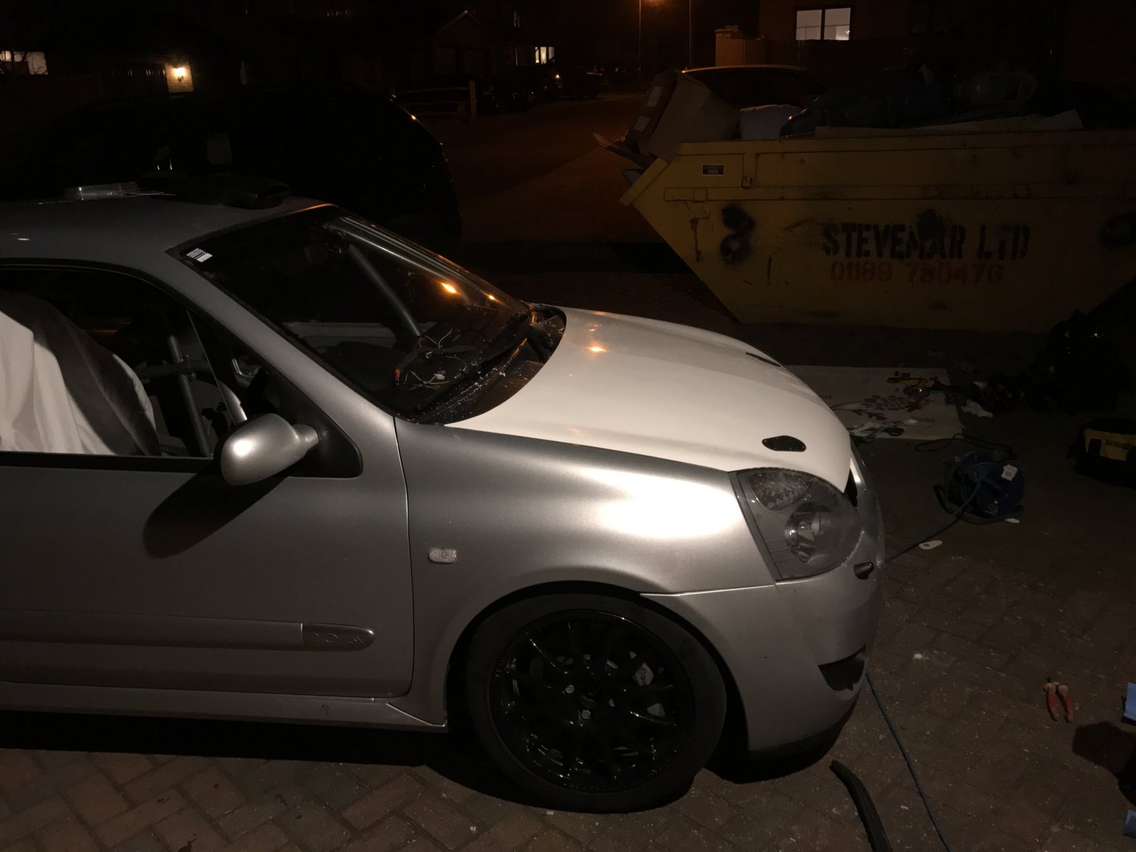

The bonnet went in the skip as it has a little rust and poor paint and lots of dents (free if anyone wants it? Skip goes soon!)
Rain stopped play so it's back in the garage where I hope to do some more bits in the evening now I can get in it with no boot in the way!

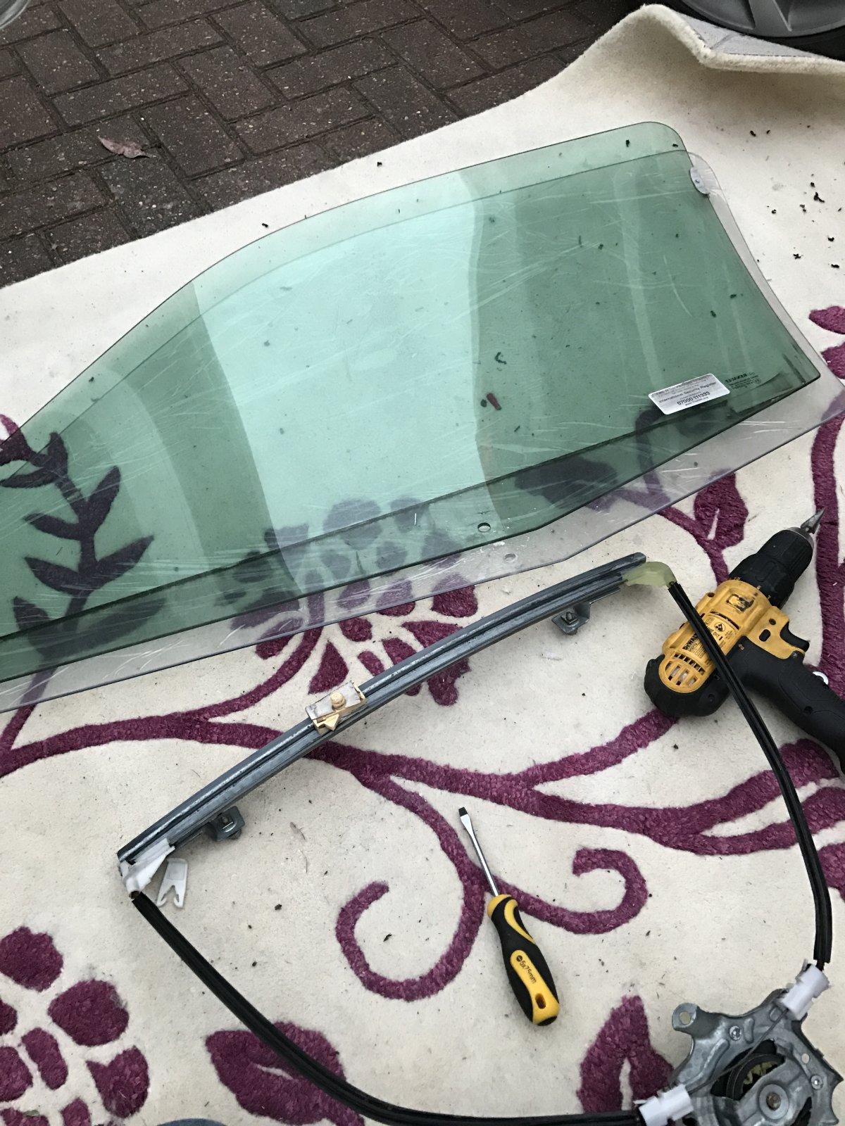

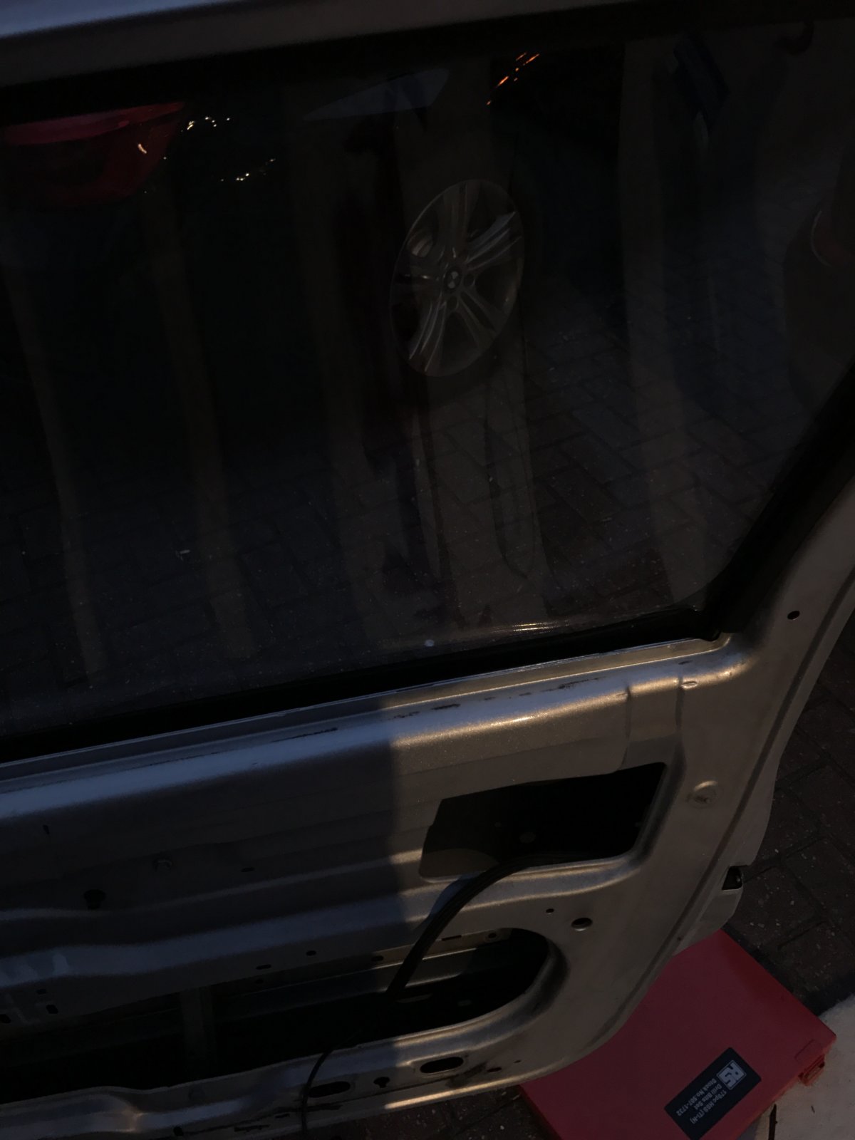

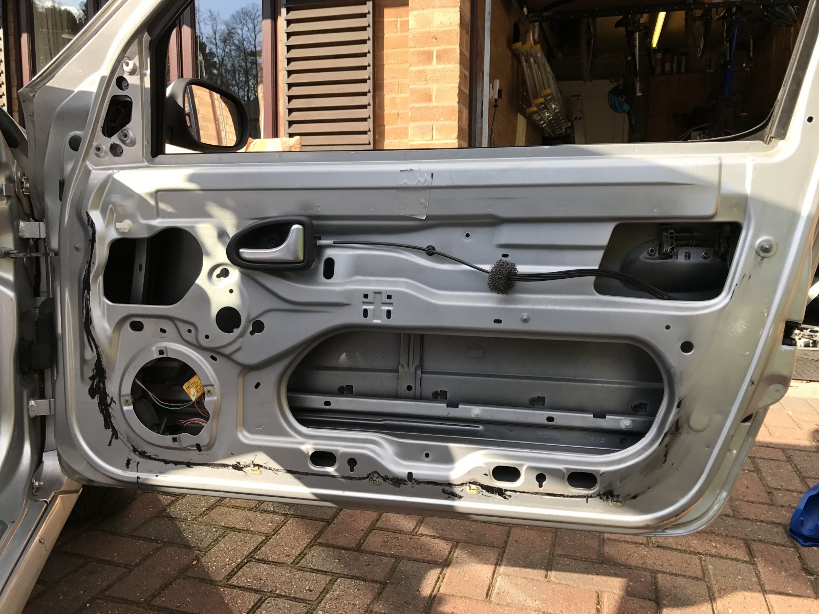

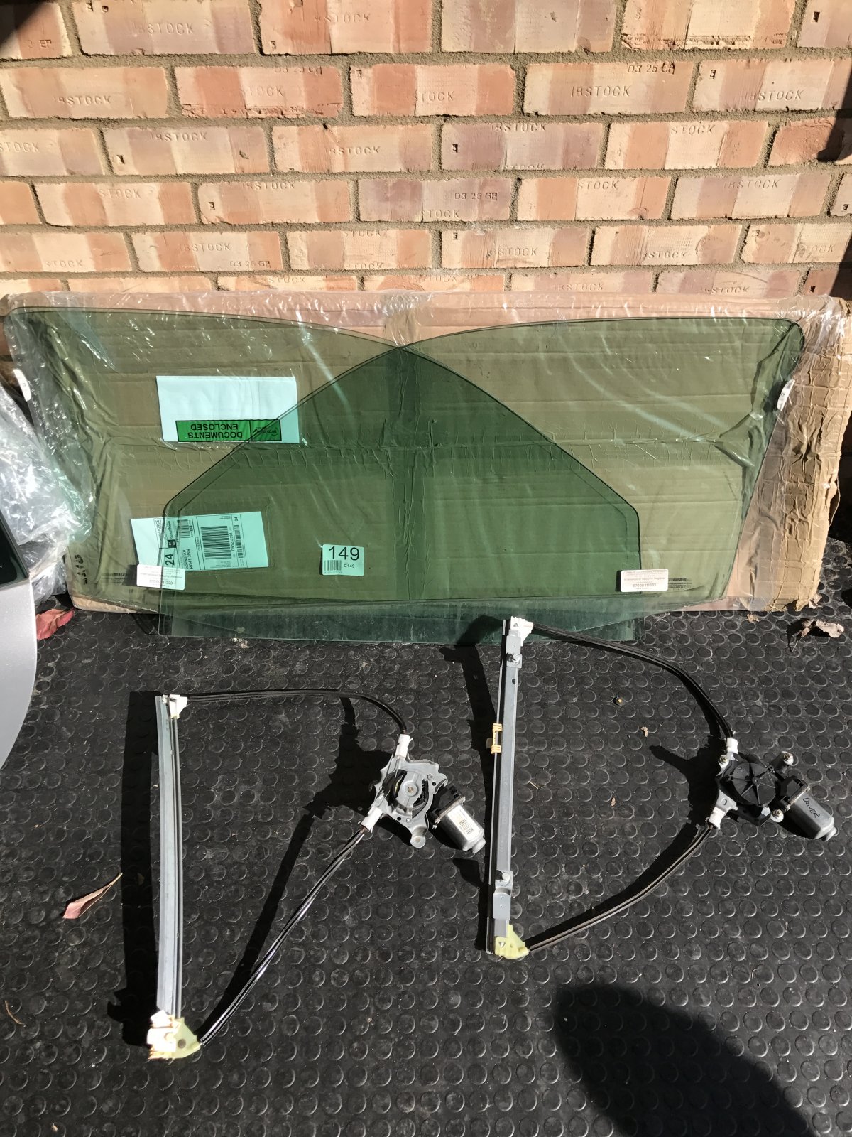

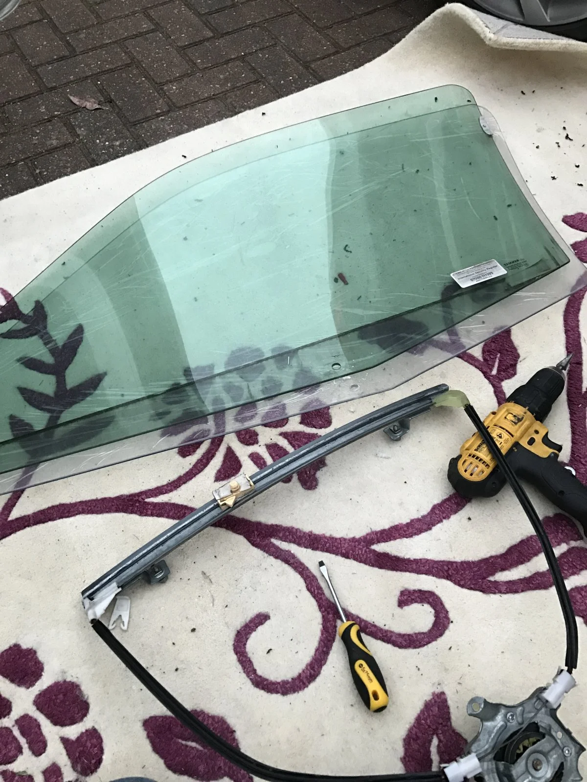

Next step removed all the electric windows and old glass, then rub down ready for paint.

Managed to get a second day at the car this weekend, first up removed the electric windows and front glass

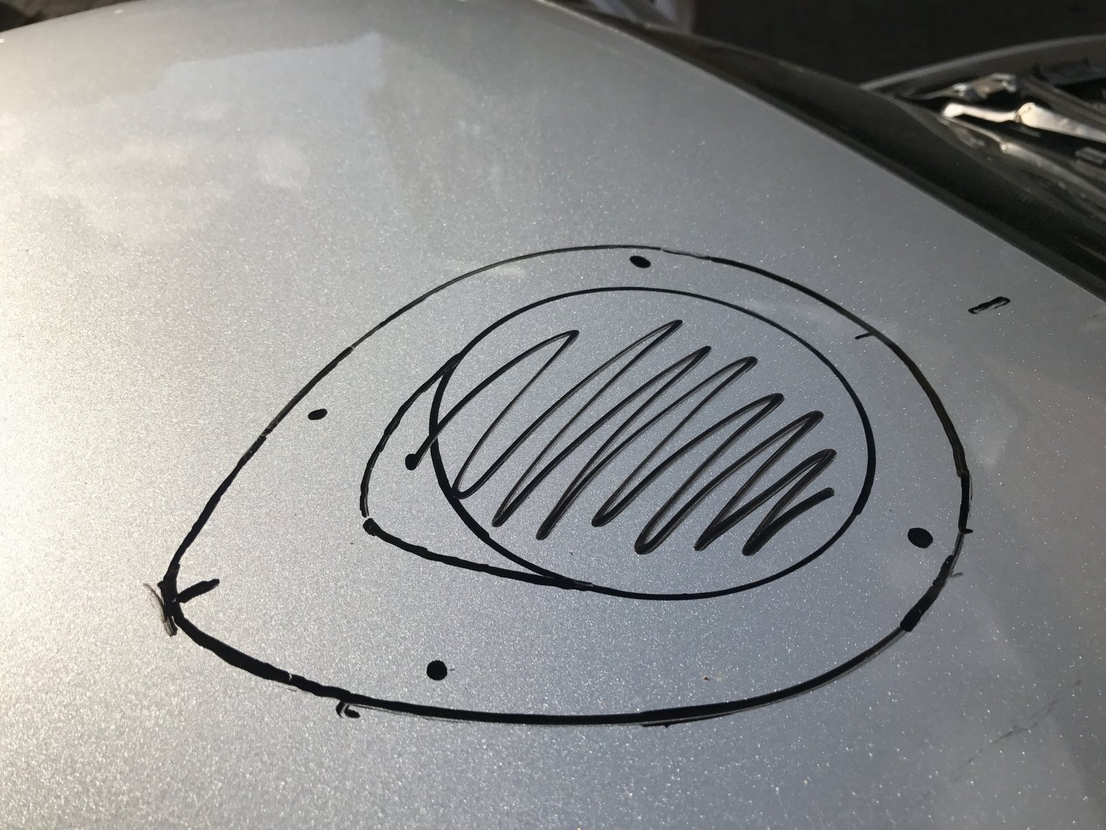

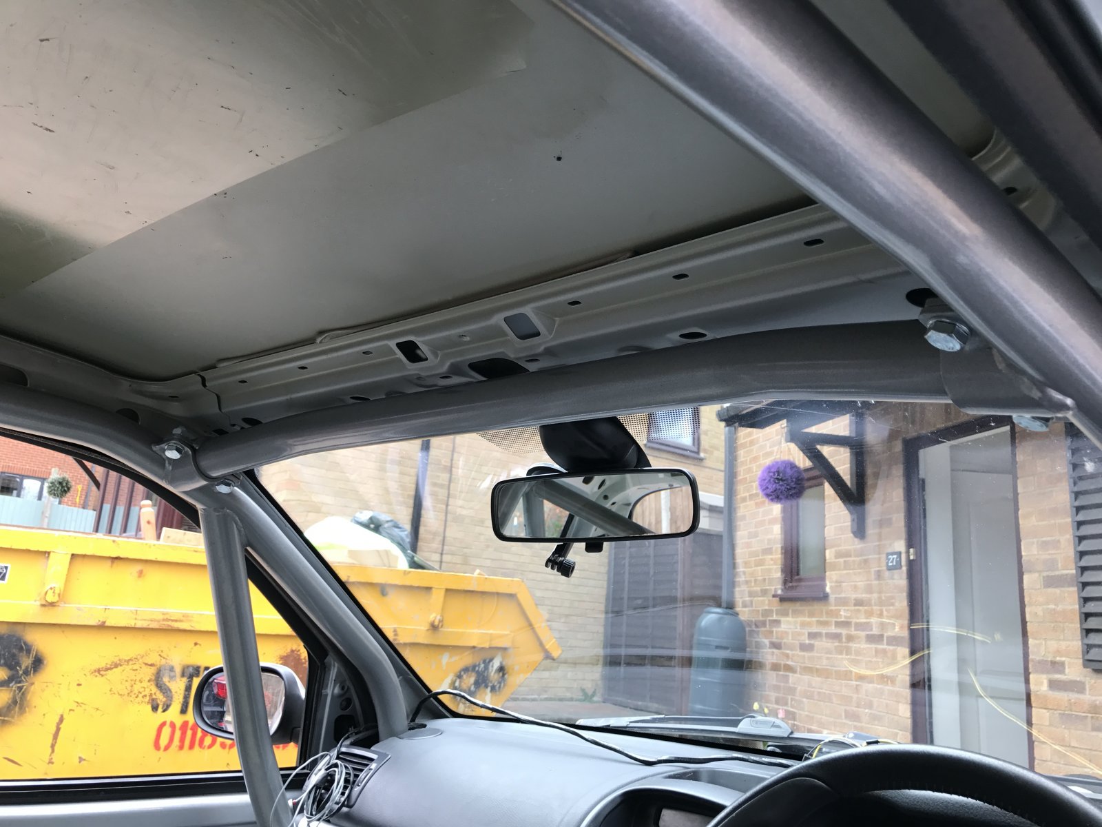

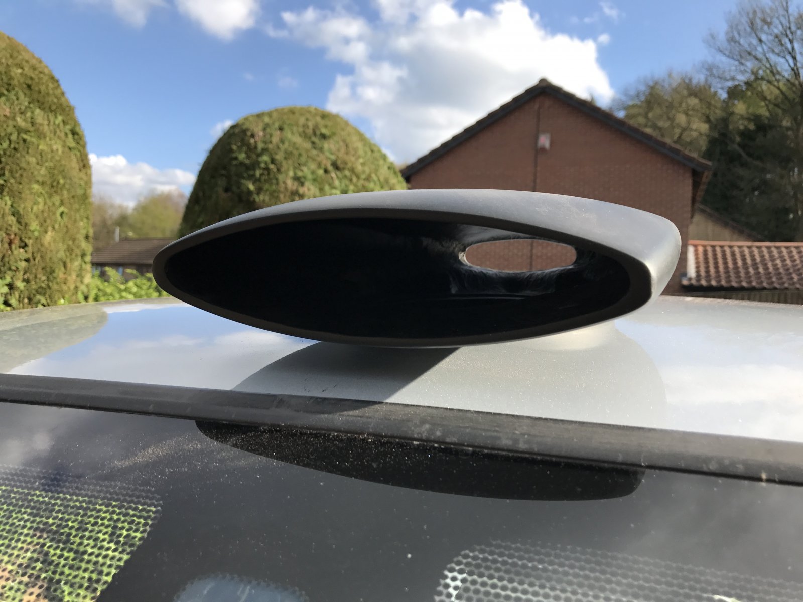

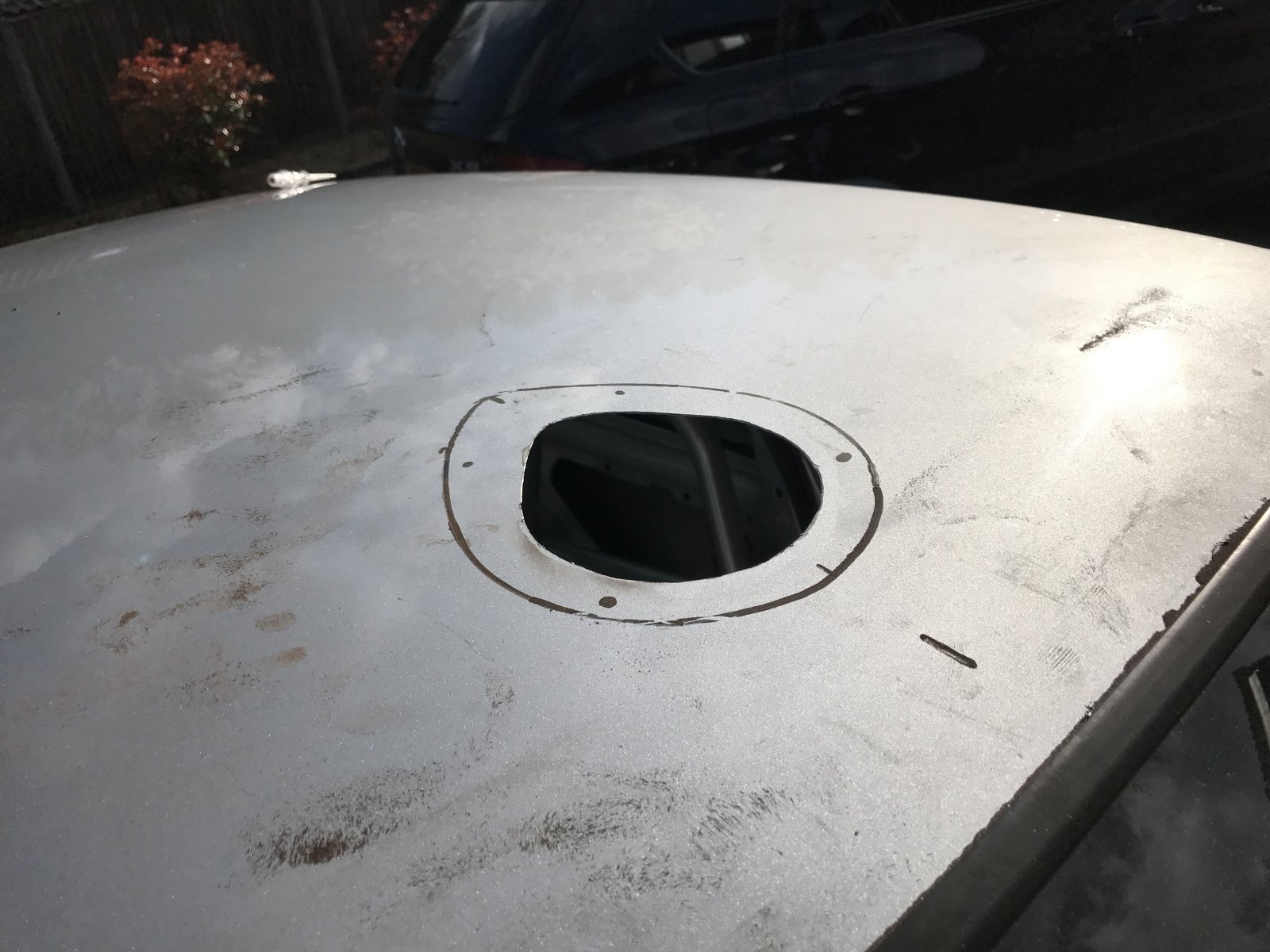

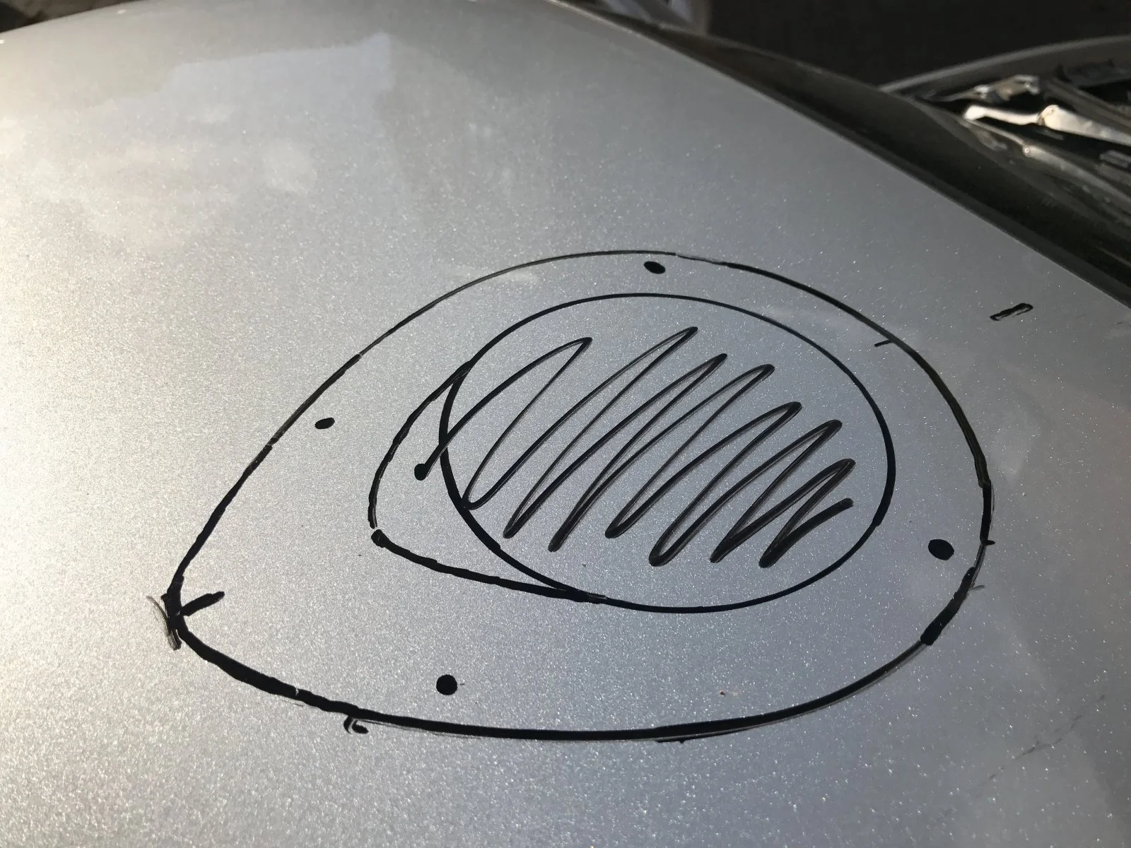

Then came a scary half an hour, cutting a big hole in the roof! Measure twice but once, it all went well to be honest. The new dremel multitool came in handy.
A productive weekend but many more are needed.

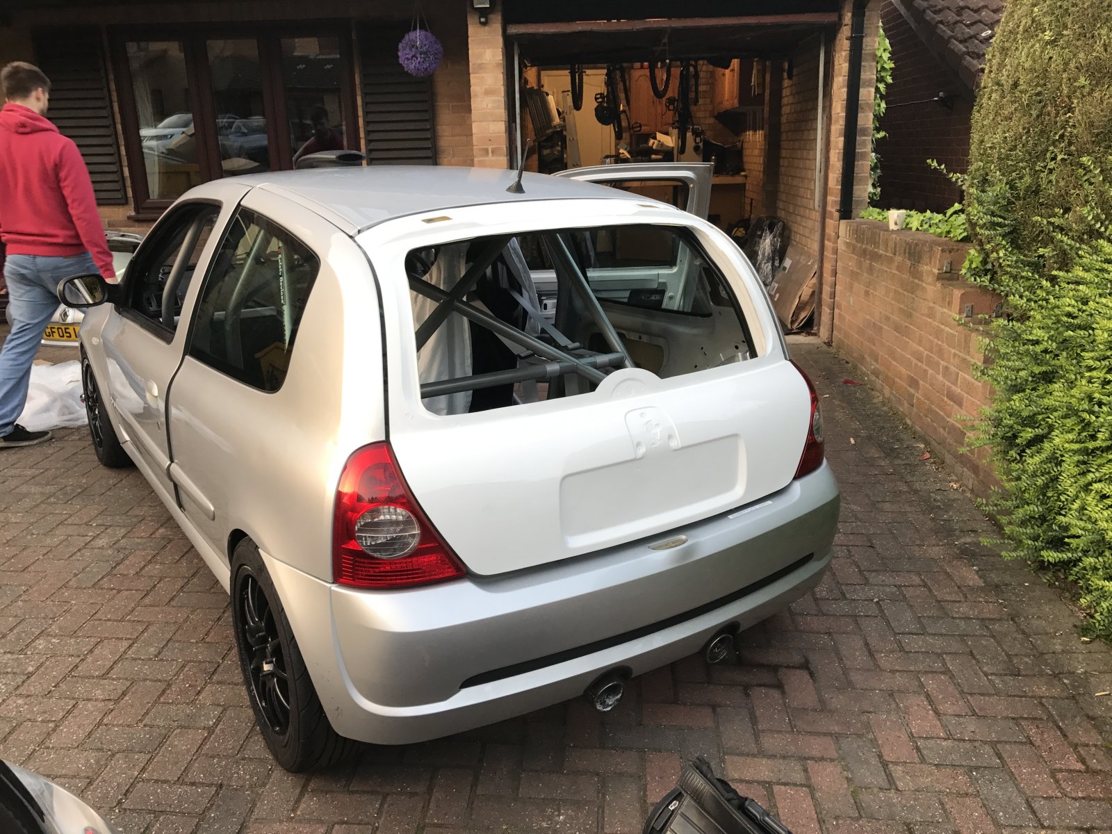

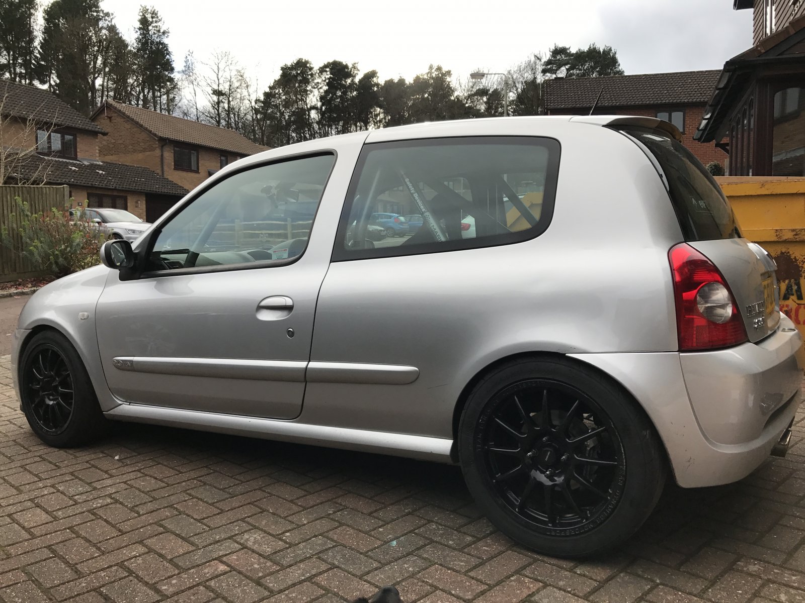

Managed another night on the car. Attached the fibreglass boot and spoiler temporarily.

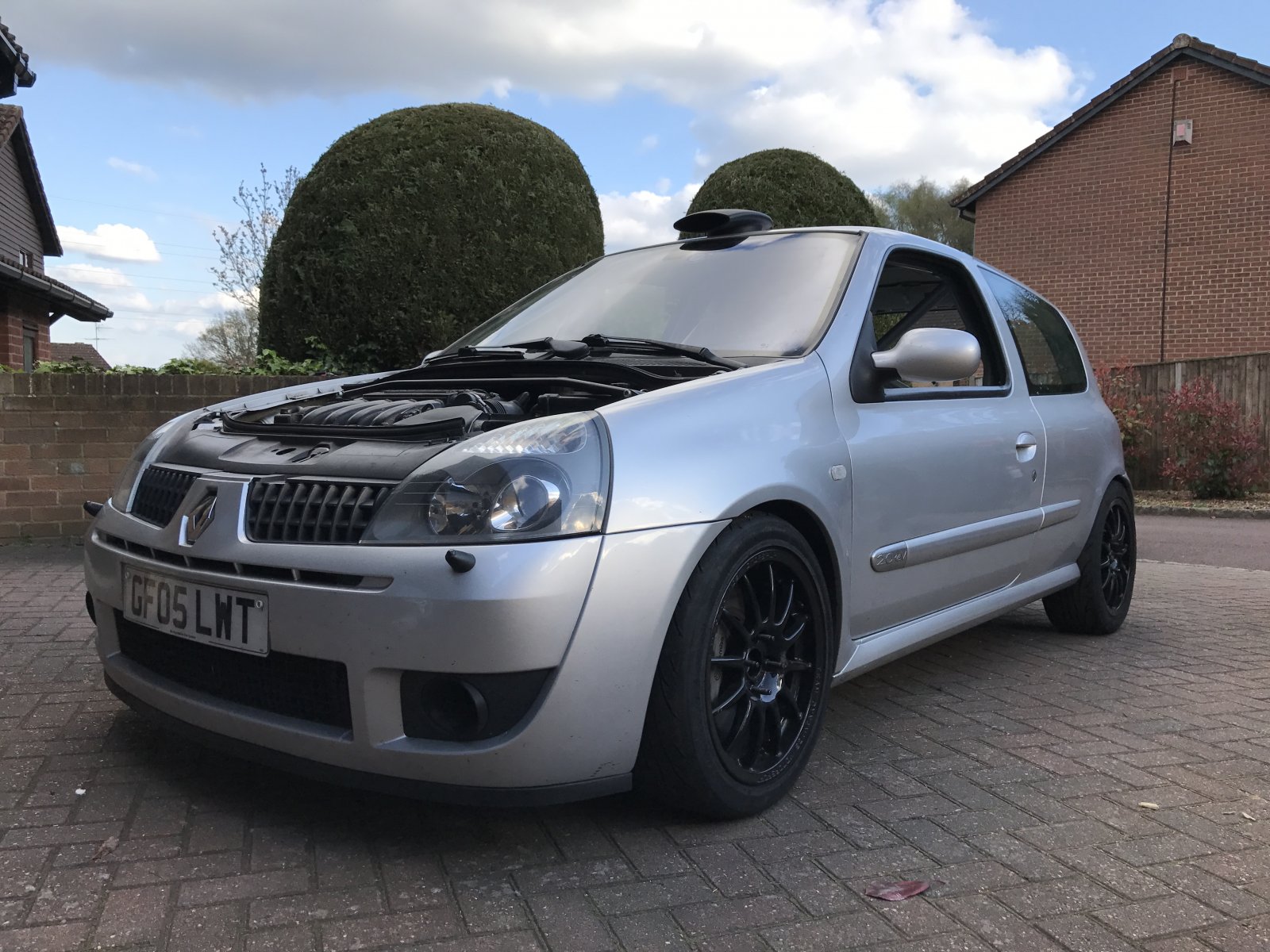

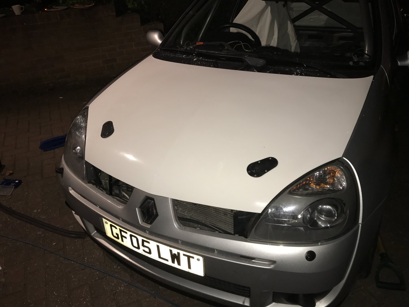

Managed to fit the bonnet with aero catches. Ended up finishing this in the dark 😅

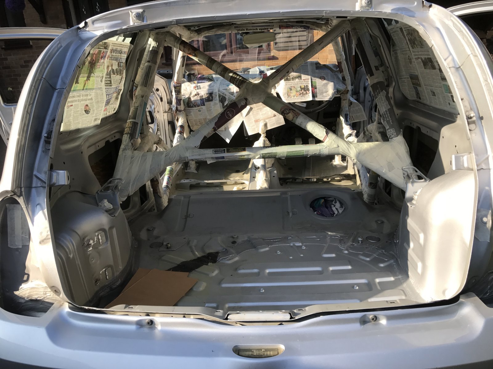

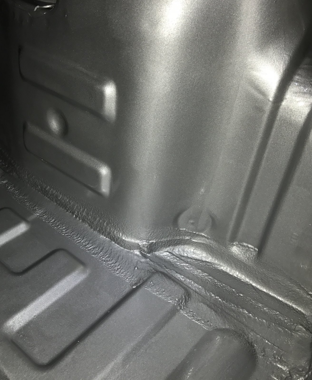

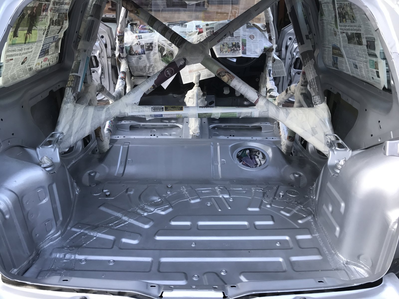

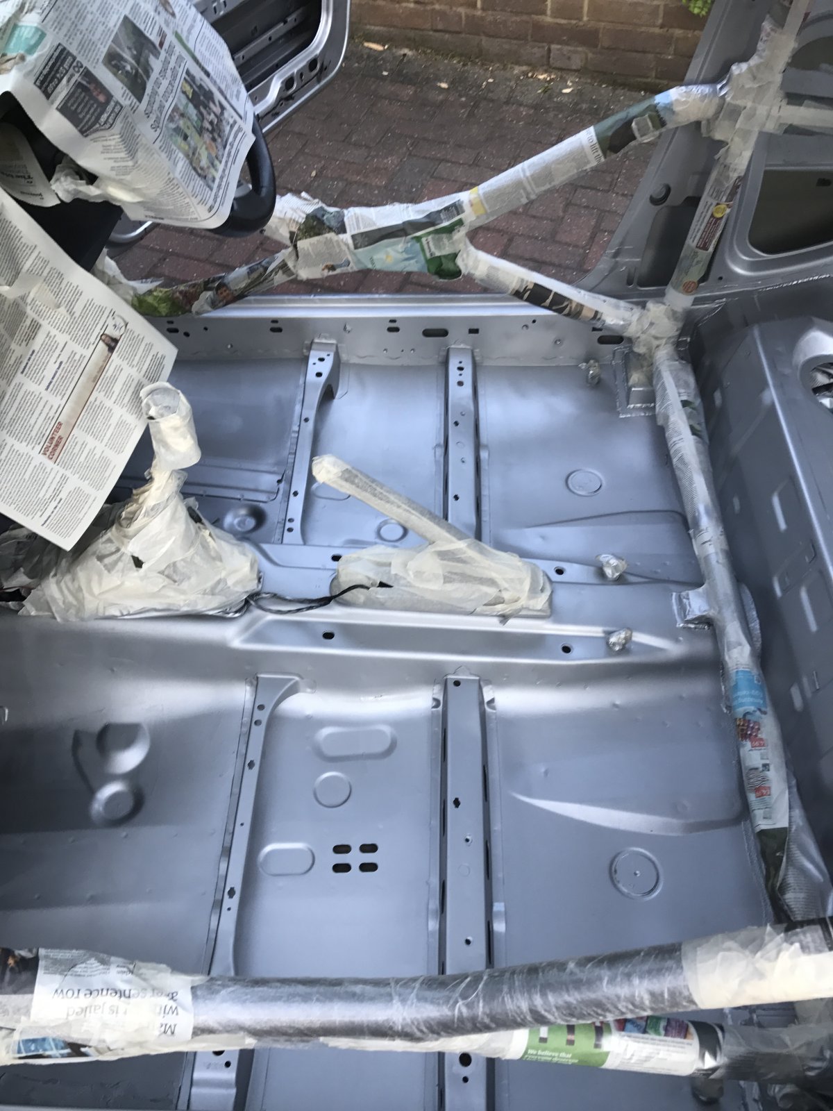

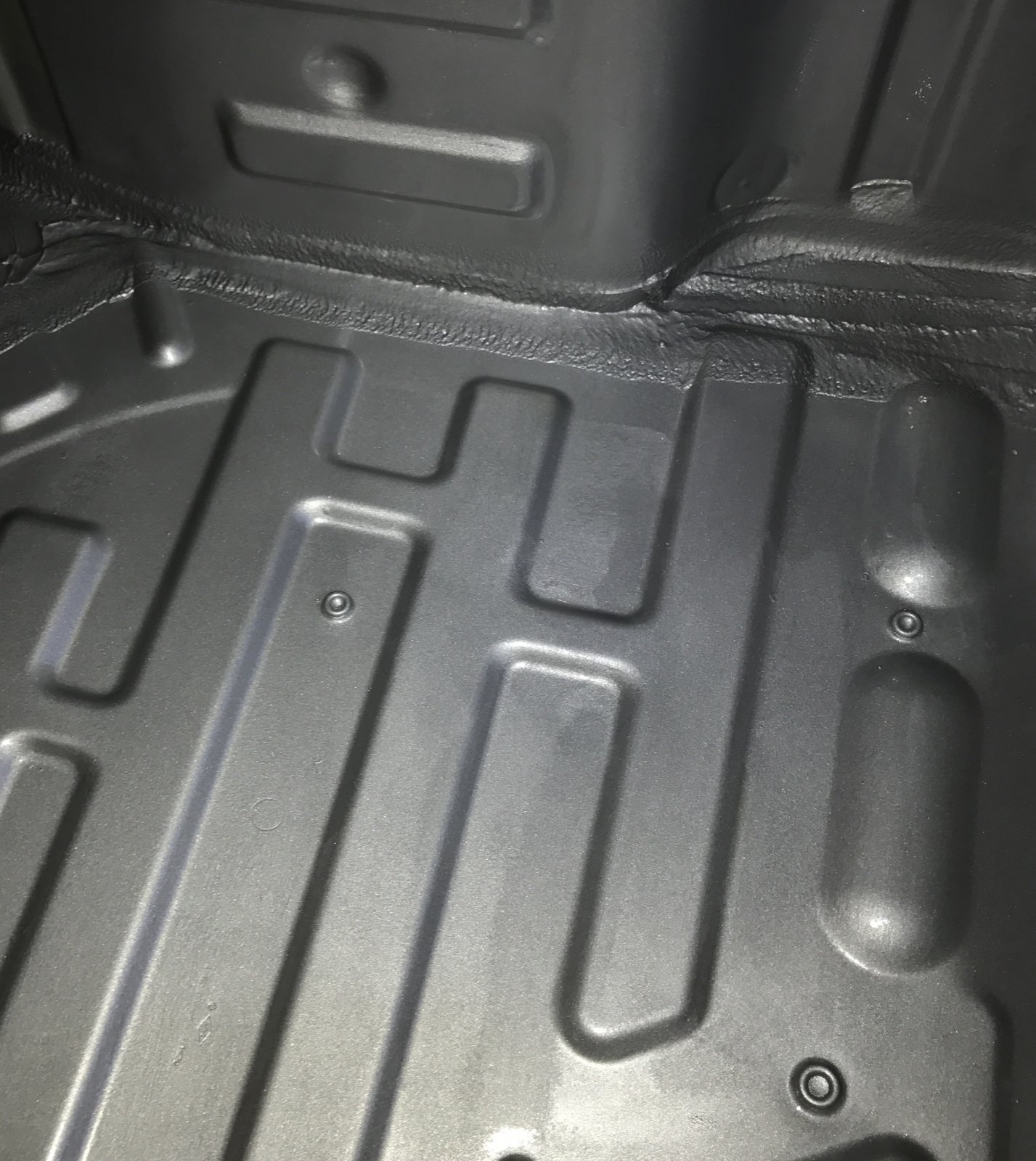

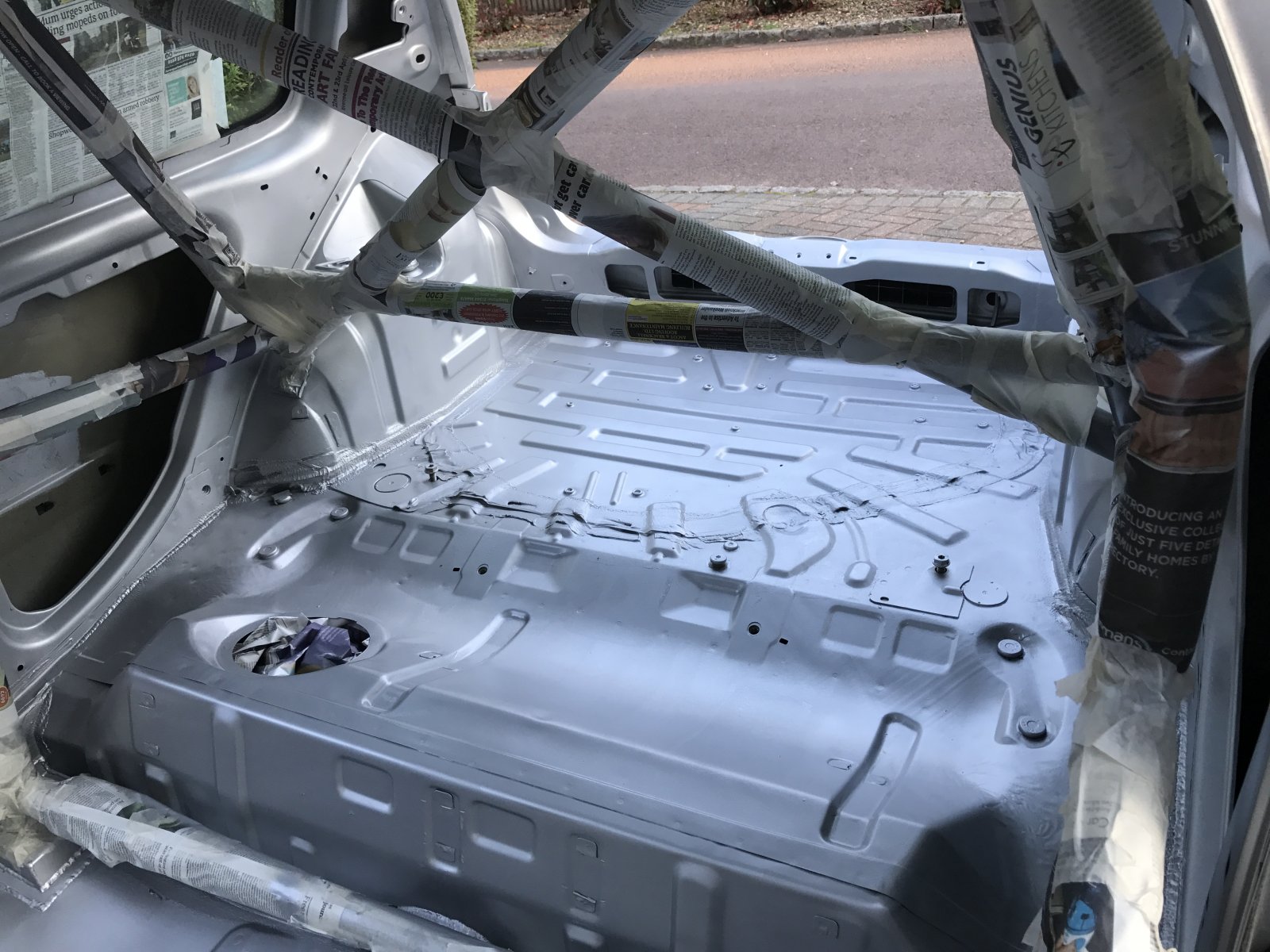

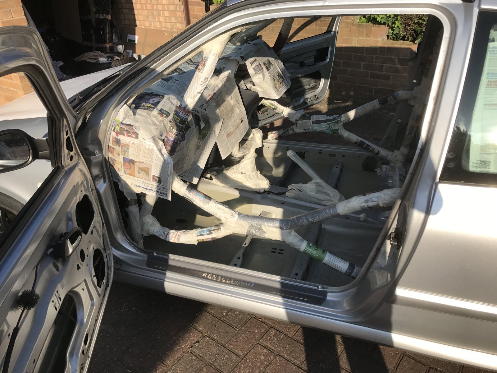

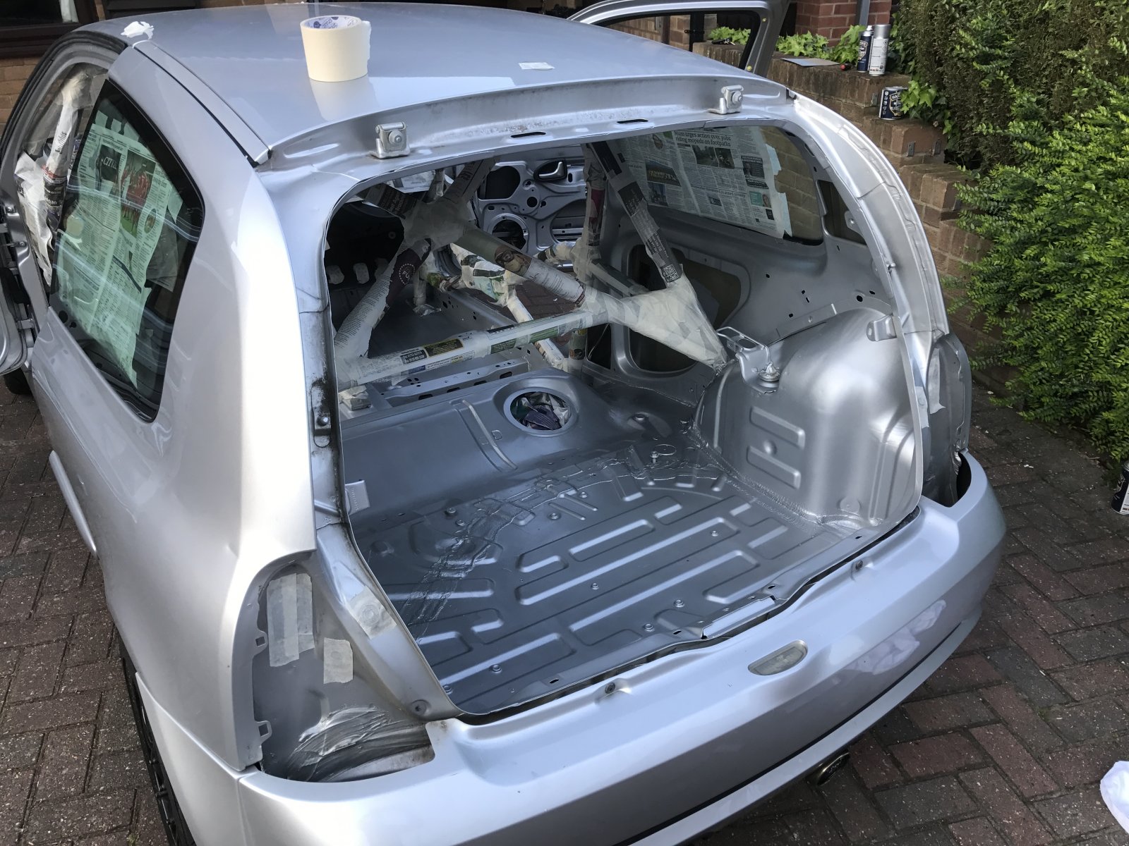

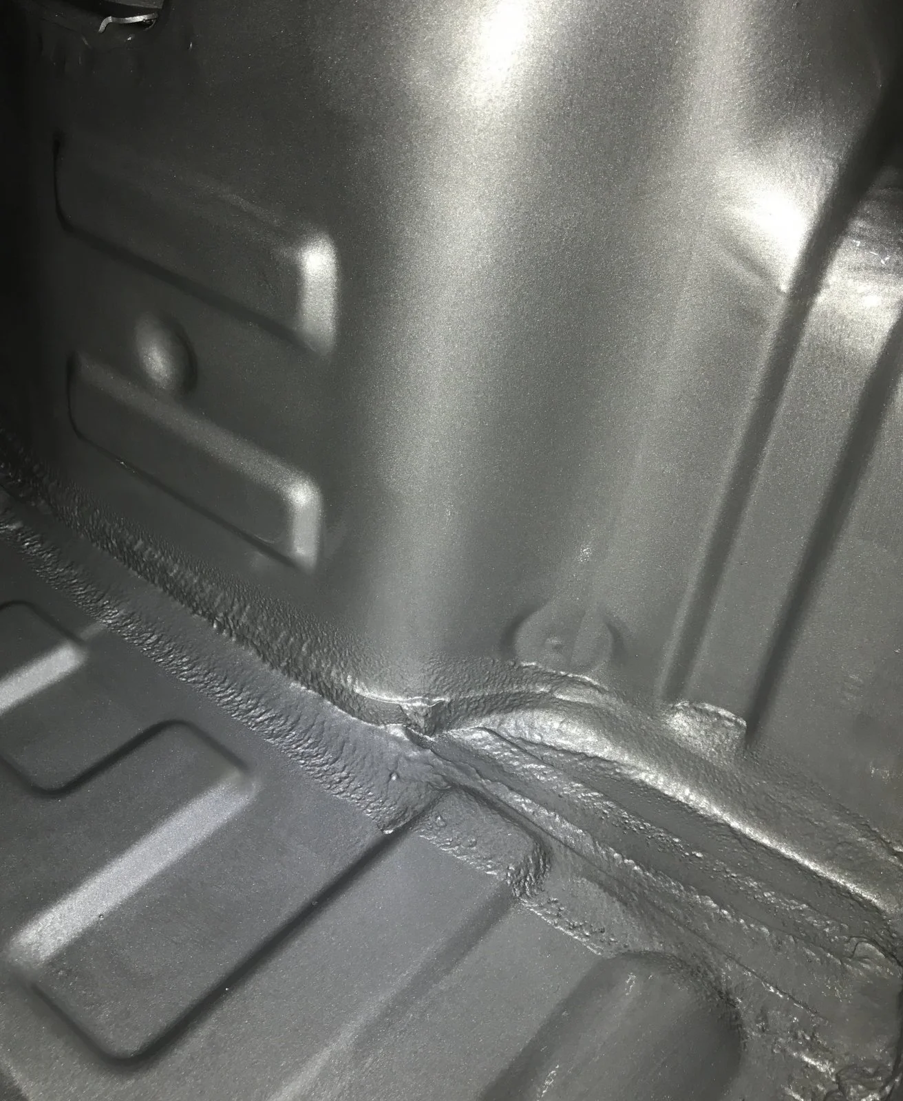

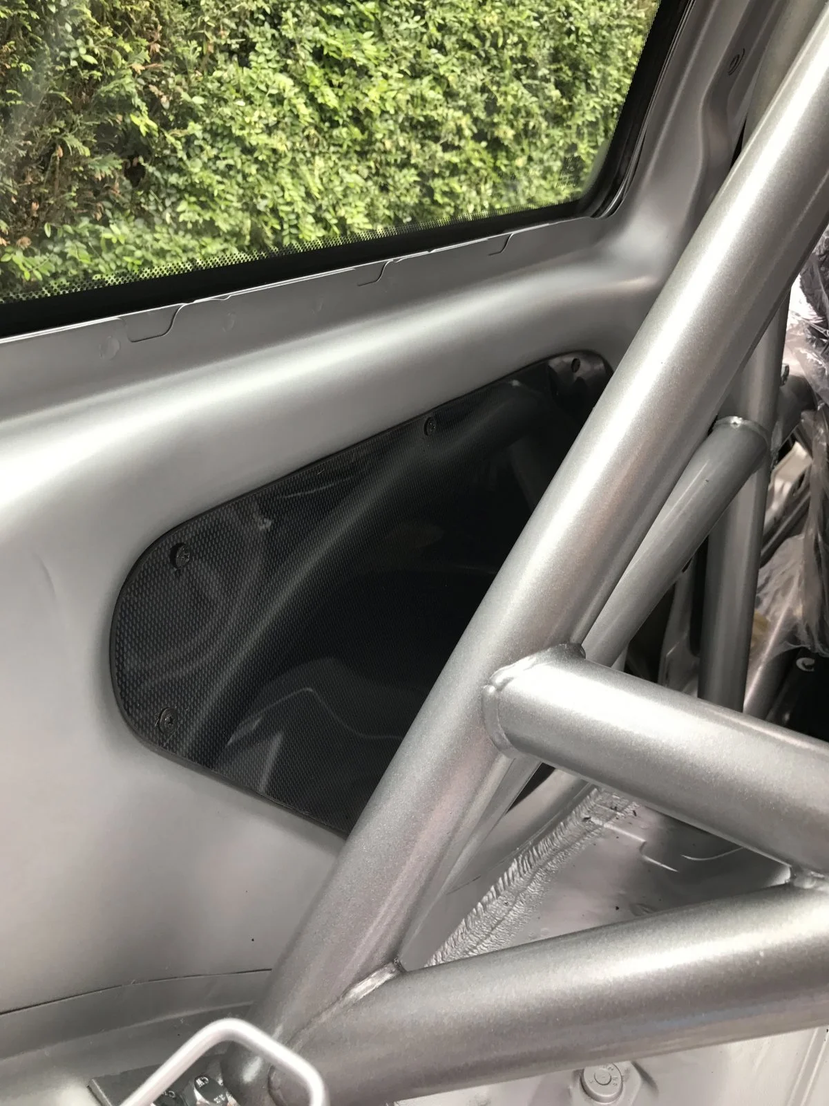

One of the most tedious days of my life, masking off the cage then rubbing down the inside! However this has turned into a very satisfying day as the inside is now painted!
Before-
After-
I used silver smooth Hammerite. Rollered the flat bits and sprayed the corners. Cost approx £50. The colour match is spookily similar! And it will be easy to touch up if it gets scratch/damaged.
Now I need to get a car in a garage with wet paint 😂
Also, take off as much masking tape that you can whilst it's still wet.
This will stop the paint from cracking along the edges when you take it off whilst dry.
(This is what I've always been told... Shoot me if I'm wrong 🙈:grimacing:)

No worries! I didn't paint up to the masking tape. It was only there to stop drips/over spray etc. When the cage was fitted they painted a few inches around it. This made it a lot easier to pant!

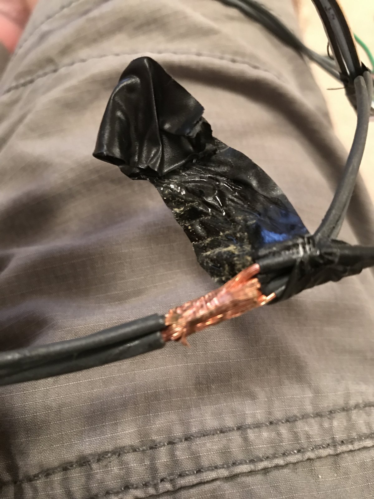

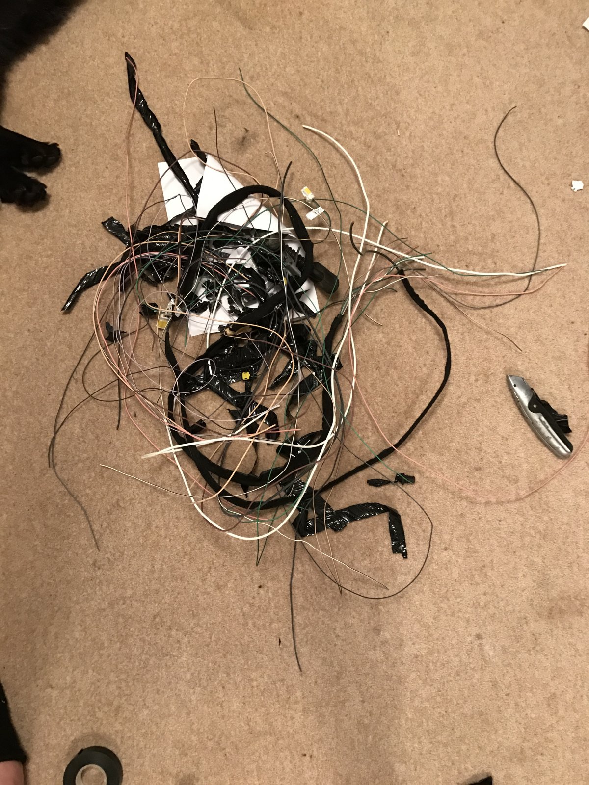

Also I have had a sort out of the internal wiring harness, the main reason being I don't want wires running across the car for no reason (not so much to loose the weight!).
What went
Suprised to find this a couple of times! French electrics........

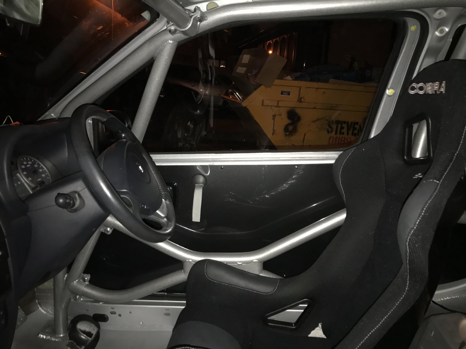

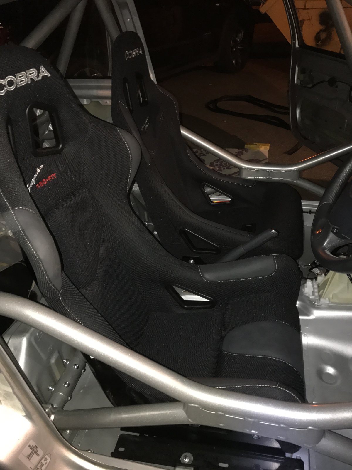

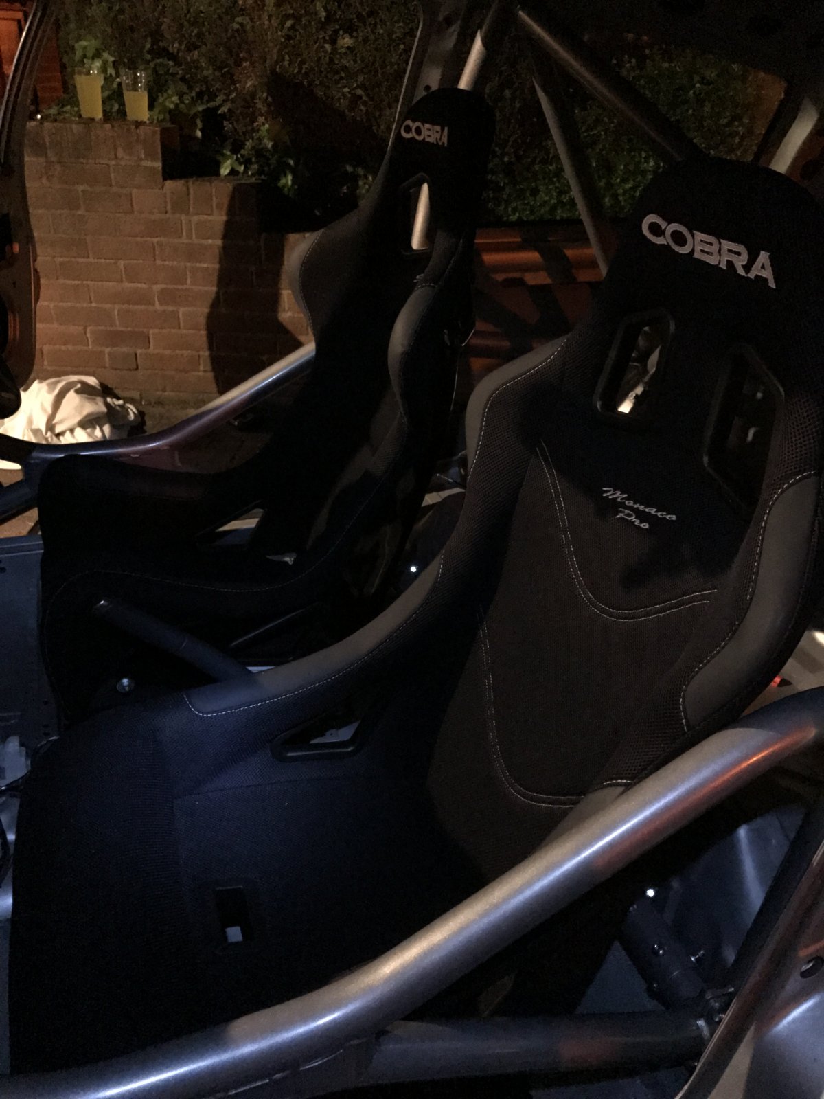

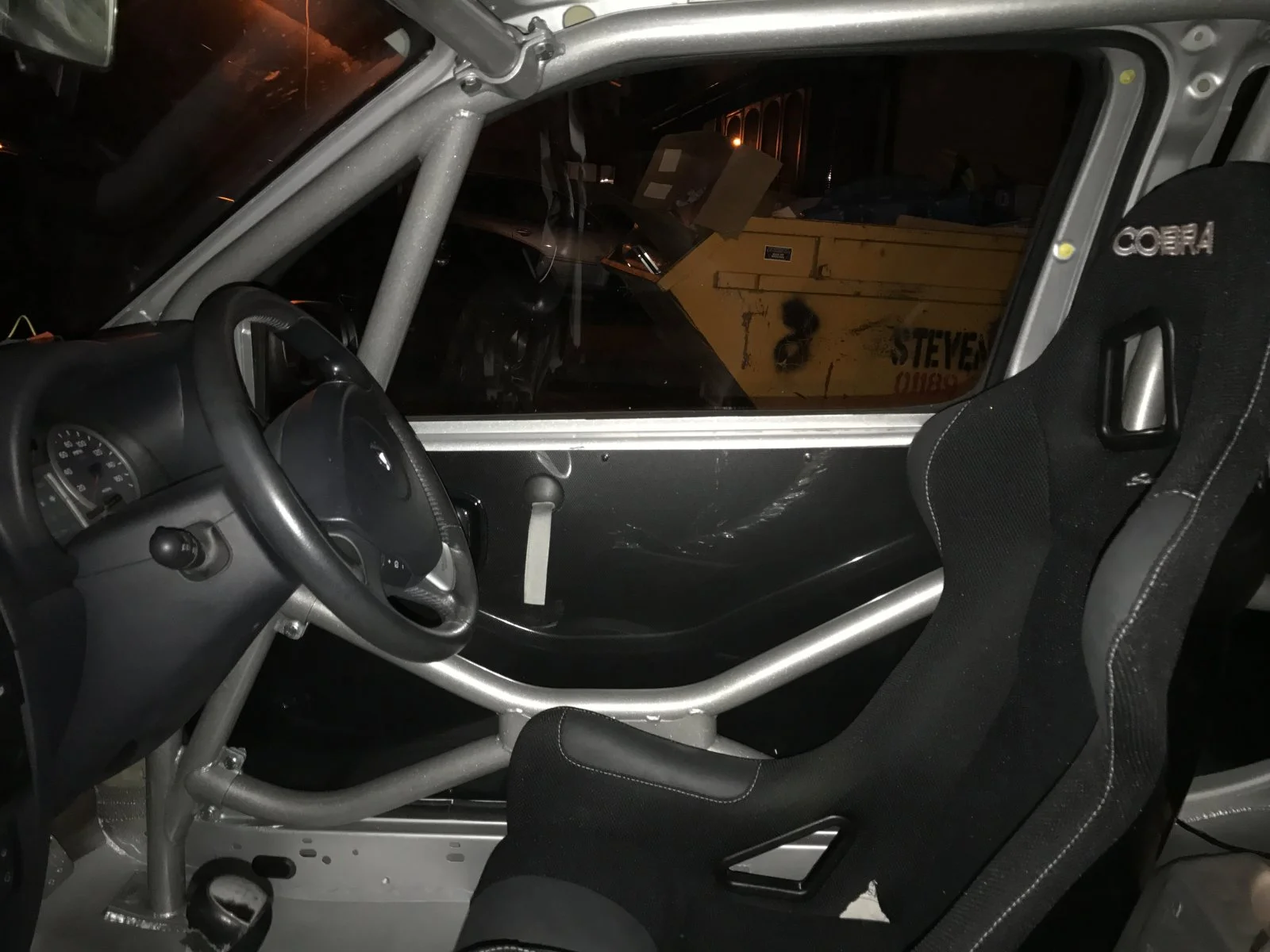

Another late night, I think the neighbours think I'm crazy! The wiring harness is back in and clipped in, the rear door cards are in but best of all for the first time in 5 months the car has two permantly fixed in seats! The side mounting points have been adapted so they are both on their lowest settings. I sat in both seats for the first time (two different styles of seats) and I'm happy :smile:
Momentum on the build is good at the moment, I can't wait to get on with the next bits!

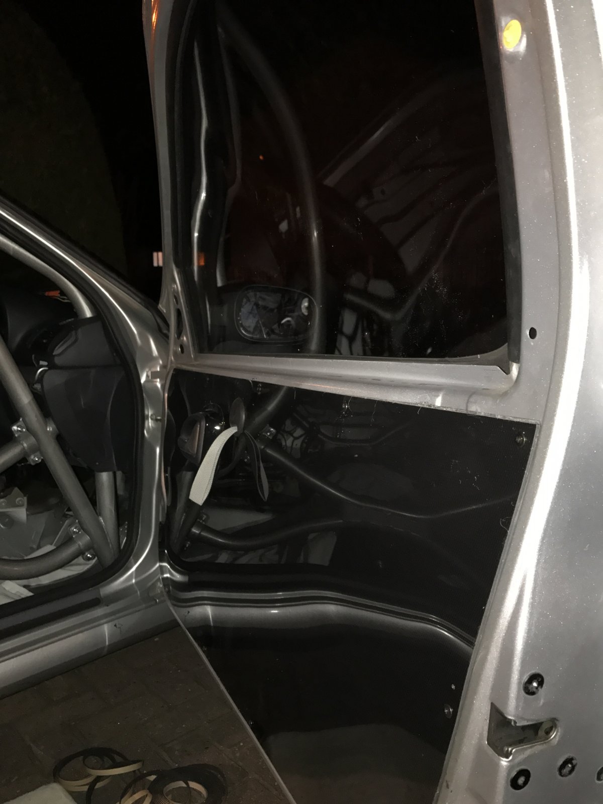

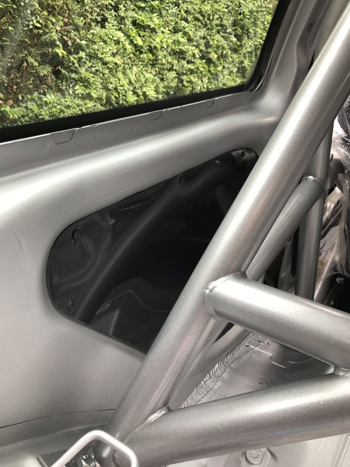

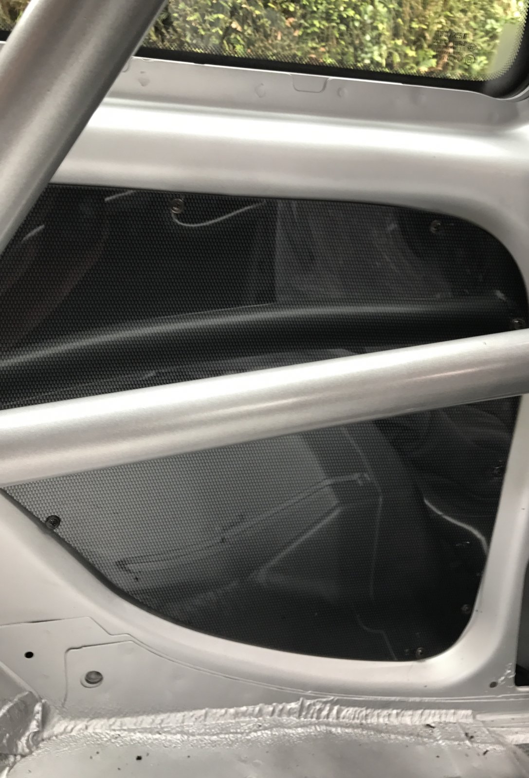

Firstly I could look at the the new rear door cards in daylight. I'm happy with them.

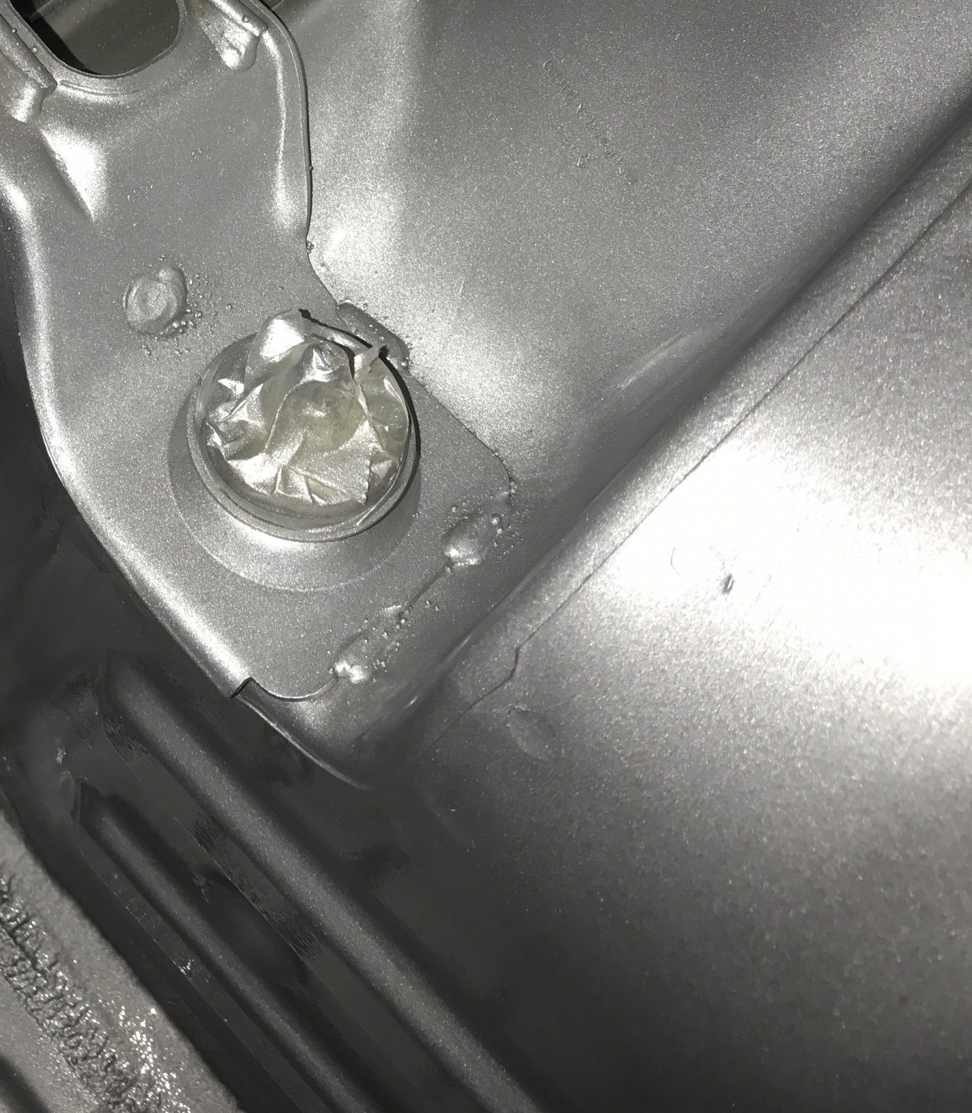

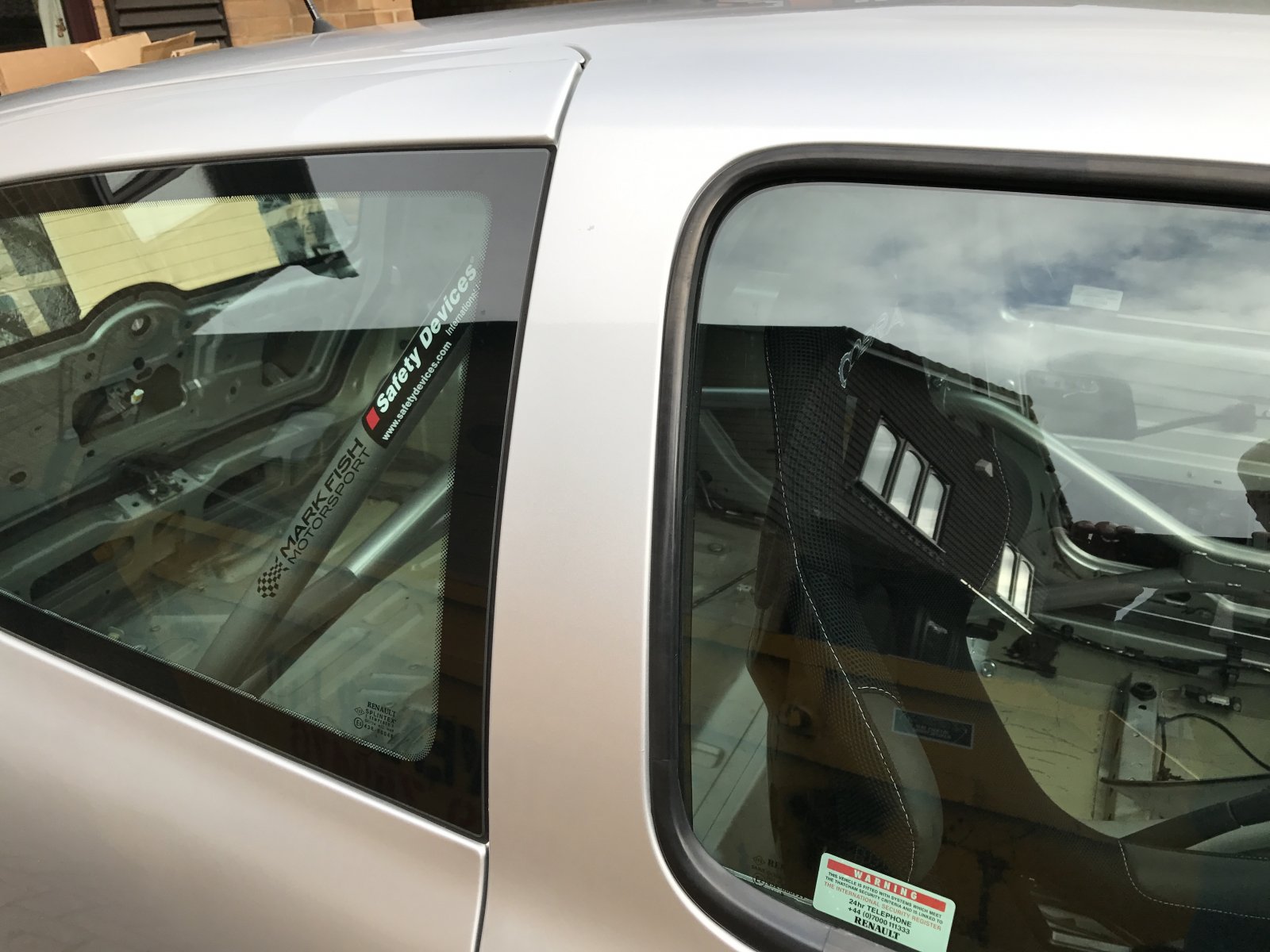

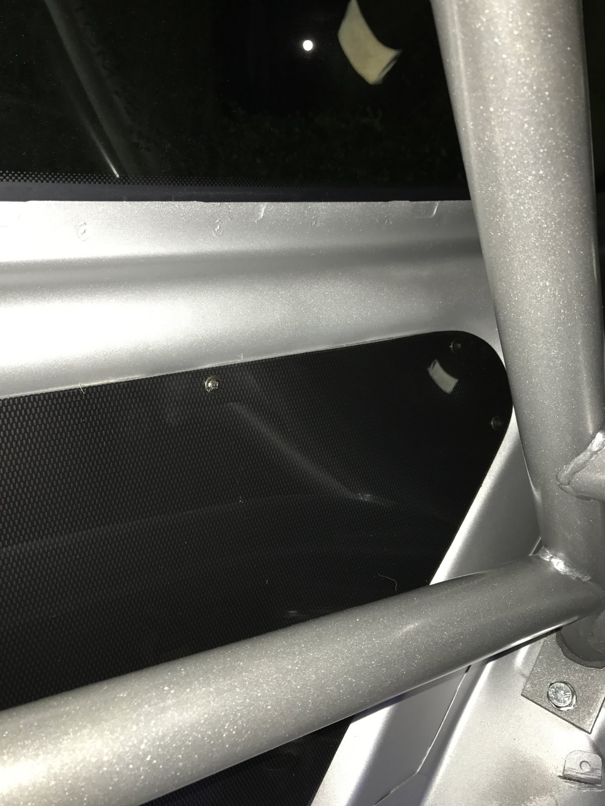

The first plastic window is in. I used the centre mounting bar and fixed the clip that passes through the hole on the original glass window. Super nevious drilling a brand new window :fearscream:
Hard to see the window but it's in there!

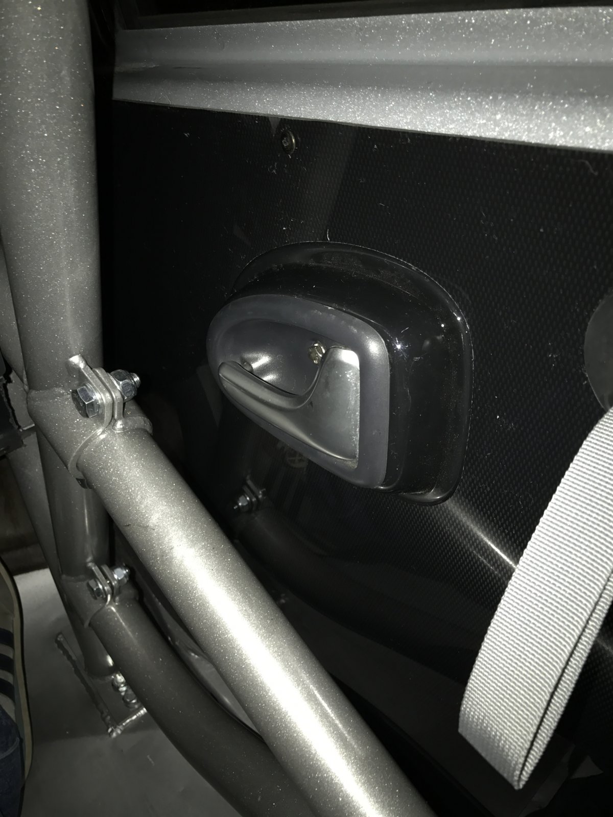

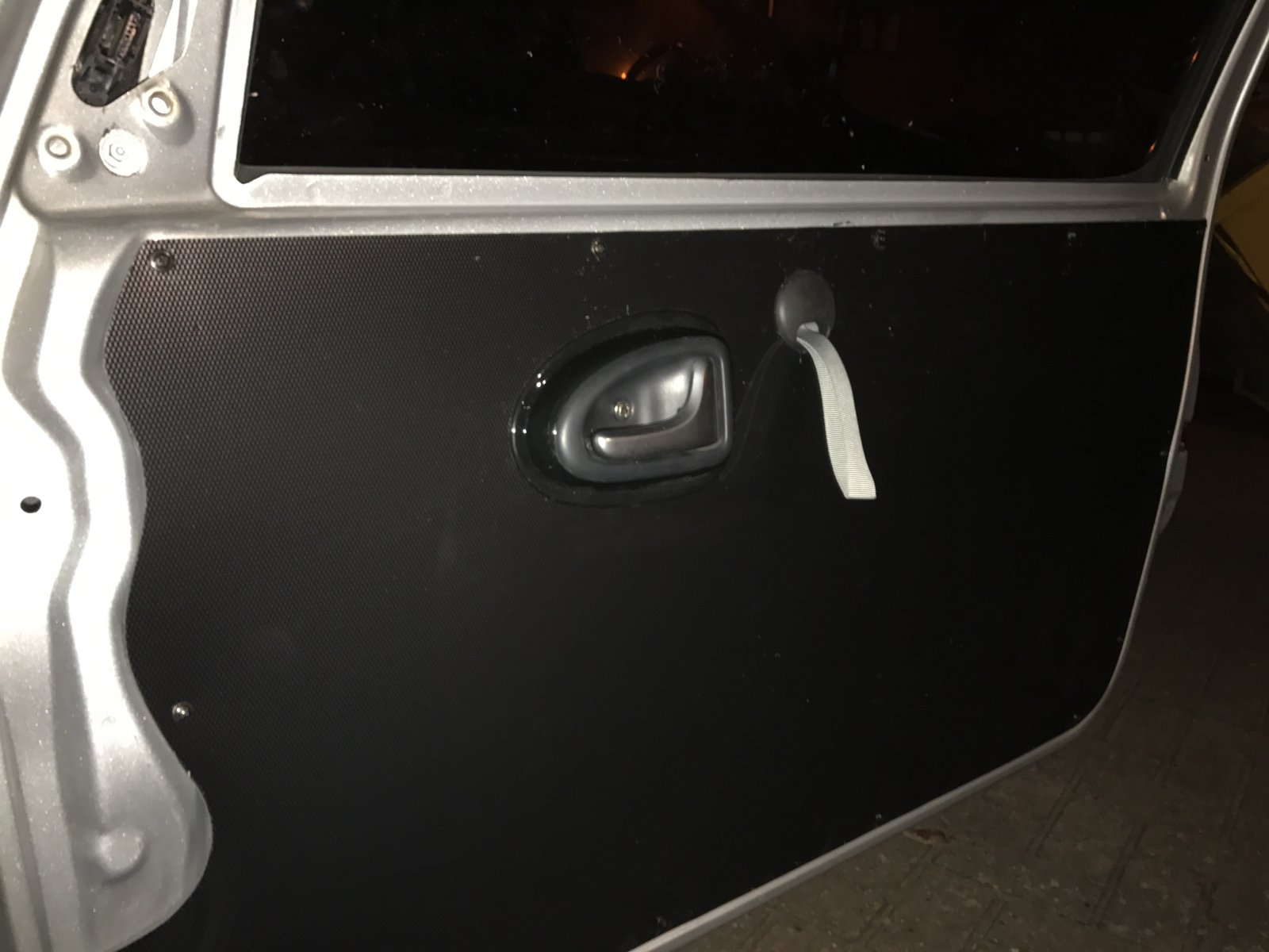

Also managed to get the drivers door card in. I have left the cables in for the mirrors, windows etc just in case I want to use them again. As with the rear I have used foam seal to stop any rattles (pointless in a car with no sound deadening?!).
Used the grey door handle straps and handle spacers. Just need to get the passenger one on now. Should be easier second time round.
