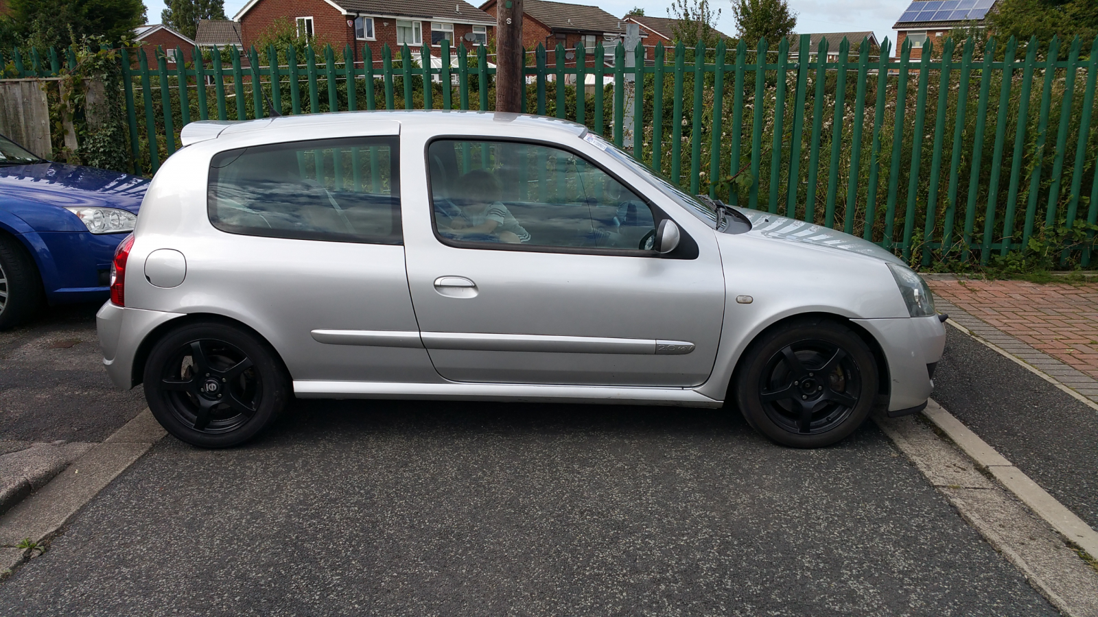

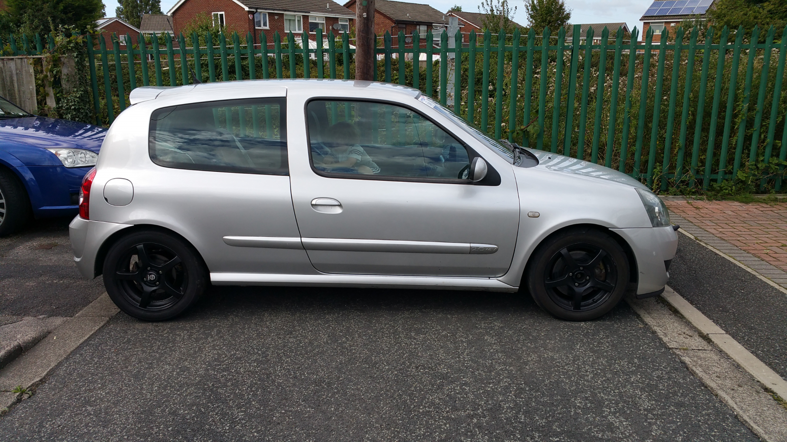

Yeah I rate them highly. Not too crashy, ride well and like you say sits nicely.
Thing I like is that it sits lower at the front as a comparison to others I’ve tried where they seem to sit more even. The rear could do with sitting lower for looks but on 15’s it works quite well.

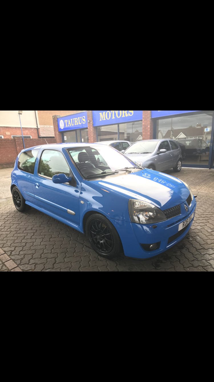

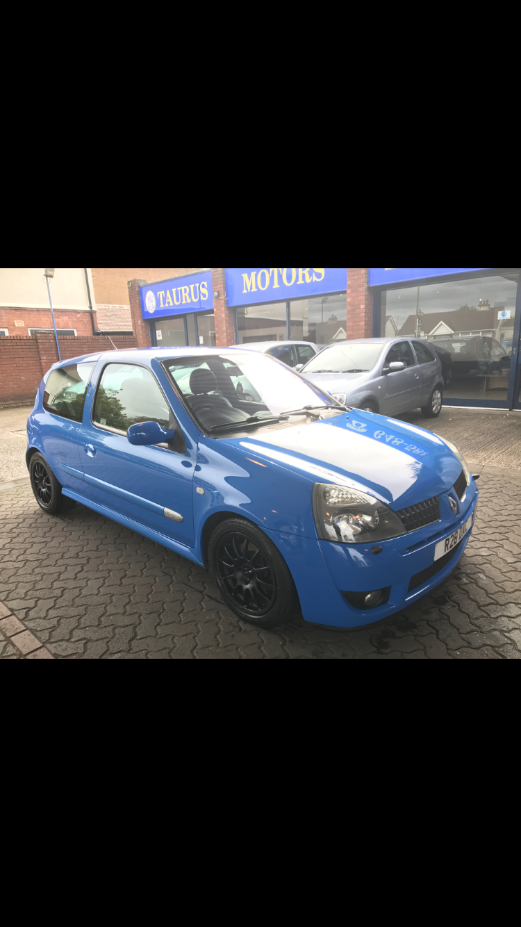

Road & occasional track, rides lovely.
182 cup pack dampers
Cooksport springs
Solid top mounts
Camber bolts
Whiteline rear ARB
Polybushed wishbones, arb, steering rack mounts.
Next on list is epas, best mod on my last Cup.
