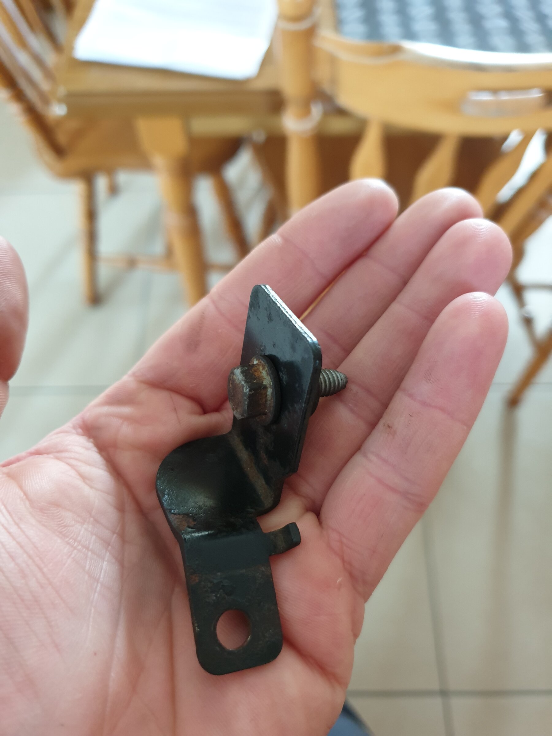

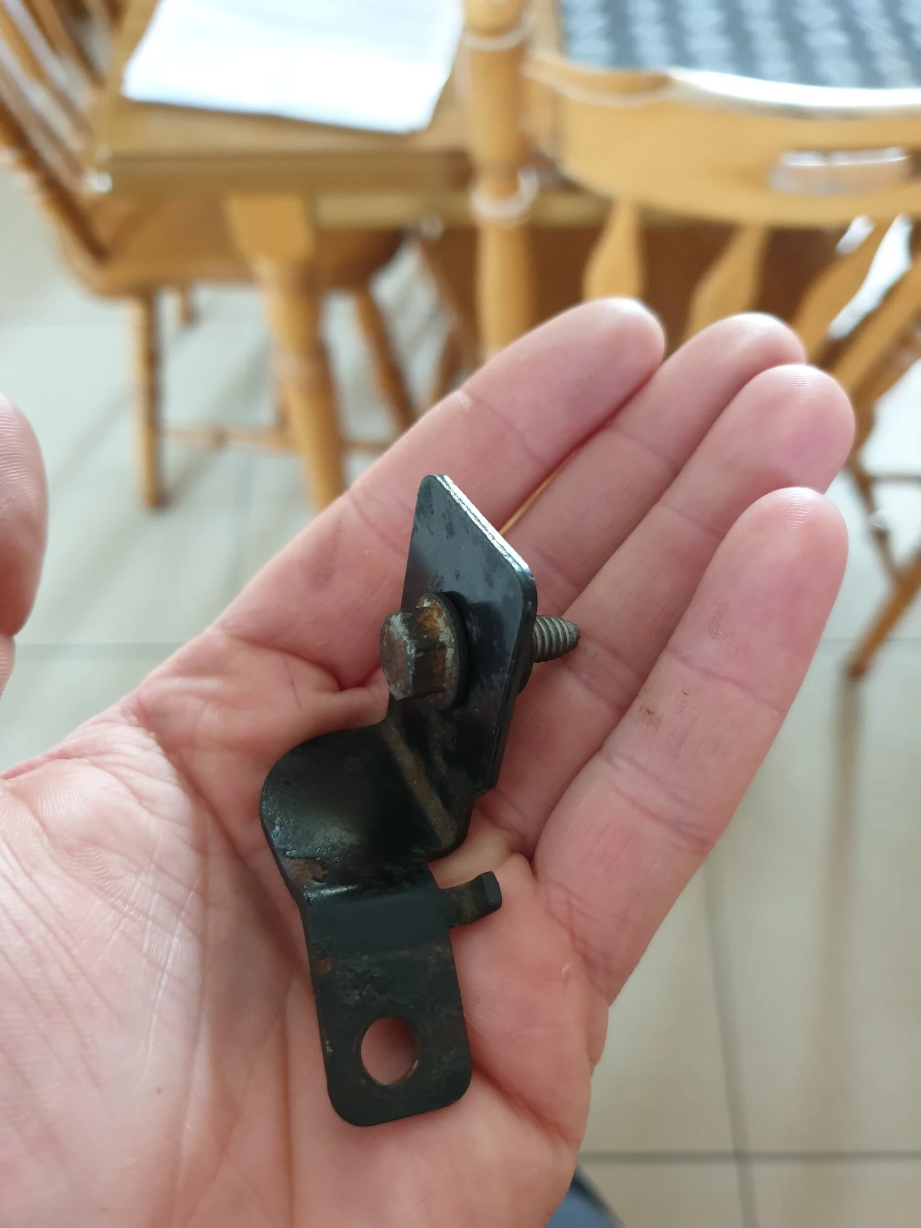

Hi all, finished the clutch change last night along with new ARB and steering rack bushes, and also ball joints and track rod ends. The car feels fantastic now. I went with dropping the subframe completely on the passenger side and moving the gearbox into the wheel arch, more than enough room to change the clutch. Every bolt back in except for this little bracket that I can't figure out. It appears it would be from the ECU support bracket that runs to the crash bar. If anyone knows where it goes that would be great! Thanks all for the help, really chuffed with how everything turned out.
  monaco 172
Haha I ended up with the exact same part left over last time around.
I seem to remember it going on the end of that support bar that runs next to the battery from the ECU to the front but I never re fit it before selling the car, I believe it's still in my toolbox lol
