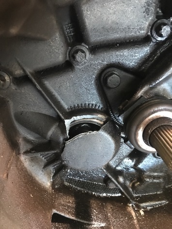

Gearbox mainshaft bearings?
If so, get it rebuilt now, before it does this.

God hope not, would it still make the noise even coasting in neutral if it was this? How much did the rebuild set you back?
All the time the gearbox internals are rotating, so yes.
I had the forethought to obtain a known good used box in advance, though the timing of when it went bang was inconvenient.
@NorthloopCup is CS`s gearbox specialist when it comes to rebuilds.
Fingers crossed it`s a wheel bearing, but I would expect that to change note when cornering.
JC5-130 is the one for the 182
