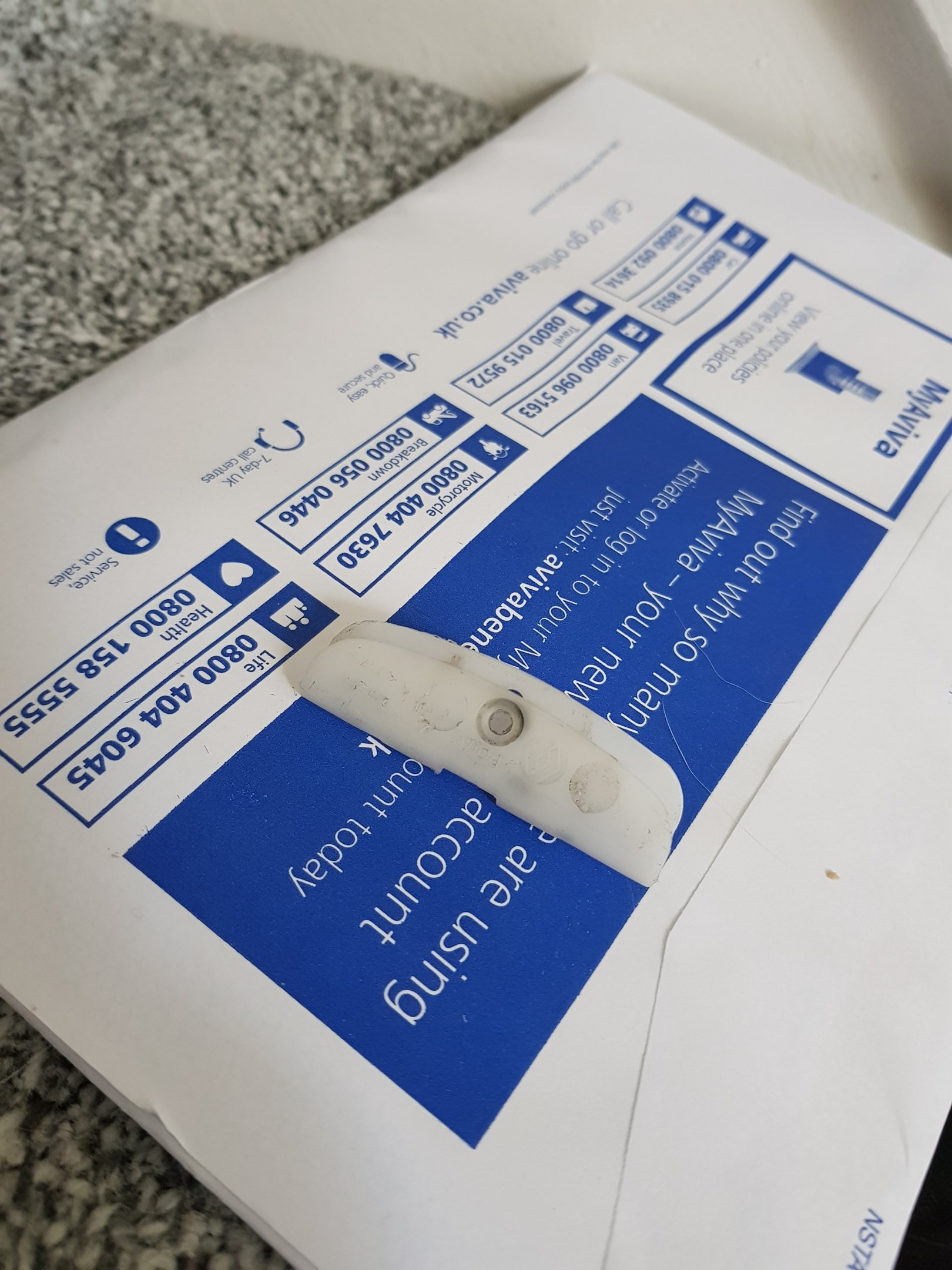

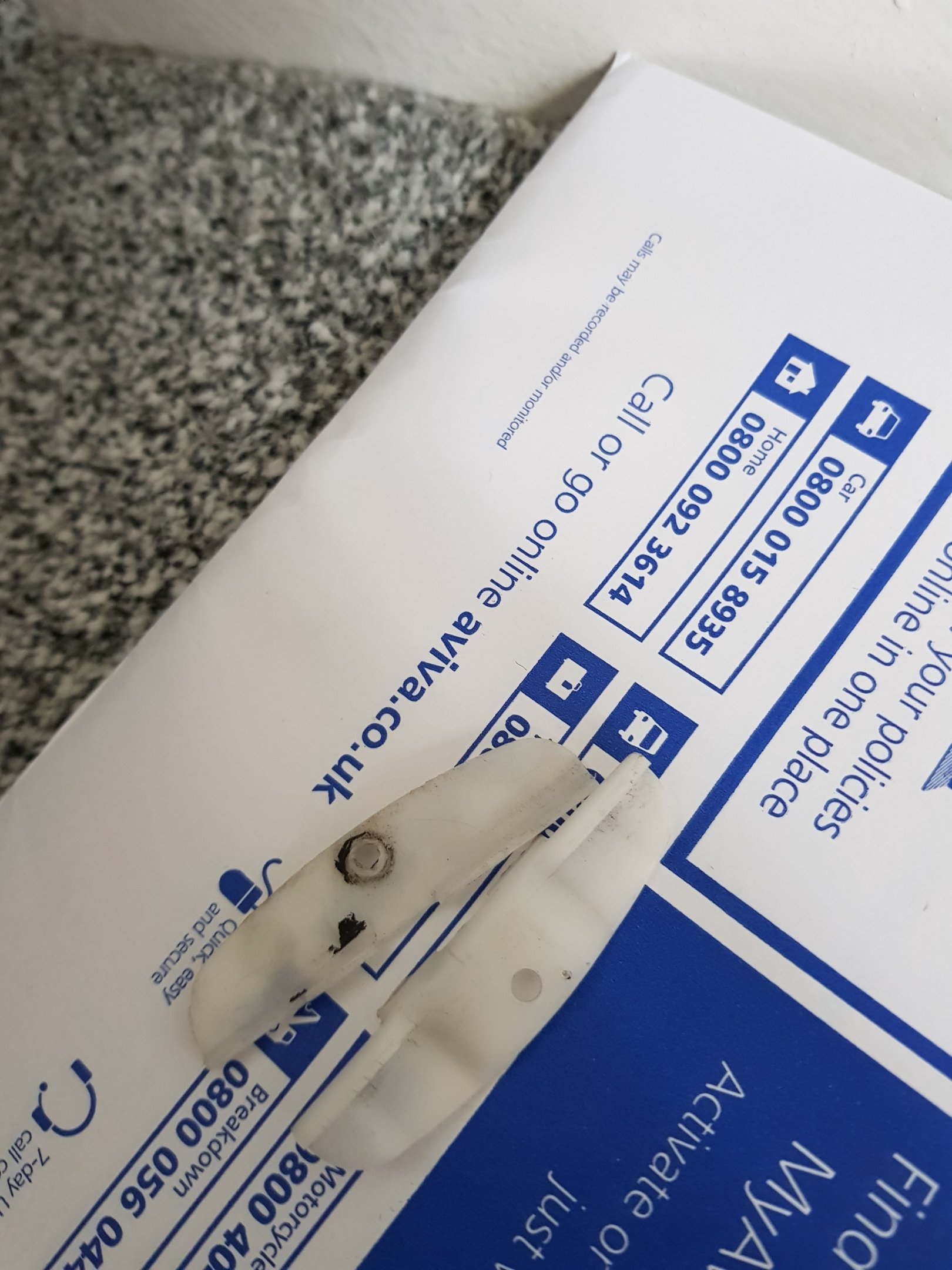

I put the window down yesterday an when I put it back up again this white clip thing came out of the runner and now the window wont close properly unless you apply some pressure on it. Any ideas on how to repair or where I can get a replacement.

Common issue , if the small rivet has separated that'll be why it's fallen off .
Normally they crack which looks like what's happened to yours .
Look on eBay will cost pennies
