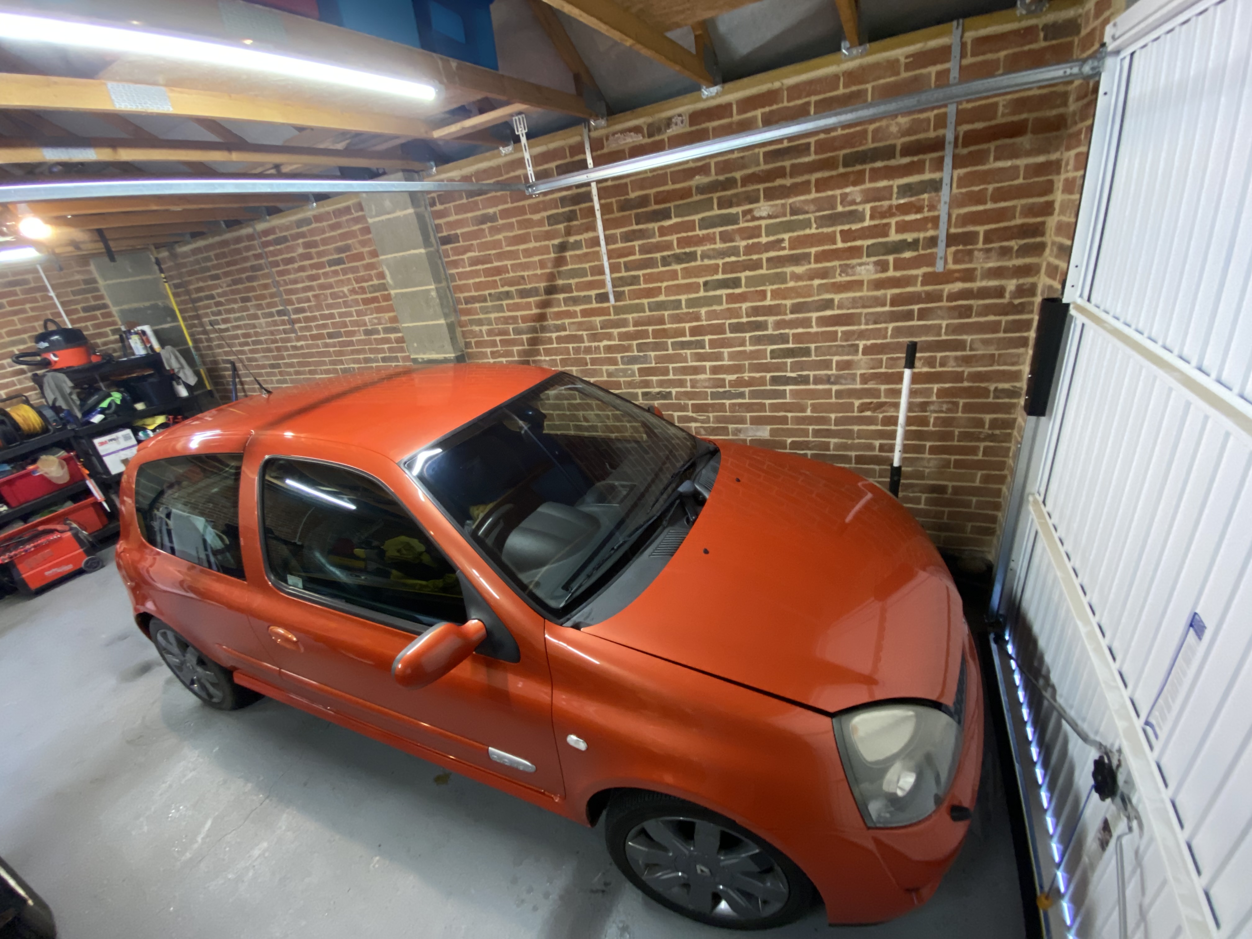

Hi everyone , i am struggling to find good quality wishbones for my 05 182 . Does anyone know where I could find some ? I have tried RPD and ktec but both are out of stock . Also it has the cup packs so are the wishbones, ball joints , track rod ends , hub etc the same as a non cup pack model ?
Many thanks Sam .

I believe the wishbones are NLA from Renault.I would say your best best at this point is probably to have the wishbones off the car, blasted, bushes removed, painted/powder coated and new bushes pressed back in.
The ball join is still available on its own and there are lots of alternative suppliers (good) for the joint.
You can also buy aftermarket wishbones but their quality seems very hit and miss. No difference between cup/non cup lower arms afaik but that is only true for the 182!
