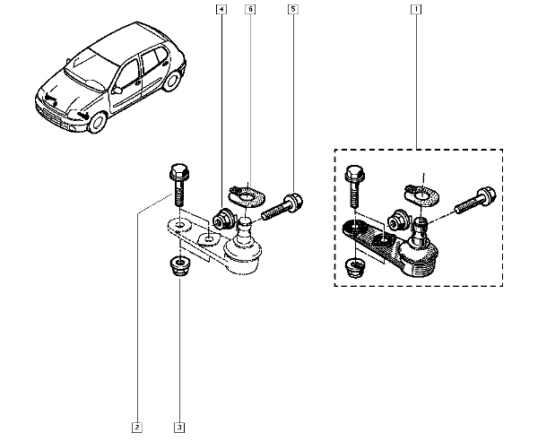

  2. Part numbers - I'm getting very confused with part numbers relating for the Cup. From what I can see the Cup has different wishbones, track rods and subframe. I've also seen that the there is only one type of wishbone you can buy now and there is no cup/non-cup varient. Does this mean that all 172 wishbones have the correct caster for the cup? It doesn't help that when I go on to AutoDoc, I get presented with a lot of different options, especially for track rods with different lengths.
I've seen the sticky but I don't know if these are for the cup.

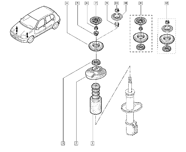

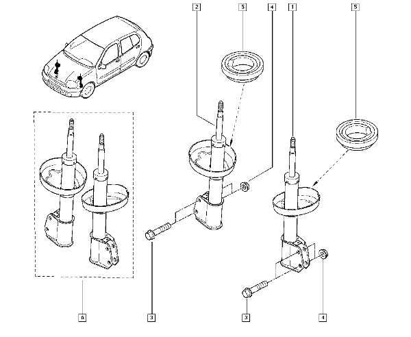

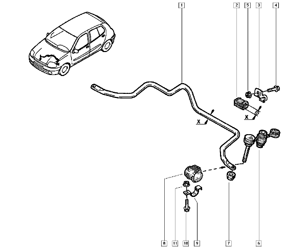

Also, does anyone have an exploded diagram from the suspension components, might help me identify a few replacement parts that are looking a bit worn, like the ARB Brackets
Hopefully these help, annoyingly they don't have part numbers on them.
Ask them to do the inner Anti-roll bar bushes as well.
Parts
CB1N - 172 Cup
Inner ARB bushes - 7700847383 (2)
Inner ARB brackets - 8200078548 (3)
Outer ARB Bushes - 7700784171 (8)
Outer ARB brackets - 546141405R (9)

That top mount is a perfect example, if I put the part number into autodoc, they sell them with or without bearing. I take I need a bearing?
Thanks both.
I’d just buy the genuine Renault ones when it comes to top-mounts, you’ll avoid all the faff. Check to see if RenaultPartsDirect or KamRacing are selling them.
