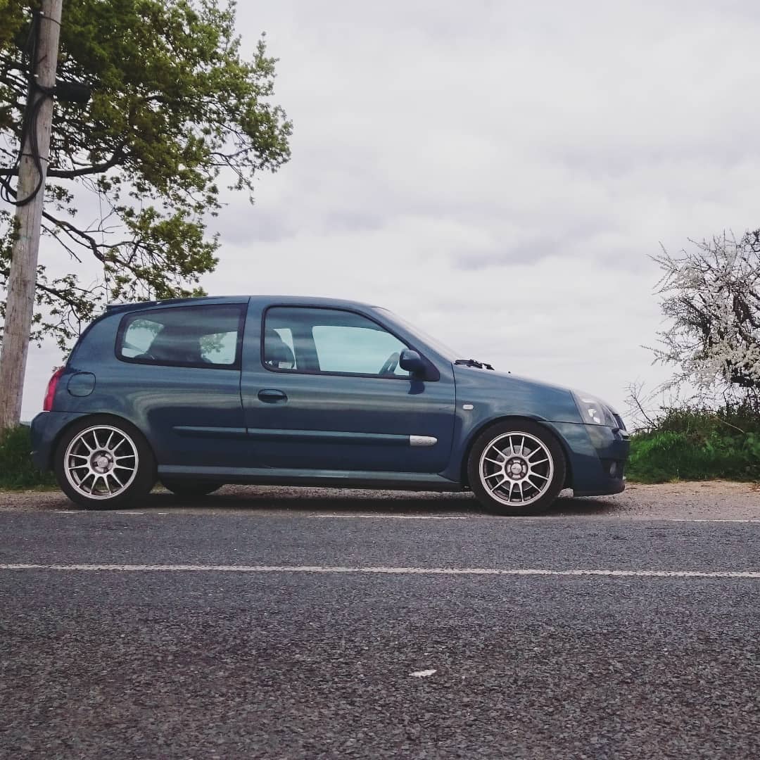

Clio 182 with OZ 16” ultraleggeras
There must be a few out there surely? Probably the best balance of looks and lightweight for the Clio 182 in my opinion.
The search function is your friend, albeit it’s a 172
Cheers. I did search and came across this but still no silver clios with silver oz ultraleggeras.

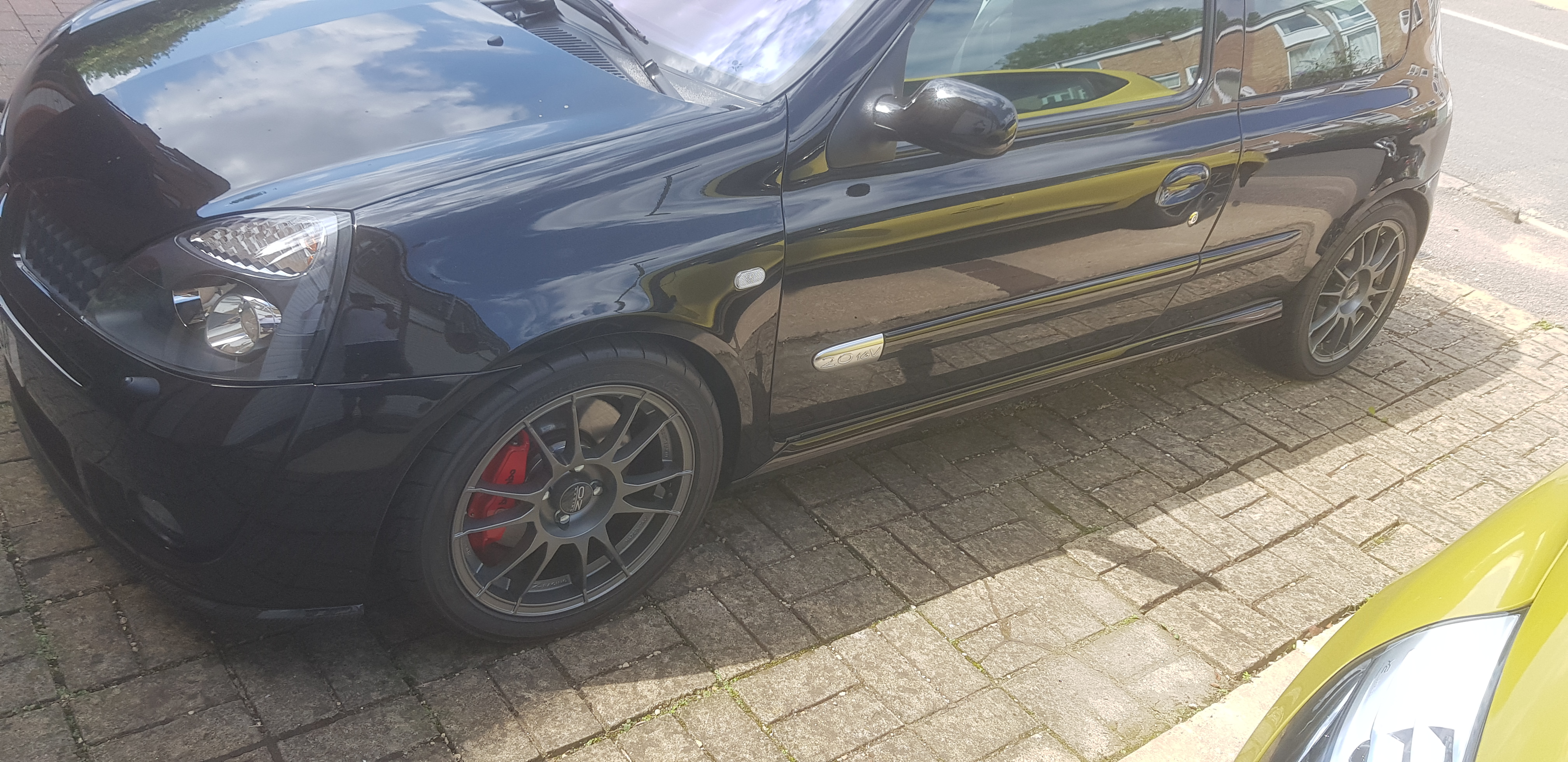

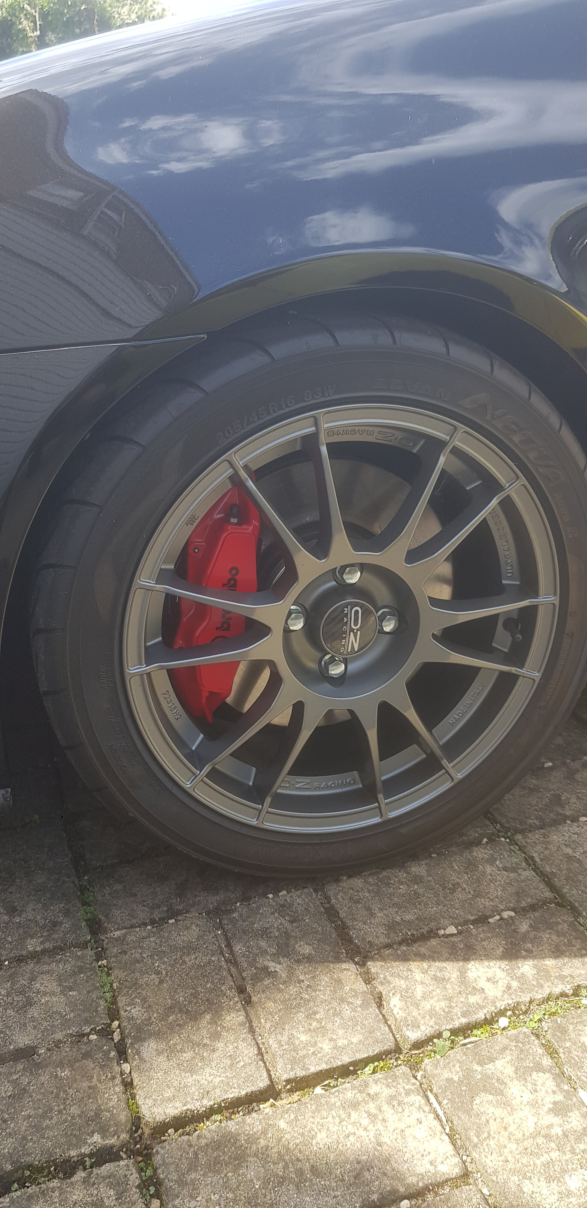

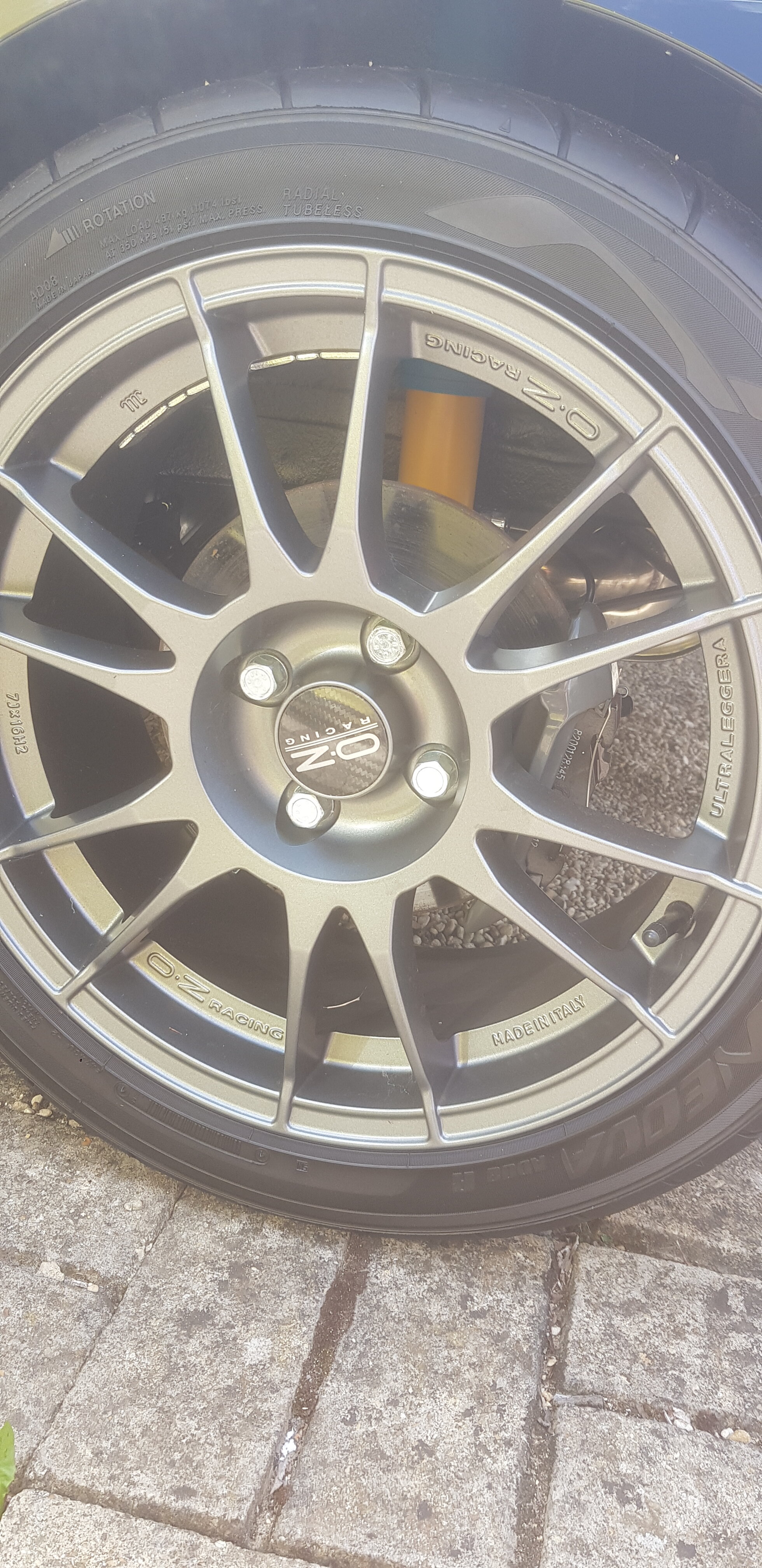

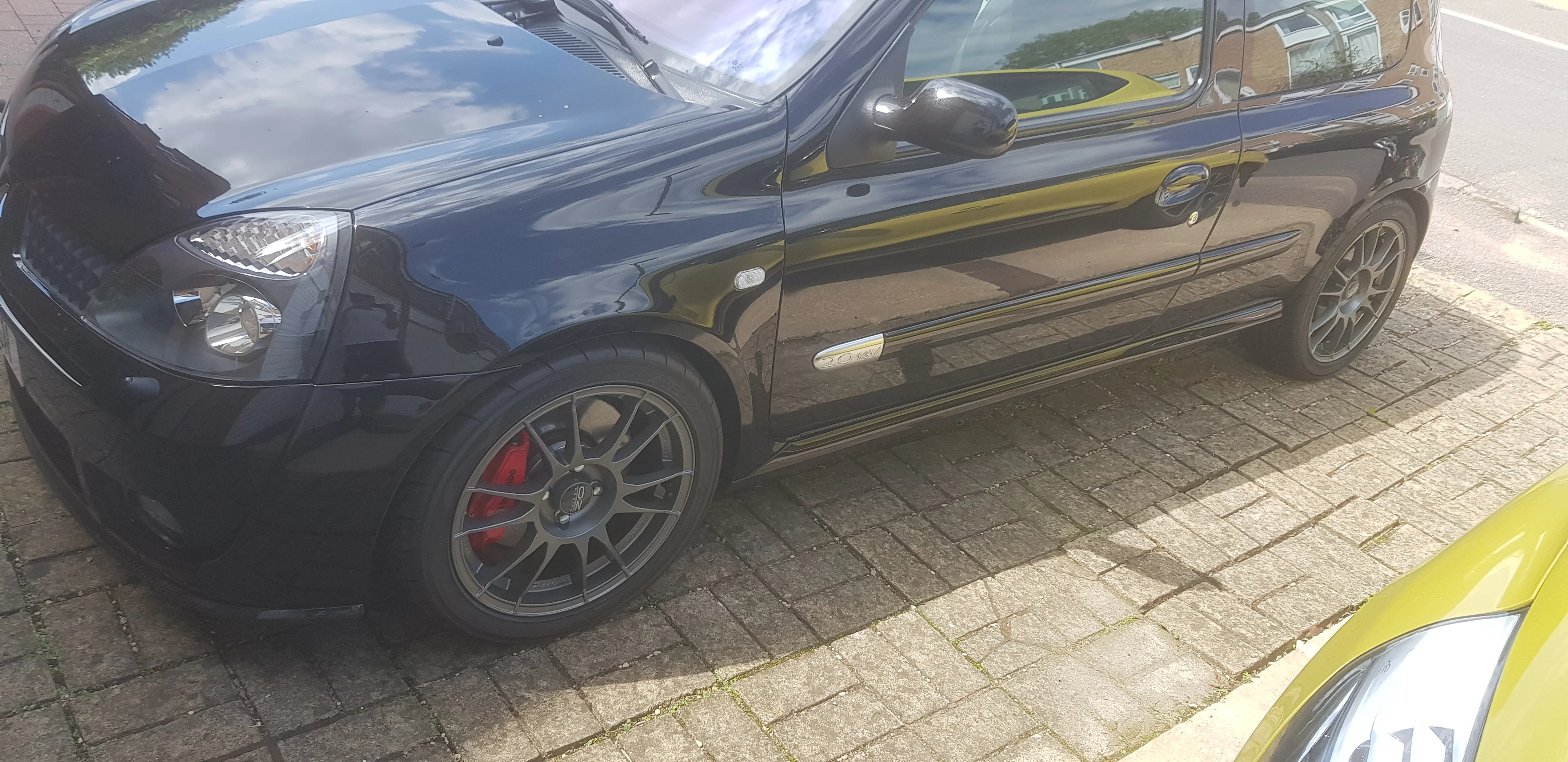

Just nipped out , mine are 16s in this pic.
Great wheels. Only bad thing is they make your rear brakes look puny .

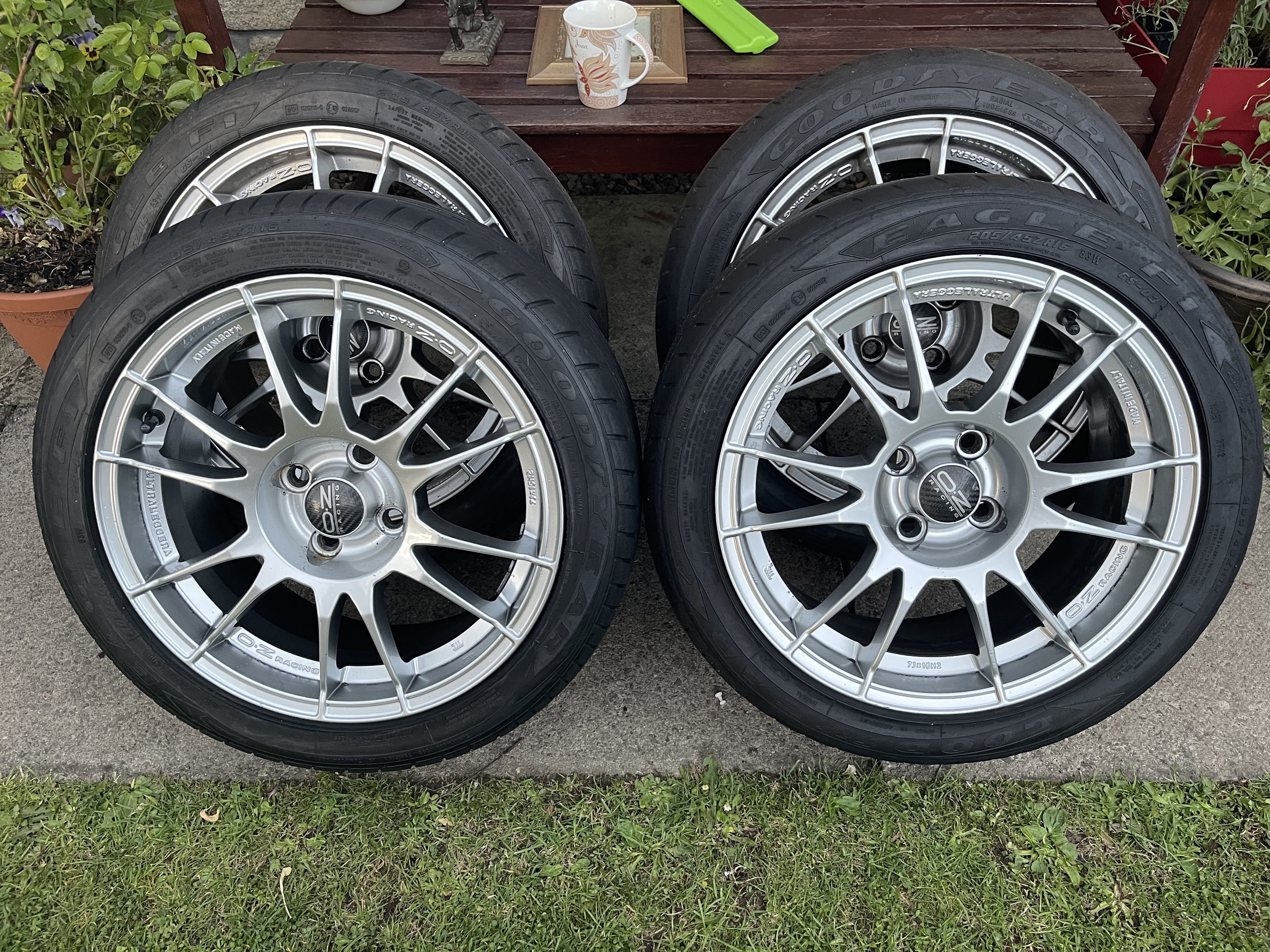

Thanks for your help everyone. I’ve gone ahead with a second hand set of these. Hopefully they look good and the car drives better with them on due to the reduced weight vs standard alloys (5.9kg vs about 8kg).

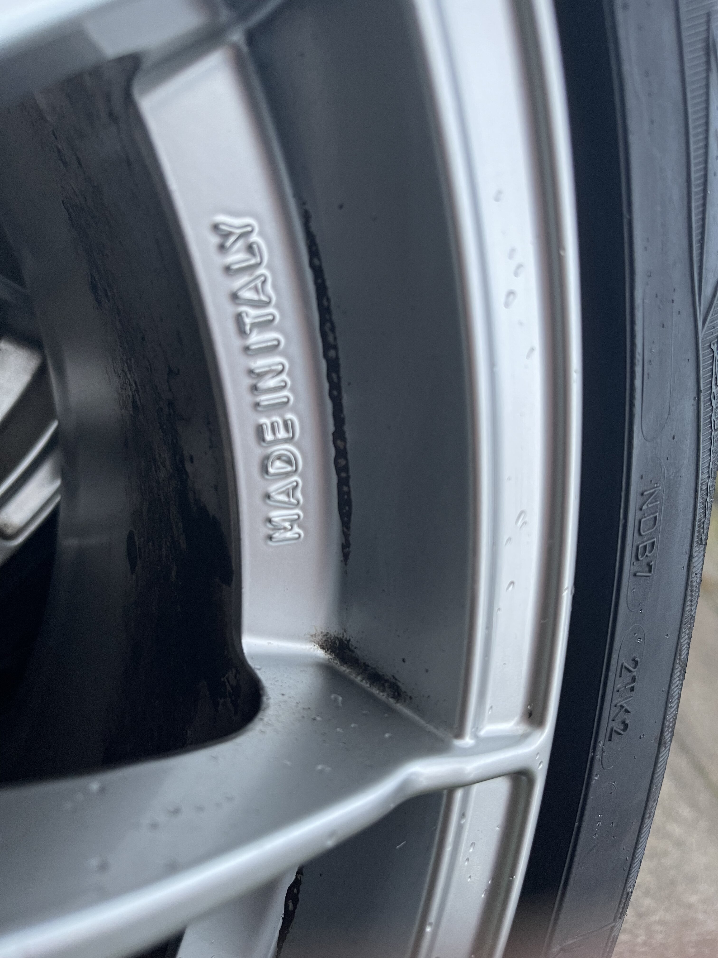

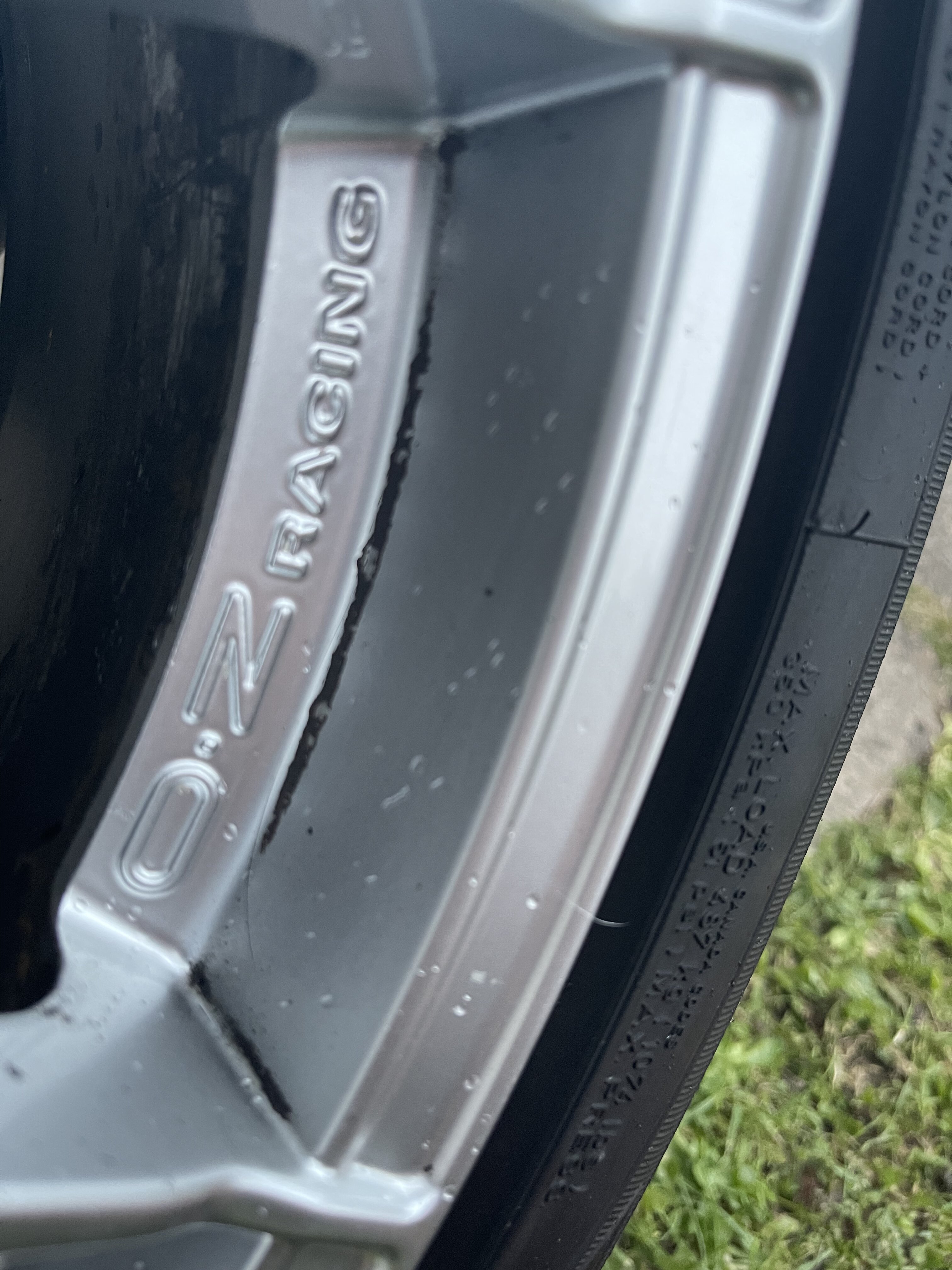

I took delivery of these 16” OZ Ultraleggeras the other day. Over all they are straight and in decent nick, however they do have some brake pad deposits which are completely welded (rock solid) to the rims - see photos.
For those of you running an aggressive track pad, what do you use to get rid of this welded on brake pad deposits without damaging the paint & lacquer beneath?

Have you tried an iron remover/wheel cleaner like Bilt Hamber Auto Wheel?
If it turns purple it's working, might just need multiple applications.
Otherwise you might be able to remove it with a tar remover.
Once clean your best option is to put a wheel coating on, makes it a lot easier to clean.
Aggressive brake dust that has welded itself to a wheel is almost impossible to get off. @Daniel told me about this stuff and it was the only thing that would remove it.
Thanks a lot for the recommendations guys. I’ve been using the built hamber auto wheels and have gotten rid of 90% so far. Will just keep using it until I get 100% removed. Good stuff and not damaging to the wheels.
