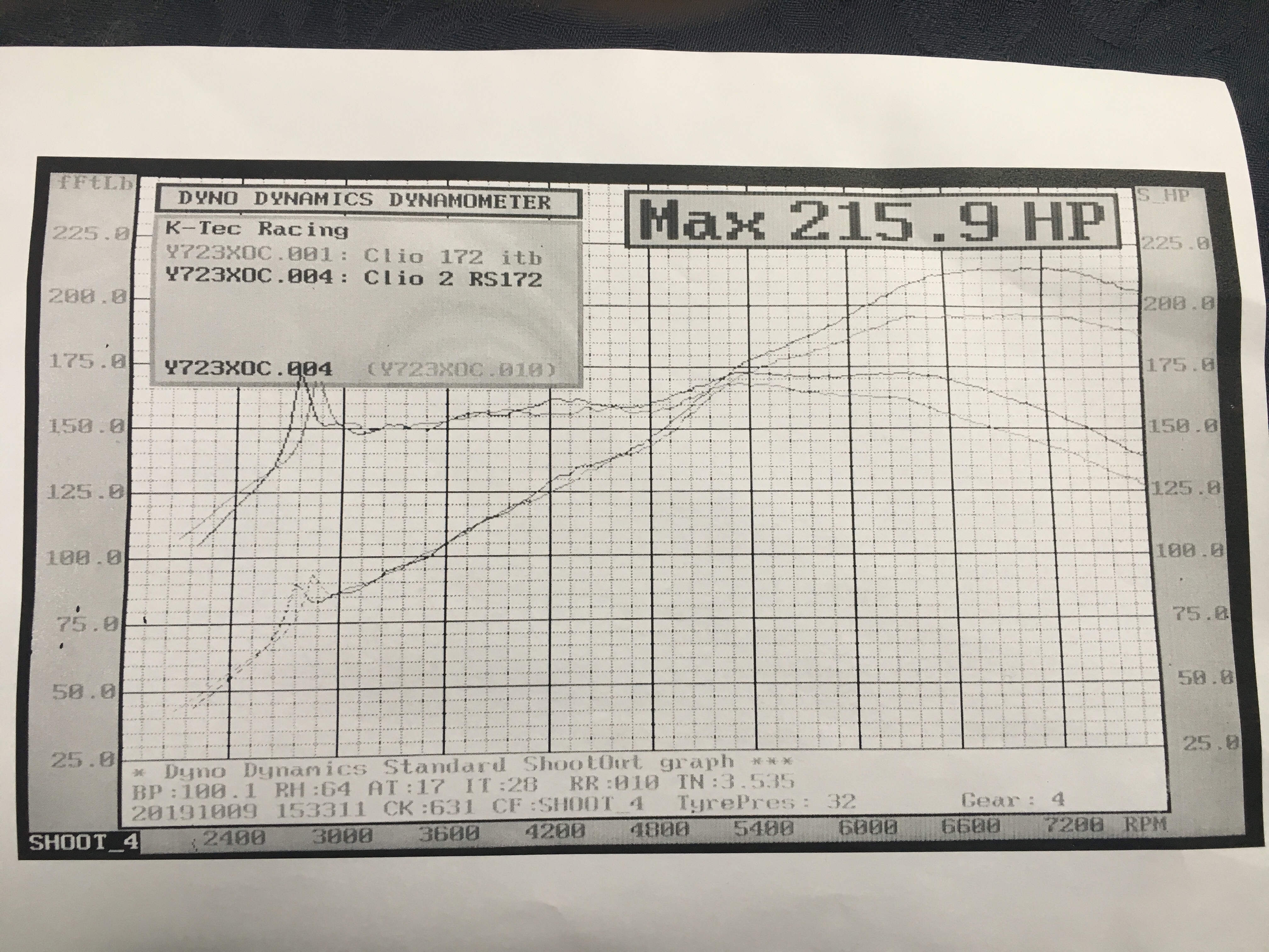

The shricks gave my ph1 engine an extra 16 bhp, torque was up to. Also use a gen90 ecu

That’s with throttle bodies and hi compression bottom end. Can’t remember the compression ratio off the top of my head. The cylinder head has three angled valves and stronger valve springs.
The shricks are quite lumpy and have a higher rpm tick over.
