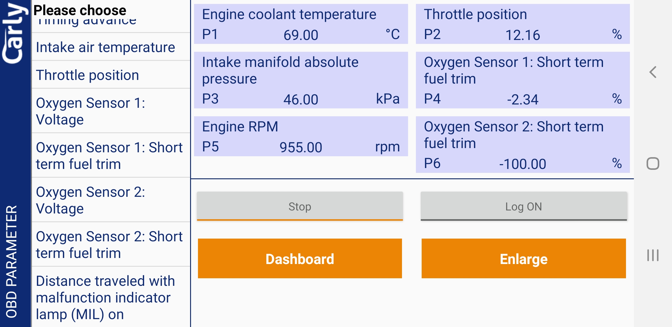

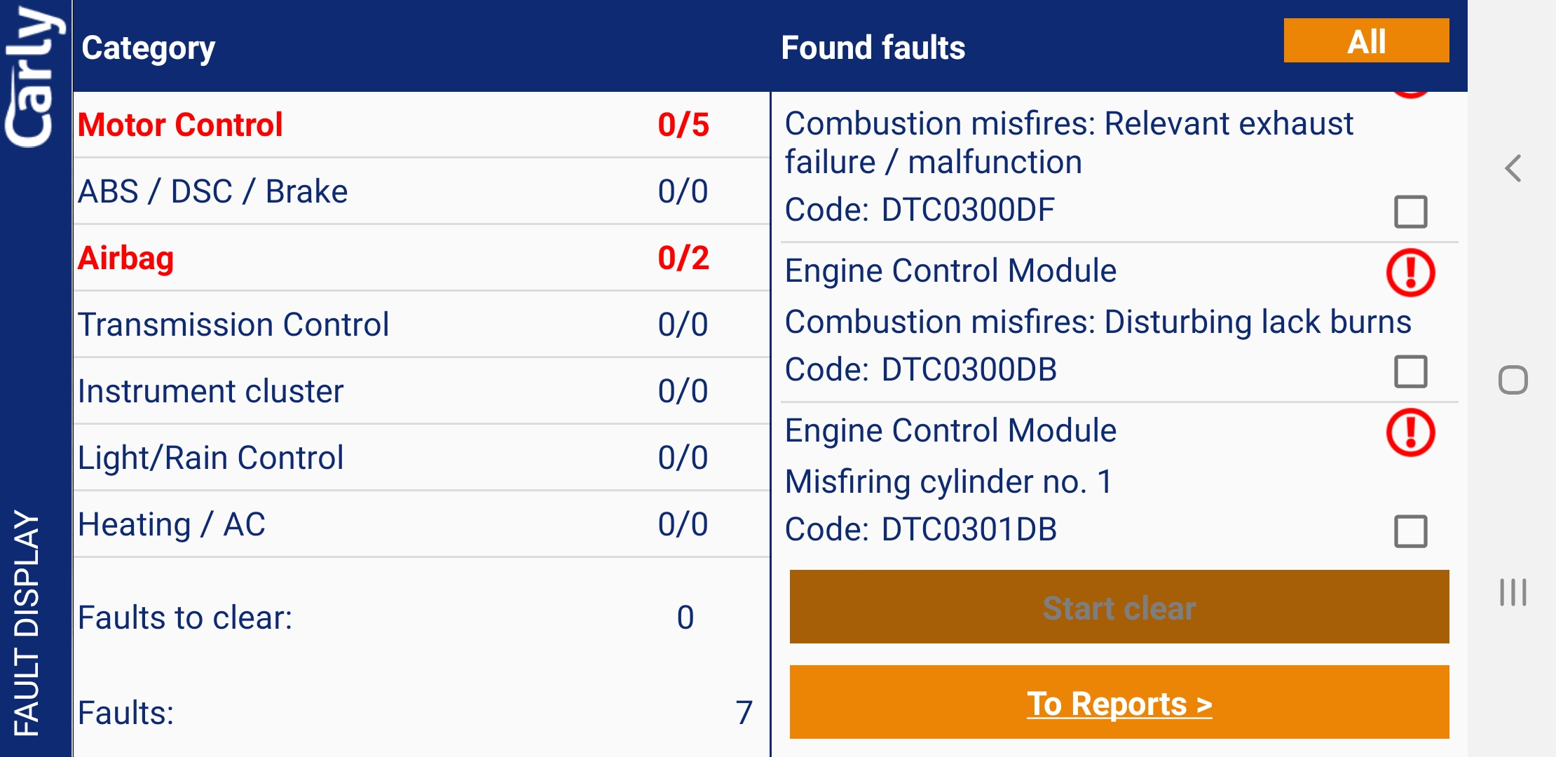

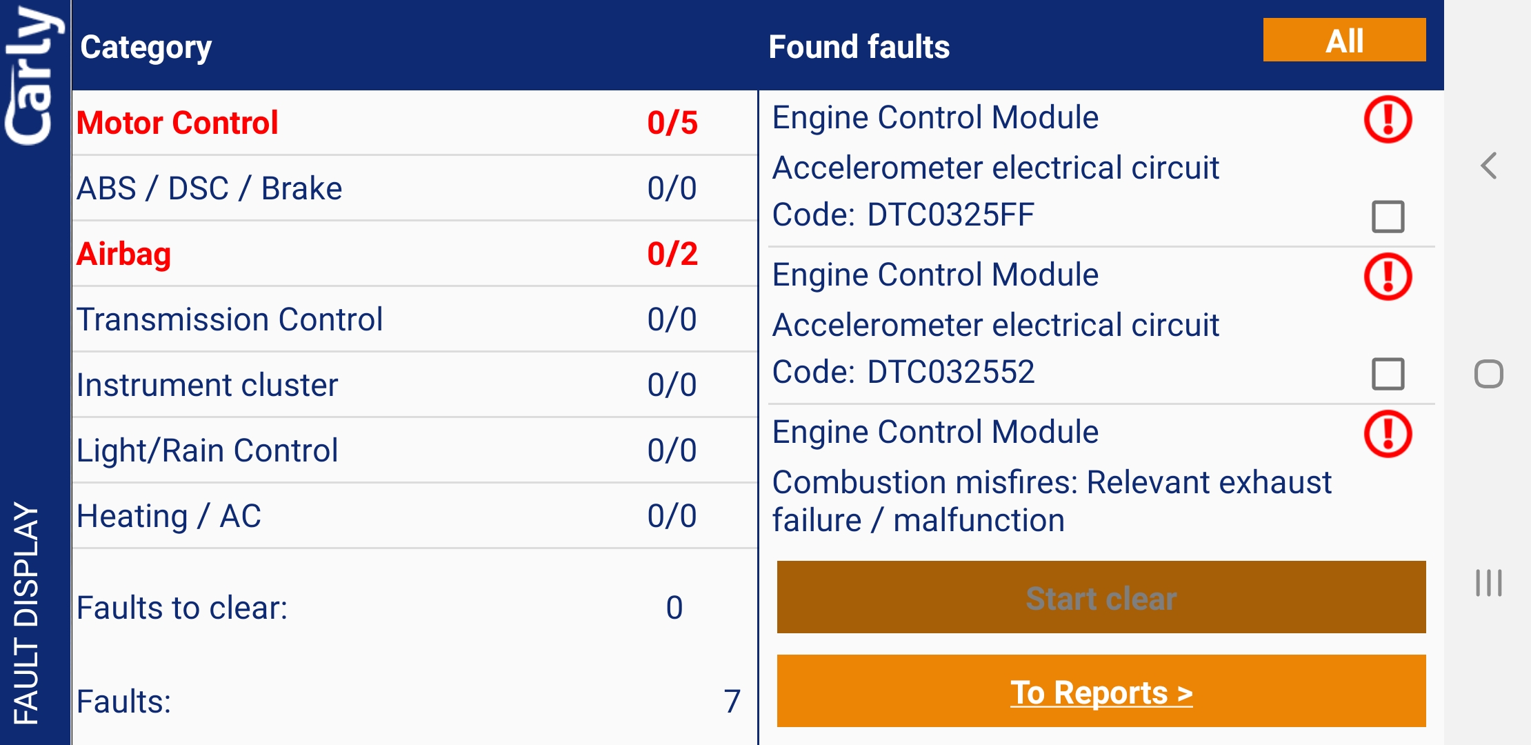

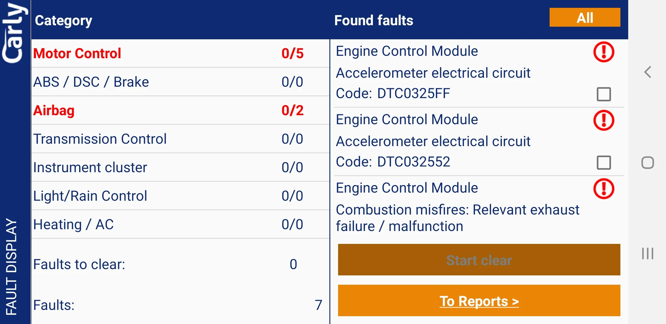

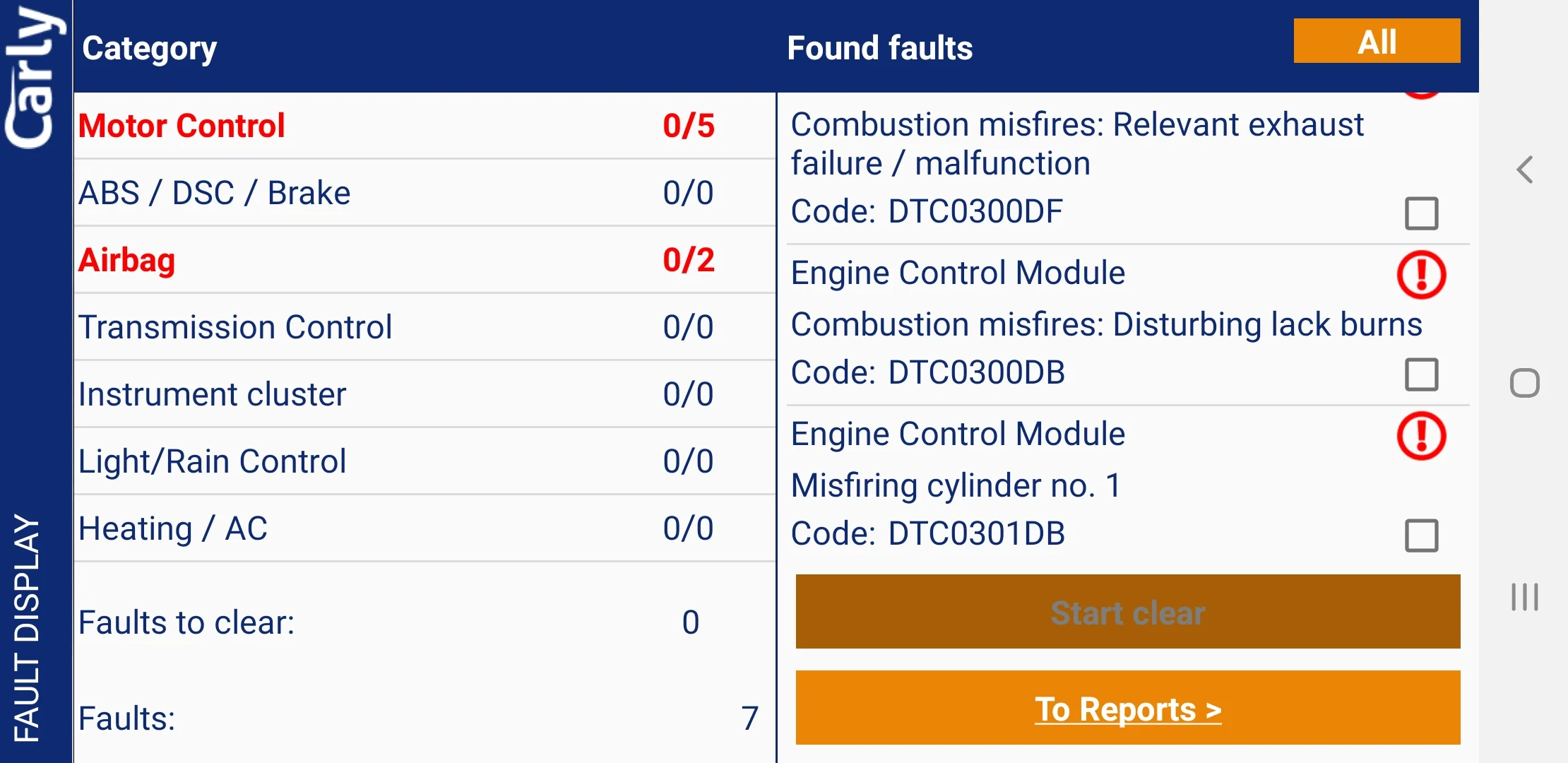

Currently running on 3cyl replaced coils and plugs. No codes for injectors, just misfire on cyl 1 and multiple misfire. Pcv is working fine.

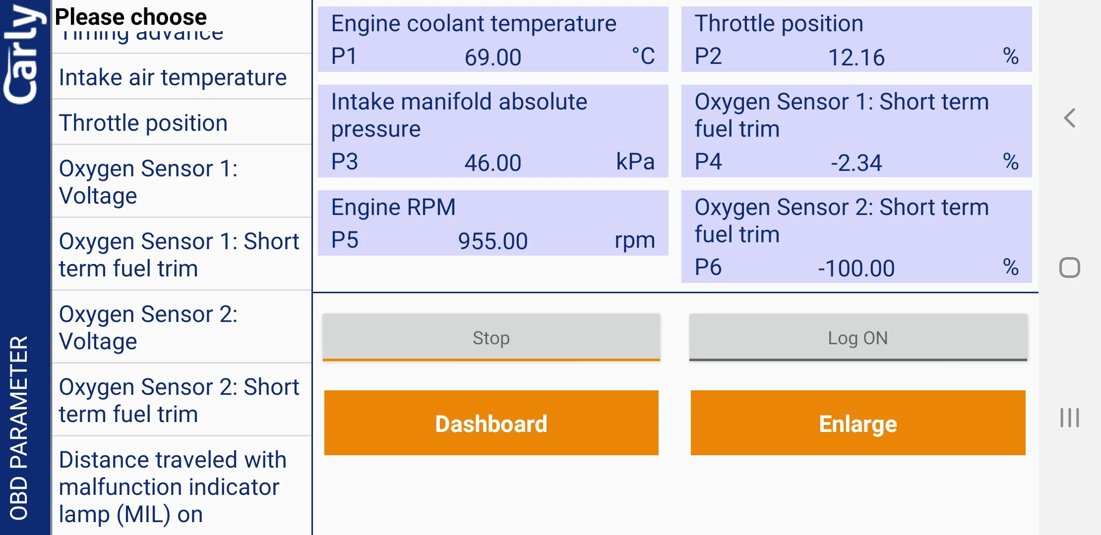

Codes attached. Also bank 2 o2 is running stft at - 100%

Could be a lambda that’s s**t itself mate. Worth having a nose over the wiring to both the lambda sensors too.

Yeah I'm going to unplug the o2 and see what happens. Just thinking worst case with the engine. The gearbox synco crunches on 3rd at high rpm. Still engages though. What kind of prices are we talking for rebuilding either? And where abouts are you buddy?

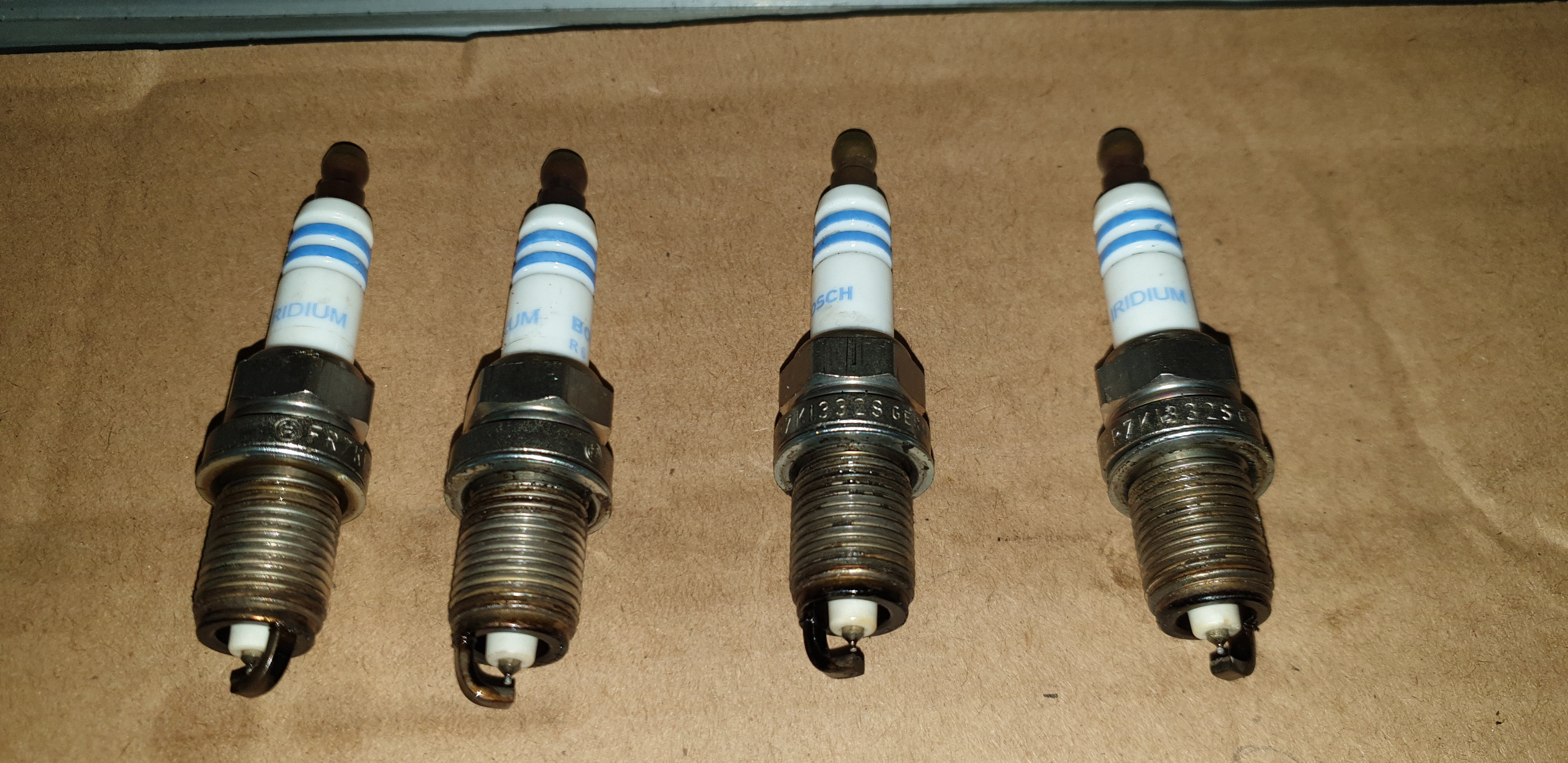

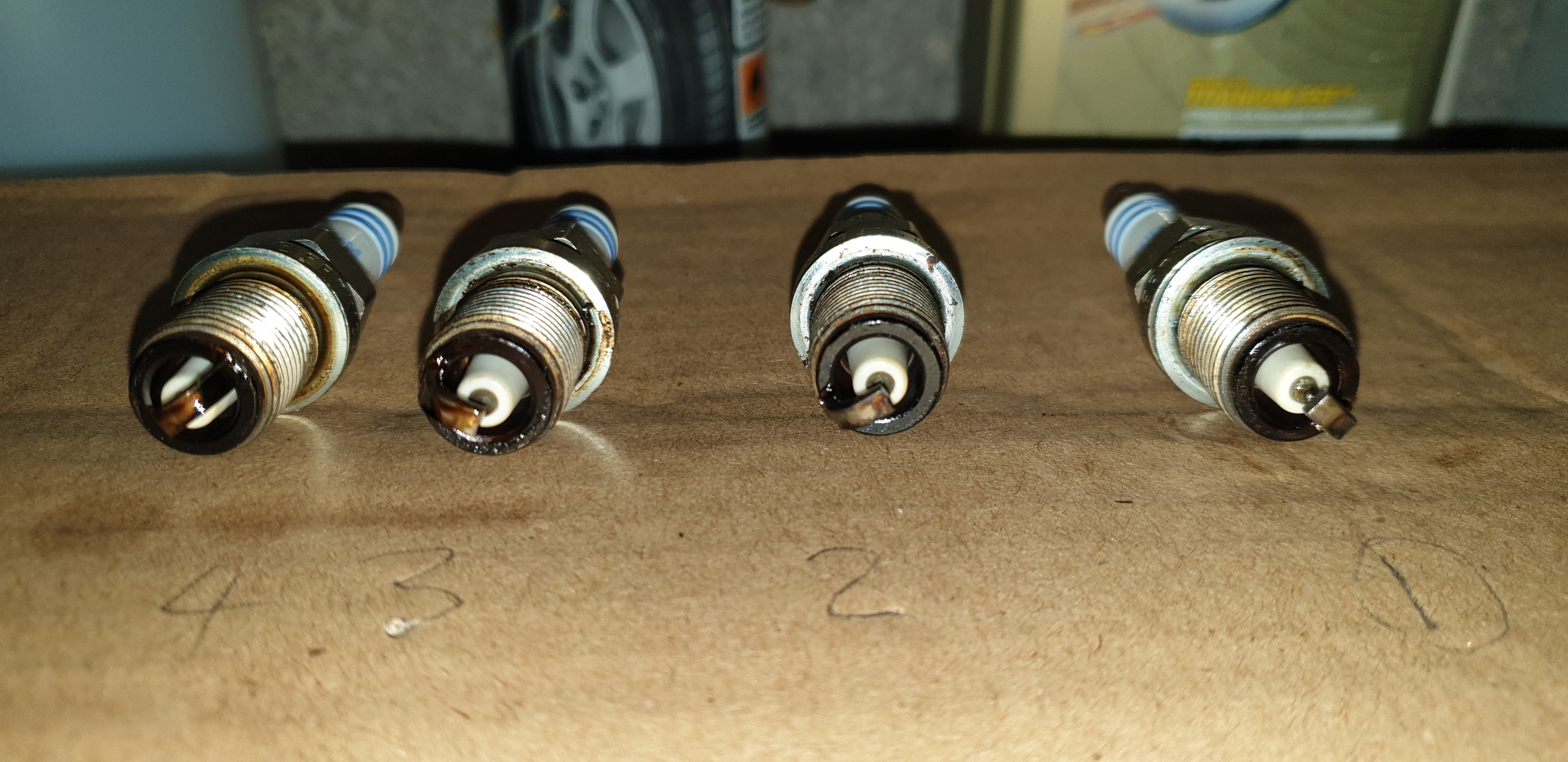

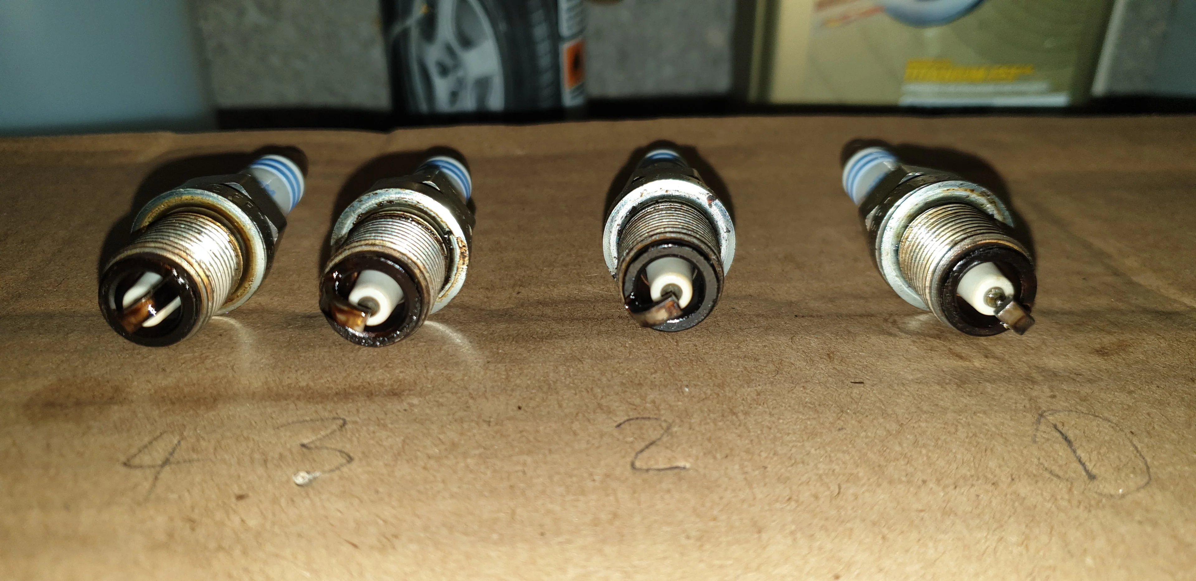

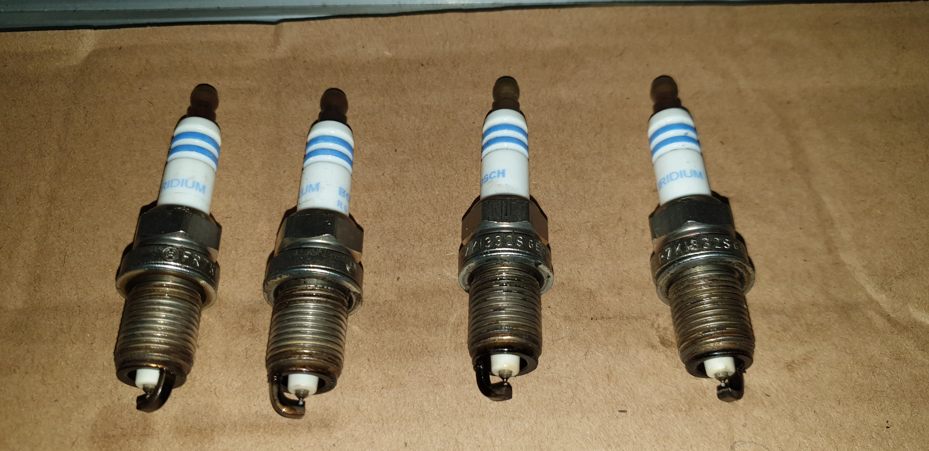

Update pulled the week old plugs out and they are all wet with fuel... I say fuel because it looks like its evaporating...

So I cured the misfire, needed oem plugs. But I still have a that jerk around 2500 to 3000rpm. I've swapped coils, plugs, most sensors, cleaned the throttle body and no joy! It has a miltek cat back. Once threw a knock sensor fault and I replaced that and torqued it down and the car ran smooth for 2 days then had again. Also feels down on power!

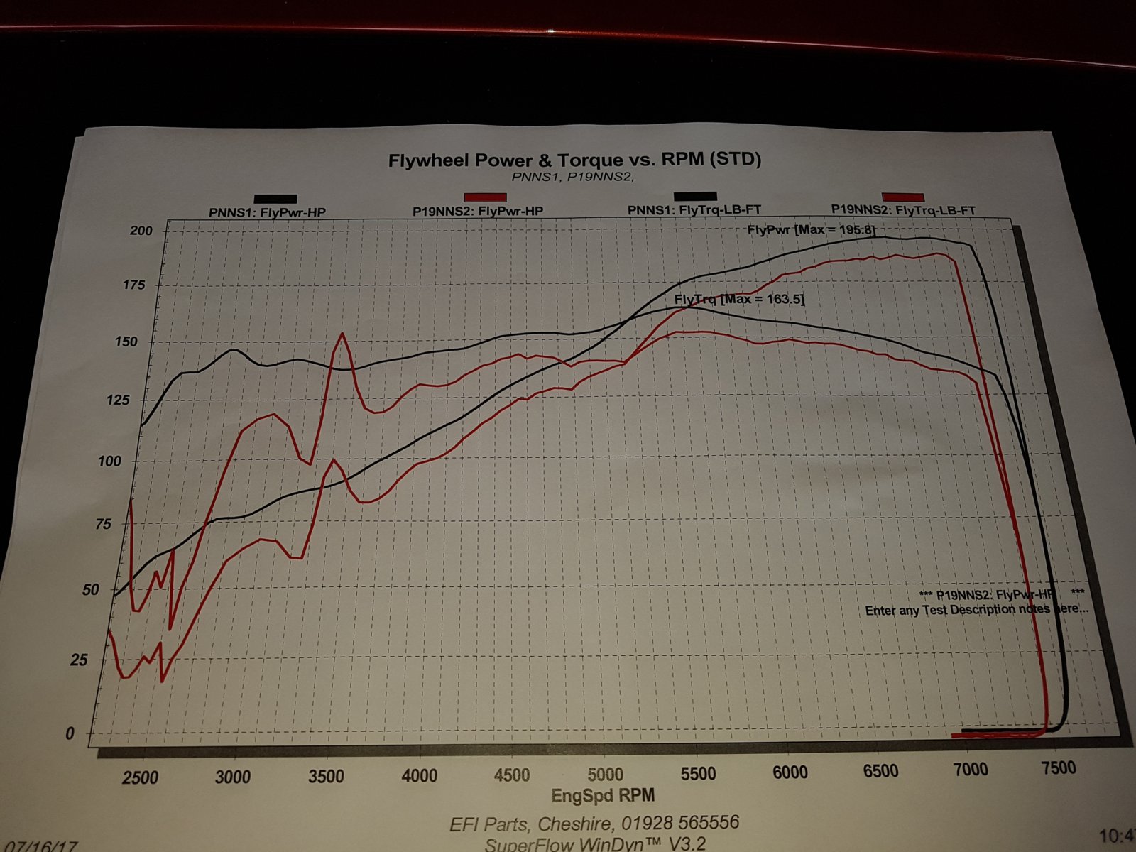

Yeah, probably the map. Some are awful, some not bad. I had one in that would cough and splitter all day long if you held the revs at the same point. Will see if I've got the before and after graph for it.
Don't need to say what one was before, kind of easy to spot...
