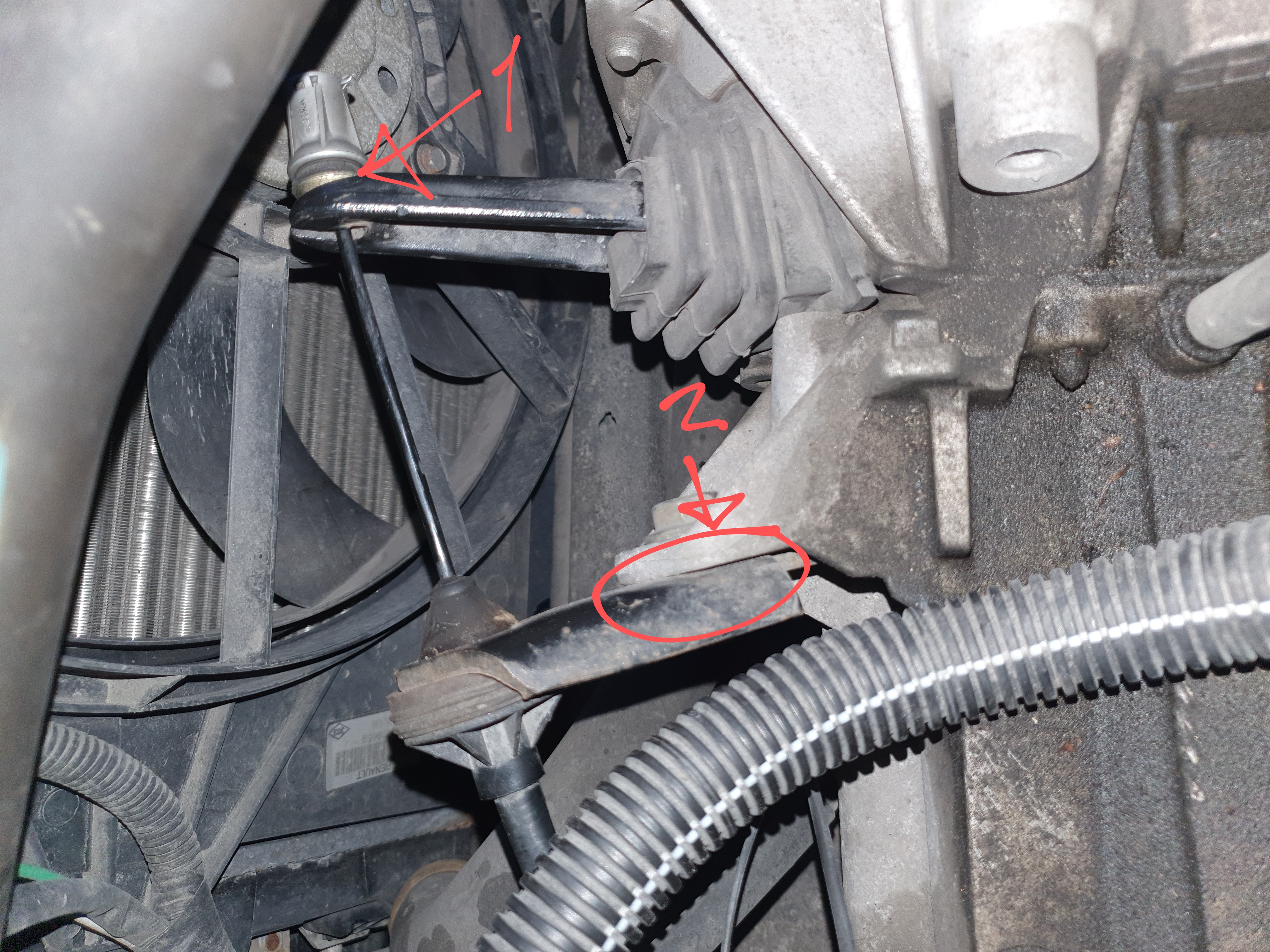

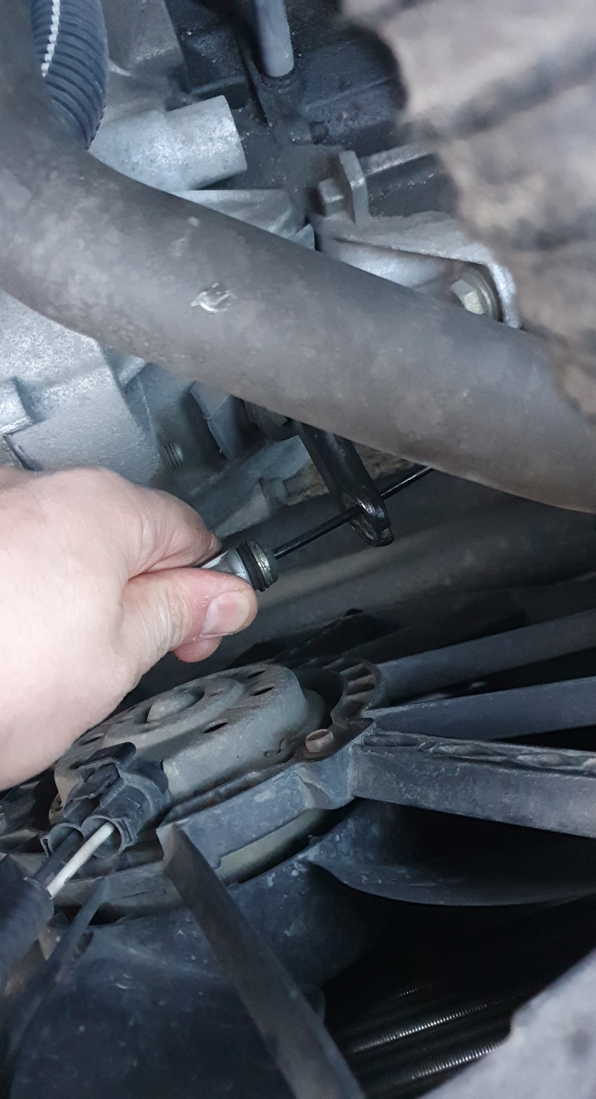

In the engine I can see the clutchcable hanging loosely in its holder.
Good news the clutch is not sliping, it keeps stalling like a champ.
There is as I can feel a Lot of play in the wire, see photo.
My thought is to add spacers/washers?
Maybe in two points, May these be good fixes?
Is it possible to get endplug on the wire off without breaking it?

I don't have any answers but in my mind there can be two things wrong, either the cable or the clutch.
I would replace the cable first and if it still isn't playing then it may need a new clutch. If you need washers to make it work something has gone too far awry.
The pedal has an auto adjuster so could be worth checking that but I have not seen much evidence of this (or really the clutch cable) going bad.
The part number for the clutch cable is 8200699727, about £75 for RenaultPartsDirect not including shipping - would highly suggest genuine if you go down that route, buy cheap buy twice and all that, been there done that haha
My cable is exactly like yours but I haven't dared touch it as it's working fine for the moment 😂
