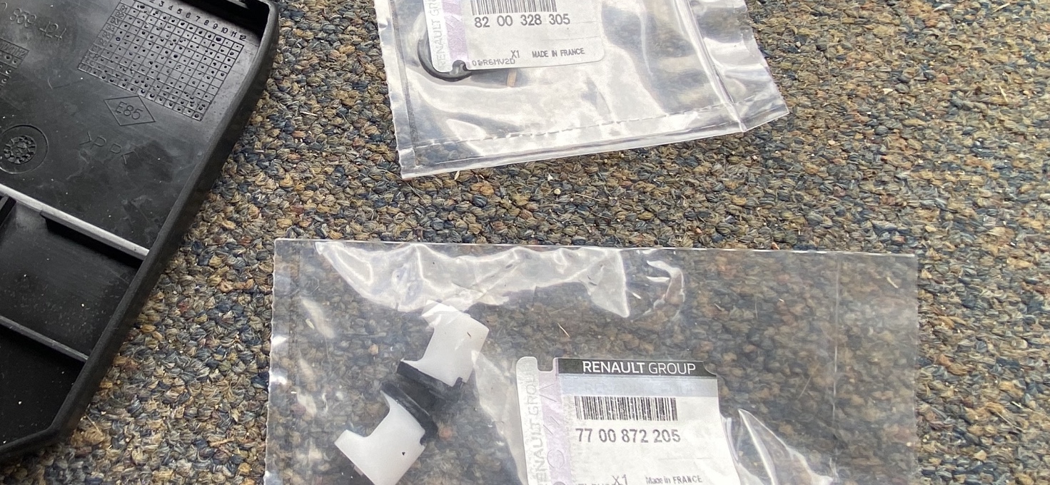

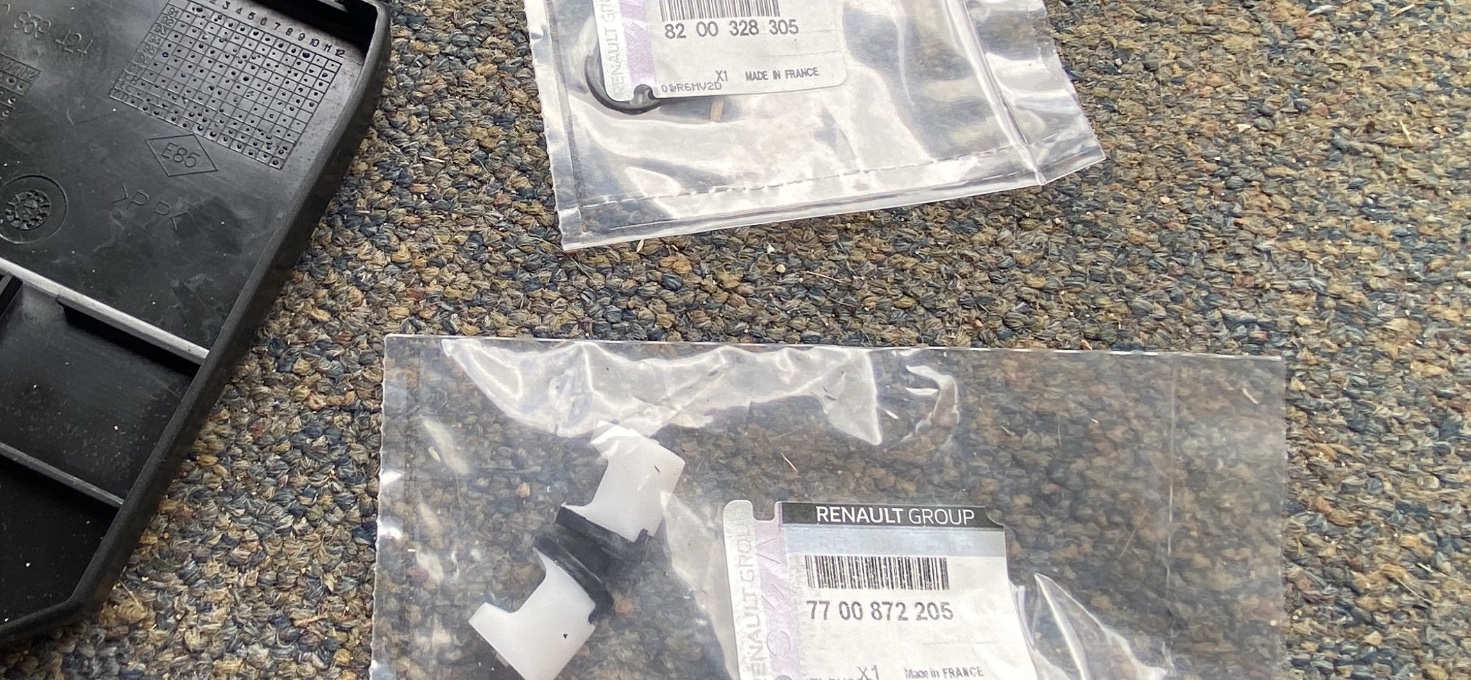

This is the bush and you may as well get a new circlip as the old one will likely fly off never to be found again.
