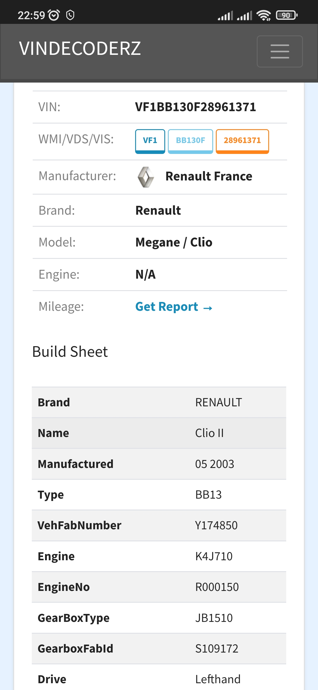

Are you sure your K4J has a JB1? aren't they all front starter motor?
K4j on mk2 has JB1 with starter on rear side as jc5, I can confirm as I owned for years and still have engine on a stand in my workshop
