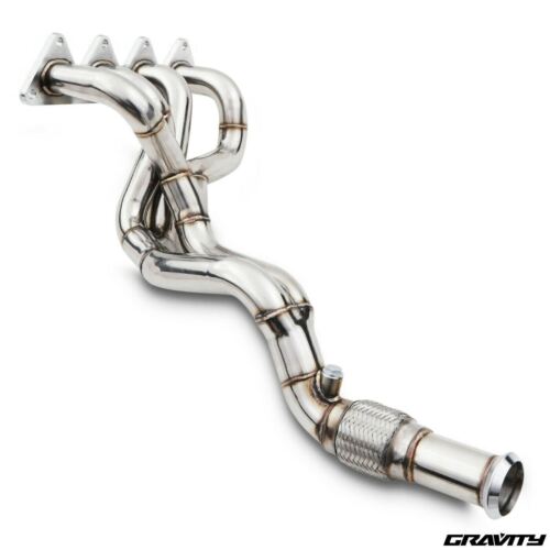

So what is the minimum you need to do to install a new Gravity Performance manifold including the flexi joint ?
RSRowe
  Megane 250 Cup
It’s not too bad. Maybe a dozen fastenings or so, but they’re big and quite tight. You’d need a big breaker bar.
The annoyance is technically you should then get the car aligned afterwards.
