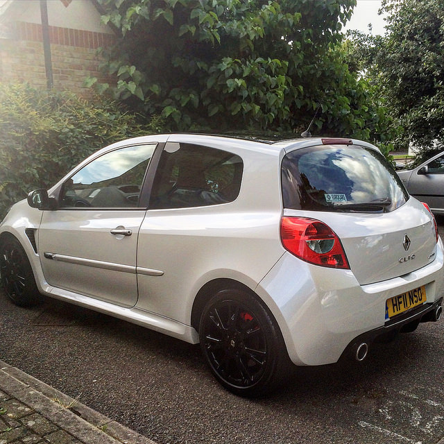

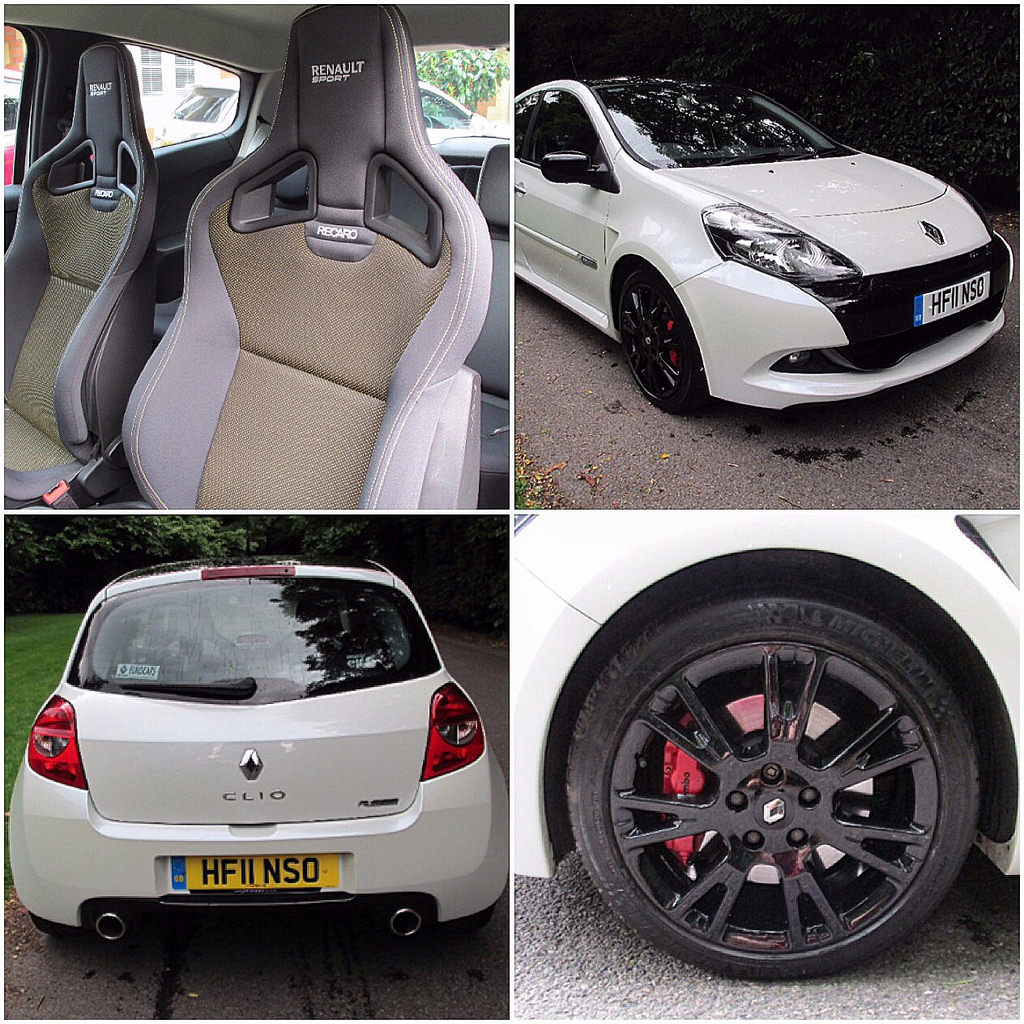

Just thought I'd start a mini build here.
Picked up a lovely 1 owner from new 2011 Clio Sport 200 with cup pack.
Only 33k miles and in pearl white, I'm told 1 of 46 made?
Will post up some pics shortly.
Got a few questions.
What Mats did they come with as standard?
What aftermarket Stereos do people fit in these?
Induction kits on these, K Tec I see do one, are they worth doing or create too much heat soak?
I've come from the VAG world and still have my PVW featured MK4 Anniversary edition so I'm hoping things don't get out of hand like that one!

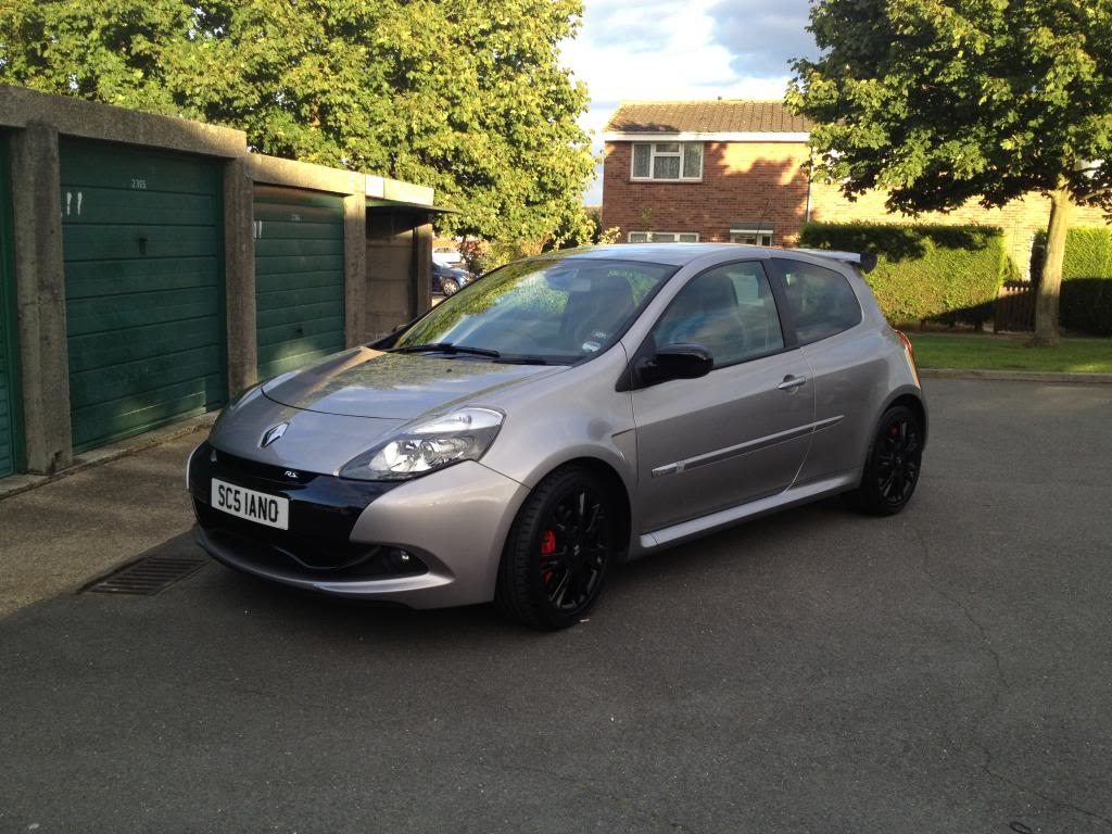

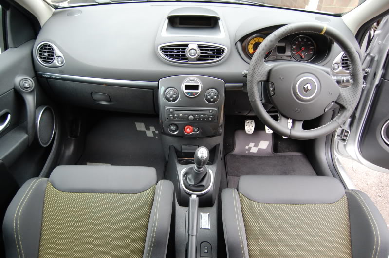

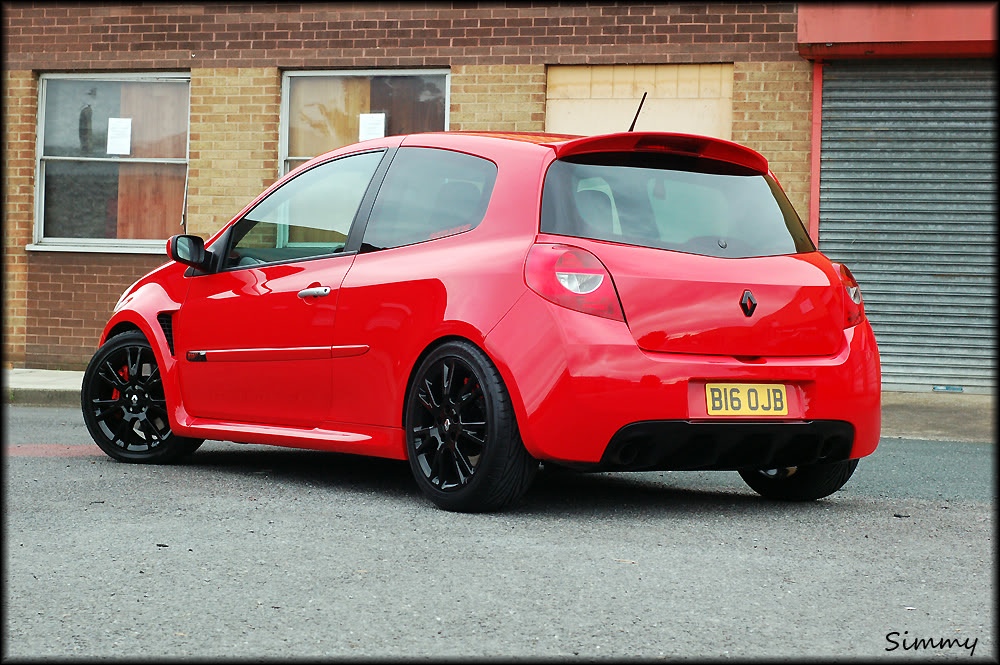

They come with renaultsport black with silver edgeing mats, when i had one the stereo was fitted in and i had a piper panel filter, the induction kit will do nothing but make a noise and is a waste of money imo, the cup spoiler gives it a more racey look and is worth adding like on my old nimbus above hv11kvx. love the roof jason.

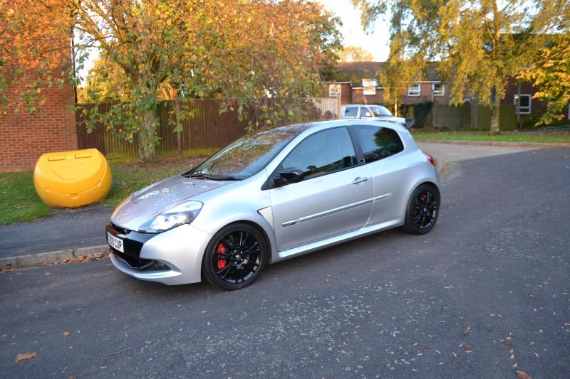

As for lowering it a little H&Rs are you best bet as they give a 30mm all round drop. If you go for the eibachs they do 20-25. Here is a picture of mine with the H&Rs fitted.
And a link to larkspeed who seem to be the best company for ordering through. Just make sure you order the correct year as the strut top mounts changed in 2010 to a smaller size.

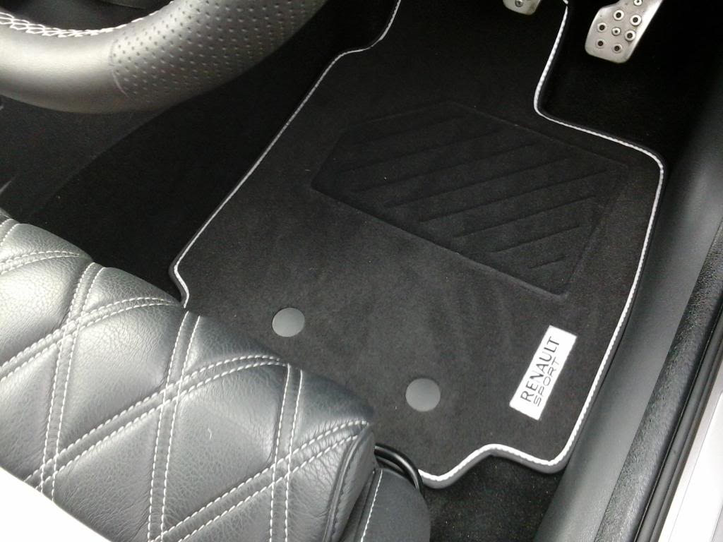

The only other really options from Renault for mats are the silverstone ones which were rubberised but I preferred them to the standard Renault sport mats.

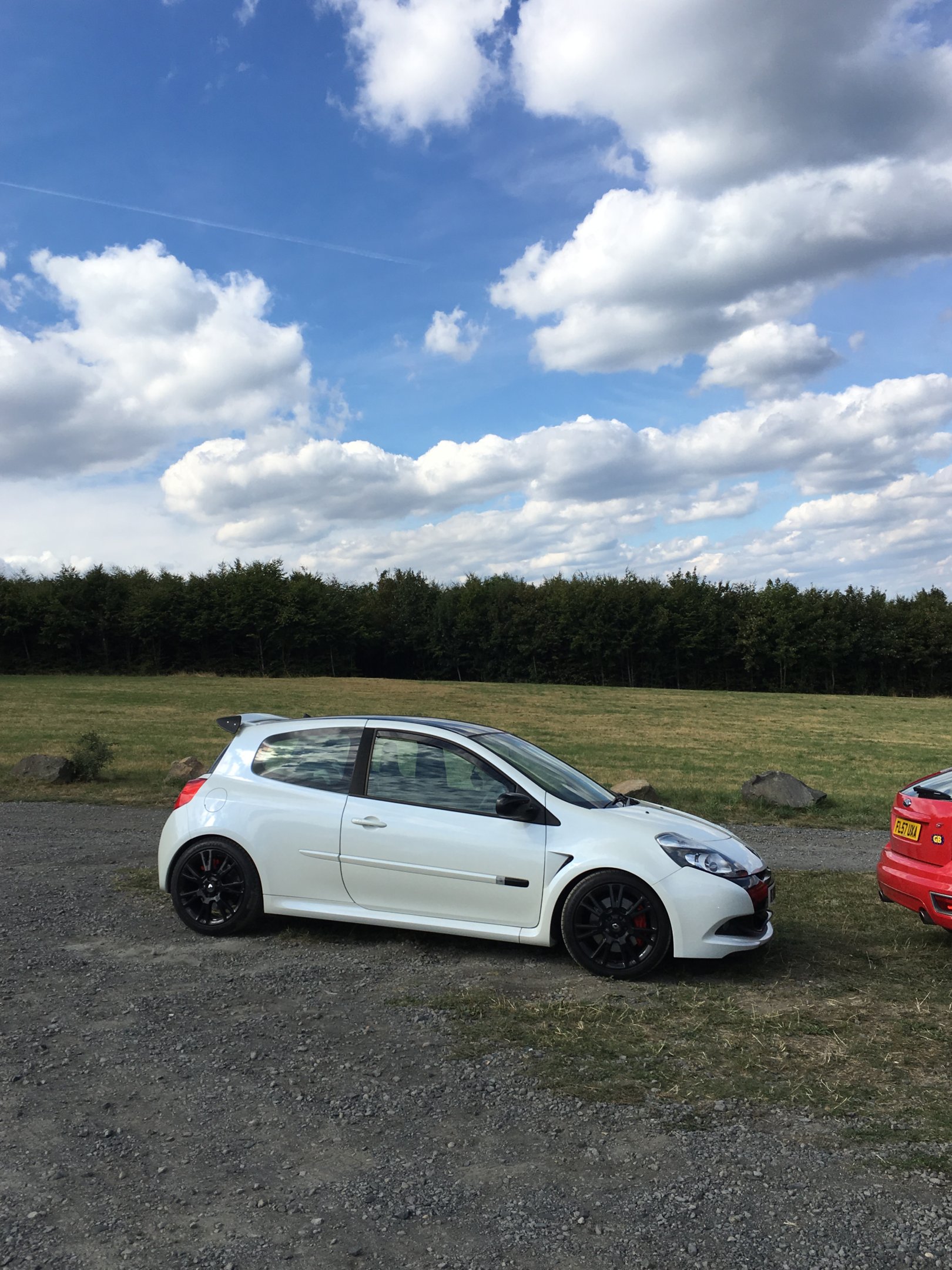

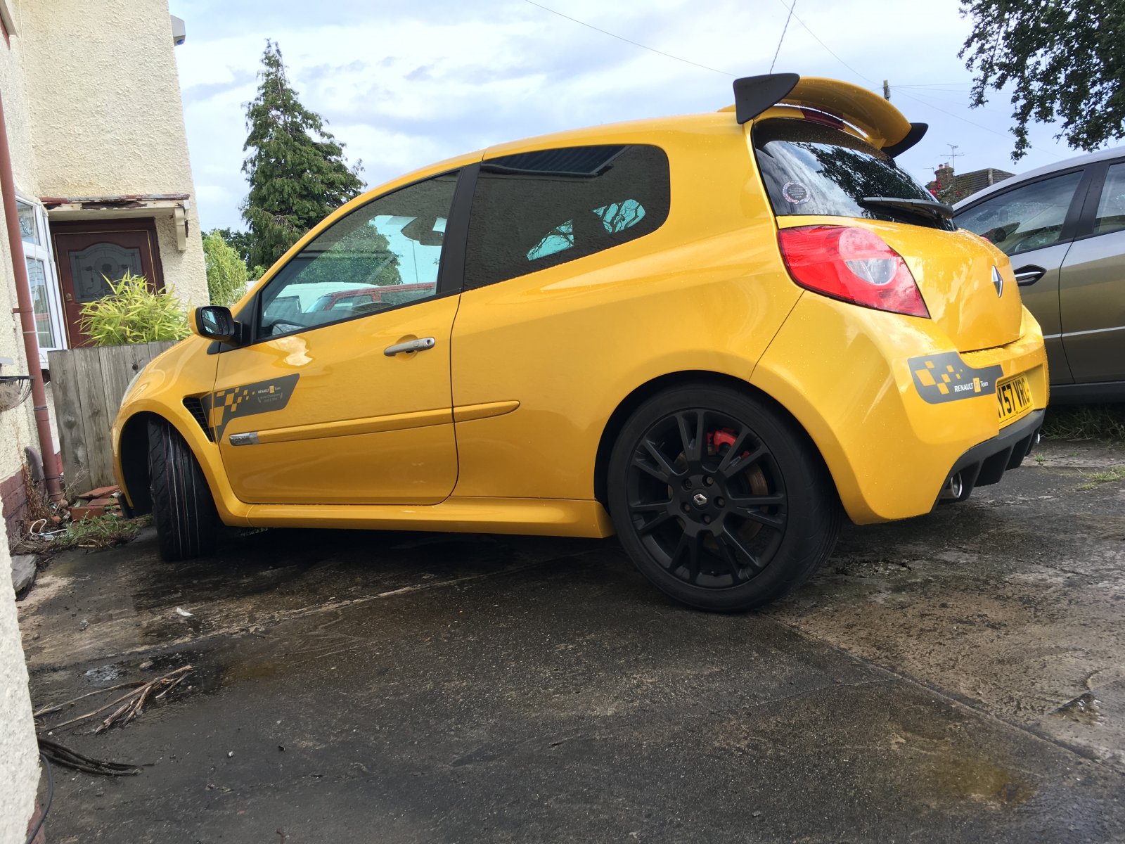

Mine on 30/40 springs ( that's 30-40mm), no spacers and 225 width tyres.
Could do with 20 or 25mm spacers.
'Cheap' exhausts do give a noticeable flat spot. Mine came with a shitty exhaust and @Euan94 can tell you how bad it is. The car barely went anywhere when launching onto Blyton lol

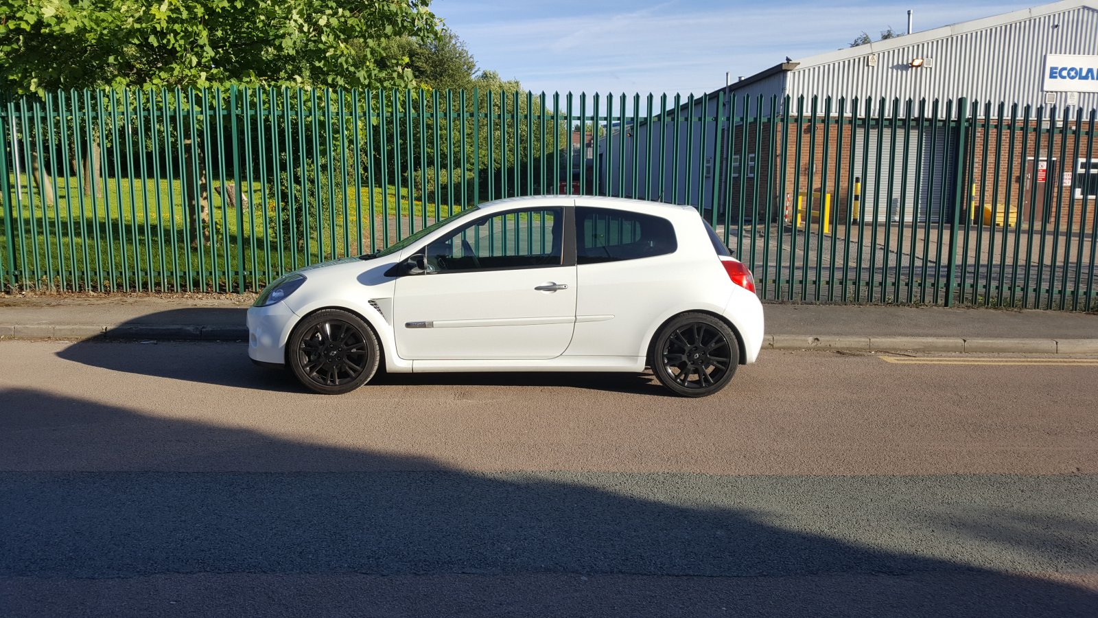

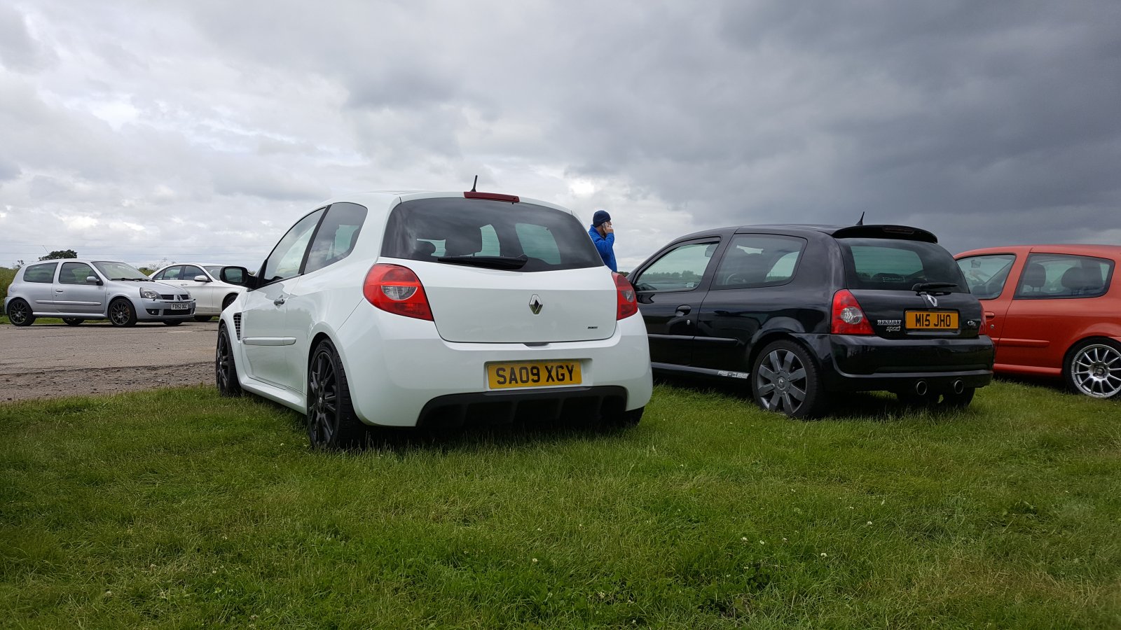

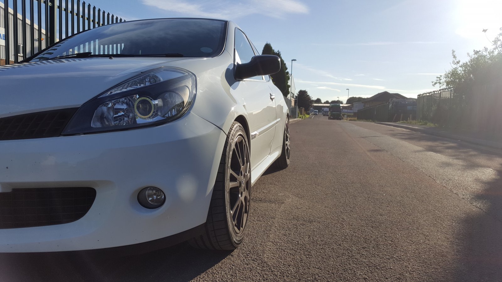

I went for the H&R 30/30mm springs on mine, with KTEC 19mm hub-centric spacers. Had the combination on for just over a couple of weeks and it's been fine, the ride is ever-so-slightly firmer but nothing significant, I'm just a bit more wary with road surfaces and bumps.
I took the top picture purely to show the spacer poke.

It's one of 17 Pearl White ones produced. 46 PW shipped to the UK in total. 17 with a Black Roof. 32 had Cup suspension. 26 Black Speedline's. Eight with the Carbon Pack interior. Two with a Sunroof. Five with SatNav. 11 with the Cup Spoiler. Six with the RS Monitor. 18 with Recaro's. Three with no options. Zero with White Speedline's.
Could be more unique than 17 if the RS Monitor or Carbon Pack are fitted. Mine is one of six as it has the RS Monitor fitted.
I got original mats (RS with silver piping) and other bits like a luggage net, ashtray/coin holder, RS steering wheel insert from Wolverhampton Renault. The matts were approx £30, much cheaper than £50 from eBay.
Looks like someone has also fitted black centre caps on the Speedline's for you, or sprayed the grey ones that come as standard, black for you. Handy.
Good to see yours also has multi coloured panels. The paint work is shocking on most PW 200's. They're like harlequin cars. Going from white to nicotine yellow. The match from the rear bumper to rear quarters is the worst.
Have fun with it.
