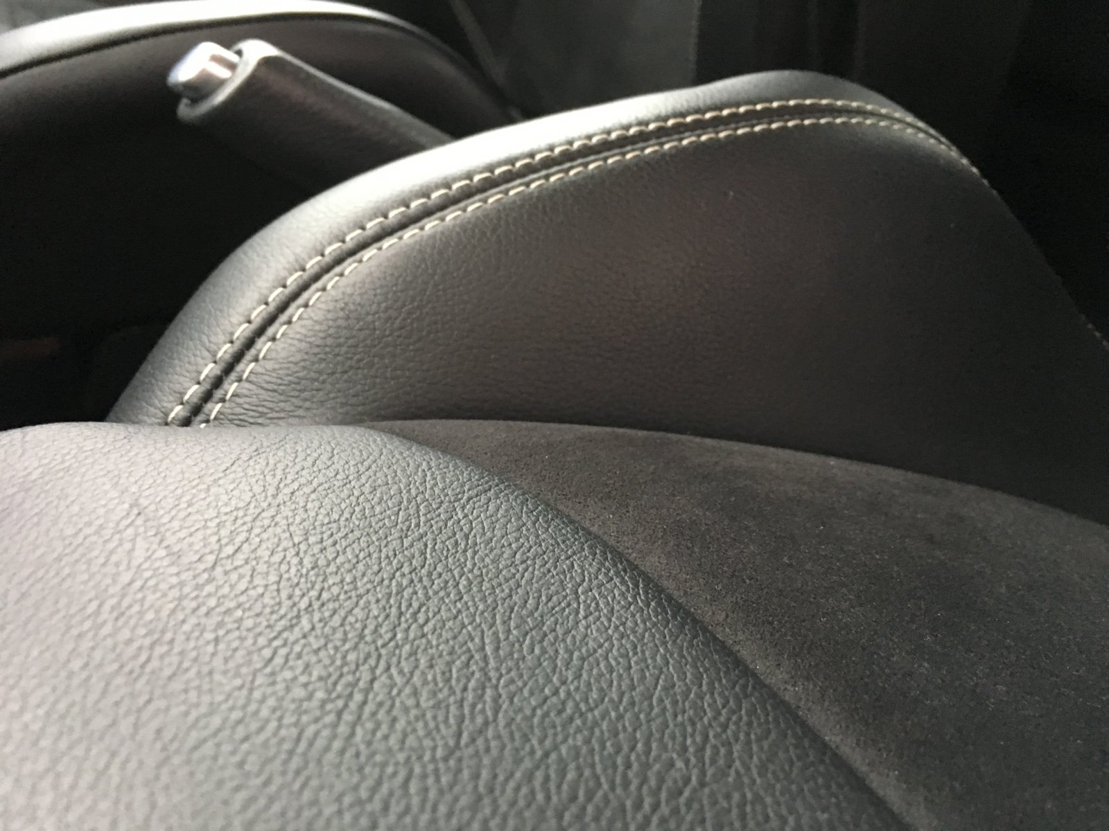

The Audi this replaces has sold today so I can get the steering wheel retrimmed now.
Hoping Snappy is still about as his work looks excellent, thinking plain black leather, silver/grey stitch and a red centre marker.

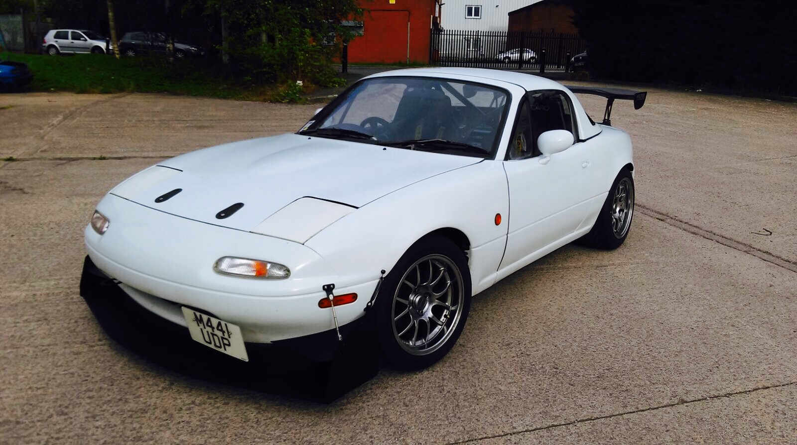

MX5 isn't going anywhere, just need to get it working! Happily I found a way to get another driver's car into the 'fleet'! :)

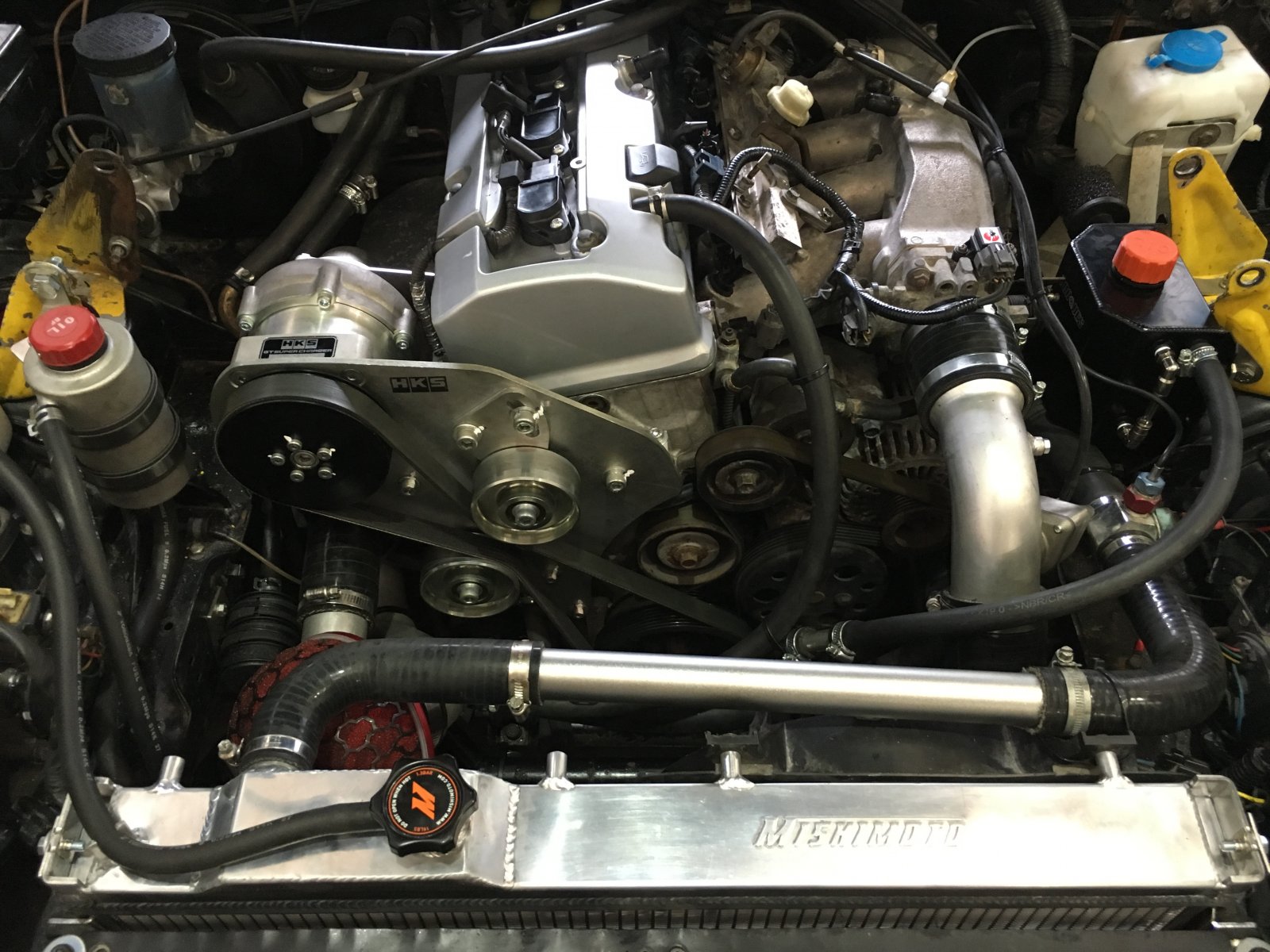

You got it, it's an F20c S2000 engine and gearbox mated to the MX5 rear end. Has been going well and seen lots of track use but having fitted a supercharger I've now got a high-rev misfire that's proving a devil to diagnose. Very frustrating but will be worth it in the end.
A couple of pics and a vid:

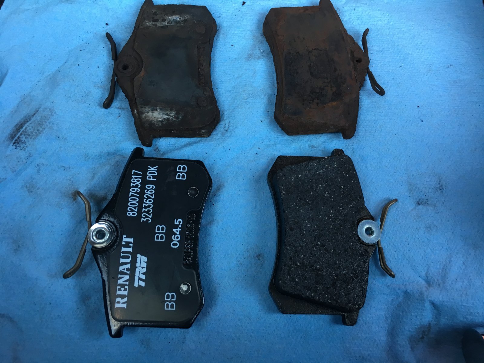

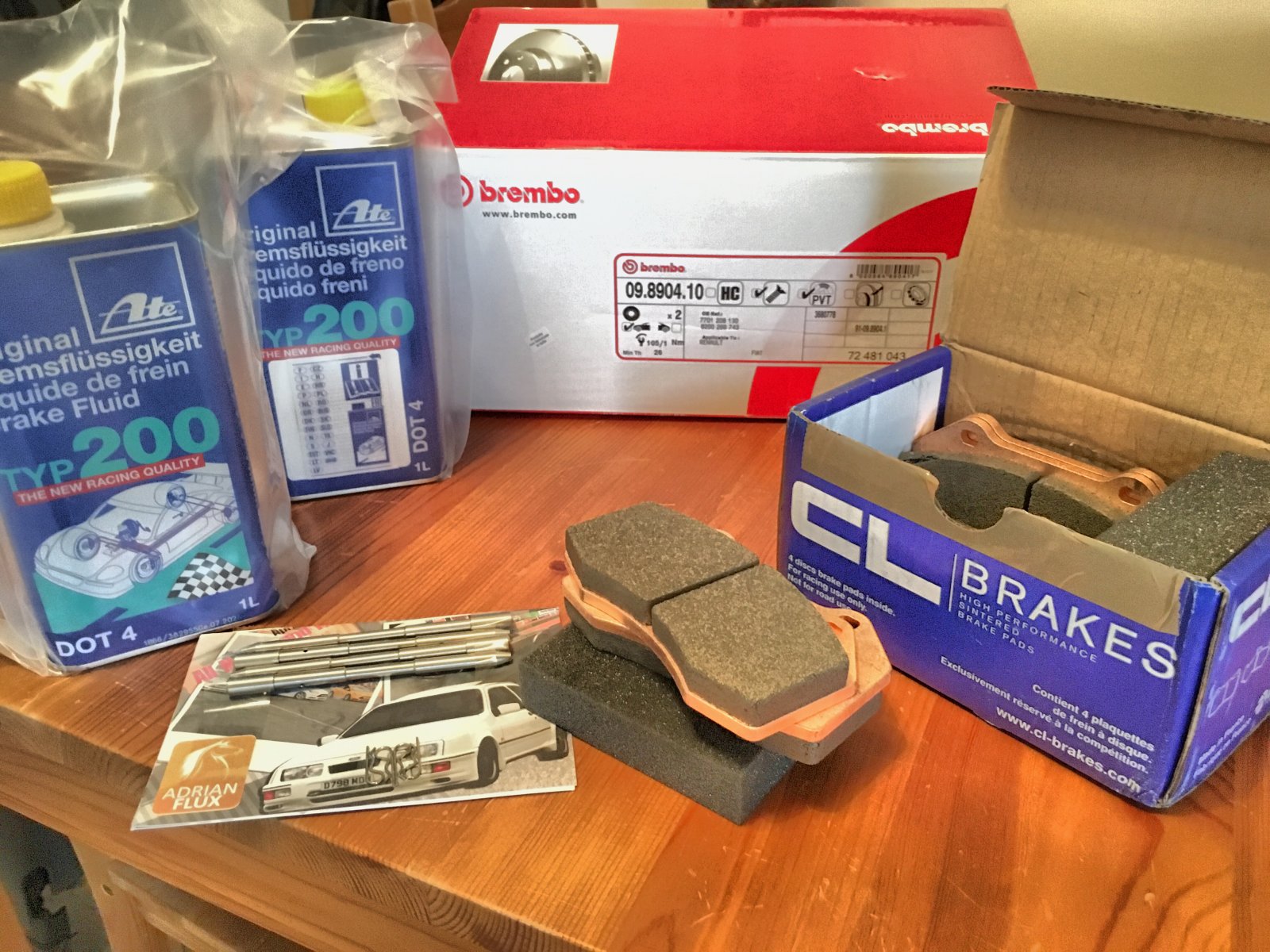

Made the most of the fair weather today and changed the rear pads and touched up the calipers. Think they were about due...
Hopefully this will improve the slightly long pedal.
Will pop some new ATE fluid in shortly and I might pop the front pads out to see how they look. I'm going to try some EBC Orange pads once they're ready to be changed but I don't have any immediate track plans so no need to do it right away.
Hopefully I'll get the opportunity to pop out and give it a good clean tomorrow, I have an Evo magazine sticker for the rear screen to as I'm a bit of a fanboy!! :)

Brake pedal still feels a bit long but maybe it will just take a little time for the pads to bed. Or maybe it wants some new fluid and a bleed.
Going to try and find a punch that's the right size for the Brembo pins and get the end machined concave to make pad inspection and replacement a little easier, I have a feeling if I try it with a normal punch the caliper paint will soon be a mess!

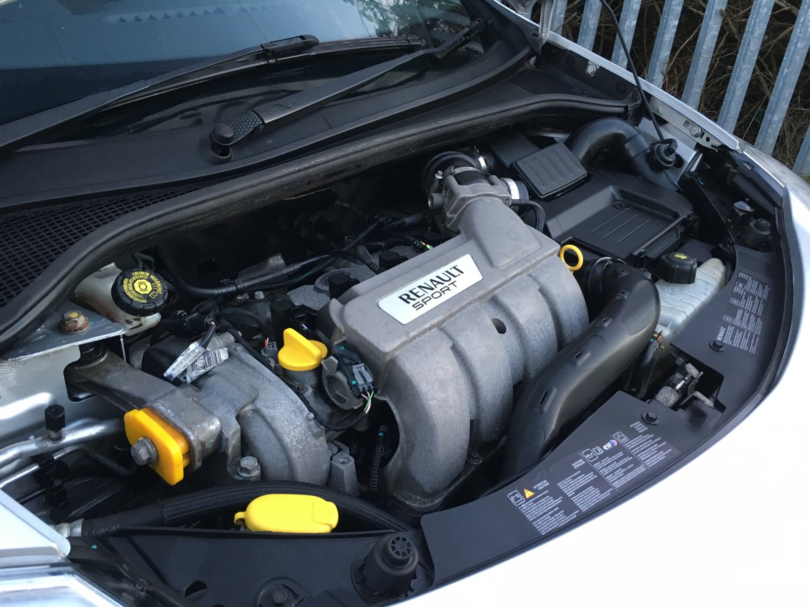

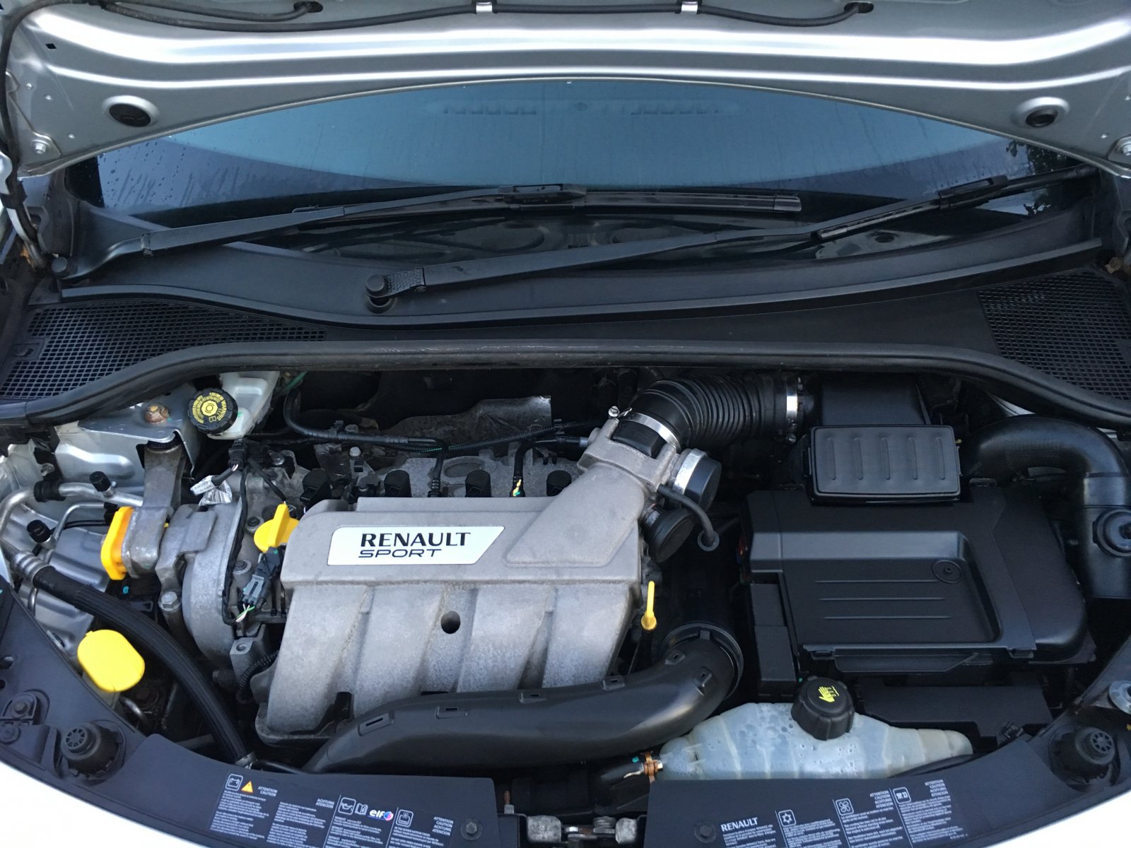

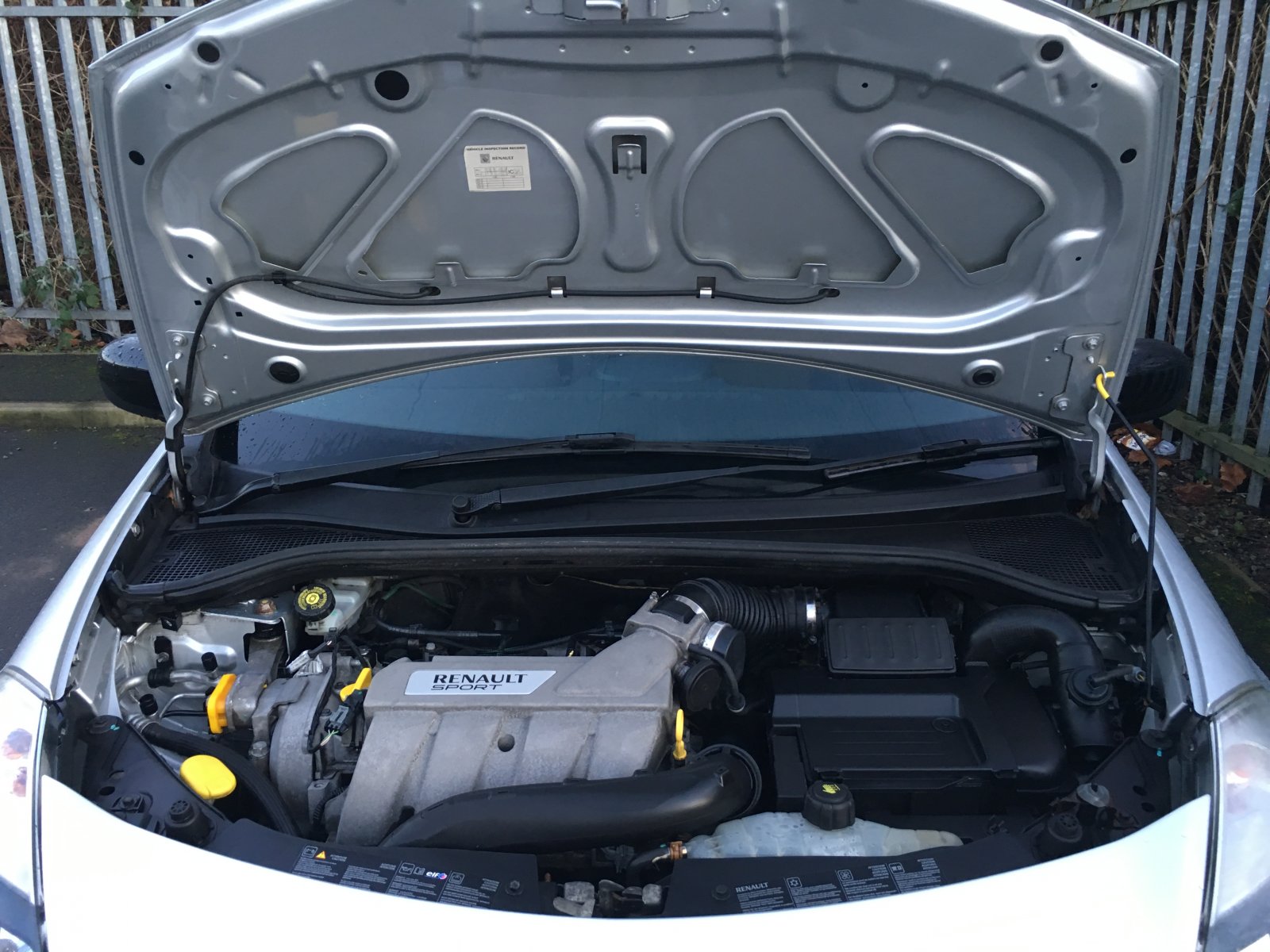

Did the engine bay and underside of the bonnet this afternoon. It wasn't in a bad state but just grubby in places, looking much better for 45 mins of effort.

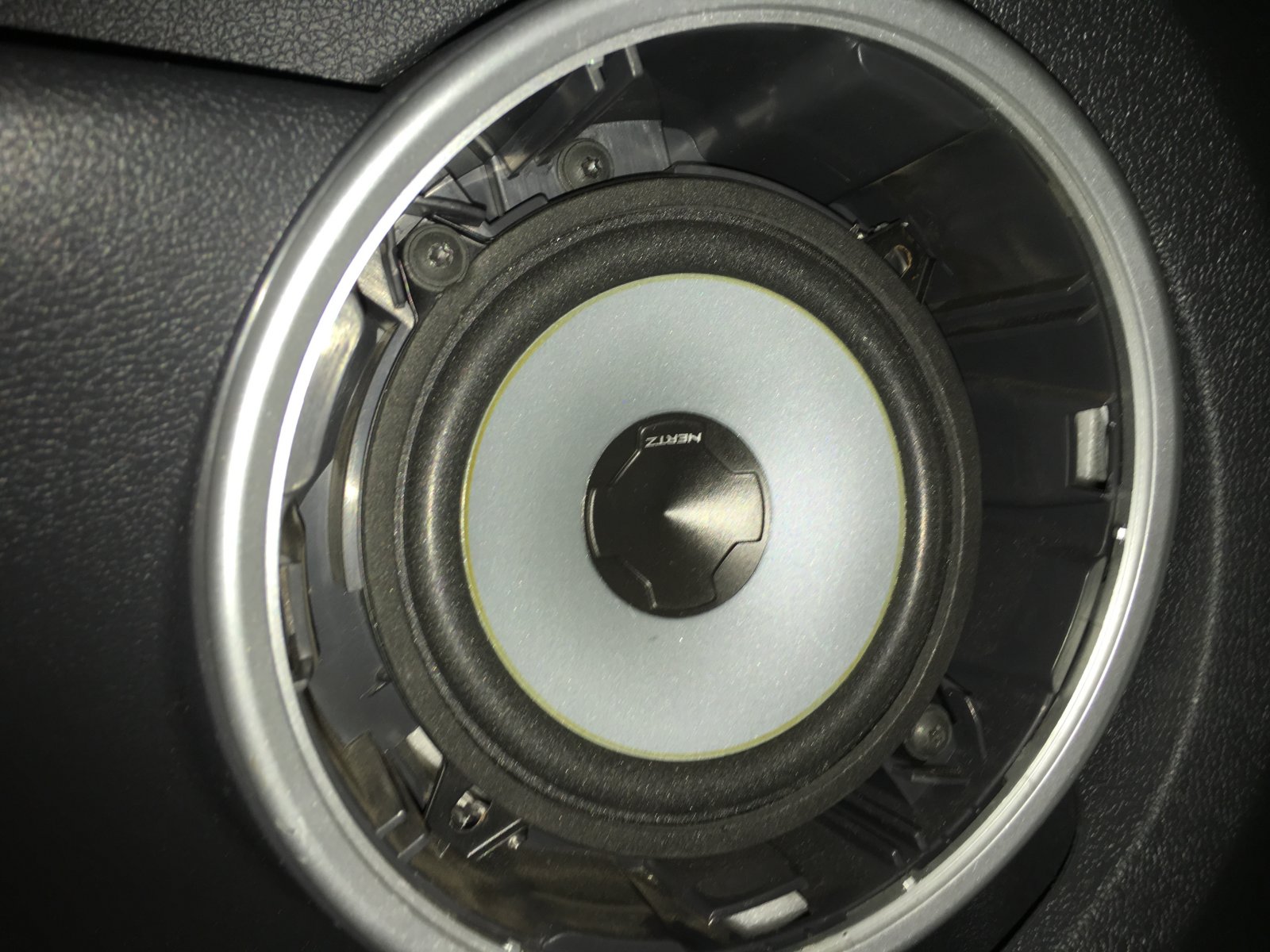

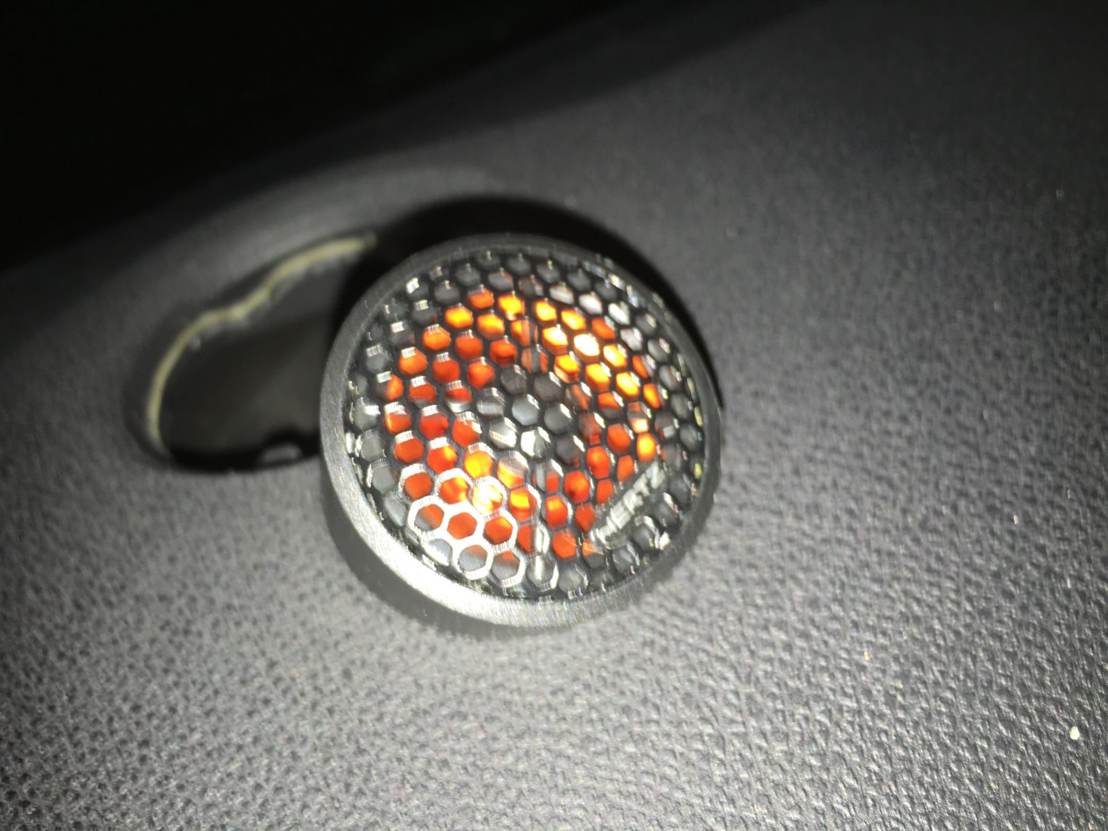

I had been looking at sensibly priced speakers and thought I'd check to see if the car had factory tweeters or wiring that might make components in the front a bit easier.
I watched a video for some pointers for removing the tweeter covers but it didn't really reveal much, luckily there were some useful comments left below the video that proved more useful.
I got the passenger side tweeter cover off without too much of a fight and there was no tweeter there, so I had a broggle around for the wiring. I found a wire and pulled it to find the end but instead pulled an aftermarket tweeter through!
Maybe someone had added a couple of tweeters to the factory wiring...
I pulled the wire some more and out popped a Hertz crossover, nice!

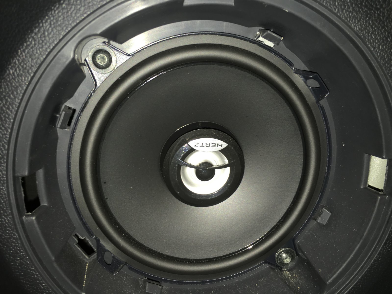

Of course I went straight for the door speaker grill to see if the woofer was still in place which happily it was:
Thought I had best check the rear speakers too, just in case...
So a couple of nice finds! It's a good job I checked before ordering any speakers!

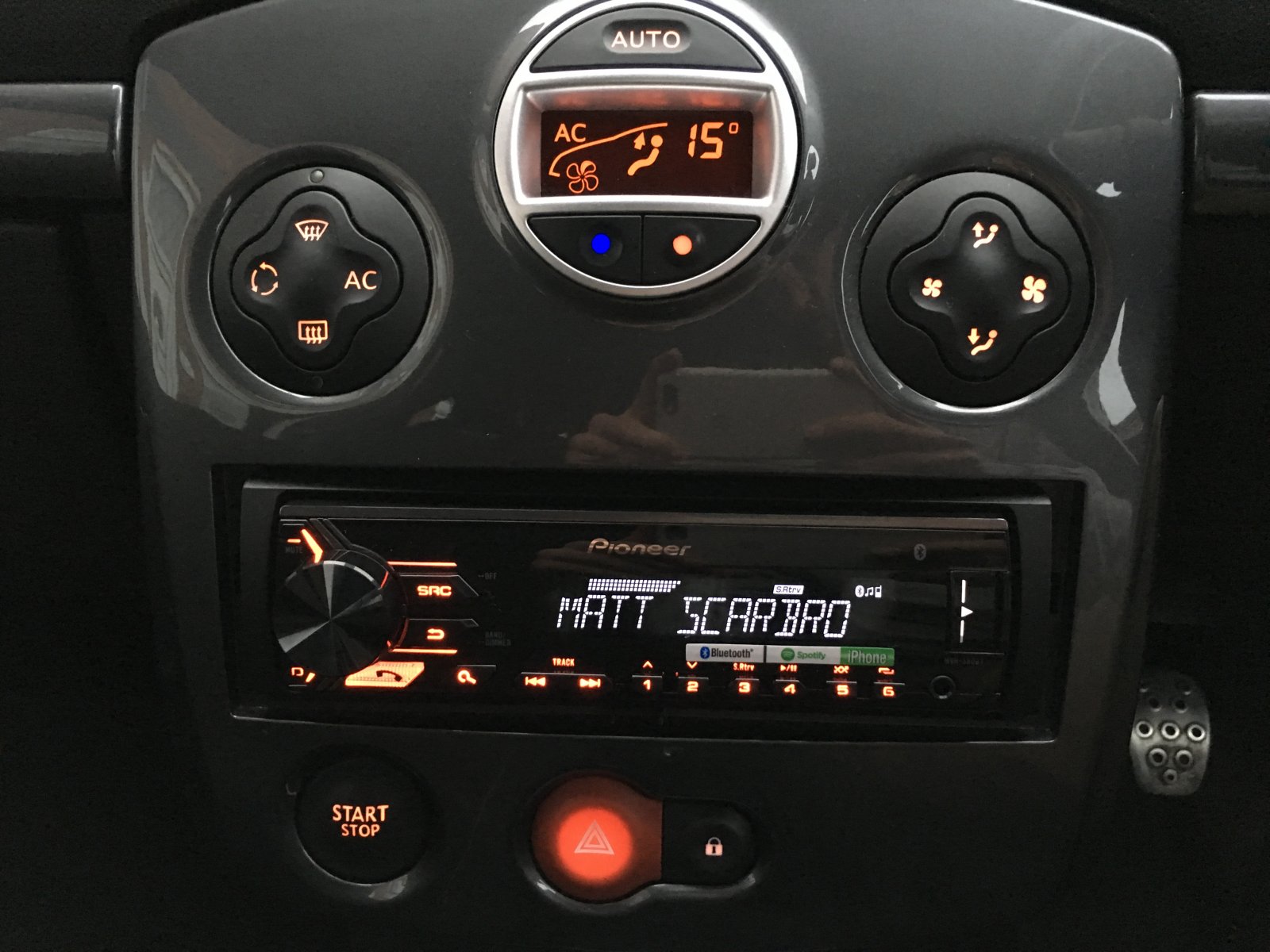

Bit more tinkering on Saturday, thankfully in the car as the weather was rubbish!
I ordered the audio parts last weekend for a budget sensitive and discreet upgrade with Bluetooth connectivity.
Head unit £67 (when I bought it)
http://www.halfords.com/technology/car-audio/car-stereos/pioneer-mvh-390bt-bluetooth-car-stereo
Steering wheel control harness and patch lead £40
https://www.ebay.co.uk/itm/271990994706
Mini amp £73
https://www.caraudiocentre.co.uk/product_m-pioneer-gm-d1004_p-32858.htm
So £180 total for parts including delivery.

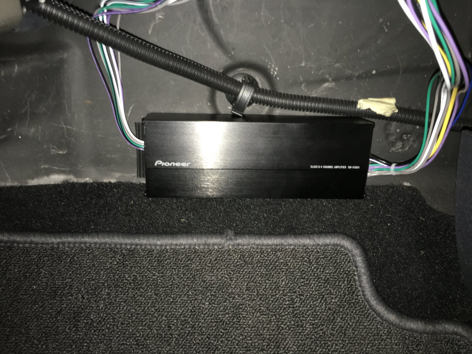

In theory it was an easy installation and happily it was very much so. A quick google told me how to remove the glovebox which made the job so much easier. I routed the microphone wire up the passenger A pillar to save messing about under the steering wheel and affixed the mini amp behind the glovebox.
The short-case mechless head unit meant there was plenty of room for all the cables which can be a headache with normal units, it went together very simply and worked as it should first time!
The beauty of this sort of amp is that it requires no traditional 'amp wiring kit' and instead fits between the car loom and the head unit harness. It's nice and compact too which makes finding somewhere to mount it easy.
For fairly modest outlay I've brought the cars media system up to date and the sound output is now very respectable, I'm chuffed with the results. :)

Yes, very noticeable, well worth the money. I should think I will ditch the rear speakers and bridge the rear outputs for an under seat sub eventually.
  RS 197
The sound stage will be poop if you do it this way. The rear cavity will have no sound being produced there so you'll hear the music from the middle and the front of the cabin.
Wire the rears to the head unit, then you can do the underseat sub with those freed up amp channels.

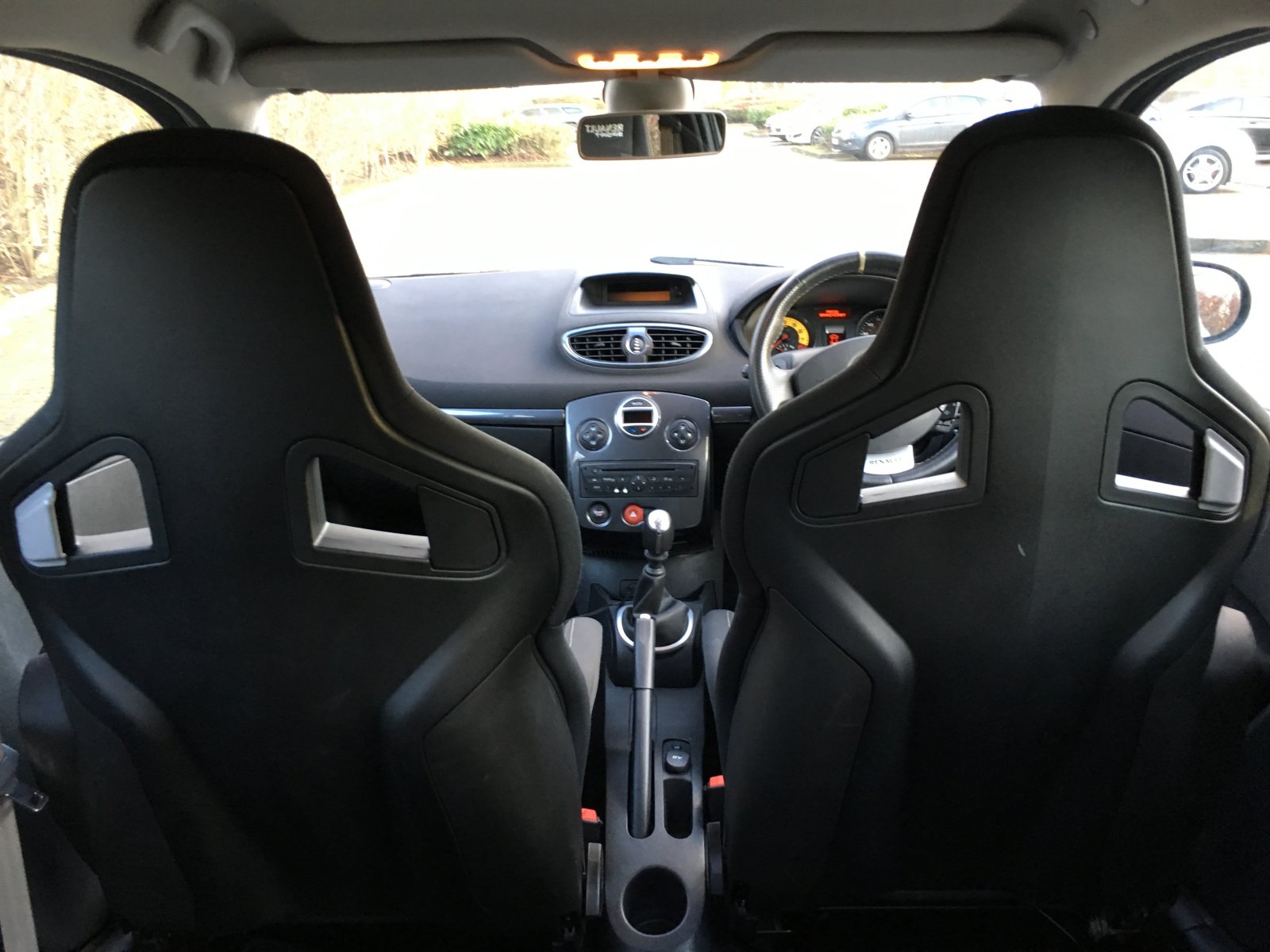

I had been doing well with spending sensibly on the Clio until it went horribly wrong...

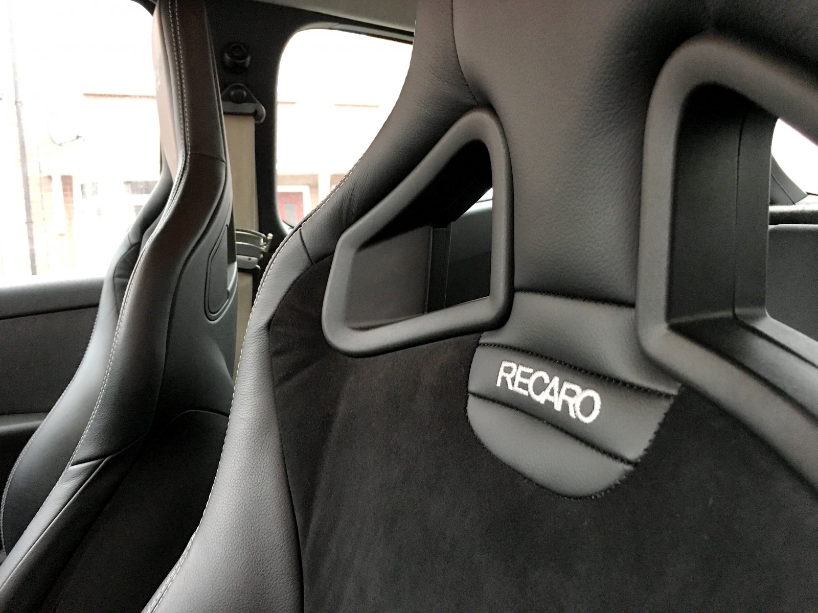

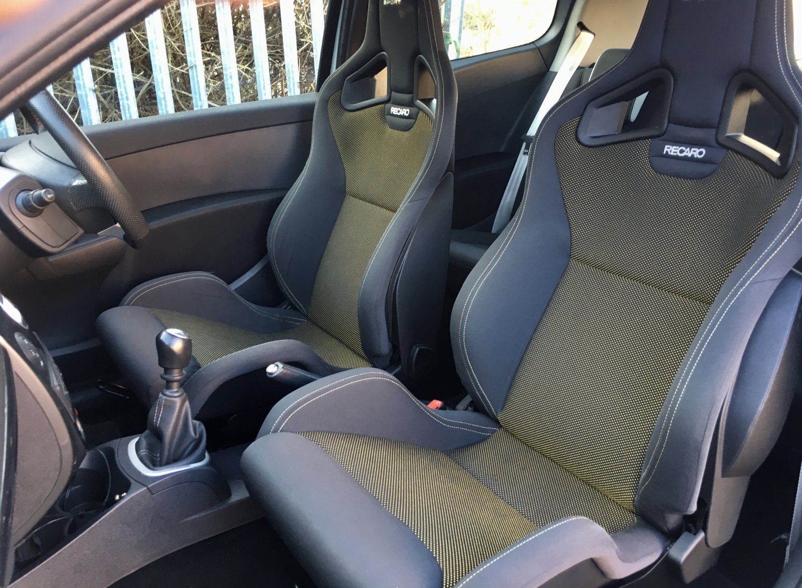

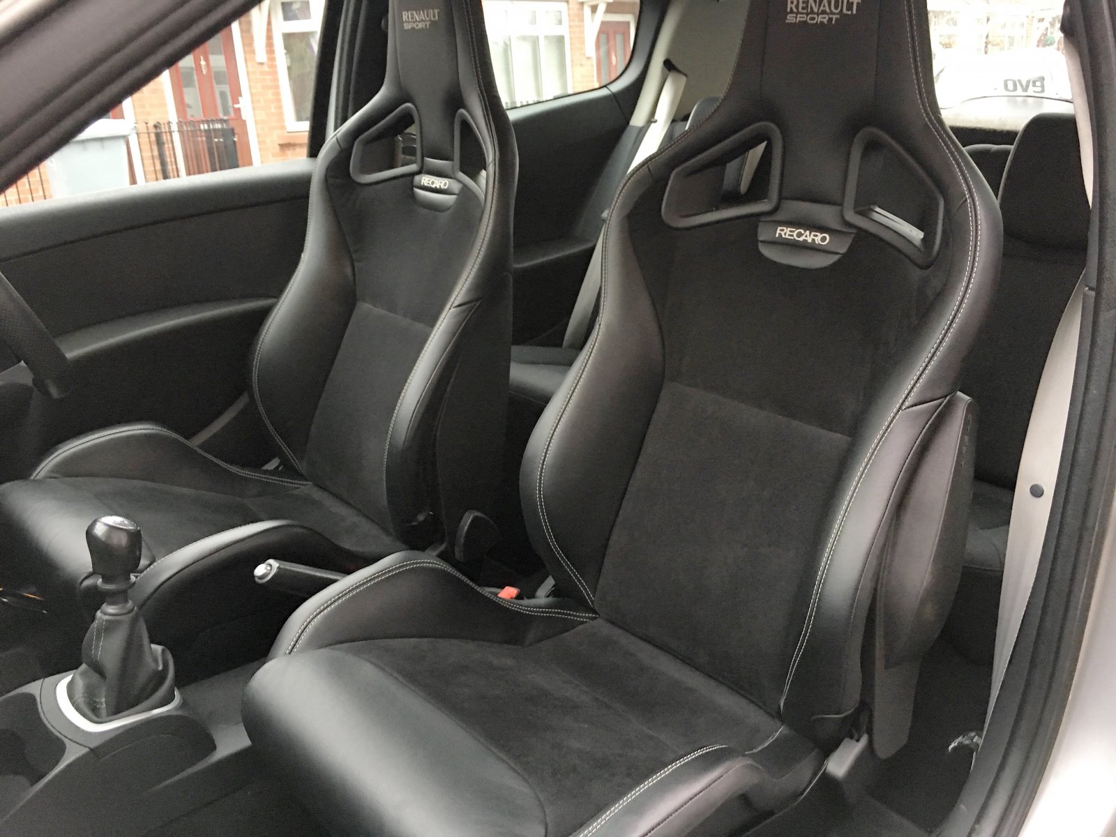

I had been considering a seat refurb so when these stunners popped up I couldn't resist. They really are lovely, I'm delighted with them.
I have also bought a spare steering wheel so I'm dropping that off at Snappy's this evening for him to work his magic. I think plain leather with silver stitching to match the seats and a red centre marker is the way I'll go. :)
  200 Cup, 435d, 2xMX5
Big money but not crazy once I've sold the normal 200 Recaros.
Will be something I can enjoy every single time I drive the car! 😌
Old ones will be in the for sale section once I've cleaned them up and taken some pics.

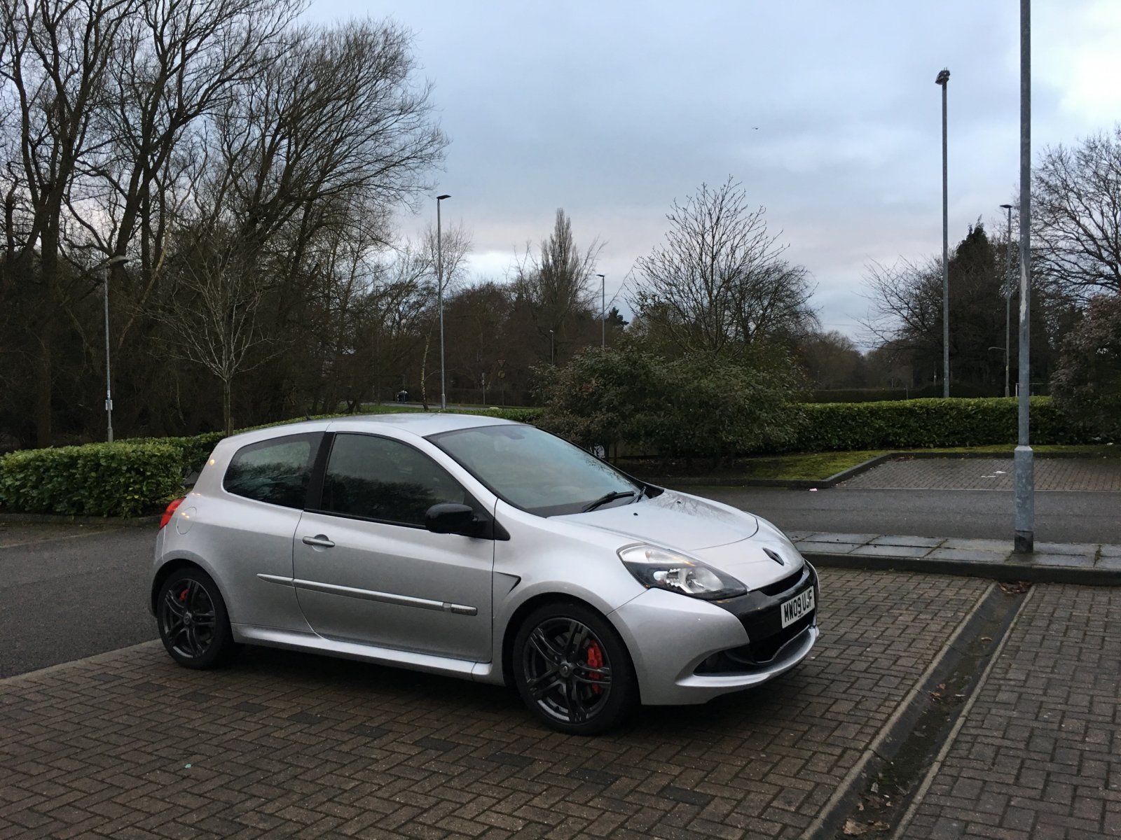

Another consideration when I bought the car was that it had budget tyres fitted. Why on earth do people do this on driver's cars, such a shame!
So I knew I needed to buy a new set from the outset. The alloys were also in poor condition so I reasoned that this would be an excellent opportunity to get them refurbed at the same time.
I was caught between going for ContiSport 5s, Toyo R1Rs and AD08rs. In the end I chose the Yokos as I don't think the others would stand up to dry track sessions. I was a little concerned that the AD08rs might be a little louder and harsher riding but I was hopeful having spent time in other cars with them.
Old vs new...

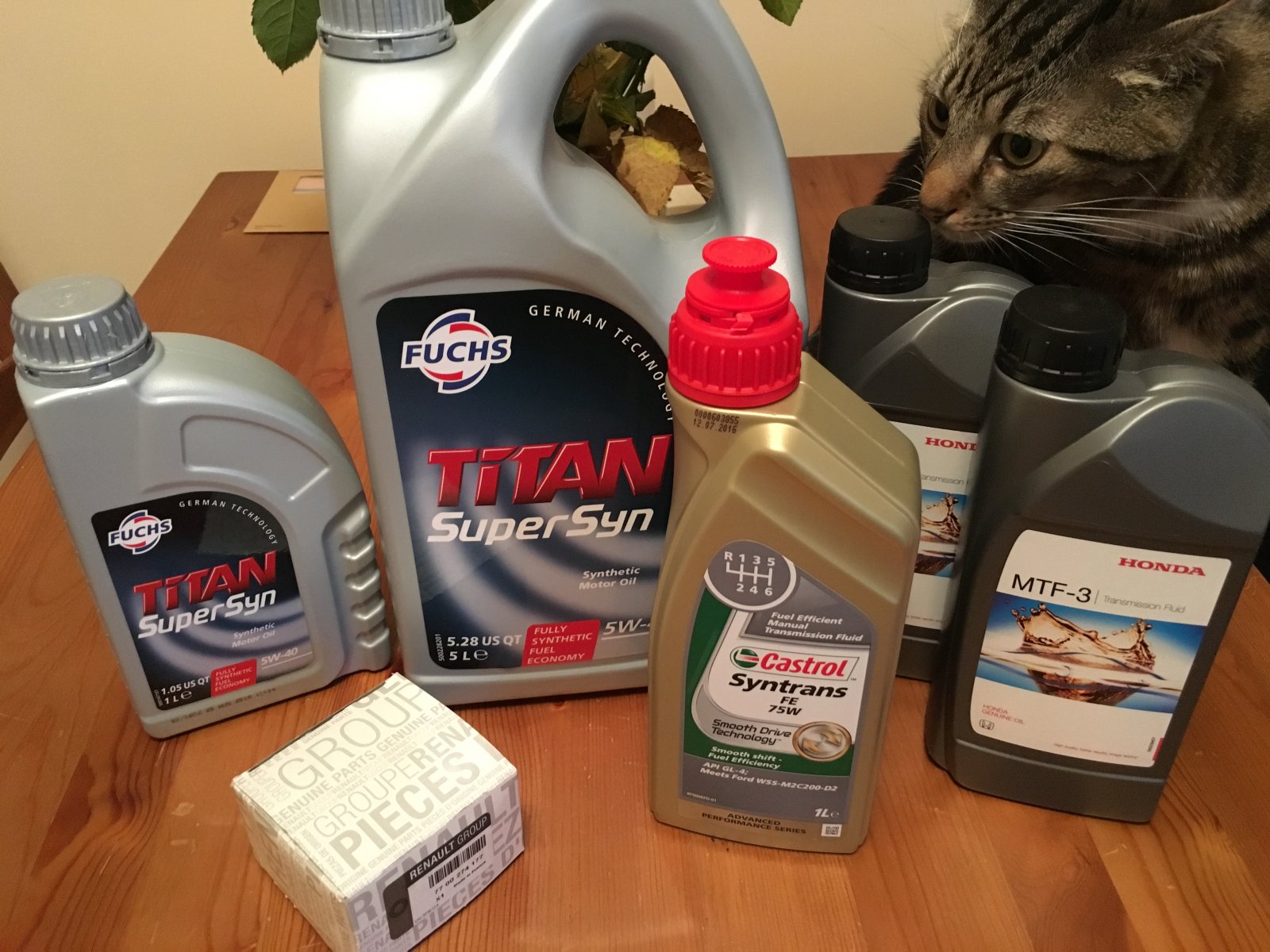

Whilst it's there I've also booked the following:
Engine oil change (only 5k since I did it but it can't hurt)
Gear oil change
Front pads with R-clip pins
Brake fluid change
So it should be in fine fettle when I collect it! :grimacing:

Back on topic and I now have all my bits to get the brakes ready for track action!
Experienced some, erm, budget creep on the pads! In the end I couldn't convince myself that any of the track options wouldn't squeal so I've just gone for a good track pad that I can swap back to OEM Pagids for road use.
I've been wanting to try CLs for a while so this was a good opportunity and as I've got some more Brembos for the MX5 I could technically use them on that if I ever needed to! That was the justification anyhow! 😂
I'm keen to try it with the standard hoses before going braided, hopefully it won't need them.
