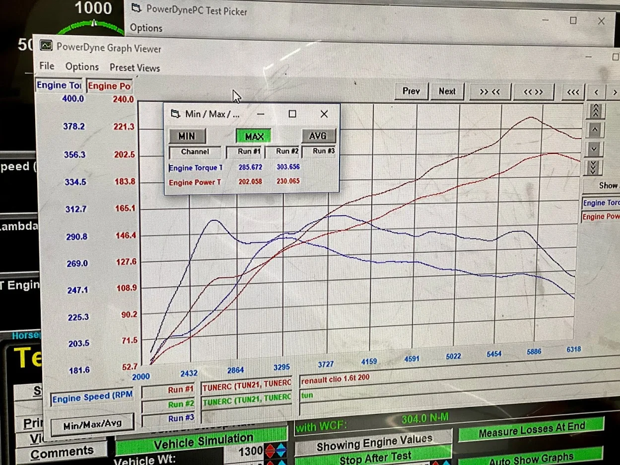

Long story short, we gained about 30 hp and around 40 Nm of torque at some points, as you can see from the graph bellow.
Note that the car is completely stock and only has K&N panel filter and the exhaust valve.
It was interesting to see that the stock power was only 203 hp and not 220 as it is stated but we all know that the same happened with previous rs models (200 had around 185, 182 had around 175 etc.) at least in my case.
Sooo, I can say that the car really feels faster now especially in the higher revs. It pulls really good and the pops and bangs are a nice touch. They come on at 5000-5500 when you lift the throttle so they are not disturbing all the time. There is a restriction with the gearbox, as it doesn't allow more than 300 torque bellow 3000 rpm, so we had to take some precautions.
I also did a 100-200km/h test (with PGEAR) on the highway before and after and I am happy to say that I gained about 4.5 seconds and that in my opinion is a lot! My 100-200 time was 16.5 seconds.
