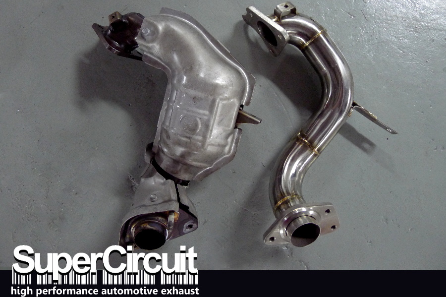

But with the Stock Downpipe? I live in switzerland. Im pretty sure that the friends in blue wont notice the turbo/pump/IC but would see the downpipe.
I know that it would reduce the power but i guess i could still hit 300 HP with a OEM Downpipe

Could you get a custom downpipe made to look similar to the OEM piece?
From the looks of things, it's mostly covered by heatshields anyway, so as long as brackets to mount those are in place, it's be very difficult for anyone to tell the difference.

Because then i could buy a scorpion downpipe with 200 cell. Cat. And drive like that. And the injectors are okay stock?
Adey.
Stock injectors are fine to a shave over 300 bhp. The ktec turbo  IS the mamba turbo (19t) you'll need a better in tank pump if moving away from the stock turbo. The oem downpipe to front pipe joint is 1.5inch ID, it's stupid small. I'd be getting rid of that before anything else, in anyway possible.
