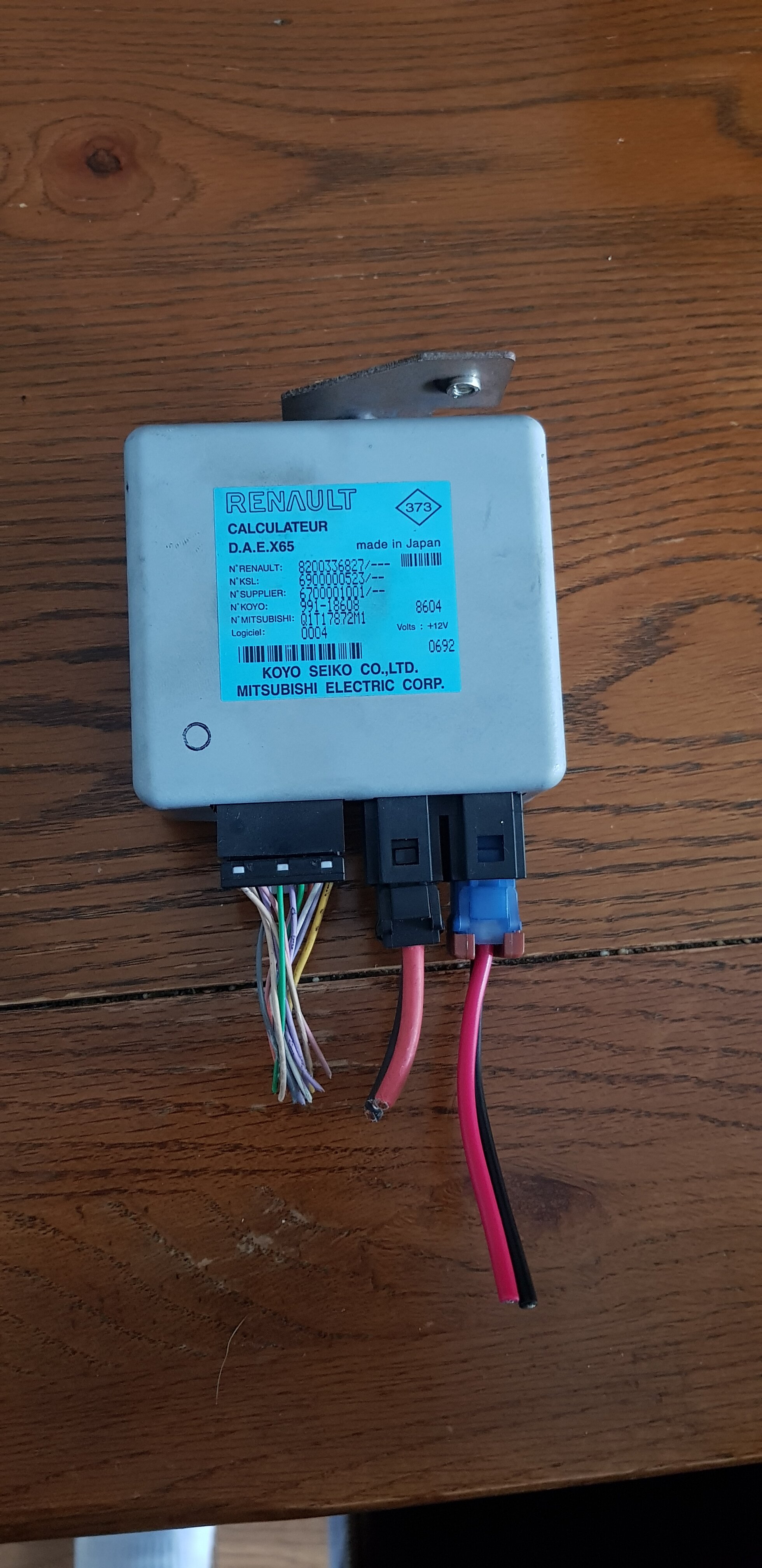

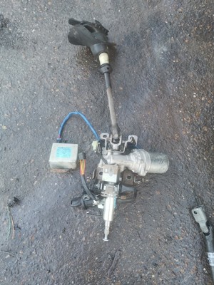

These are what I’ve been linked too from here in the past.

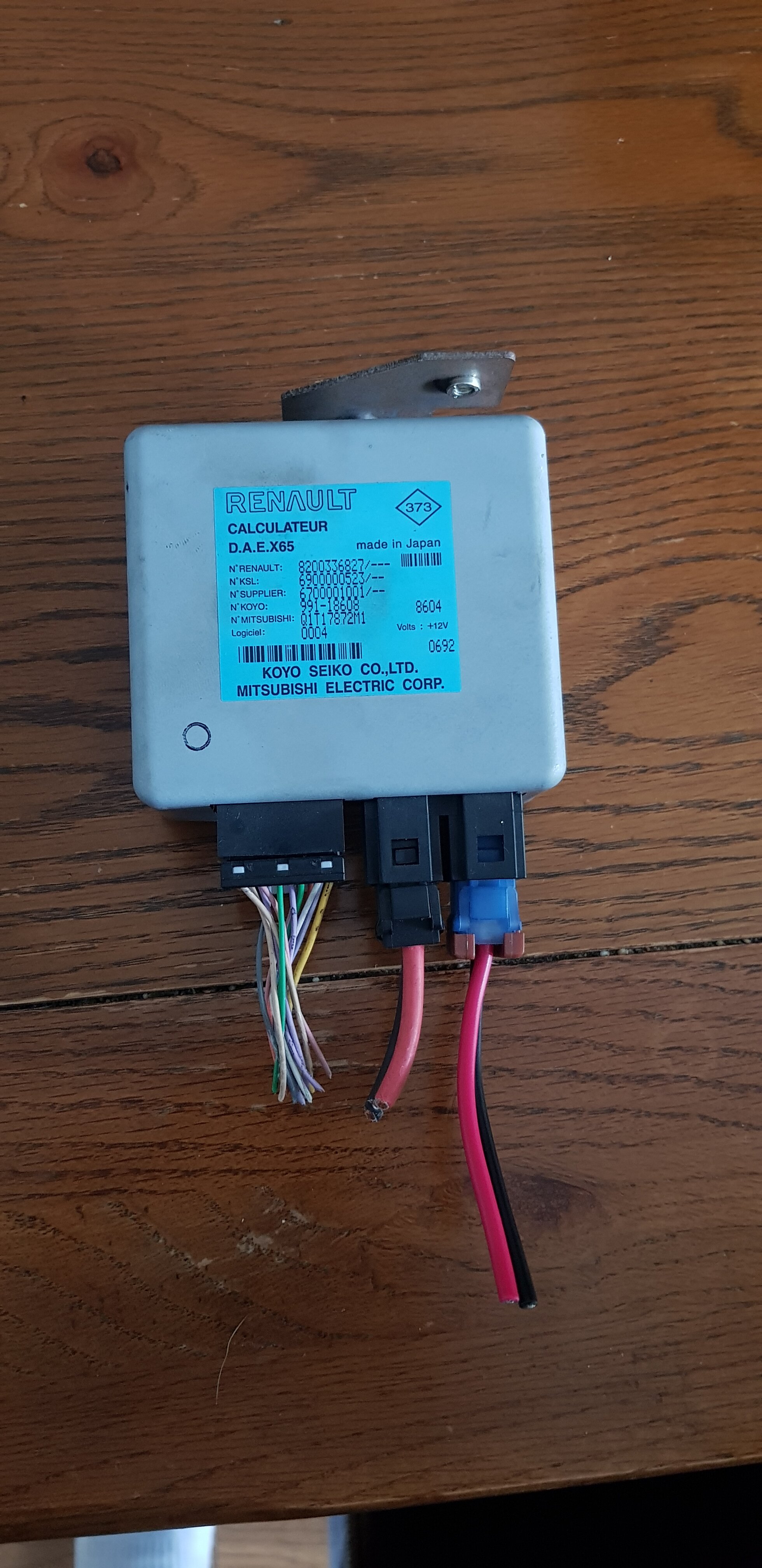

Can you explain what each plug does please. Blue is the one that goes to the motor isn’t it. What does the black and the rectangle one do or used for?
@ZachB That picture above of the ECU, could you tell me what each plug is for please? I'm guessing the blue blue is the cable that connects the ECU to the column motor?
Blue is from the motor, black is power from battery and ground, rectangle connects the column to the ecu and there is also a small power and ground. The instructions that come with the kit will tell you which colours do what and where to splice them. What wiring tools do you have?

@ZachB I think I understand. So what should I be asking the bloke at the breakers to keep connected?
Blue plug - shouldn't be cut and connected to the motor its blue sheath.
Black plug - just need a length of cable attached so that I can add on and run it to power and ground.
Rectangle - shouldn't be cut and should still be connected to the column?
Where is this small power and ground cable found and the kid you speak of is the one off of eBay/inferno?
The wire in your pic, where would I find these? My Clio is currenlty stock by the way.

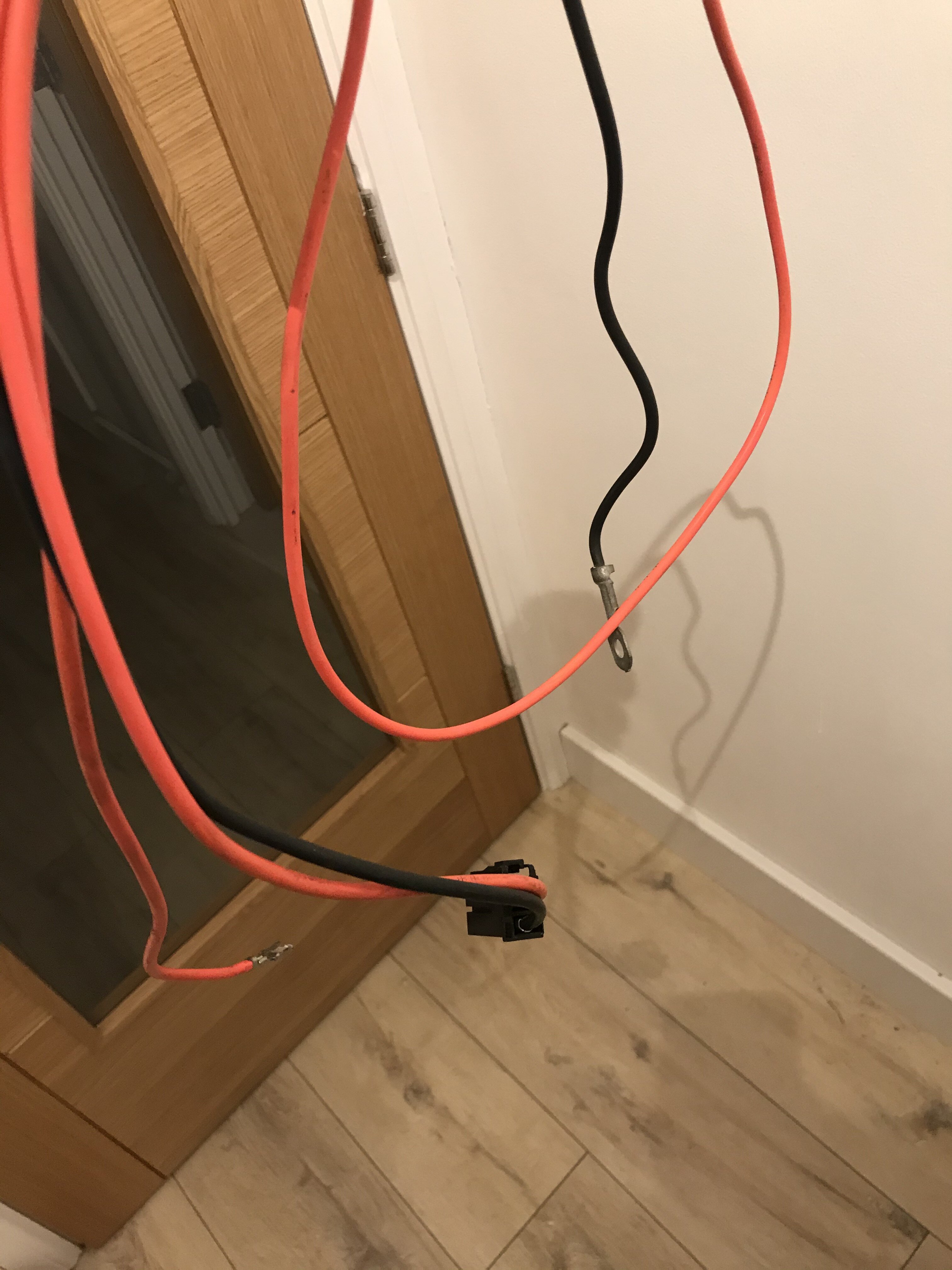

I didnt see you'd quoted that post I made on the column from ebay sorry. The picture of the wiring Im holding and one other wire that I may have (I need to find it) combined with the column and ecu with the ebay kit you posted is what you need. I can send you the the power and earth wires (pictured) so you dont have do any crimping, I have spare 50/60a fuses (forgot which they are) as well.
I would appreciate that. I have purchased one the racks from the eBay posting you posted and just asked him to keep the wires attached as I wasn't sure what it was I needed. If you message me I will sort out some postage and some extra for your troubles.
No problem but you need to check first if you have that wiring! Because my 182 loom didnt but 172 cup loom I had did
It will be near where the steering ecu would be to the right of the column if so.
I will check and let you know. Mines a non cup 172 so not holding my breath
