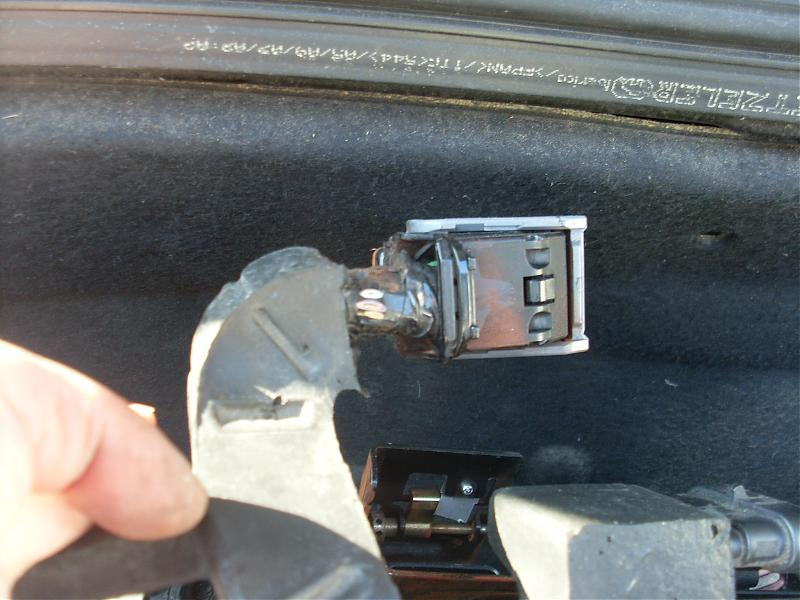

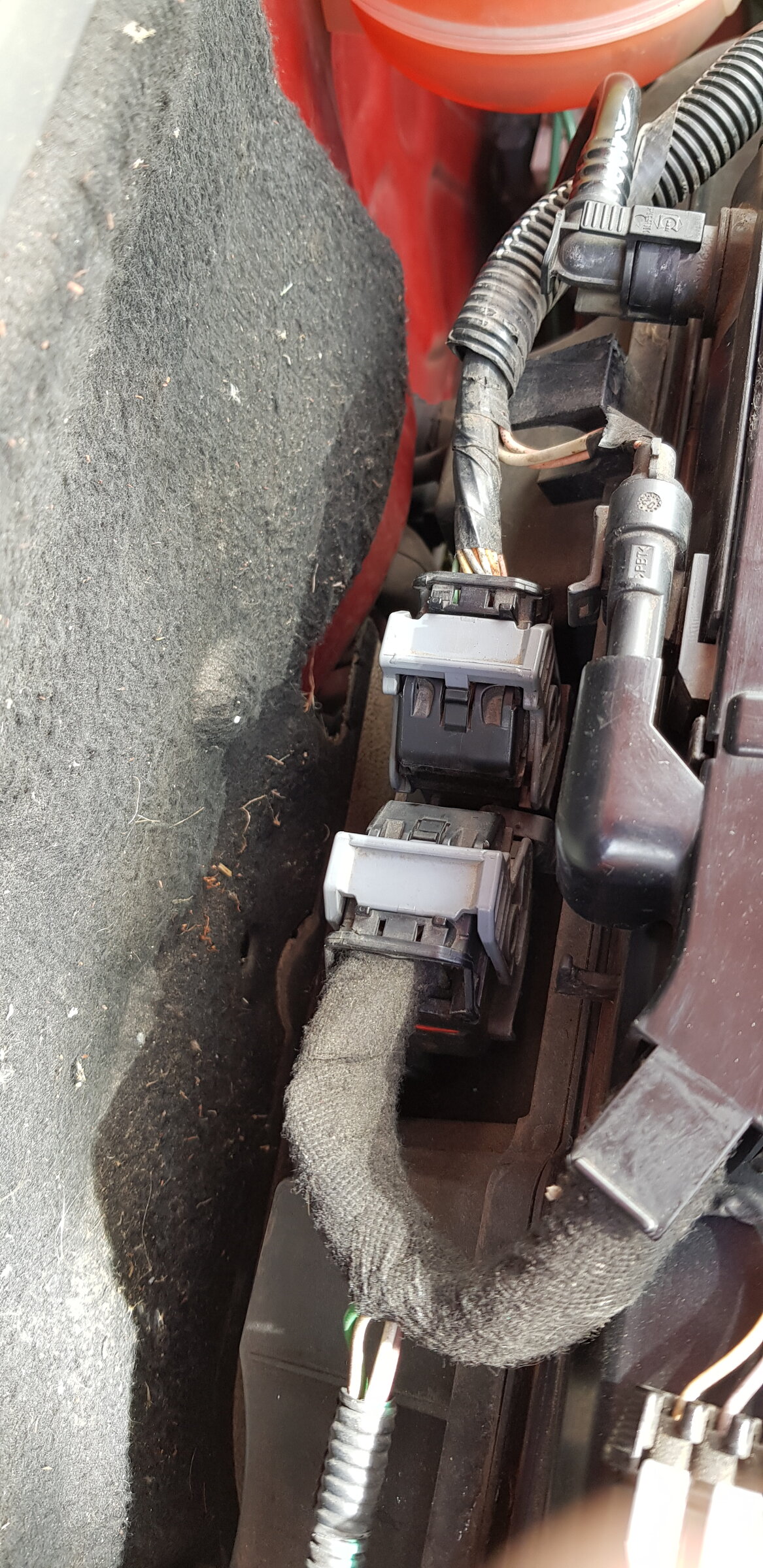

The wiring loom bracket that goes to the ECU on the inlet will have rubbed through, check the wiring there, clean up as needed and cover/shroud/tape any exposed wires. There's a metal bracket thing, just bin that off, it causes more hassle than it's worth!

Seen these issues far too many times, I ended up re-taping a full engine loom on a 1.2 before looking for 1 broken wire 😂

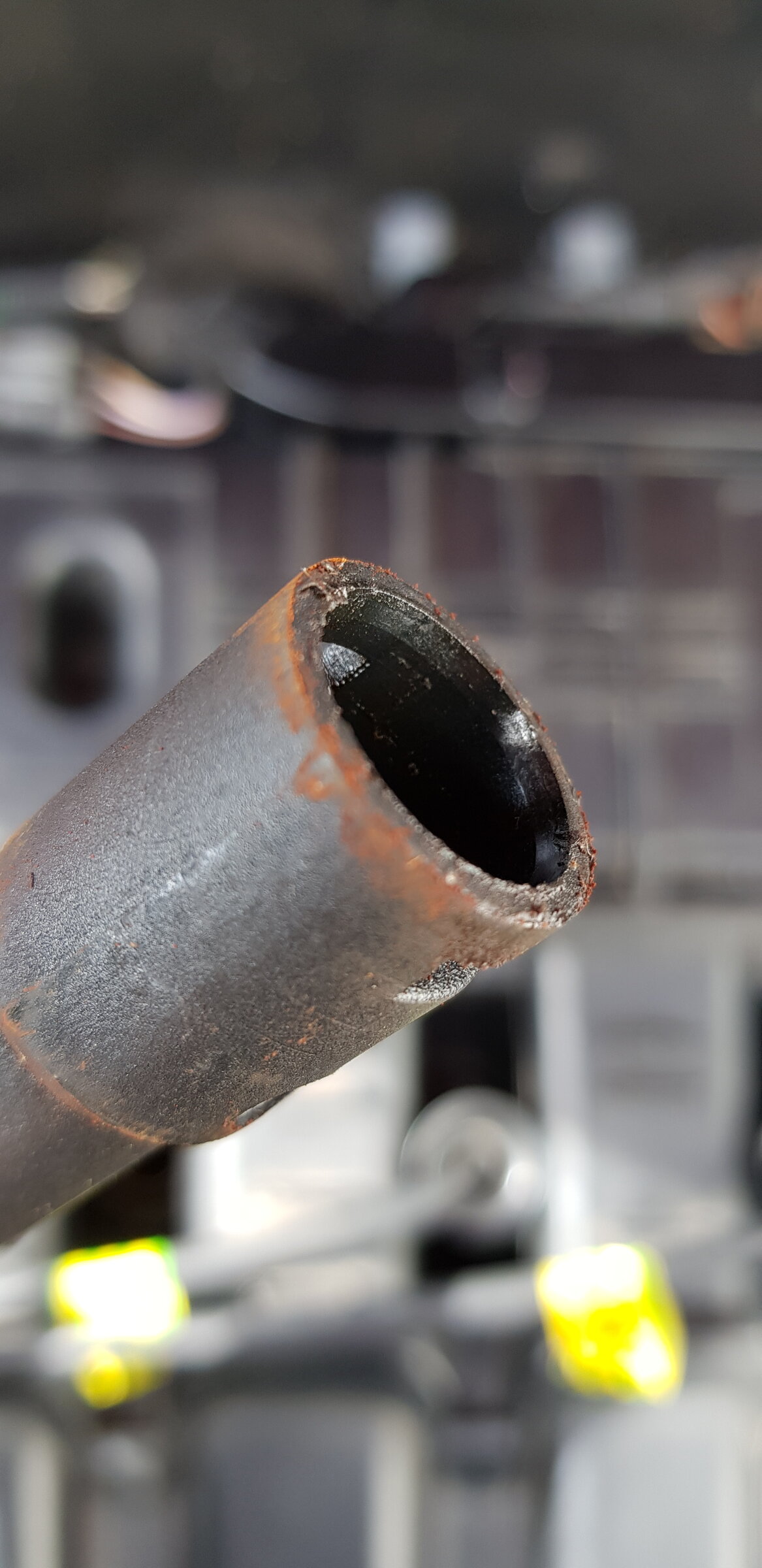

The ht leads seem to all have some brown dirt on it and the one is missing the rubber bung at the tip, pictured below. Is it worth cleaning them up and the bores or replacing them? also good to hear uve had expericance

I'd clean them up first mate
If you struggle then I have a 1.2 16v coilpack with HT leads going spare I think that you can have. As for the breather yes that's the one, you're best off taking the whole airbox/inlet assembly off and giving it a proper good clean out, sometimes the oil will get sloshed around that much and make it's way further down the inlet

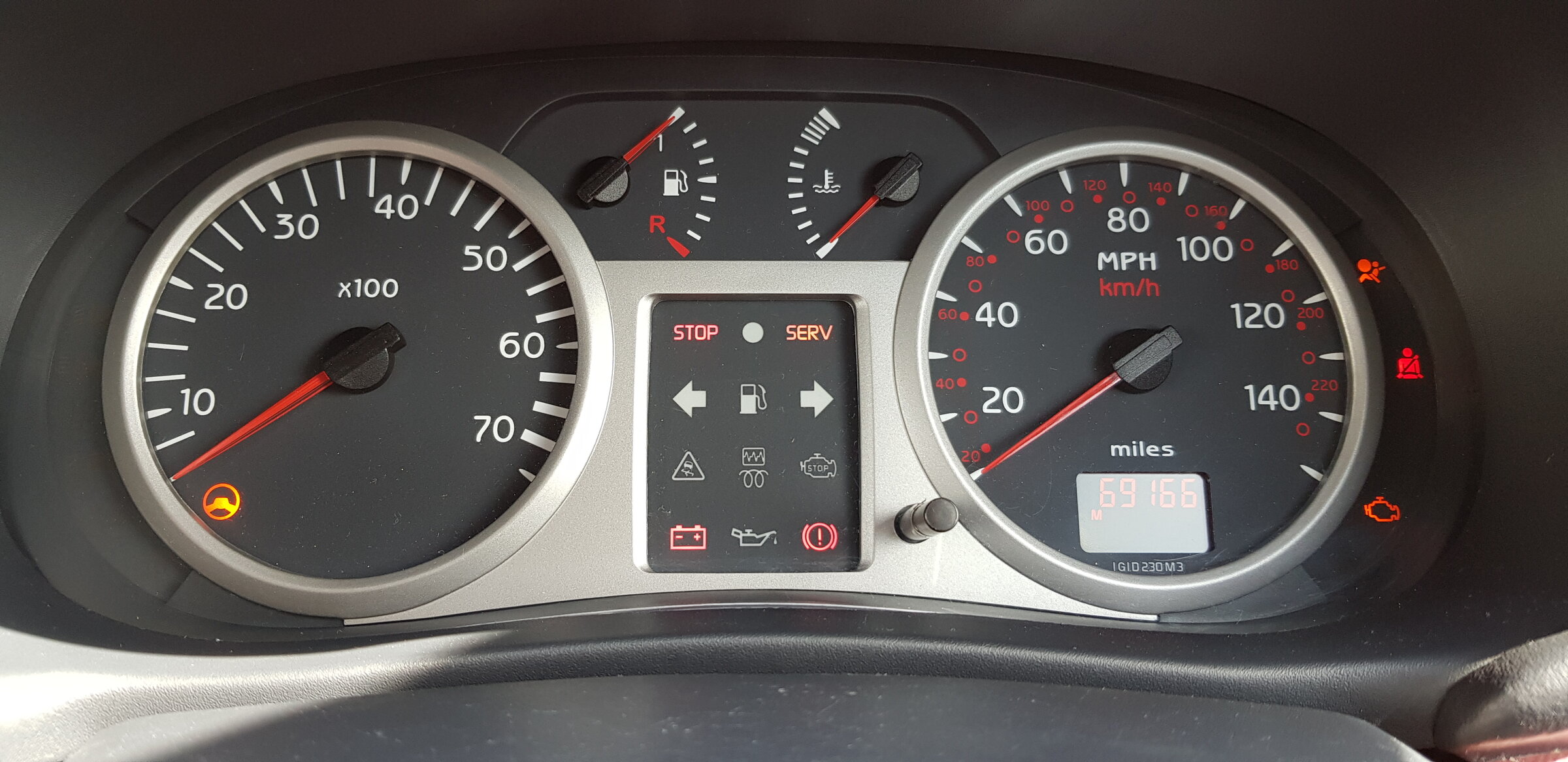

Not sure if that pic will help help

Okay so it looks like yours had already had the heatshield removed and been taped up

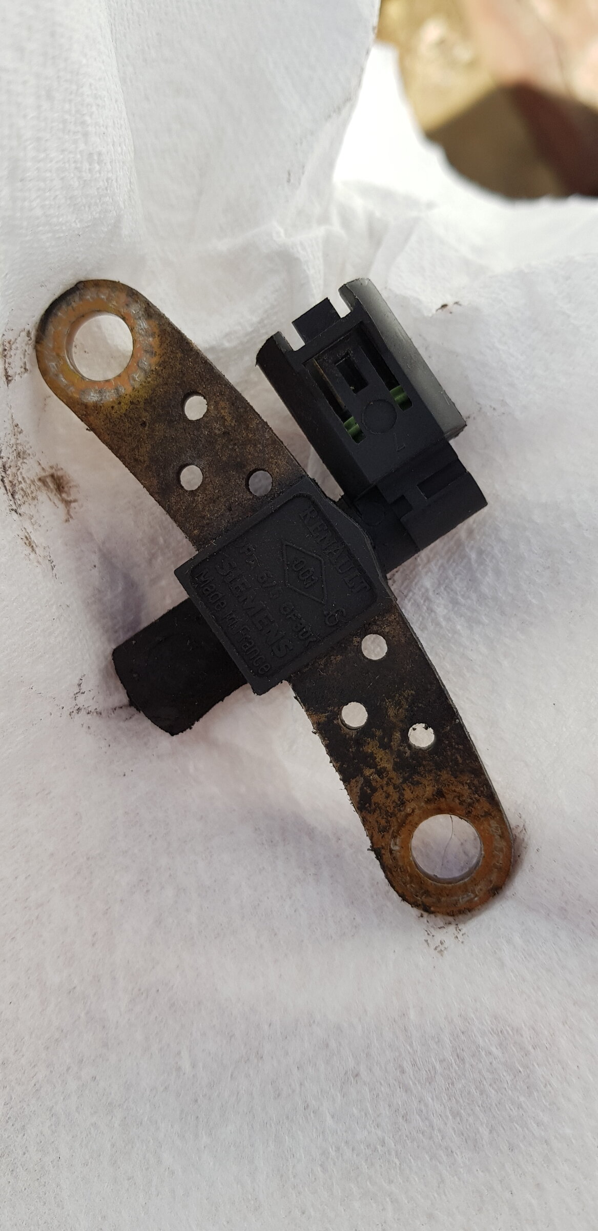

Give everything a once over and give the crank sensor a little wiggle too
If you're in there take it out and see if there's a buildup of clutch material, cleaning it wont hurt anything
Although it should crank over even if the crank sensor ain't seeing the right signal

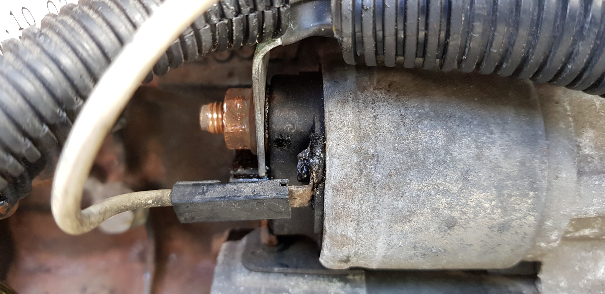

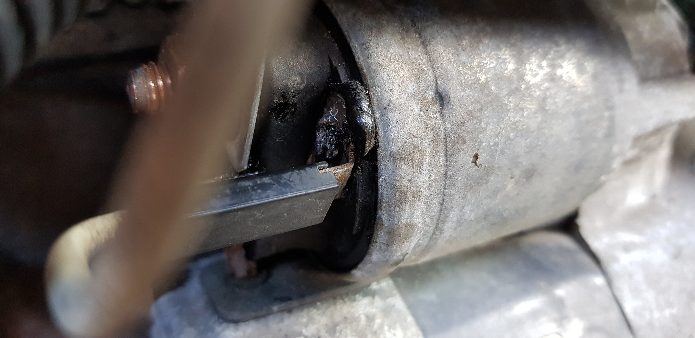

I had to remove this bolt so i could remove the intake , it worth removing it and moving the cable about a bit

Should there be an oil of some sort on it?
I wouldve thought for a solid connection just needs bare metal to metal contact, right?
Ok cool

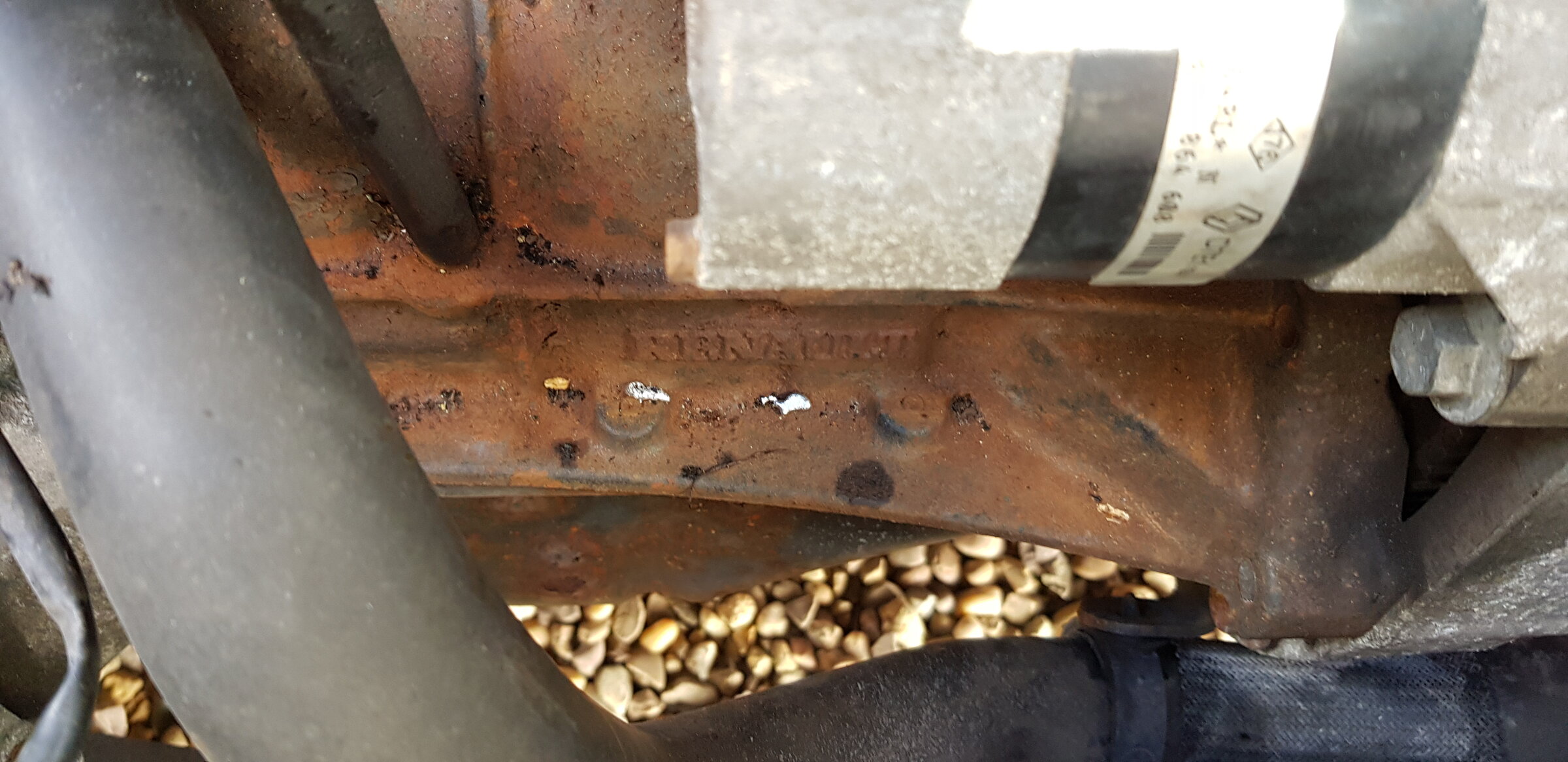

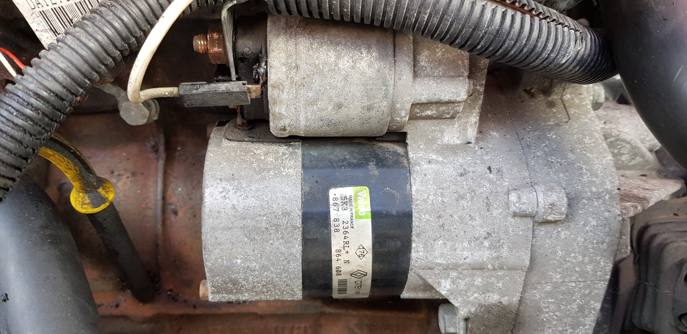

Ive just noticed some solder thats sitting on the bottom of the engine im thinking it mayve fallen off the white wire
