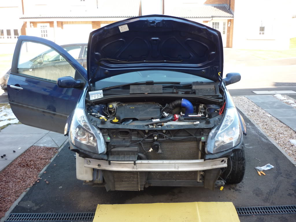

Hi guys was looking for some advice, jst bought a k&n 57i induction kit for my Clio gt but am not sure what to take out (original air box) nd fit it:( has anyone got pics so I have a rough idea how to fit it, cheers
Mate, remove battery, remove battery casing then the air box slots forward and out leaving only the tube that leads to the air box. Need to fit the stand the K&N came with under the battery case before re-fitting all back together:-) only pain is getting a cold air feed to it as old one doesnt really do much good:-/ Hope this helps
best pic i have im afriad!! removed my pipercross viper as was pissing me right off!
