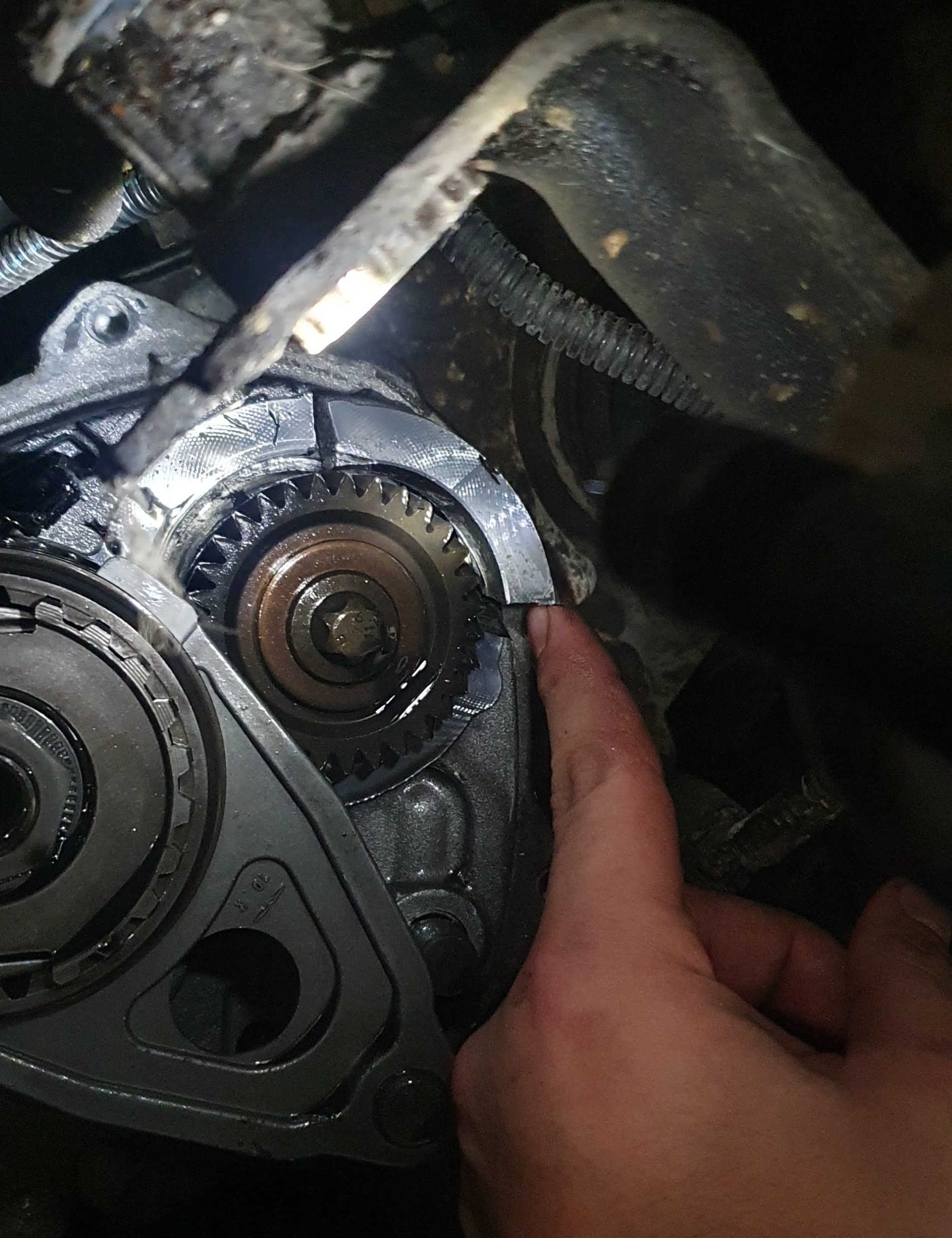

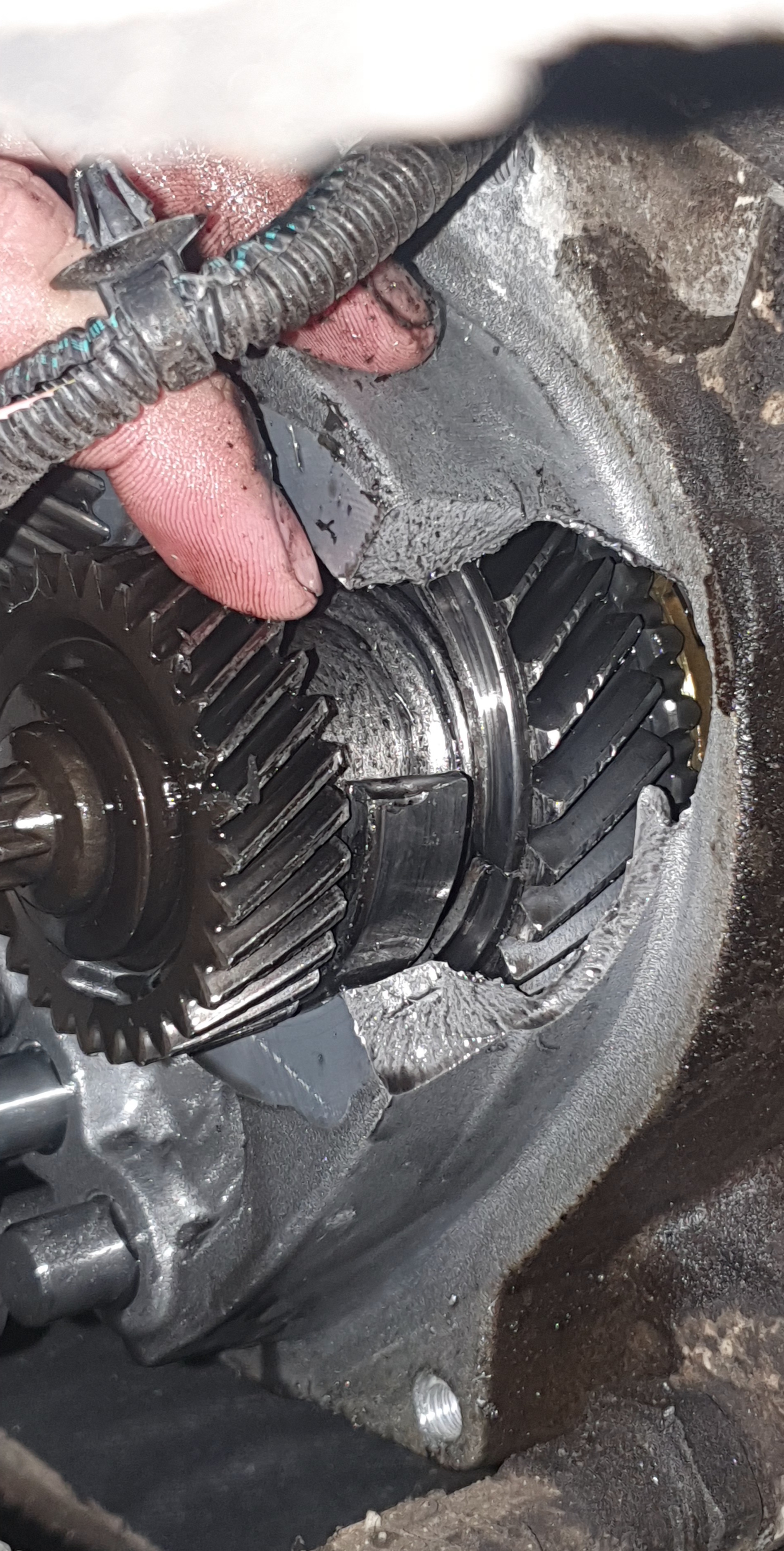

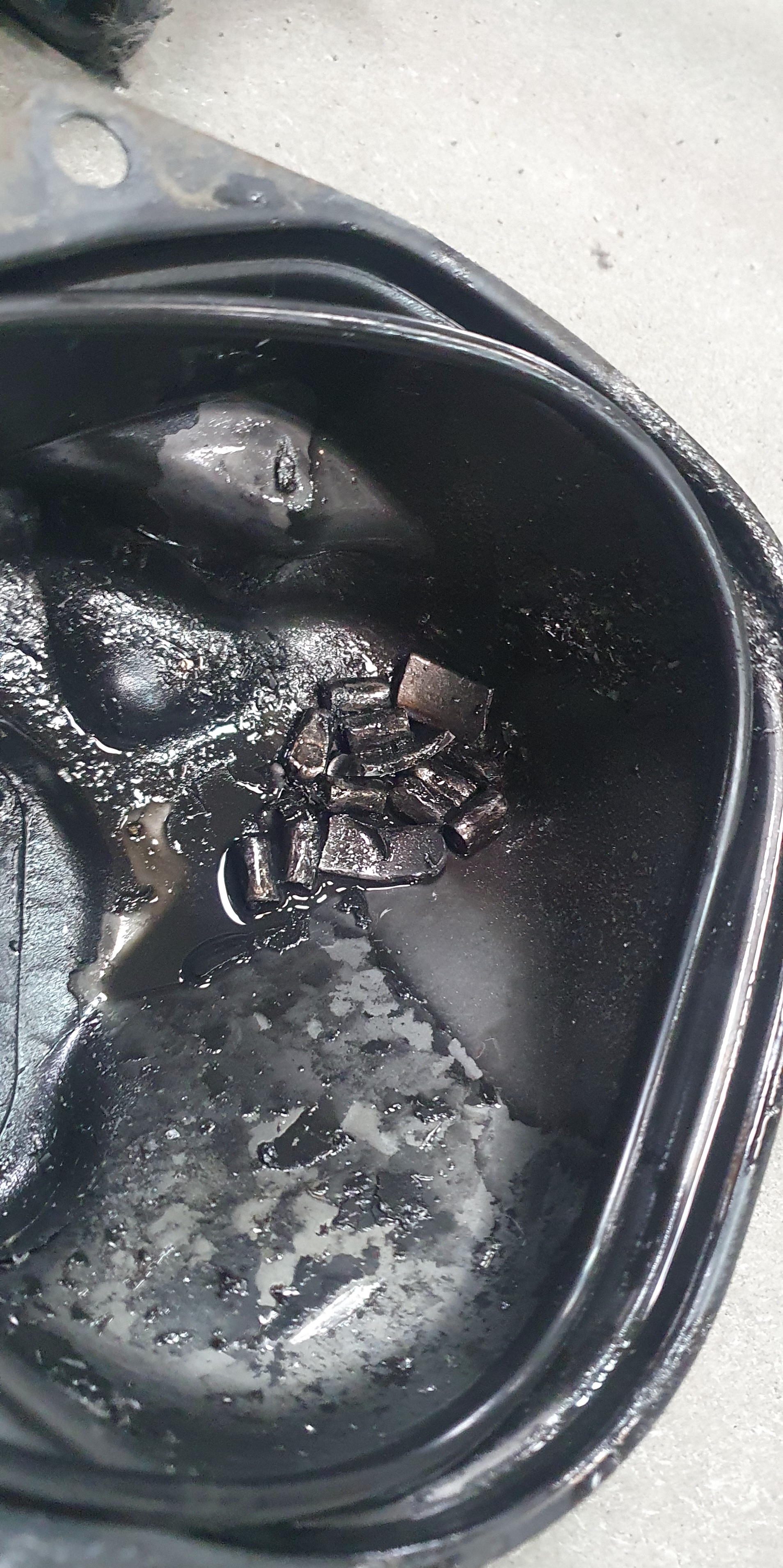

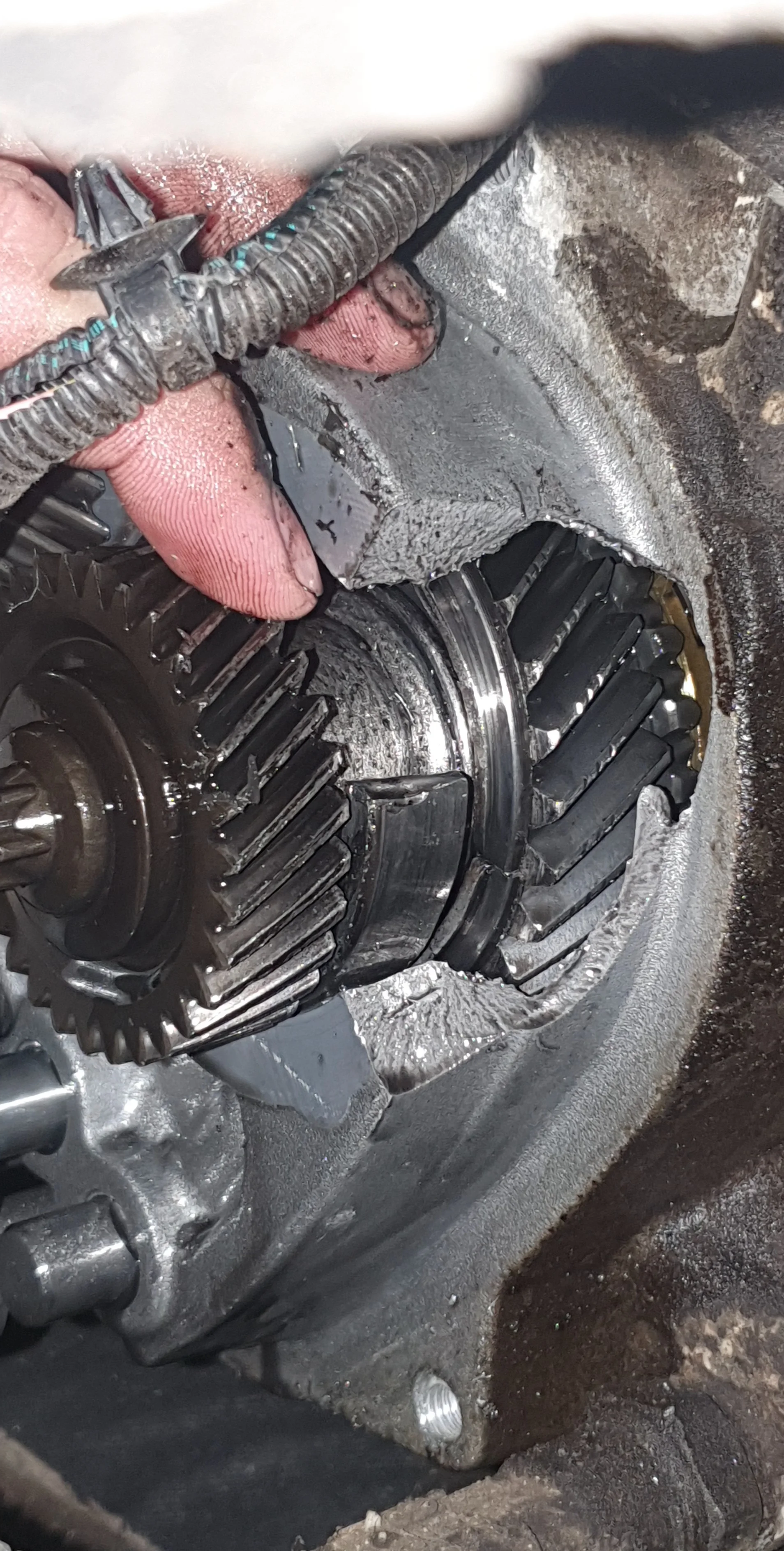

  Renault Clio IV 1.5d
Well there it is 😬
