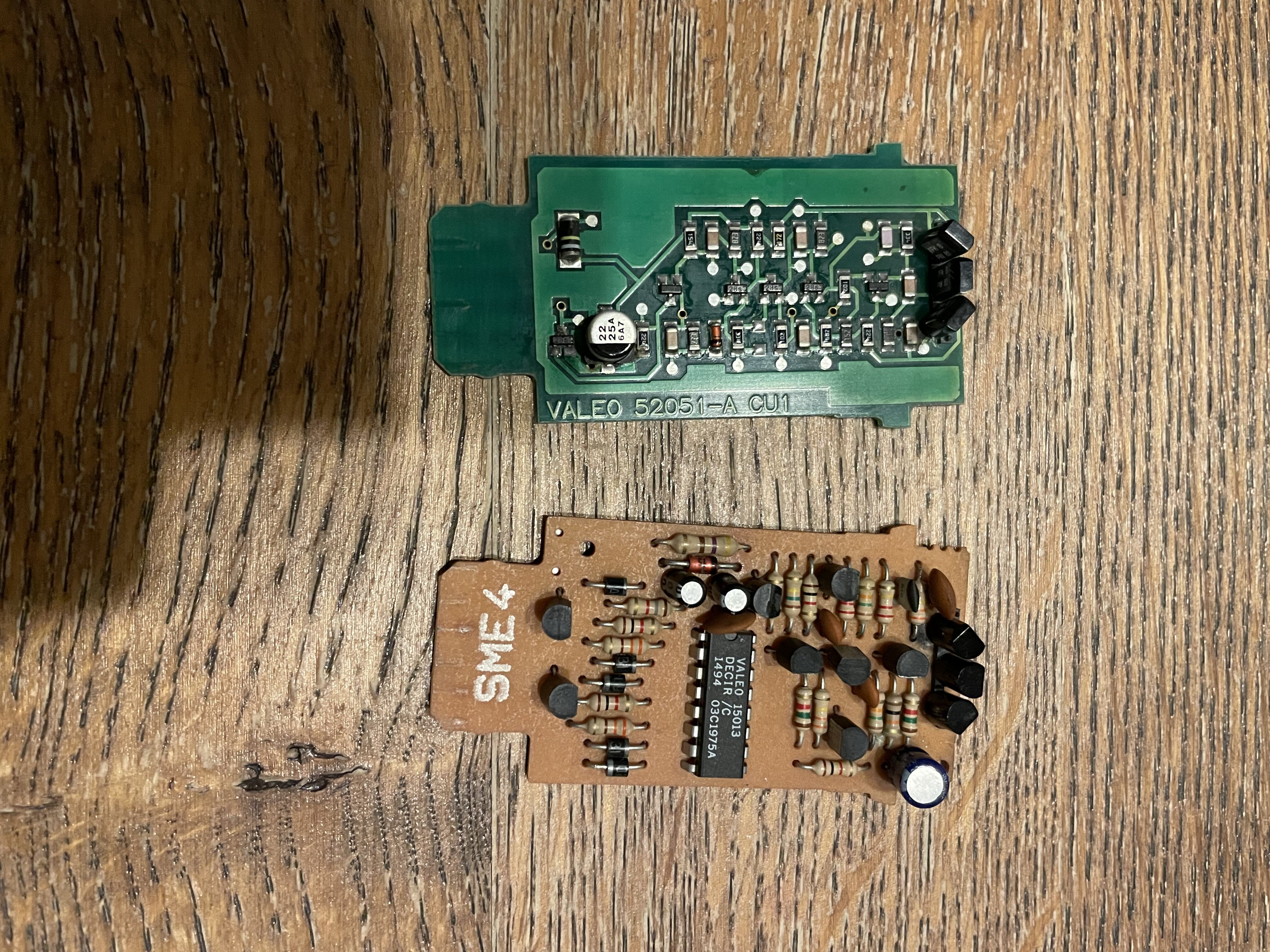

I took a gamble and bought one off eBay without thinking to much about it, now I have received it I realise i have a far more sophisticated board (green is mine and brown is an earlier version).

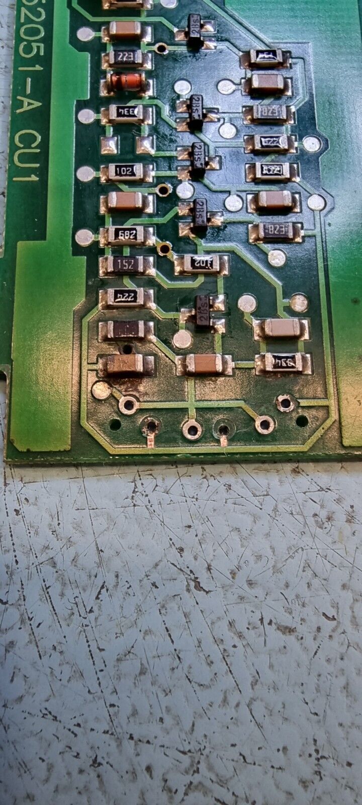

Terrific, I’m going to get the board re soldered by a specialist if that doesn’t work I’ll let you know Brigsy

The problem was the car had been sitting with a leaky sunroof so I guess it corroded the board

I think the brown ones might be r19? I just had a look at my spare ones. One was green and one was brown but with slightly different ir cover to the clio one

I was looking at some French forums regarding these modules and the early boards went in various cars, it seems like even the early ones couldn’t be swapped out without the correct fob as the ir frequencies where different to stop you unlocking an entire row of Renaults in a French supermarket car park. They work in the same way all you’re seeing is a more modern set of capacitors. I believe the ir sensor then sends a message to the car’s onboard computer but I’m not sure really whats going on, there must be more too it then simply seeing a basic ir signal from a key fob and then unlocking everything surely.

I`ve had a mid repair photo come back from the PCB repair guy, it looks as though over time the contacts on the board themselves have dissolved.
