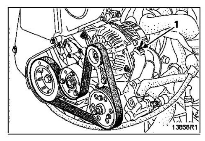

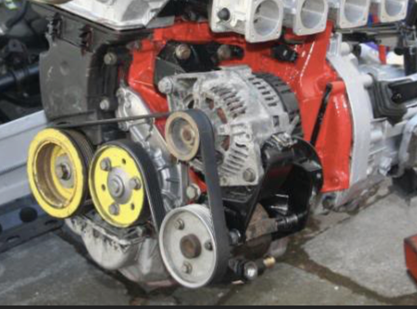

I have a Mk2 Clio phase 2 172 and have removed my AC pipes, compressor, and condenser, and bought a 172 radiator and Clio cup Alternator to fit on my car.
I noticed the power steering pump will have to be moved and remounted somewhere else? so the Cup alternator can be with the cup brackets.
So I have a few questions.
Where is the power steering pump fitted when you have the Clio cup alternator set up?
And can you use a standard Clio 172 radiator with the Cup set up?
Any pics or advice would be very helpful
Mr Underhill
The power steering pump sits lower. See illustration. You need to bend the pipe in order to fit so go very carefully as you can snap them. A standard 172 cup radiator will fit.
