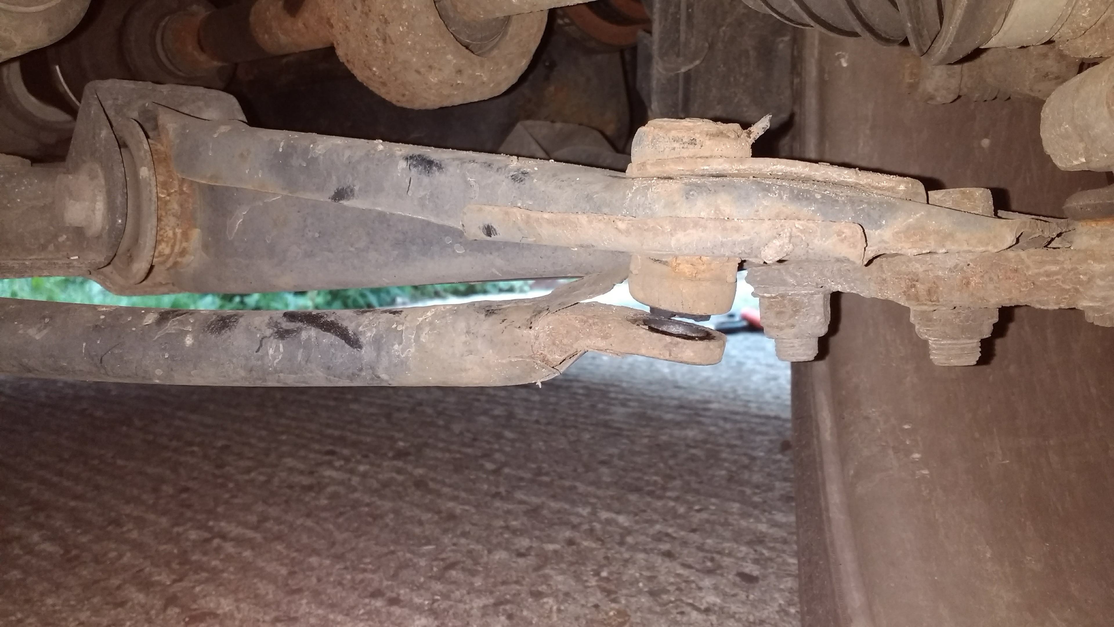

Clio Mk2 MOT failure for link arm broken... what part do I need? Photo attached.
Car  2004 Clio MkII

Outer anti roll bar bush mate. Currently sitting at £14.82 a pair of Lemforder's from ECP with their latest discount code. Euro Car Parts number 614745055. or theres the cheaper starline ones under 614745059, its your choice
Less magically, Starline, what I don't want is a bolt that doesn't come with a nut, doesn't warn you it doesn't come with a nut, and doesn't tell you what nut you need.
M8 nyloc, for any Googlers out there.
Job done, don't know about over-tightness though. Just seemed to keep going and going.
