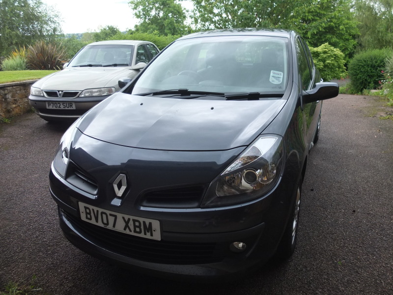

I know this, as I changed all mine this weekend. I find it much easier to take the bumper off and do the lights that way. My hands won't fit down the back of the lights at all.
Here's a pic of mine:
