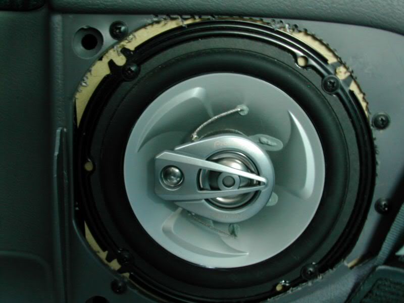

Well its 13cm standard size and needs a lot of chopping to fit 6.5 inch speakers but it can be done. I know this cos Ive done it!
not the best pic of it ever but hey ho
cool, did yu take the whole 1/4 panel off and mount a mdf ring from the back ? how difficult is it to do that ??
that plastic is so flexy........has the mdf stifened it up ??
Yeah had to take the panel off and then cut a lot of plastic away. Its more than just a mdf ring, it goes off to the side as well so that its held in better.
