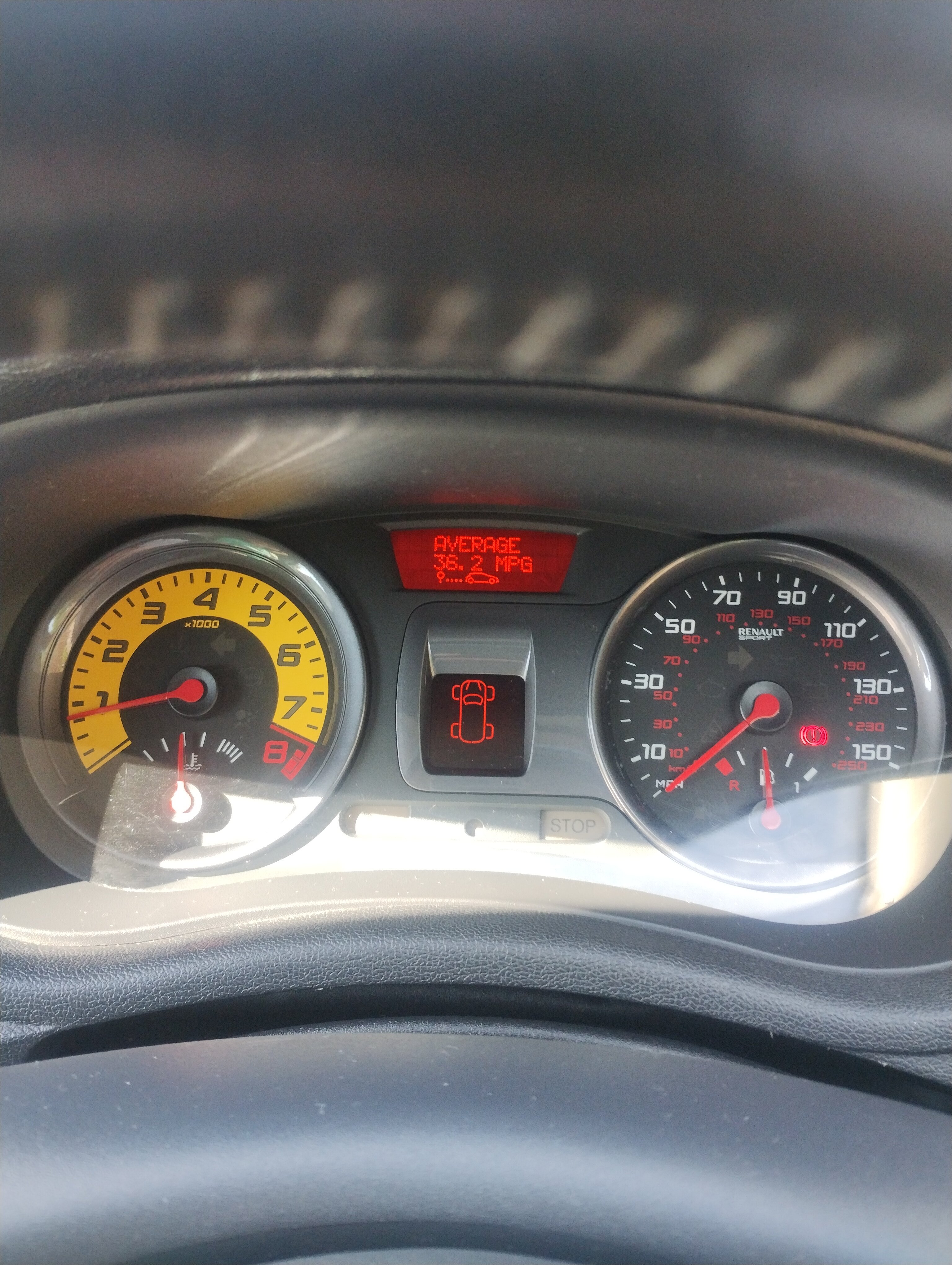

Hello again, had my cup 200 couple of weeks now and haven't had much time to drive it, so went for a good run out this evening got it warmed up and opened it up, the change up lamp illuminated,the beep came on but the car limiter stepped in @7000 rpm? Redline obviously 7500 rpm, Ive heard that a new coolant thermostat can cure this problem?. Appreciate any good advice, cheers

The standard rev limit is not at 7500….
It must be 7500 as why would the Rev counter show it to be

Yes, standard rev limit is 7500rpm, if it's coming in at 7000rpm and you have been driving for 30 mins or so then your correct, thermostat likely requires replacement.
I'd fit a genuine one as the last couple of gates ones I've had have failed prematurely by actually breaking up

Cheers matey, much appreciated, I was dead sure it was @7500 👍

Thermostat issues will bring the shift light on much lower than 7k

Mine was hitting the limiter at bang on 7k with a thermostat failure.
7250 was the 172/182 rev limiter, the 197 and 200 are 7500, they don't hit peak power to 7250rpm according to the specs from Renault.

So had chance to get the car fully warmed up, drove it 15 miles along some b roads , traffic cleared so gave it a boot full and straight to 7500 no bother, compared to my 182 I had this 200 cup is razor sharp in the way it drives upper Rev range....class
