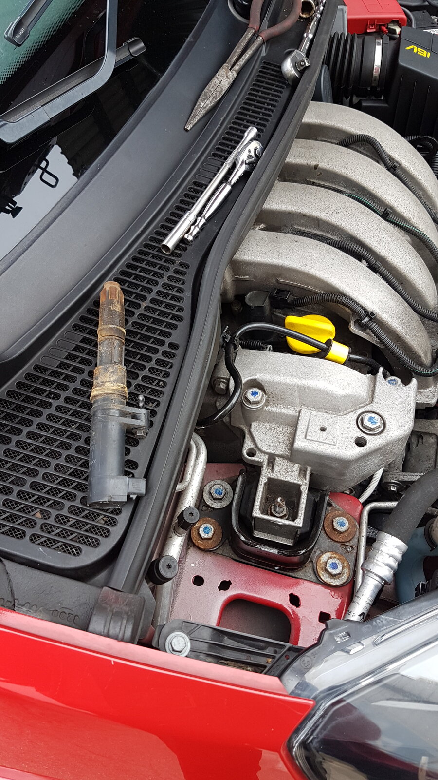

Pull them out with the engine running, one by one to see. If it's working ok the engine revs should drop/run rougher, if the coil is removed and no difference then that's your faulty coil. plus it might look like this
Jack1998
  Renault Clio 1.6 Rsi
Just pulled them one by one and the engine started to run rough each time, so I assume all are working well?

were any looking a bit ropey like mine was?
I had them out to do the plugs a few weeks ago and they were all very clean in fairness, I only pulled the cable out when I tested them tonight
