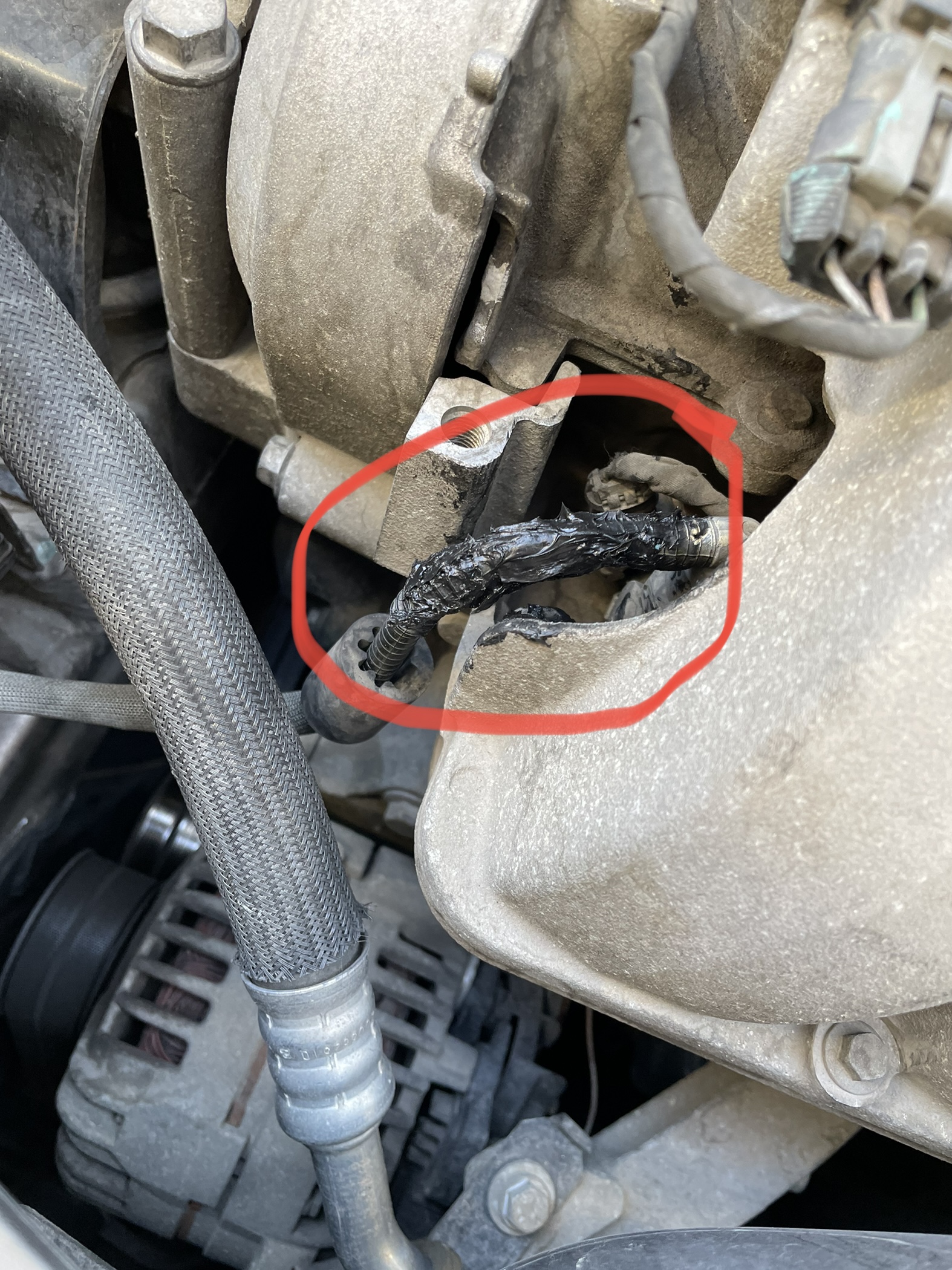

I have Renault clio sport(197) year:2009
My fuel pipe is in cracks and I just sealed it with silicone(see pic)
Anybody have the part number of this part(OEM)?

id get an aftermarket braided one. I've just changed mine due to corrosion on the steel part under the car (its all one pipe from under the drivers seat to the fuel rail) - it was the shittest job I've done in a while, I was 20 minutes away from taking the engine out lol it was about £120 from memory

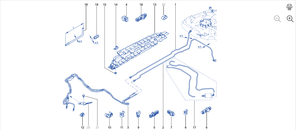

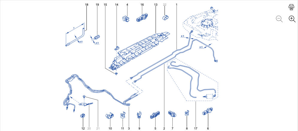

Part Number Is - 164467639R or 8200604131
Give it a google, Think the retail is around £160+Vat
