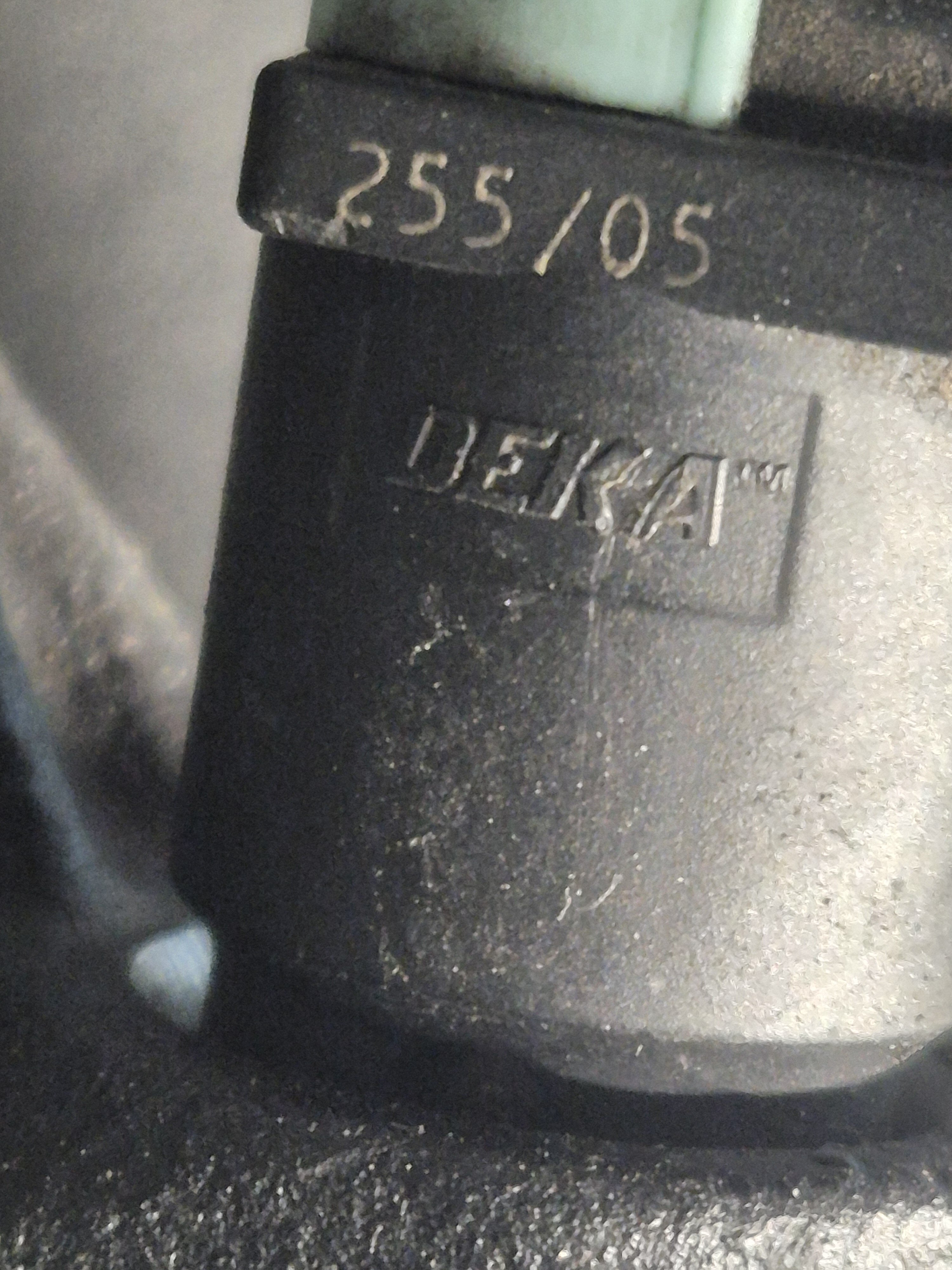

Does anyone know the part number from 197 injectors?
My jenvey bodies came with a jenvey fuel rail and apparently 197 injectors that have been flow tested. 2 of the injectors have 255/05 etched on them 2 have 235/05. Bit wary of running them if unknown and mismatched
Mertin
  Ph1 172&Ph2 172 Cup
Also to add, googling the numbers from them returns very little matches which made me wary
MAXRUNDOWN
Get them tested, even though previously done they might now be miles out.
This exactly. If they've been cleaned and flow tested then sat for ages they will need doing again as the Heptane used in flow testing can cause them to stick if you don't get petrol through them fairly soon afterwards
