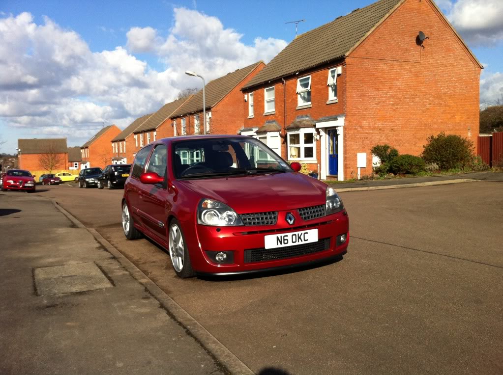

Looking to fit spacers on my ph1 172 an wanting to see what looks the best so get snapping chaps
Cheers
Re: Clio,s on spacers

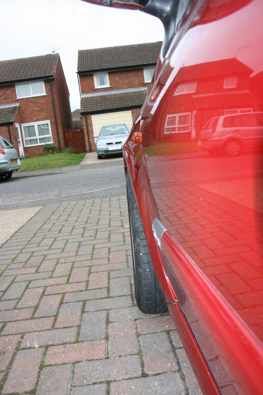

25mm front, 15mm is what im running. Sit perfect imo.
Obviously it changes due to wheel offset etc.
Pearce
  172 cup

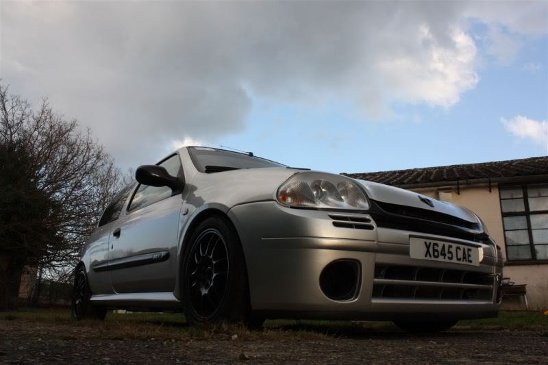

Looks nice mate think the front could come in a bit mind what's the offset your running

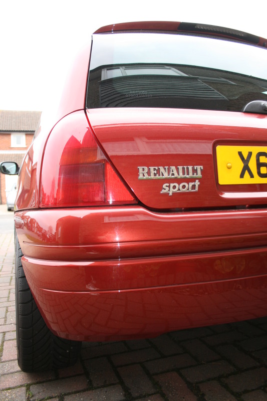

Danny, what 5mm spacers are you running on the back as I need to get some this week?

From memory 20mm hubcentrics at the front and 15mm at the rear. Also running extra camber front and back.
