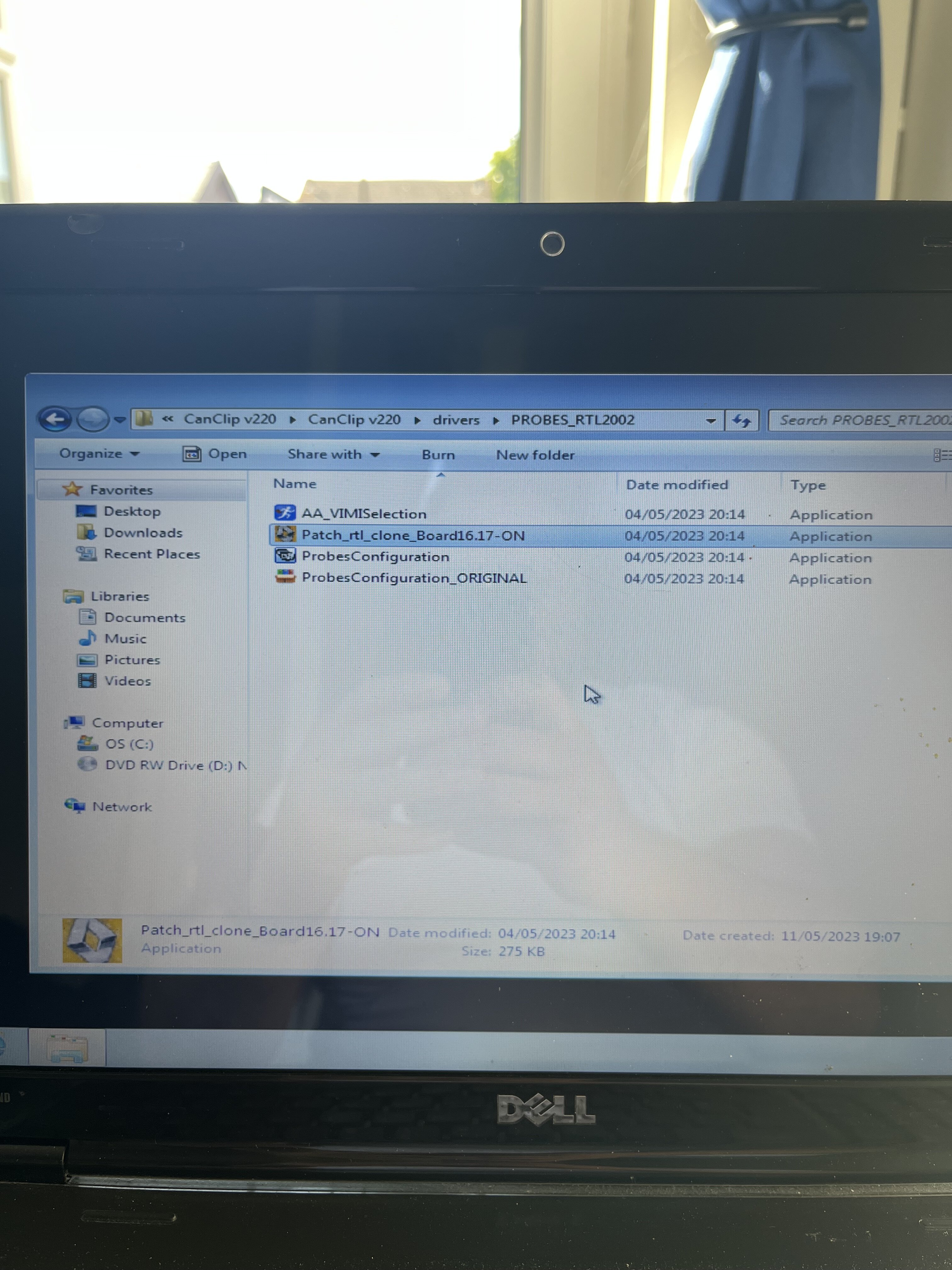

Not sure if I’m doing something wrong here. To start with 1 of the 4 drivers seems to be under password so unable to install
Highlighted one in question so if anyone has that patch_rtl_clone… I’d be grateful if someone could send me that please. I have contacted the seller who told me the password but it didn’t work and not waiting on another reply.

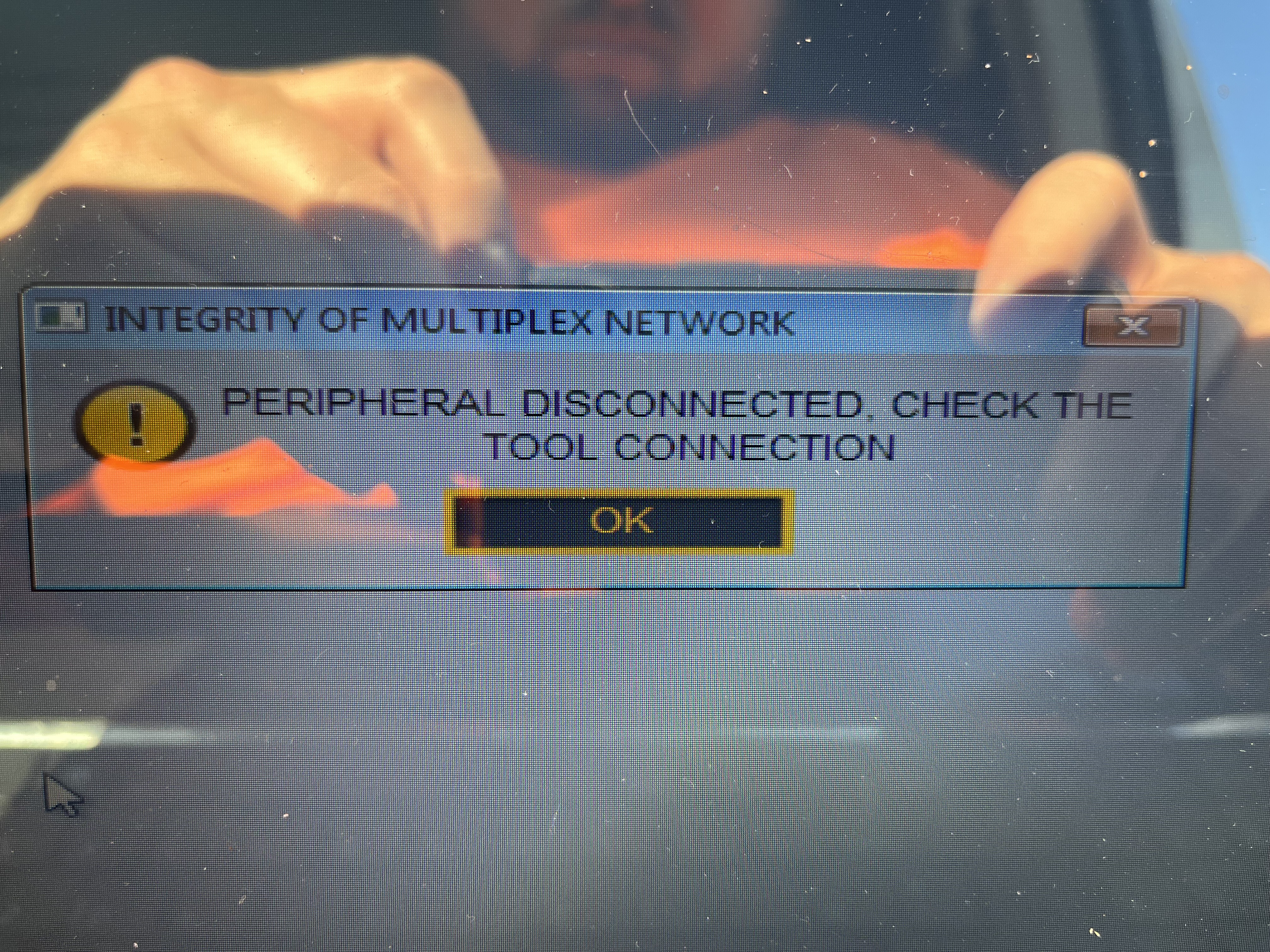

I can get it to communicate with the vehicle to an extent. Where it says RO I put the value of 0 in and it goes to the next screen completes 100% and then I get this message
Probably something to do with that one driver also non of the top buttons seem to highlight and work but the ones down the left do.

I haven’t. I got a new laptop which I need to get 32 bit windows on as it has 32 bit support for its drivers and a different version of Clip with all drivers.
You don't have to worry too much about that as you can run VMware which allows you to run a different windows within.
Example my diagnostic laptop is windows 10 64 bit, but for the clip edition I need for my 182 and my hardware. I run windows 7 32 bit. VM ware and the installation process is probably the more faffing side of getting clip working. However I did a test on both 64 bit and 32 bit in compatability mode and neither worked so it really has to be a separate install.
