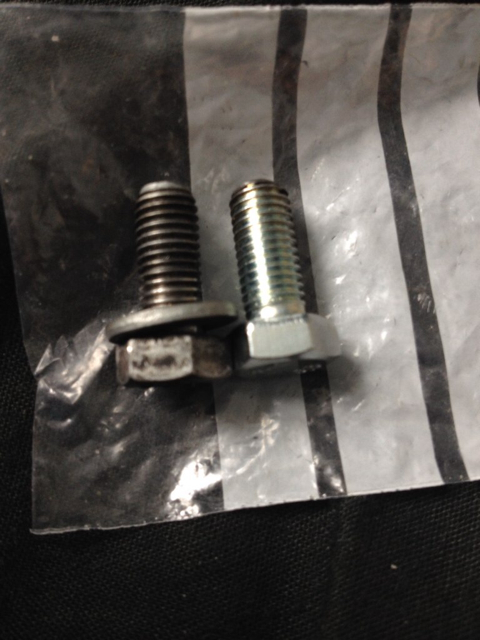

11mm head, with a washer. 20mm long at a guess. M6 thread also a guess. If you're local to Chertsey, I'll have a few knocking about.
cheers for the offer mate but i'm in south wales near cardiff, just measured it at 15mm long. 11mm head plus washer and m6 thread i think is right though.
Any local machine shop should have something that will do the trick.
hopefully getting one made for me on monday hopefully, i've also ordered one that is 25mm long so i'll just cut that one down now. What i did find is that m7 x 16mm is commonly used on a vespa bike. Hopefully all will be sorted soon!
They are M7 not M6. Renault seem to use a lot of M7 bolts for some reason.
Yep you're right, m7x16mm. Uncle sorted me out with one last night
