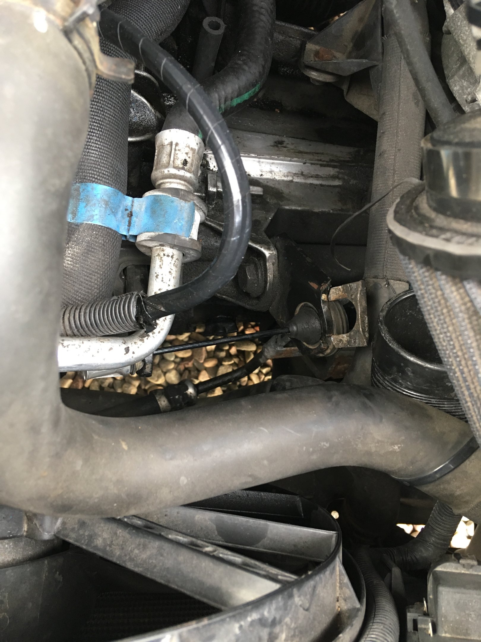

Clutch- has double washers on the cable, really heavy low biting point. Reverse gear crunch an not getting second gear. (Can find 2nd gear when engine off, mechanic says defo a clutch.?

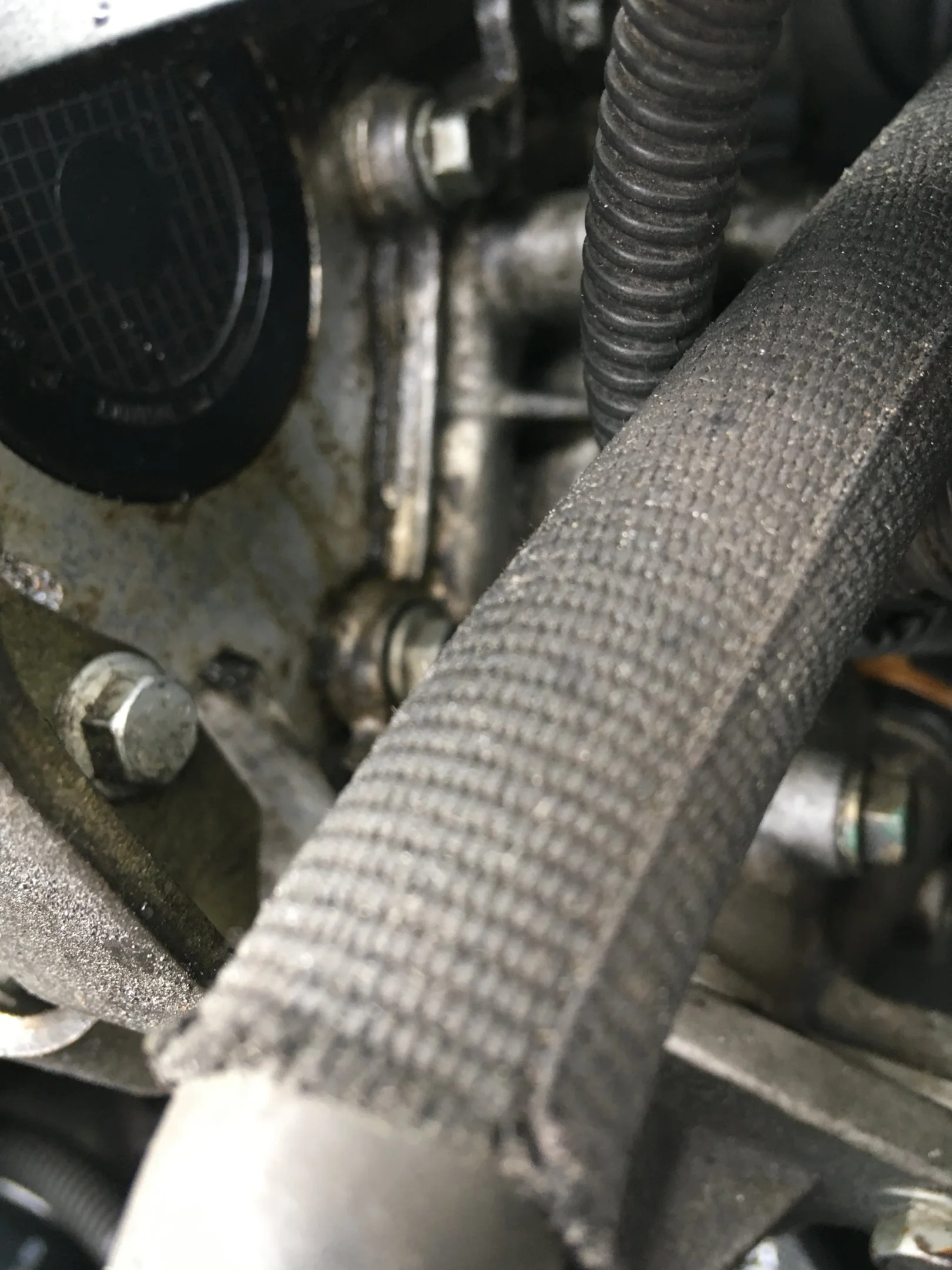

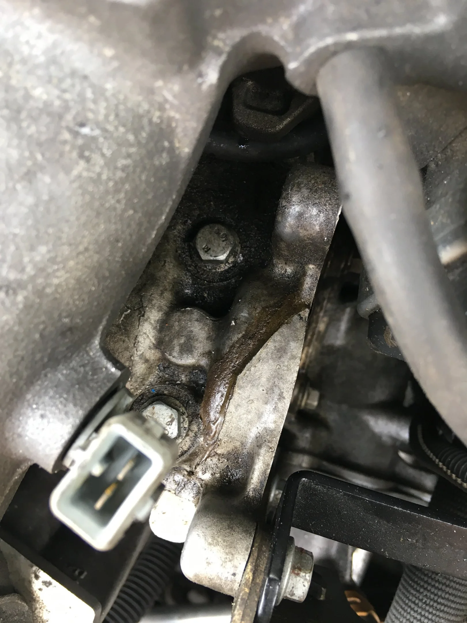

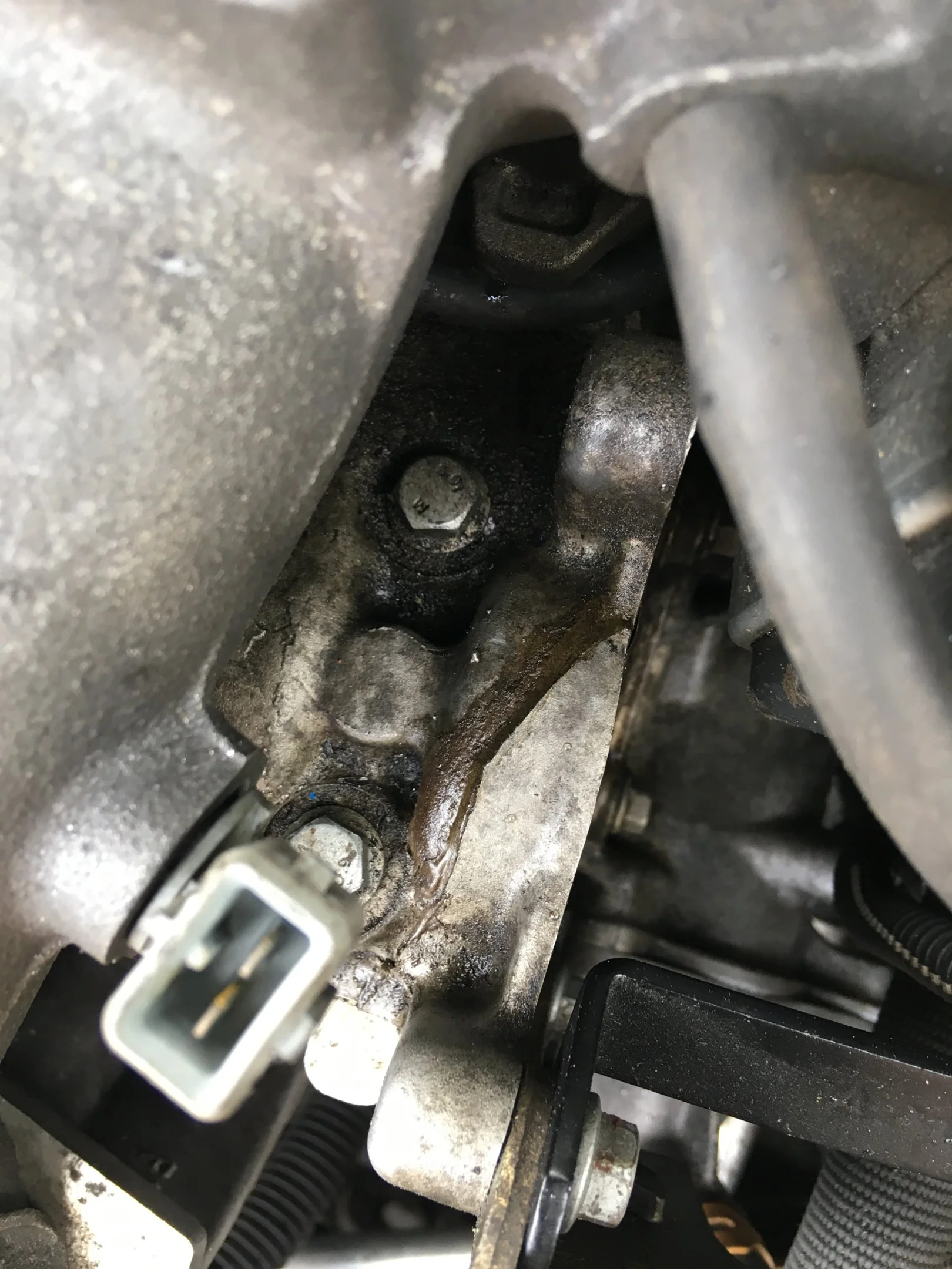

Gonna have a day tomorrow cleaning a fluid/oil leak mess, to pinpoint where it’s from.
The steering fluid tank looks milky, mechanic says it’s proberly an additive to seal the system, can any1 point me in where to check along the rack and steering gear for common leak points.
Cleaned off the thermostat housing and down front of engine and clutch side so can check again if any new fluid seeping from there so will do the same with steering rack and rear of engine.

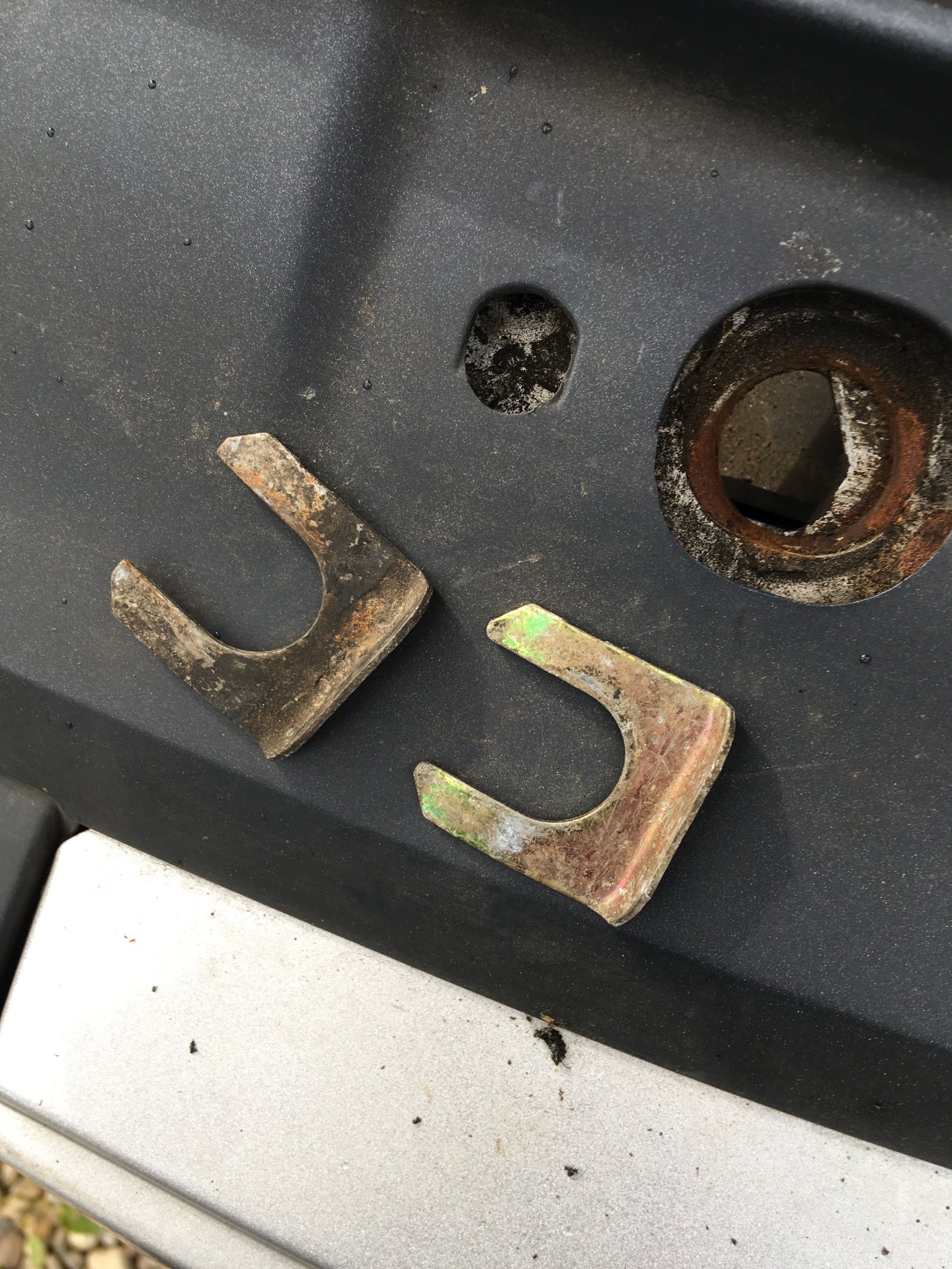

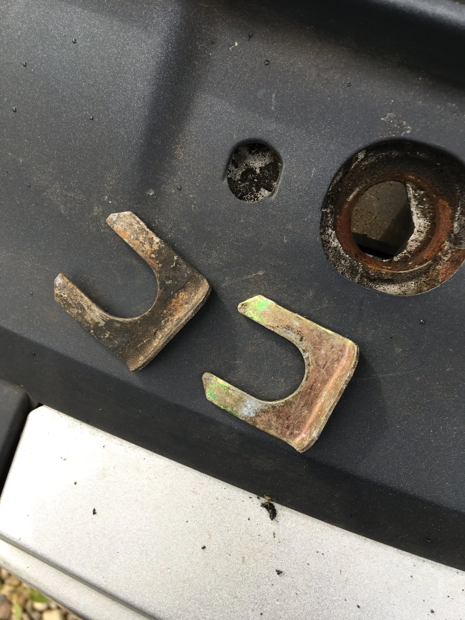

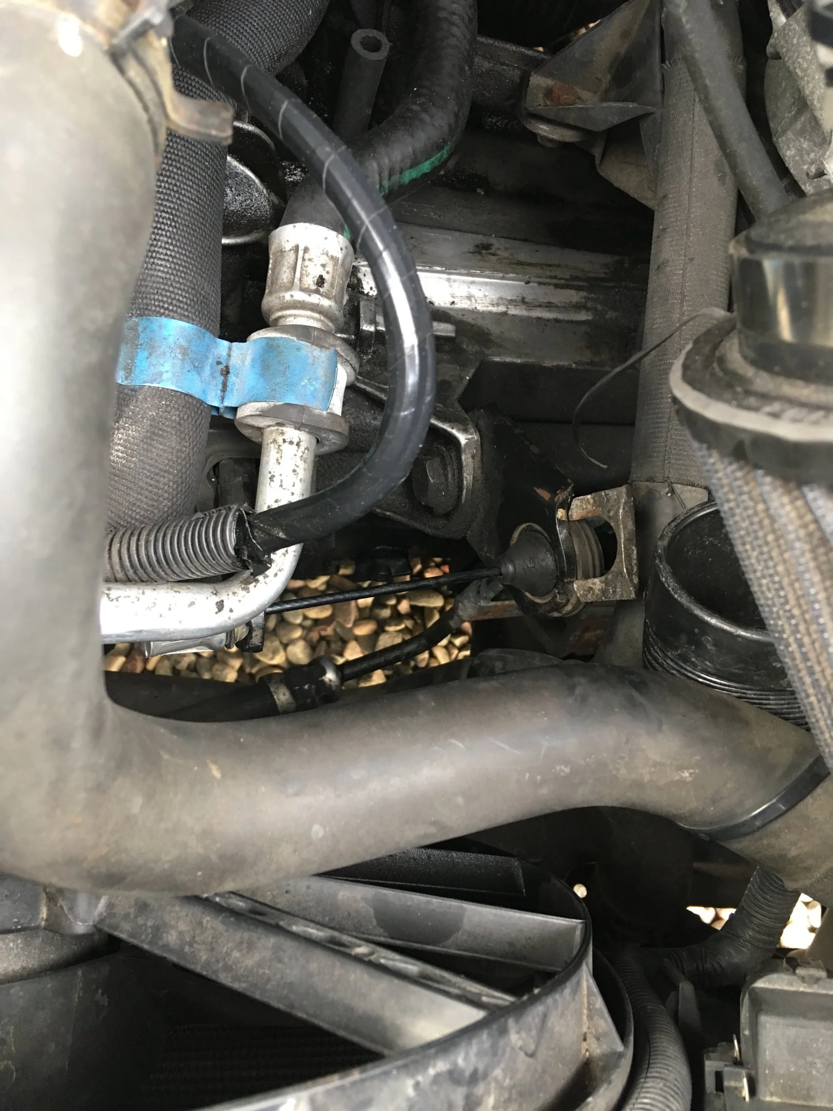

With spacers on the clutch cable it sounds like somebody has tried to get a bit more life out of a worn out clutch and hide high biting point. If previous owner has been ramming it into gear i would exepct gearbox to have syncro damage. Order a valeo from gsf cheap as chips with discount and stick it in see if its ok.
Where are the spacers, are they on the end of the clutch cable by the gearbox? If so surely that would cause a higher biting point because you’re reducing pedal travel by effectively shortening the cable ?.
Good point it might make bite higher - depends on what the self adjusting cable does. I reckon they were trying to get more leverage on the clutch arm
Yeah gearbox side.. maybe putting them back in will reduce how stiff the clutch is. Till new clutch fitted.

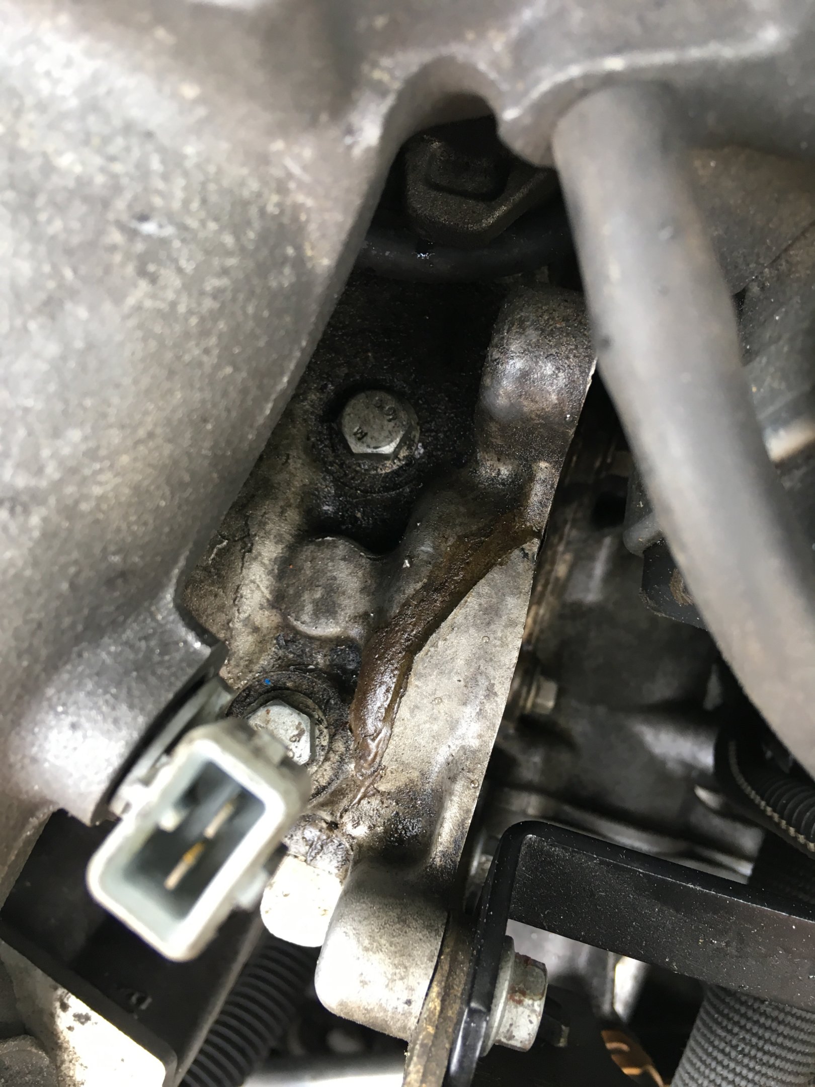

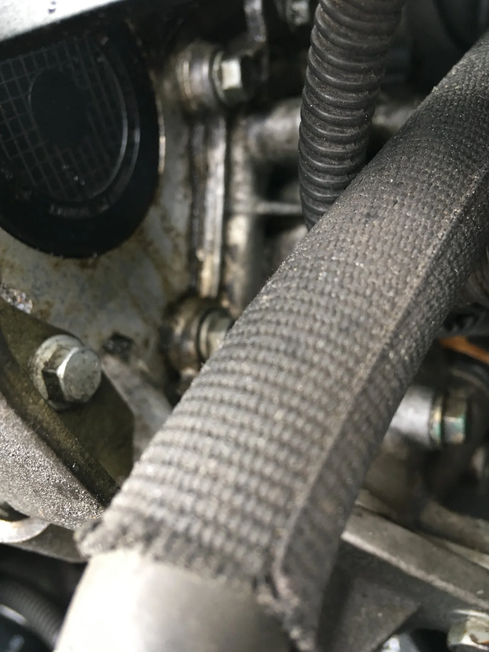

Rocker cover crack and repair..
Cam covers or thermostat gasket oil leak/ slight seeping
I doubt it’ll change the stiffness. That’ll be the springs/fingers in the clutch plate weakening over the years, I would imagine.
Just a little update, fitted the two u-washers to gearbox side where they originally where
and 24 hours later the misses has just phoned and iv got second gear working and driving, self adjusting clutch cable?

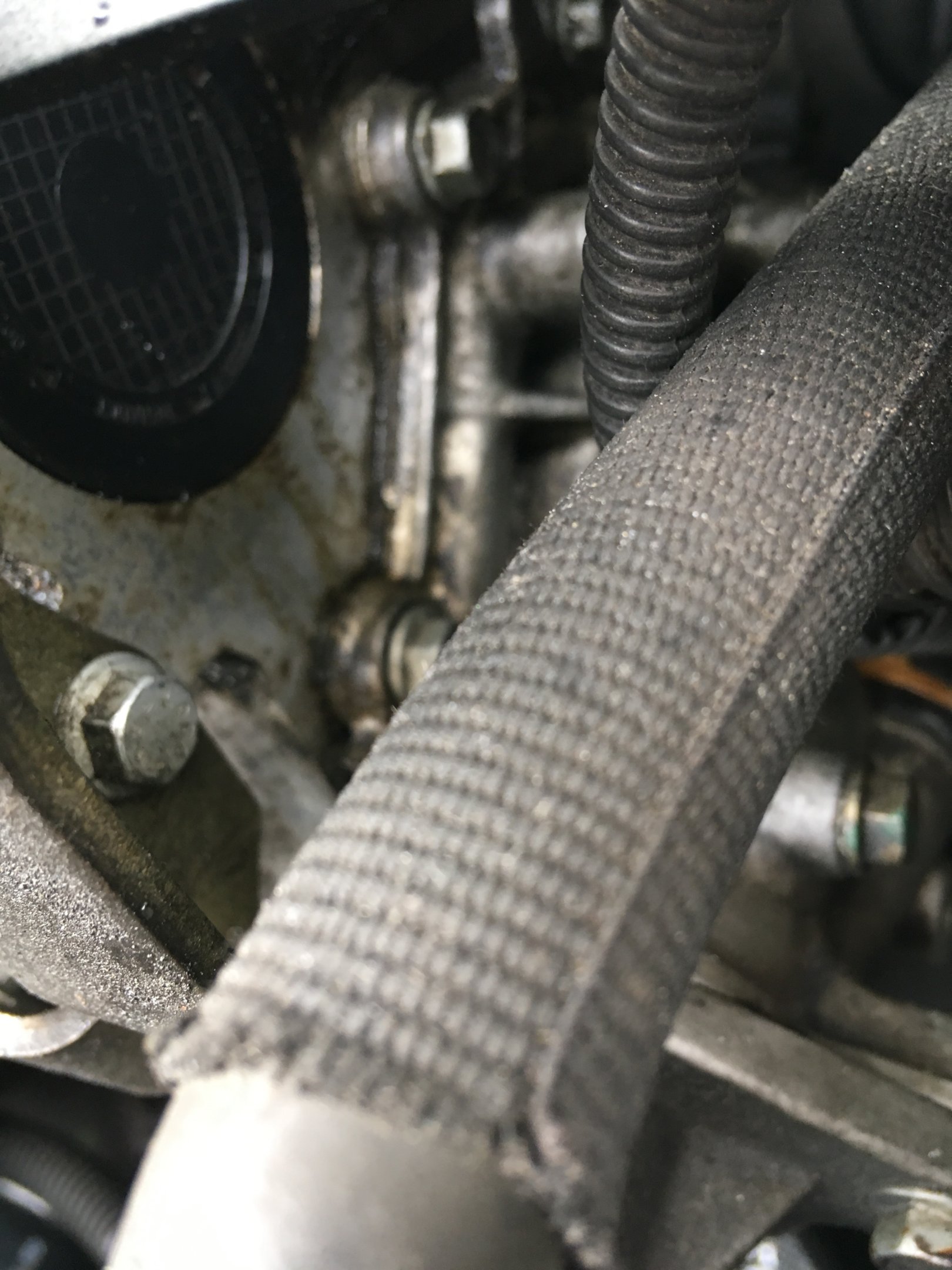

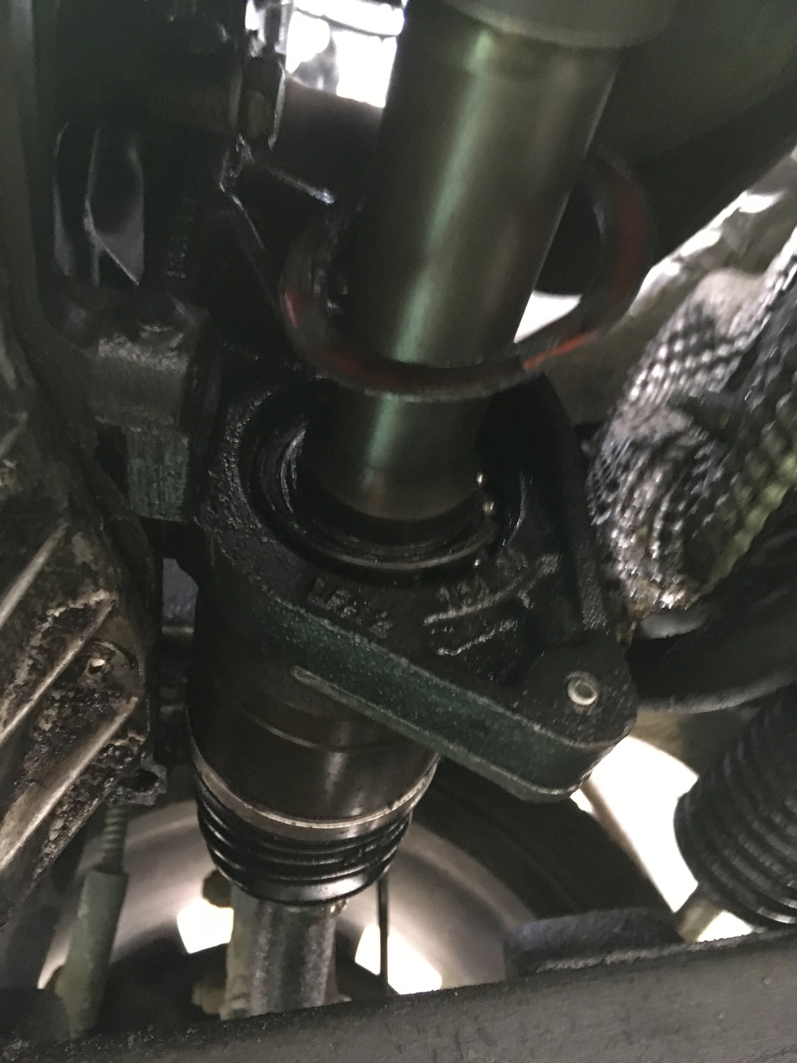

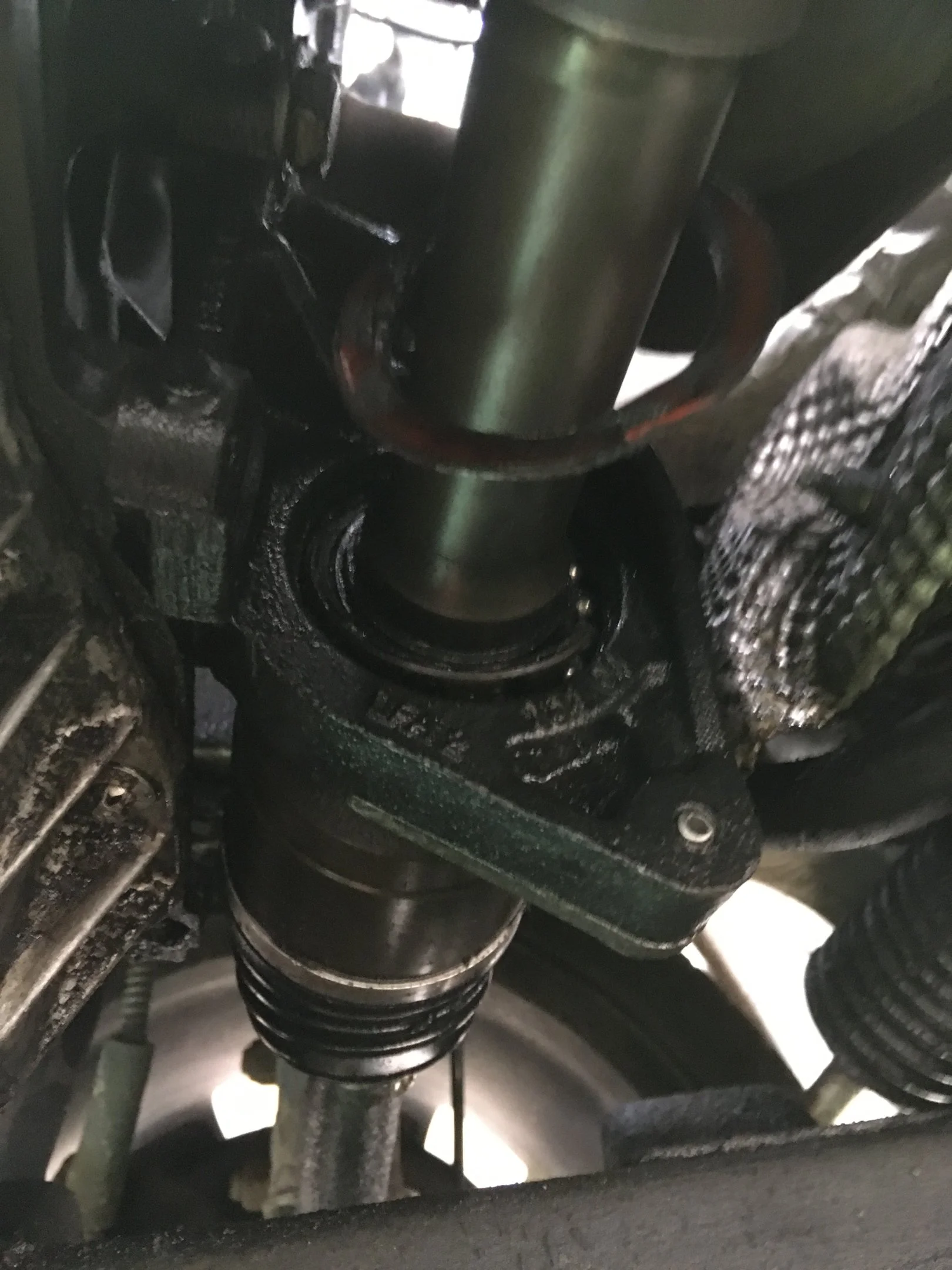

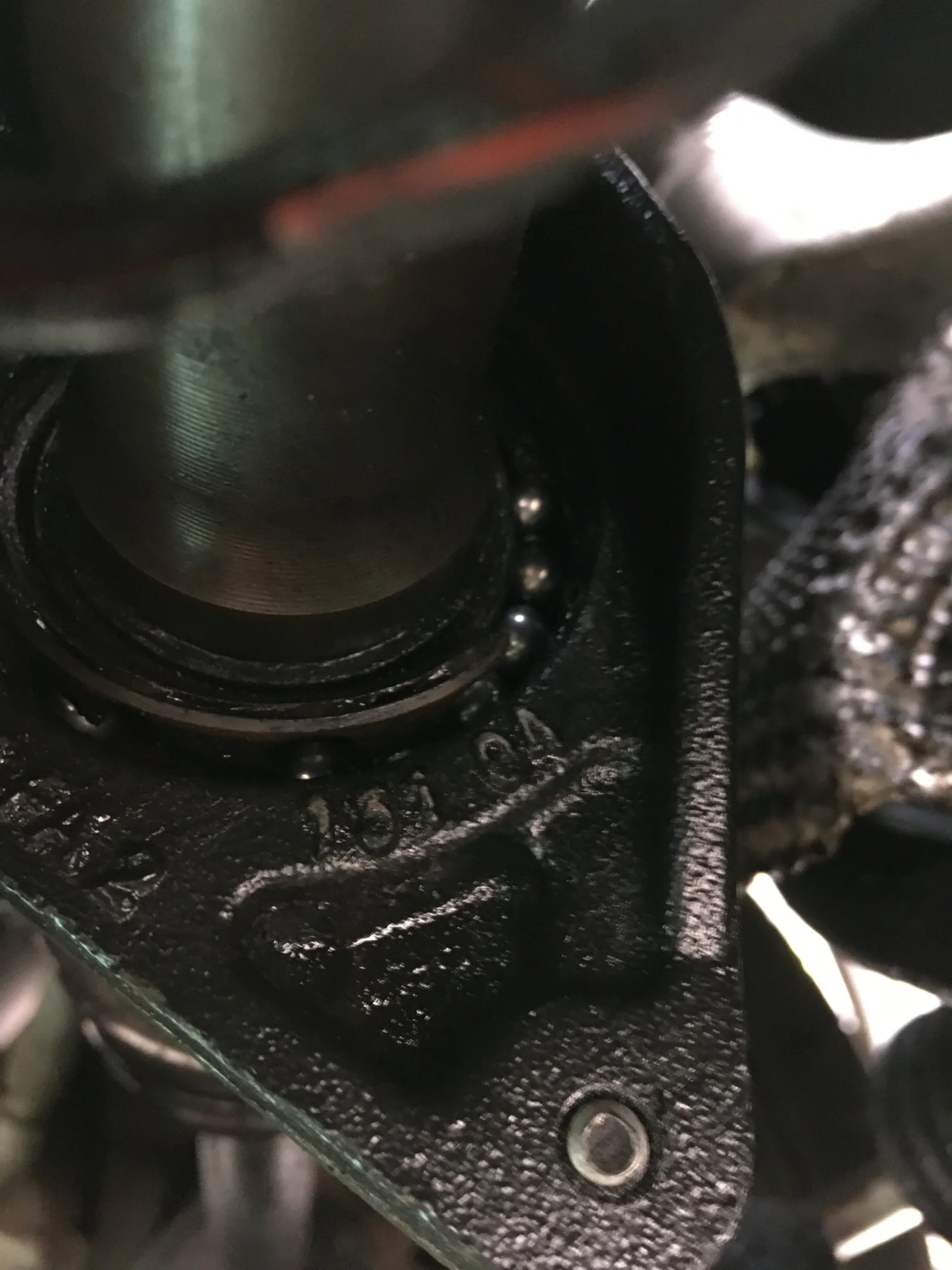

How safe is this driveshaft? :’(
Yeah inner boot two seals have gone, needing to get clutch changed so will get shafts as well.

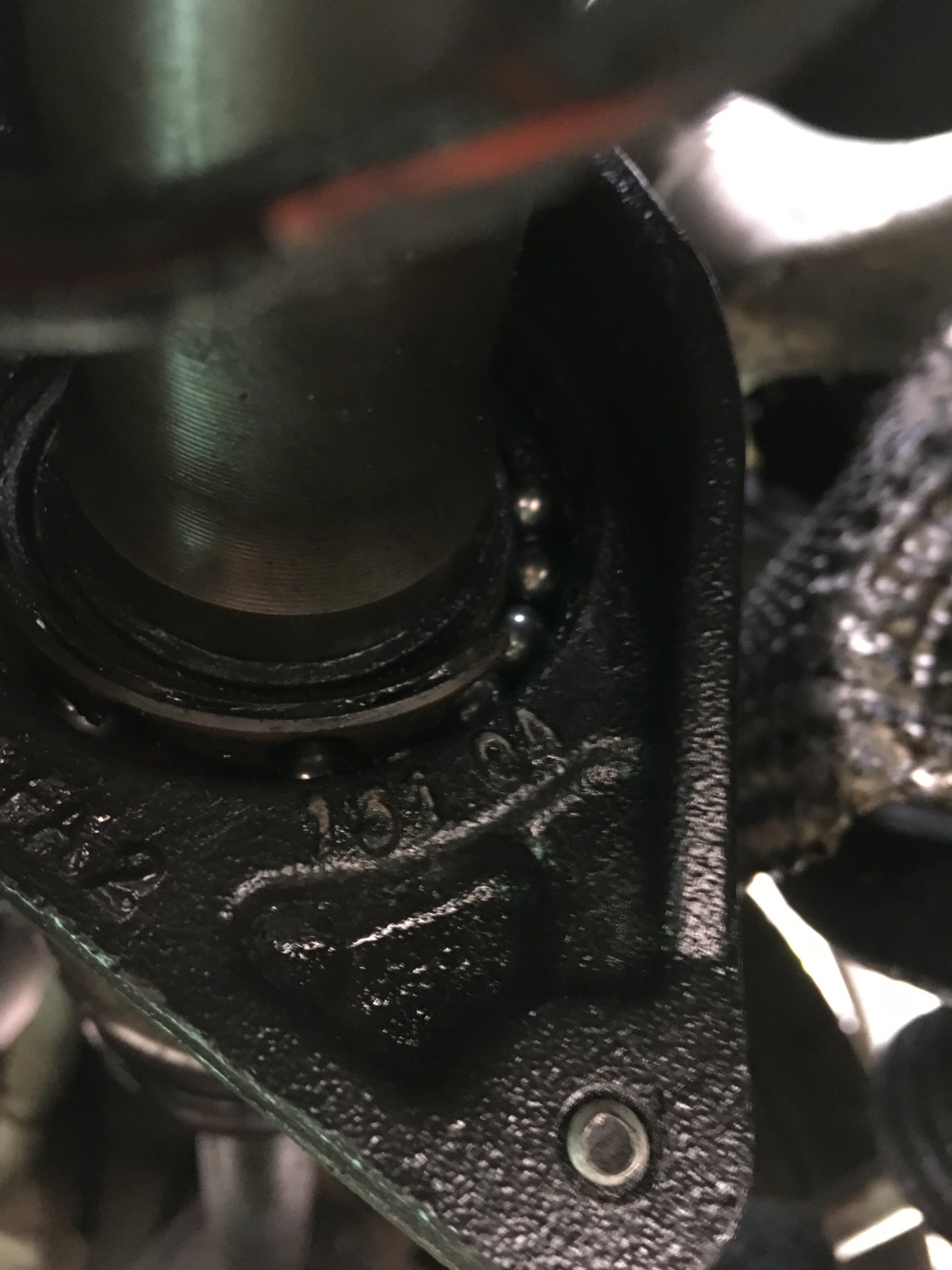

Is a new cam seal on the box side changeable, just the one?
Rocker cover corner has been repaired can see the sealant, would I get sealant and cam seal and remove old seal to investigate the cover and the seal? Oil is going down side of the block to the stat and box/clutch and to the rear to the mount

Try a new seal and sealant it might work for a bit, i think you will have to live with that oil leak unless you get the cam cover welded or replace the head though.
