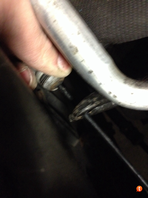

I can pull my clutch cable this much (see pic) with ease
But if I get someone to push the clutch in I can then put a bar in there and push the arm all the way over I can then also hear the ratchet clicking and takes up the slack. If I do this though it selects every gear fine but when i push the clutch in it makes a noise at low ish revs. It's got a new valeo clutch and release bearing was working fine for 200+ miles then all of a sudden I lost all gears when I pressed the clutch. New clutch cable to try next from Renault?
