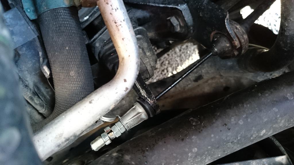

Found this interesting bodge today after removing the ripspeed air filter that had been fitted by the pervious owner....... I don't think it should be like this!
Is that a clutch cable or sea fishing line with weights on it

I was thinking about taking a nut or two off and seeing what happens, with them all on there is a small amount of tension on the release fork. Will give it a go and if nothing start with a new cable.
