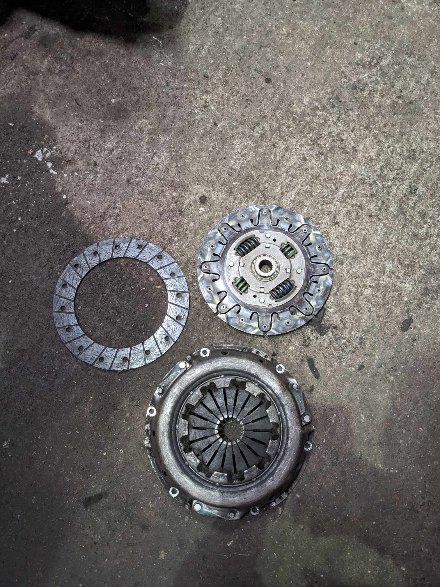

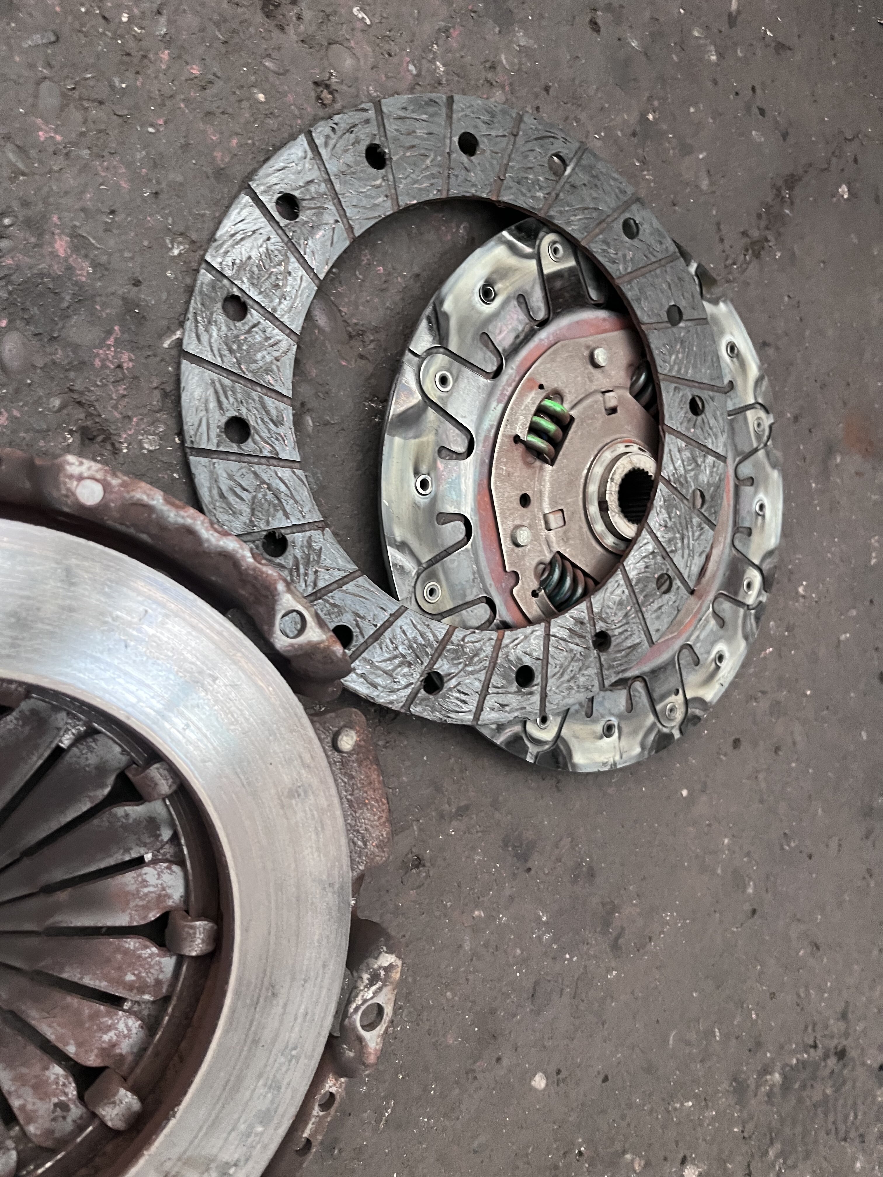

At a track day in my Clio 182, noticed a weird “whiring” noise on engaging gears from a standstill and from low speed 1-2nd. Also, you can smell the clutch burning initially before the car picks up revs.
When it’s rolling it goes away completely and the car drives totally normal. Any ideas?
Just fitted a new gearbox with a gripper dif- all worked perfect. Clutch has done around 4-5000 miles and still seems to have plenty of bite.

Thanks- goes away once clutch is engaged- doesn’t really change, just occurs when under load - when pulling off.
Just trying to find out what I need to order and if I need to drop the box

Mine did this just before the clutch gave in,
can hear it at 3min 37sec in the vid below.
Neil Clio 182
  Audi TT RS Clio 182
Let’s hope so then. Will get one on order. Getting bored of dropping the box out 😂
Well thats gone :p one half of the clutch came off the other is dust in the box :p
