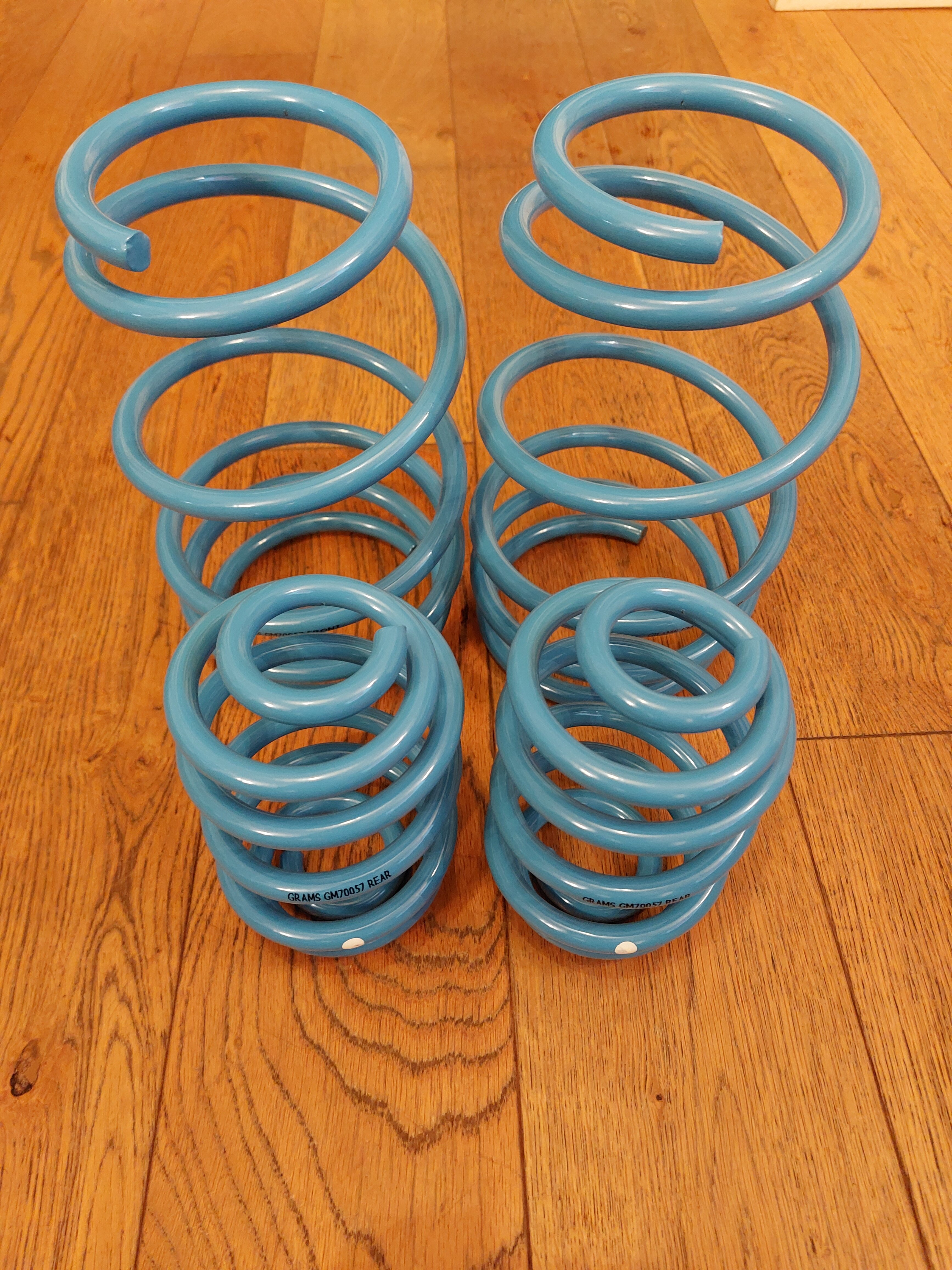

Cant comment on said question but I had another 182 with grams sport springs, standard everything else apart from some refresh here and there. Compared to my ast coilover, strengthened adjustable wishbone 182 it was honestly great, very surprising how little roll it had and it was quite comfortable. Could push much harder than I thought would of have been possible.

Grams springs with new cup campers, 16mm front spacers 10mm rear.

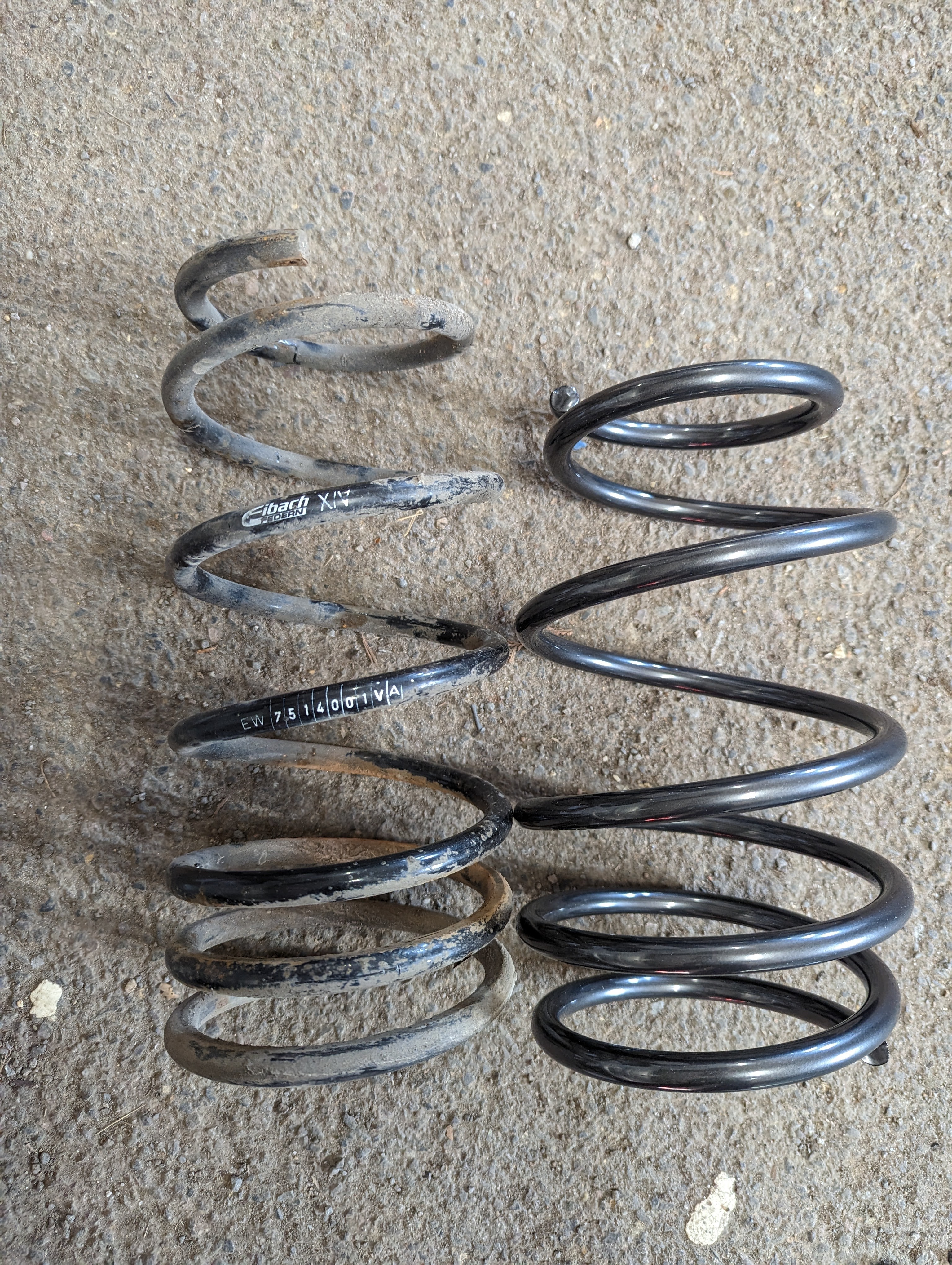

The Eibachs still crash occasionally compared to the original springs, which I had on my Black Gold car. To be honest you only have to fit the wrong tyres and the ride goes to s**t.
I had AD08Rs fitted once and it tried to throw me off the road. The tramlining was awful. Since running PS3 195/45/16 or even 195/50/15s, the car behaves itself. Renault really fine tuned everything on these cars.

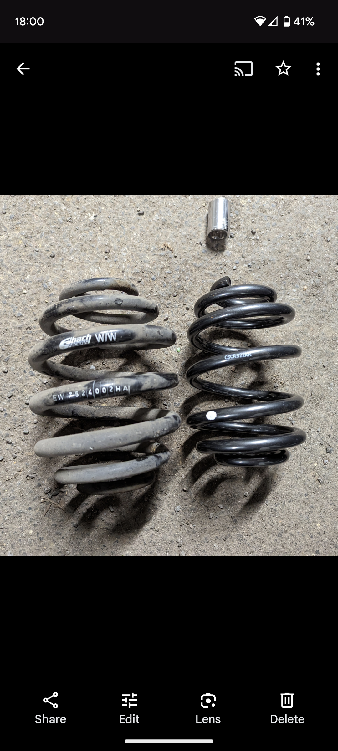

When I did a refresh I went for cooksport springs and (cup dampers) just because they were a touch cheaper than anything else.
Seem good, but I can bottom out with 4 people in the car now.
Previously had eibach sport which previous owner fitted.
