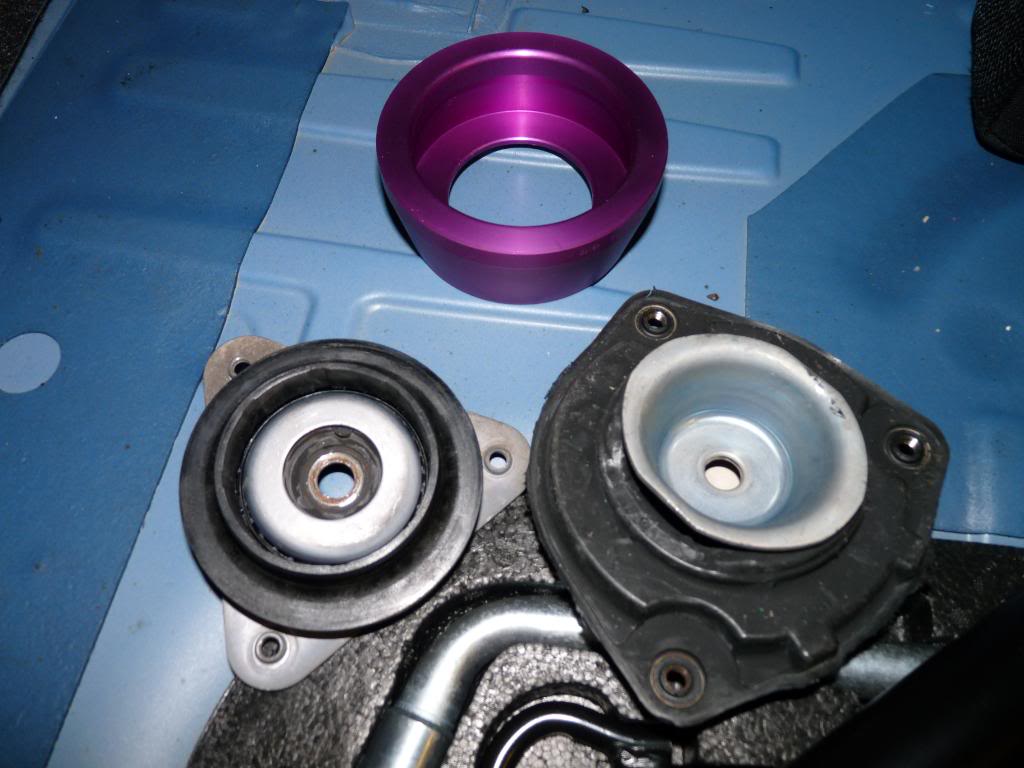

Anyone got a picture of the topmount differences between the 197/200?
Mines looked like this. Car was Dec 2010.
  Discounted 1*2 parts
Here is a pic of the differences in top mounts. The larger one on the right is the old style mount and the smaller on the left is the new style. The old mount fits snuggly in the purple coilover cup or H&R spring and gives a good solid fit.
The new style mount is far smaller and rattles around inside the cup. There is no way I'd trust this on my car as you're never going to be able to get the shock to fit perfectly. I know people have said to me 'just make it look central and tighten it!!' but its only going to take one bump to move the shock absobrer?

Mines didn't move after I stuck a washer on the damper rod. In fact when I took them back off after 4k, they hadn't moved in the cup at all, still perfectly central.
The reason you get play in it is because on the oem damper rod, the bit below the thread is thinner than the thread. On the KW's, the bit of metal below the thread is the same thickness of the thread. OEM - the nut goes down tight. KW - the nut cant tighten as it runs out of thread.
2 washers later and they didn't knock or move.
