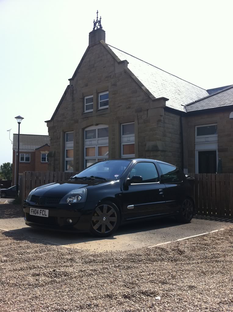

thus is how the car sits, its low but not stupid low;

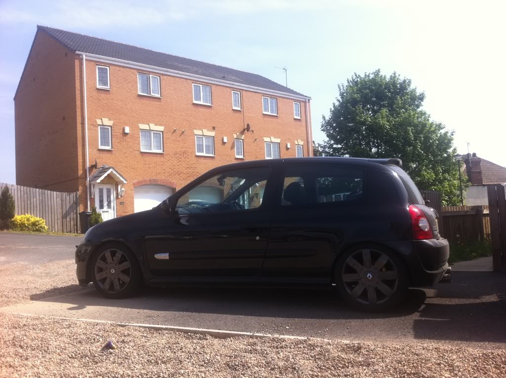

the car isnt even that low;

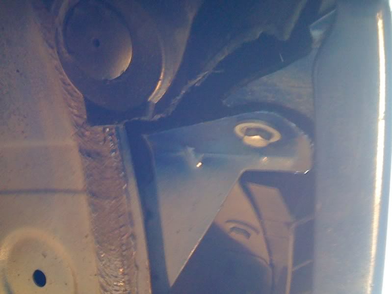

Ignore the plastic trimming. It's the metal bracket mine was rubbing on. The arch lining destroyed itself on the way to the Nurburgring. so I had to rip the remains off, that's why that's a mess.

lol, ok thanks for your help mate. ill cut some of the plastic away and bend the bracket up abit like you have done.

I haven't done any bending. I trimmed it. Some bend it bu I found trimming it was easier as it means it still connects to the front bumper easily.
