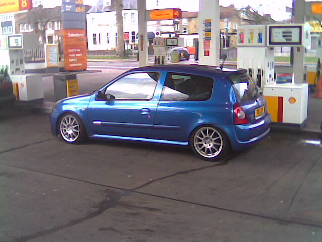

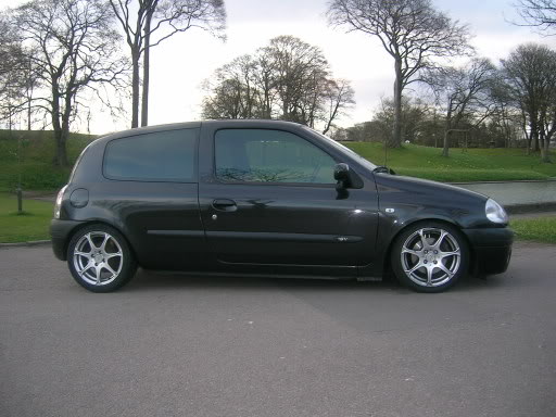

Dansta's cup on H&R's, run's it at that height all the time now get your hand in your wallet son ;)
All the way down at the back and until you need to start f**king about with bumper brackets at the front due to rubbing like mad (around 60mm at a guess) and yes it does handle better. I had a set of H&R's on my 172 and now have another set on the 182.
cup_66 said:
That last pic down looks lovely!youve got me in two minds now!so going that low wont comprimise the handeling?
Handling no, practicality... lets just say Dansta's splitters dont last too long, lol.
