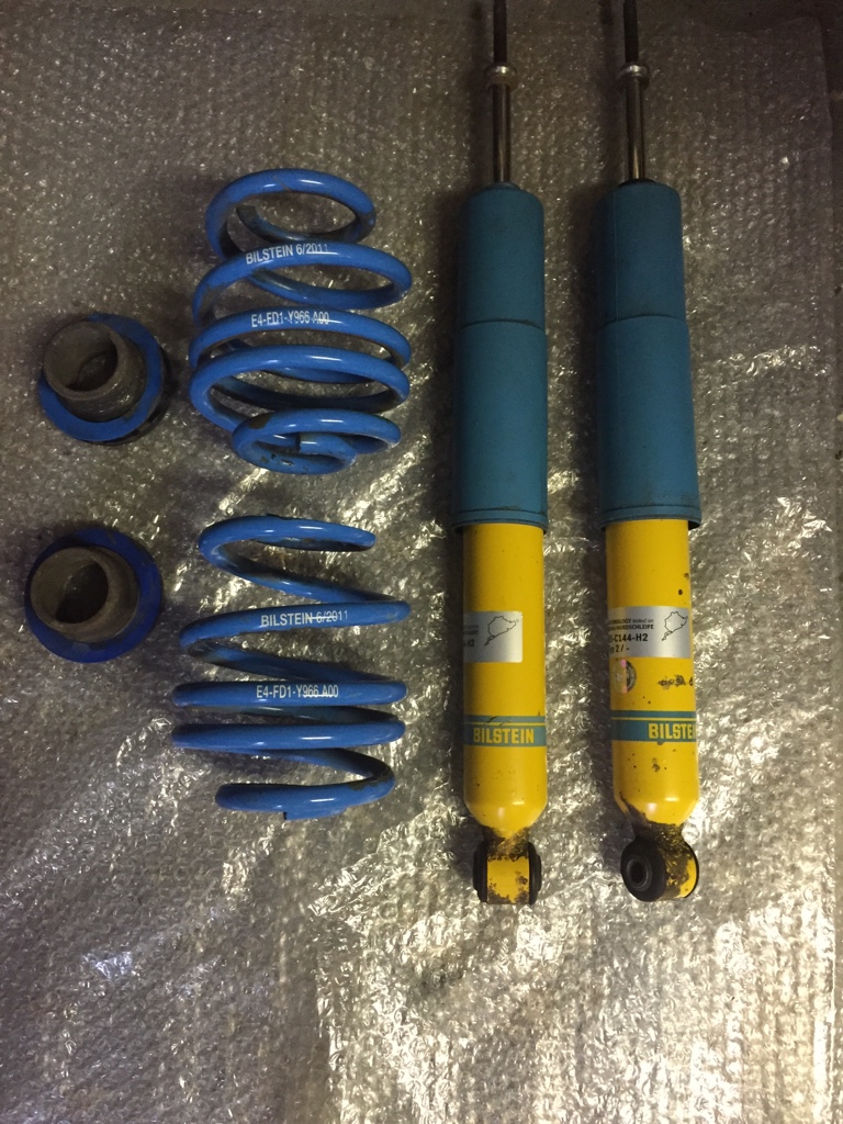

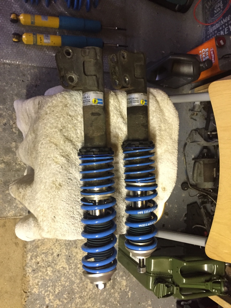

Having said that, I need to some advice please. I have put some AST's on the clio, and removed my old bilsteins. The Bilsteins are caked in road "crud" and i'd like to clean them up all shiney new before I sell them on. What products are best, and is use of a jetwash recommended or not recommended?
I'd also like to keep the ASTs clean, so any recommendations on what to use periodically on those when I clean the car in general. Fanks.

Get yourself some Autosmart G101, it's a multi-purpose degreaser. That'll clean them up nicely.
To protect the AST's, something like GT85 spray will do the job.
As James has said to be honest, Oli. G101 with a foaming head/sprayer will help coupled with a soft detailing brush. This will remove all road grime. There will be iron and tax contaminants but I'd be careful using removers on something like coil overs. See where you stand once you've used G101.

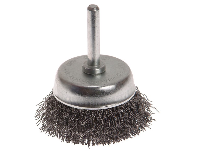

For the billies, you need one of these for the threads:
