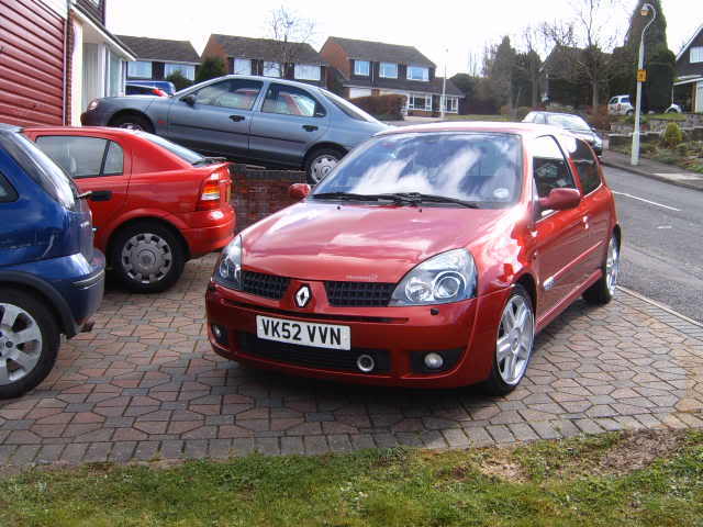

long way round by the battery , across down the back of the light fitting and around to the lower grill
  '02 172 Cup
is this where you mean?
i am gonna spray it black i think so you cant see it.....
i will take a few pics of the route if you like?

Thats exactly what i mean.
Not sure if i want to cut it in to the grill yet tho!
Any pics you have would be much appreciated.

I used a hacksaw blade. It was a clean cut. Do not recommend doing it though. I regretted it after a few months. Sitting behind the grill like the above pic will get just as much air in.

i used a stanley knife. dead easy. just took about 15 mins. only did it about 2-3 weeks ago.
the pipe wouldnt reach further accross the grill (ie past the filled in squares), so i simply cut through the thin "filled in squares" although i may be getting the wrong end of the skin massively if you guys both mean cutting right through the grill

As said above. I don’t recommend doing it as a new grill from Renault cost about £50 and I don’t believe it improves airflow compared to having it behind the grill. Its more a styling mod really. Looks cool but when you plan to sell the car on, most prefer the standard look and or trade peps will make a big issue out of it when valuing your p.x
And it looks better than this silly funnel coming out the grill, i think you'd get away with it on a big bhp jap turbo'd motor but not a N/A clio :S
