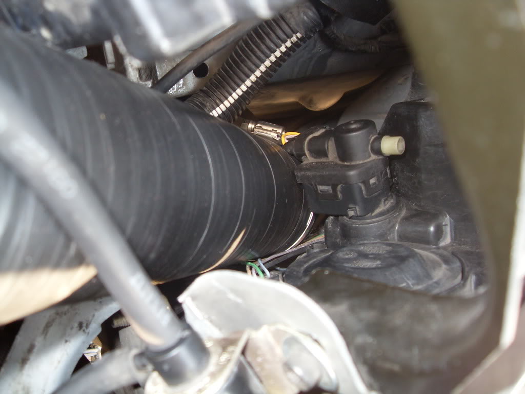

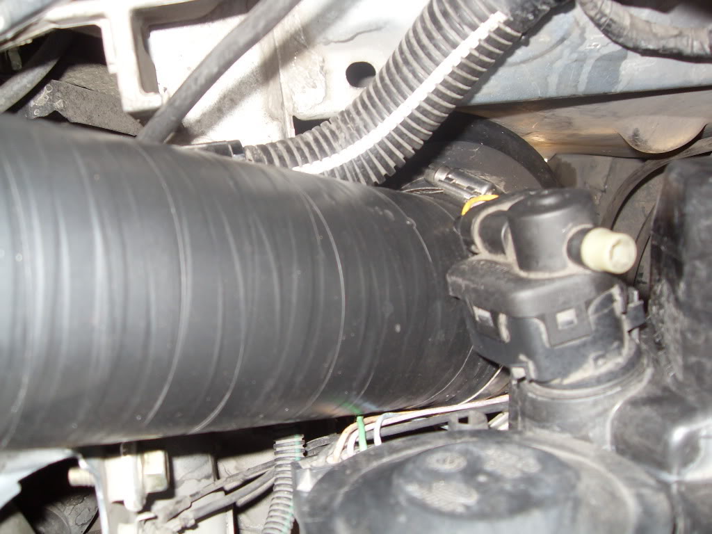

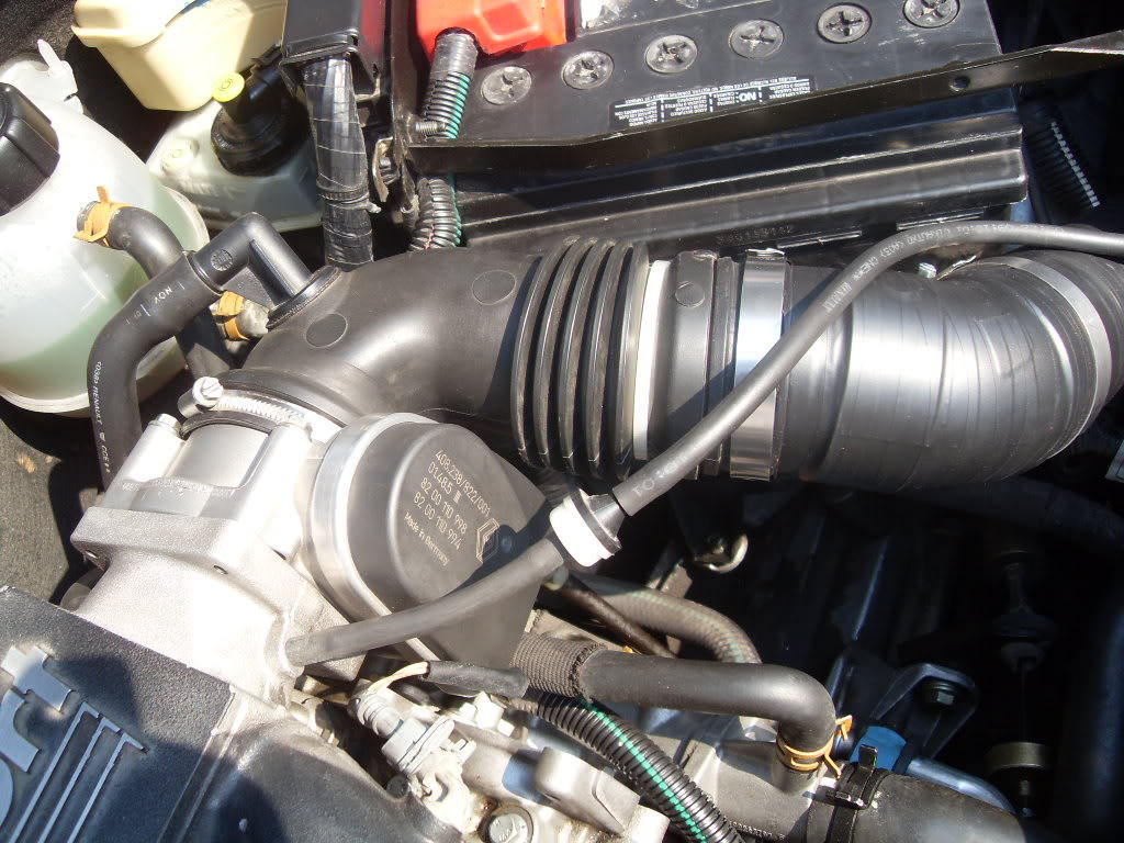

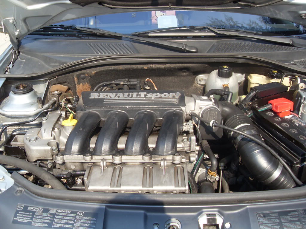

What you guys think of this setup
This is a true CAI, sounds awesome and think makes good power? I never did before and after, but,
  Renaultsport Clio 172
^^^is that electrical tape around the pipe?
Yes, the CAI is made of 3" PVC tube, 45 deg elbows and covered around black electrical tape. Cost nothing, just had to buy the filter!
My recorded temperatures for the inlet are between 30 - 40 celcius, think is high??? Bet is lower than the stock box though. You can even touch it after being in traffic.
The 45 elbows make for smoother path, just the OEM one is the big turn
