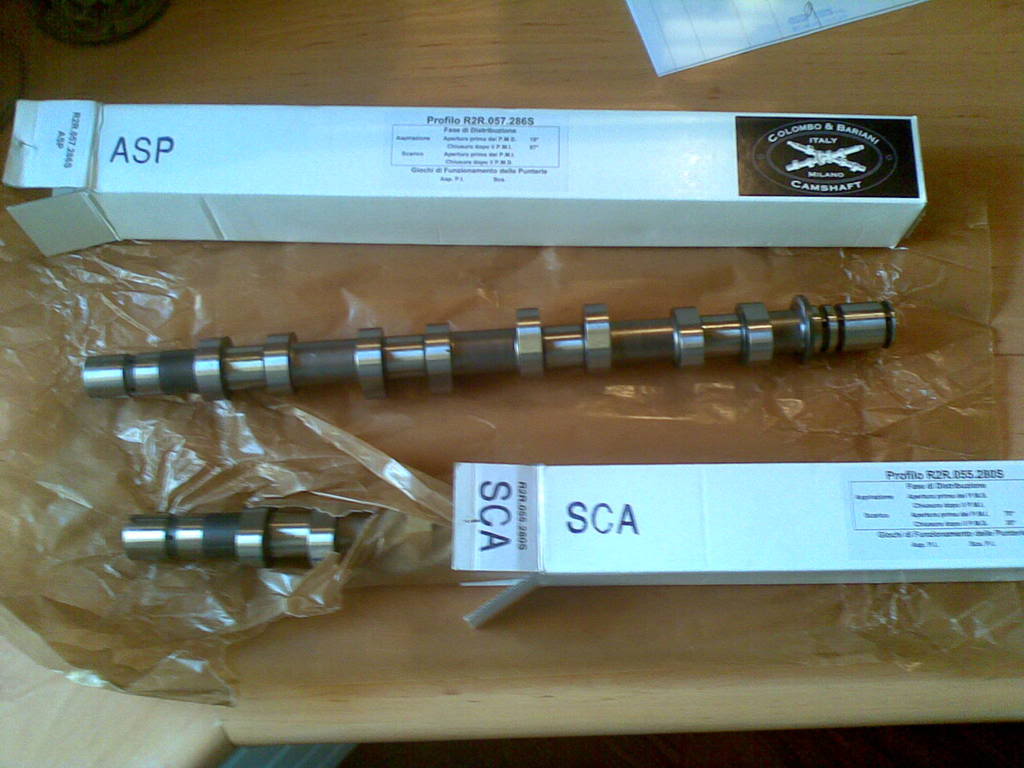

I've finally gotten to the point of ordering them. http://www.colombo-bariani.com/popup_dettaglio.php?lang=eng&id_prodotto=103
Road medium that do'nt need any other engine-mods.

Got the metal from Italy, heavy !?

Got them from factory , bit of discount 10%
Payed them with IBAN transaction , they let me know almost the next day that payment was in and how we were going to take care of getting them to Holland ! Very quick on email response etc. A friend of mine picked them up on a saturday, they were closed but it was arranged for someone to be there for him so he could come by :approve:
Costs about the same as Schrick ;)

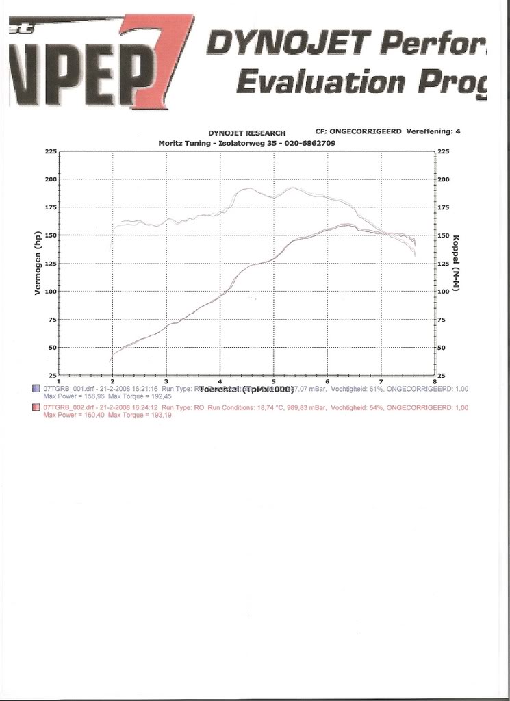

this is last year, with a Group N map by Fastchip, exhaust with orbisoud sportcat and ITG panelfilter. Result around 161 at the wheels which was already quite fast ! In a minute i will have scanned my printout from today...

How much has that 10bhp cost?

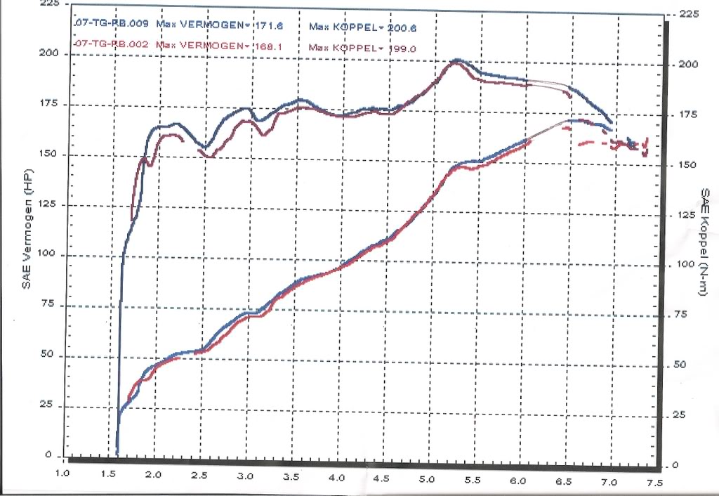

It was actually around 12 hp (wheels) more ;) .. Costs ? Silly money; 182 manifold + cams + inlets + mounting + custom map (Henk thanks a lot !) , the clutch also done :dead:
But i'm very excited, the car really really shifts. Torque has increased , power starts nice and early and the gears just seem longer as it just keeps on coming to way up higher up in the rpm
Henk spend some more time than usual to sort things out, he was also really happy with the outcome. The Colombo & Bariani cams were his idea , Alper from Turkey (EN035) had these on his car and Henk had mapped these with also very good results. Idle is still okay (for pretty wild cams) , torque, topend power, these cams have it all
My expectations are blown away (well was'nt expecting much after hearing/reading around on here), i think it was definately worth it
And when you could see the car limping into Fastchip headquarters and then after a couple of hours how she came out ...:star: Henk you're the man ! Unbelievable what you get for your (little) money from him. Hats off :)

  197
Even more astonishing, puts out the same power as a stock 197 on that RR.
Torque curve is almost similar as well, with the 172 a bit stronger between 6500-7k and the 197 a little bit above 7k.
