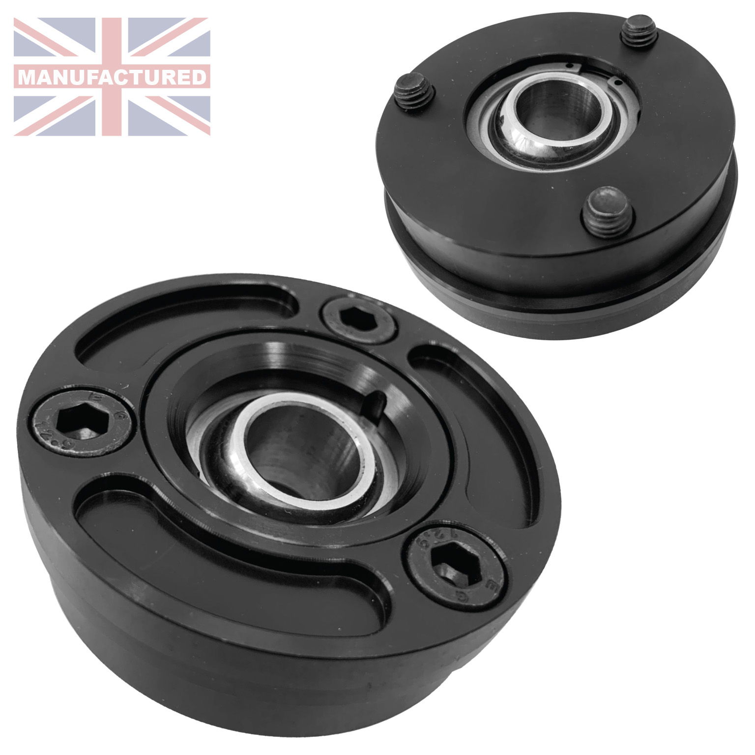

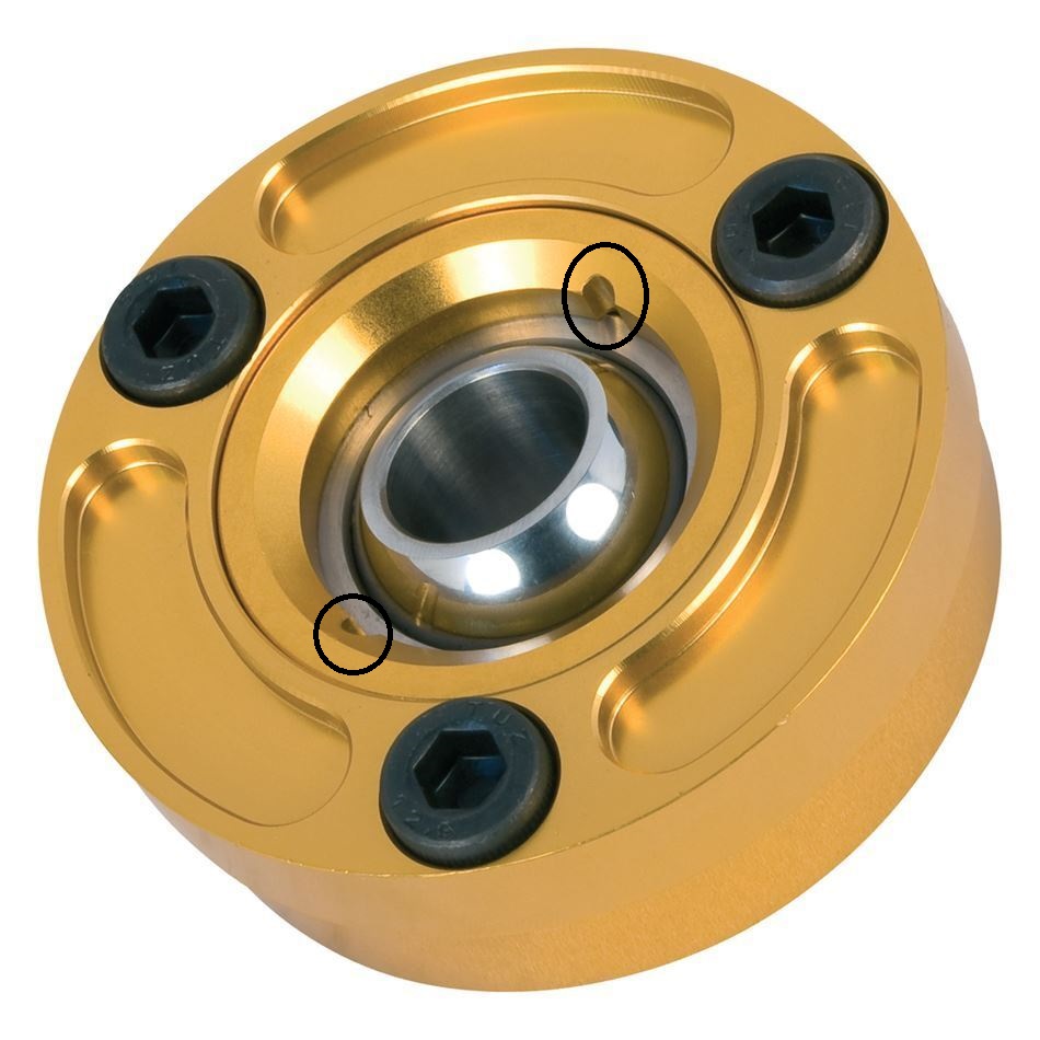

Are they these ones? Look like the spherical is held in by a nut. Rob knows more than me though!
Edit: Theres just a circlip underneath?

Pillow ball and spherical are one and the same. I believe the correct term is spherical bearing however lots of top mounts call them pillow ball. No idea why!? Perhaps a yank thing, maybe because it's been confused with pillow block over the years?
Anyway, as the good man Beauvais Motorsport above says. What mounts have you currently got?
If they are as above the circlip can be removed and the bearing will tap out. Ive seen another pattern where the bearing is pressed into an Ali holding plate (normally the ones that give you camber or caster adjustment). However I'd bet they aren't a very tight press fit as they don't really need to be. You could likely tap them out without a press.

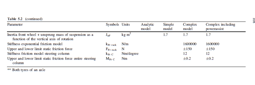

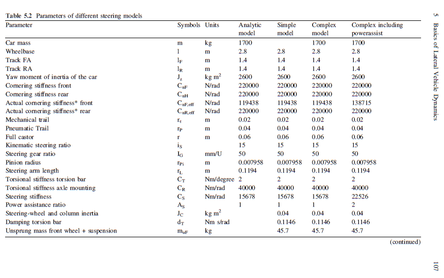

Those graphs were just an example taken from the Steering Handbook. You have self aligning torque as well as mechanical trail and a host of other things that can alter the steering.
If you read 30 pages of Race car vehicle dynamics every single question you asked is there, but then obviously the optimum setup to find is up to you to find out through equations and £££. Sorry I cant be of much help, and I dont know of a specialist that could properly set up a car from scratch without spending more than its worth.

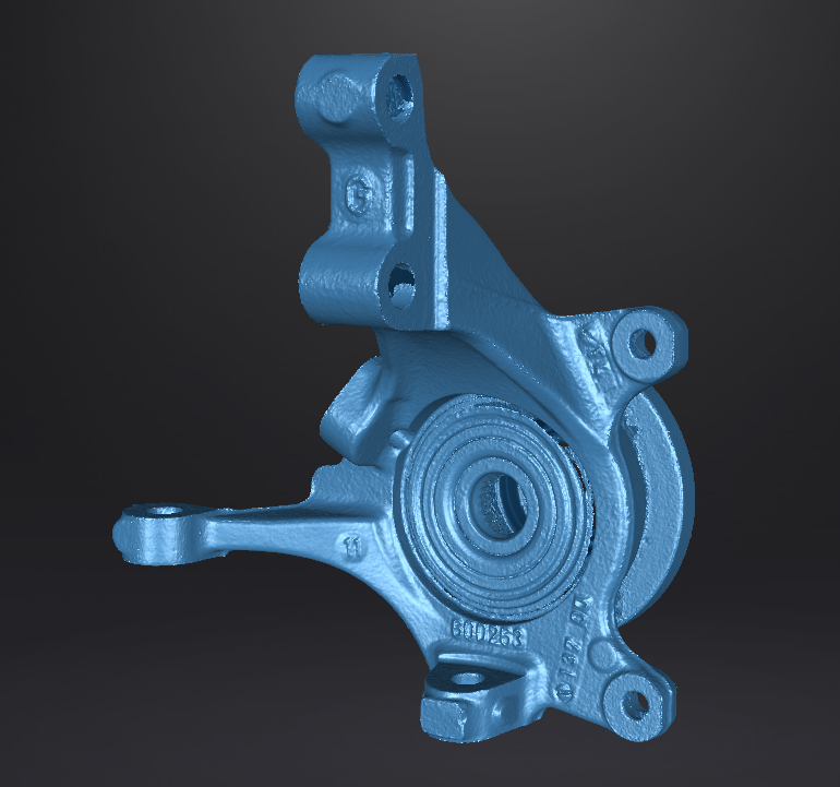

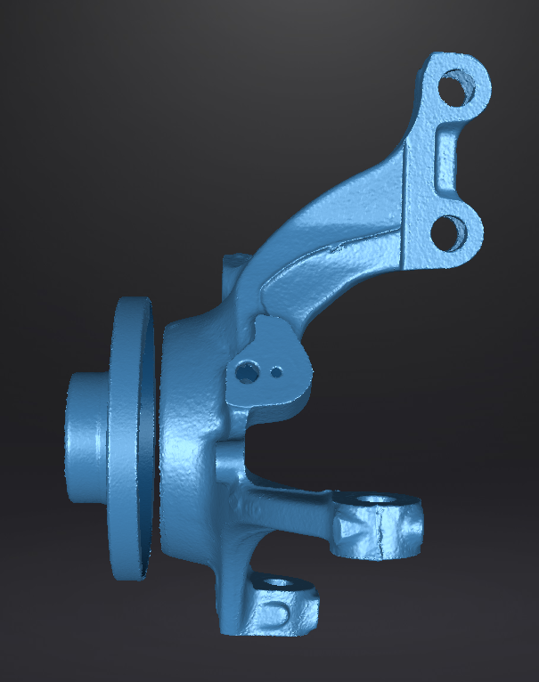

If you are still interested in clios when I have a full scan of the car I can offer more help.
All I have which serves nothing more than to just look at.. A 'cup racer' hub scan. This was the scanners first test to make sure I knew its performance was satisfactory, which it is.
Simbo
  Clio 172 Cup
The scan is certainly impressive. But as you obviously realise... I'm looking for a cheap / quick fix...! From what I've read, it seems that many trackday Clio 172s run with about 2.5 / 2.8-deg negative camber - and since reduced ride height tends to increase castor I think, as a starting point, I'll set my castor back to factory spec (benefit of the adjustable top mounts) and experiment from there - with incremental adjustments back to the current castor angle. But I guess with each incremental castor adjustment, a toe correction will also be required?

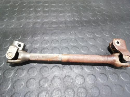

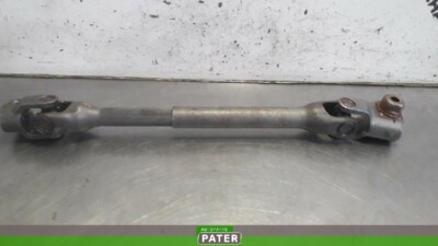

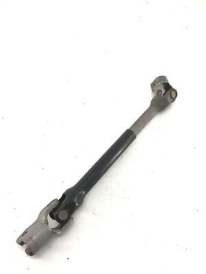

Column joint is to replace to a completely solid version. From electric columns, twingos and some dacias.
That one looks a little dirty but only one I could find on a quick search, I think there is a part number for it but I won’t be at my computer till tomorrow to find it.
