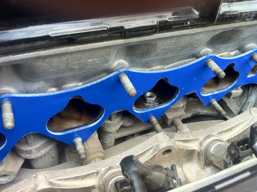

well i had the car with paul taday @ rs tuning for him to work his magic, i had a small issue with the inlet manifold and had to take the itb's off only to find a foreign body in there.
i removed it and thought id got away with it but after a bit of time on the dyno it was soon apparent something wasnt right :(
paul did a cylinder test and confirmed the inlet valve was leaking by on that cylinder :(
he did what he could with the car and lets just say he gained 90bhp from what it went in there with but still not what i was after ( please dont ask for the figures lol)
pic of the foreign body

now to remove the head and sort the valve seat out, just when i thought i was finished lol.
